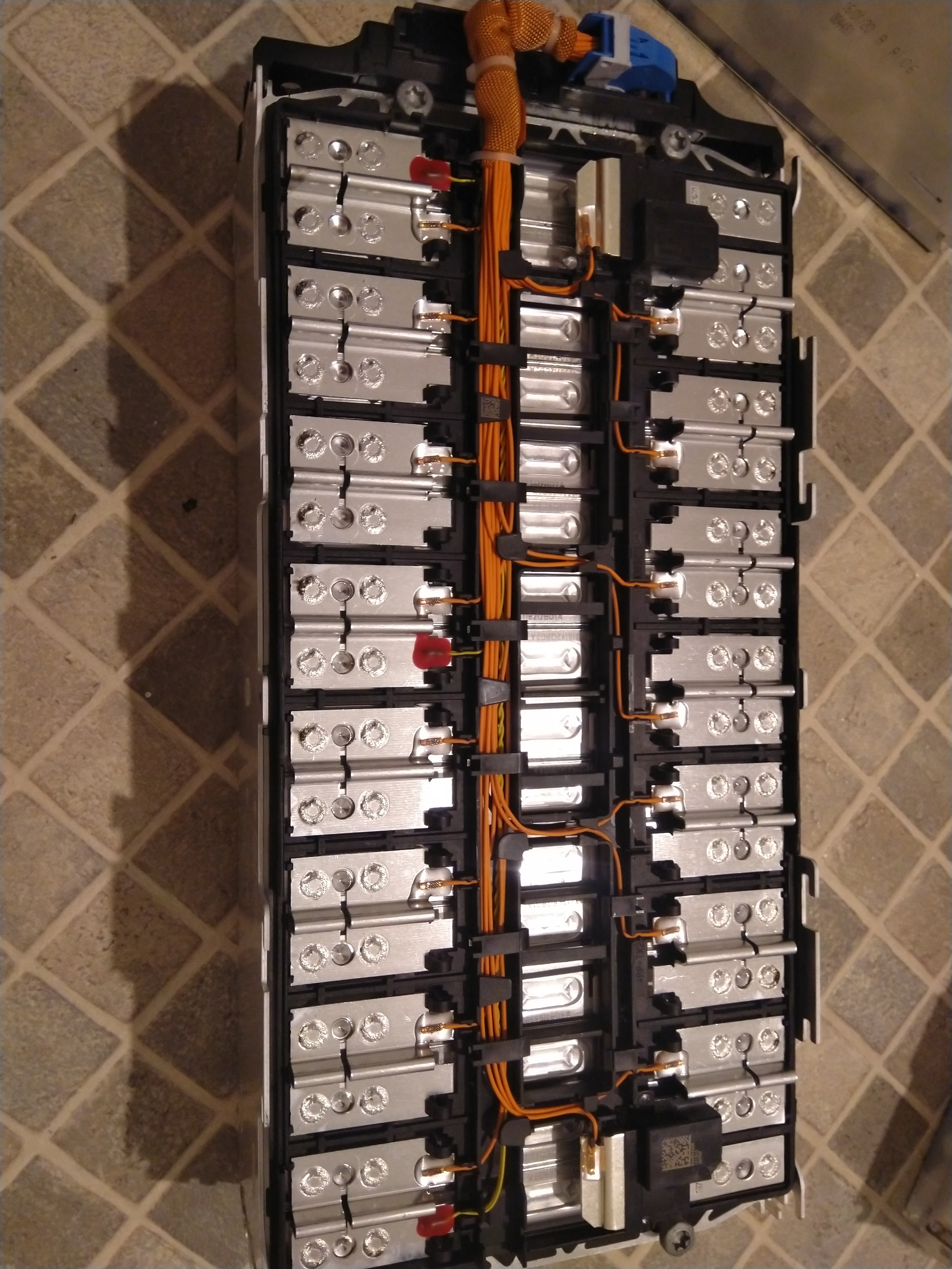

I recently purchased one of the newer 12Kwh 34Ah packs and thought I would highlight some of the differences I have noticed to the information that has been posted in the thread so far. This post will focus on the technical stuff, details of the purchase are on my project thread here:
viewtopic.php?p=25620#p25620
This is supposedly from a 2019 BMW 3 series G20, but given the pack is dated 6th Feb 2020 either it had a new battery or the listing was wrong.
Physically the modules are the same size and shape though I believe they are slightly heavier (I don't have an older one to compare), the most visible difference is the card/foil piece moulded into the top cover. I don't know what this is for but I guess it's some kind of heat or emc shield?
Once I had the pack fully dismantled I found the most negative module has a different CSC with a white case. Pinout and wiring are a bit different, see below.
The loom for the CSCs is completely separate to the one that goes to the contactor s-box which is convenient unlike pictures I have seen of others where they are bound together.
The end of the loom which connects to the master has far fewer pins populated compared to the picture that OutlandishPanda posted here:
viewtopic.php?p=13845#p13845, the pinout is similar with one important difference,
CanH and CanL are swapped around!
The S-box is also quite different.
BMW must have listened to Celeron55 calling the Panasonic contactors 'whimpy' here:
viewtopic.php?p=22123#p22123 because they have fitted these 175A contactors from TE. The exact datasheet is not available as it is a restricted product but this is the closest public version which I think is the same just with a lower voltage rating and 90°connector position.
https://www.te.com/commerce/DocumentDel ... -1904070-1
It says they should be good for 500A for 30s anyway. Also has an economiser built in.
The precharge sense wires are attached in different places, and the connector has fewer pins populated. I plan on wiring directly to the contactors anyway so didn't investigate this further.
Despite all the changes, SimpBMS still read all 96 cells fine, I haven't checked if balancing works yet as my pack only has a 3mV delta.
