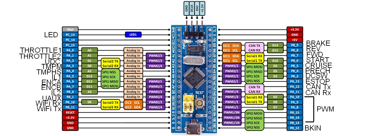

Decided to see if the inverter firmware would run in the so called Blue pill cheap STM32 boards that are available for a few Euros on ebay. Loaded in the bootloader and firmware hex with stlink and to my amazement it works. As the blue pill uses the smaller 44 pin package some pins are missing but I think the important ones are present.

Interesting. If you do most of the communication over CAN then you can afford to lose quite a few of the IOs.

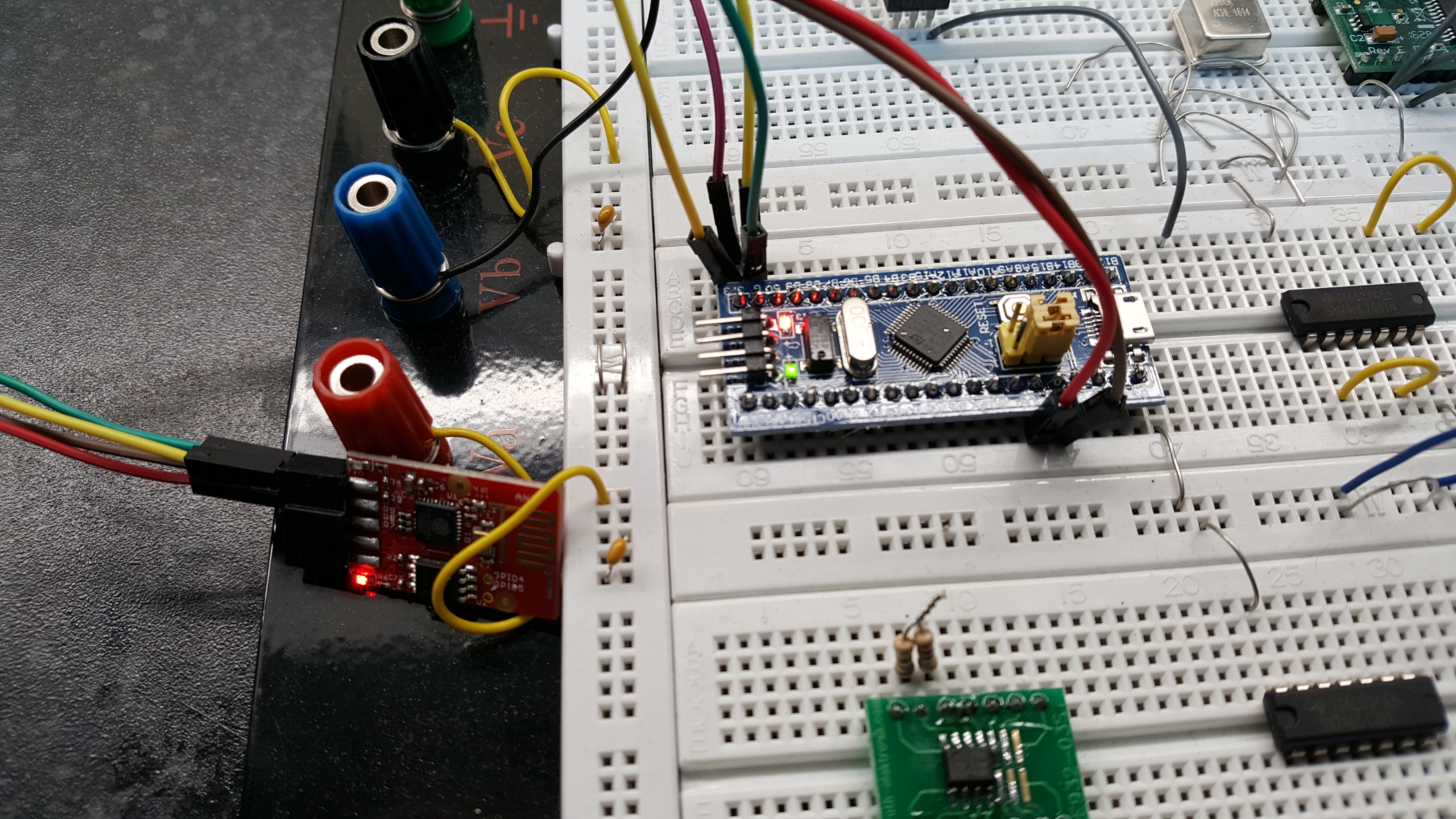

So with some tweaks to the io mapping and deleting some error pins it fits. Tested on a breadboard generating pwm in open and closed loop. Now just need to run a motor:)

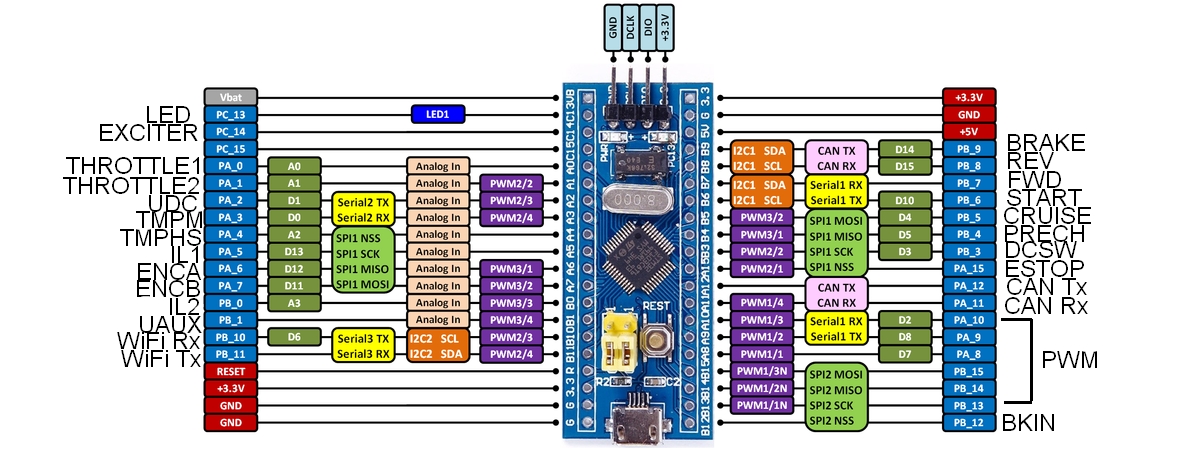

Now with resolver exciter generation.

Nice work JB, those blue pill development boards are absurdly cheap. And PC_15 free if needed.

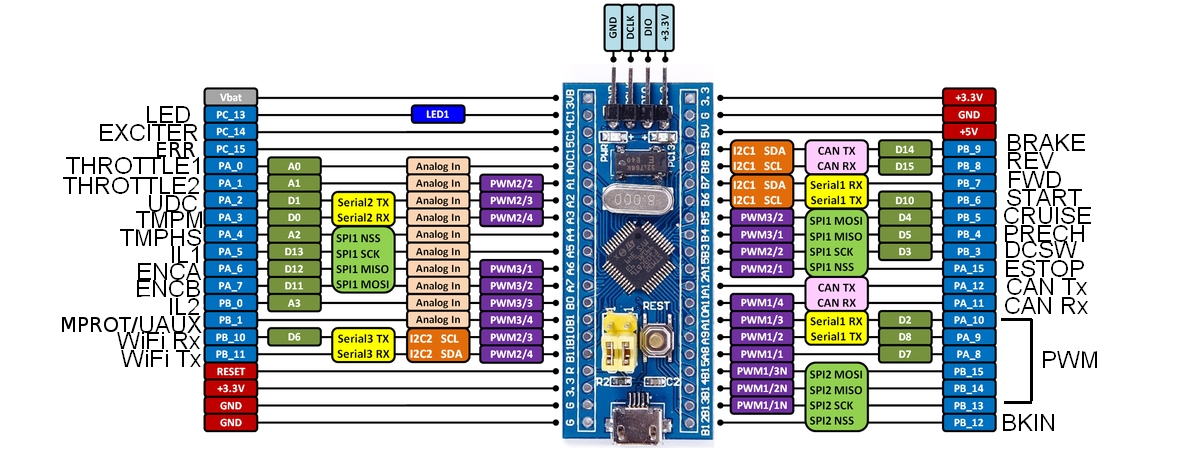

Here's a first try to make a unified software that supports Blue Pill.
I have added mprot again (to have to change less code) and mapped the error output to the yet free PC15

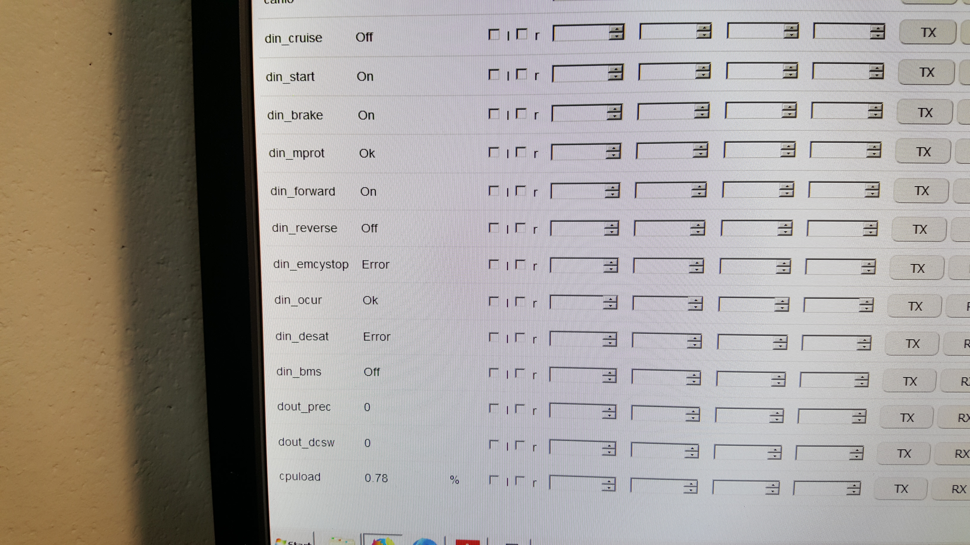

Just more thoughts on the mprot pin. It makes sense to tie it to your supply voltage (aka 12V) via the 4k7/1k2 divider to be able to read the uaux value. So it's not really in the way.
The emcystop pin doesn't do anything useful, it is just used to determine whether a shutdown (bkin) was caused by emcystop or something else. So it would make sense to delete it and map something else like brk_out (brake light output) or vtg_out (over/under voltage output)

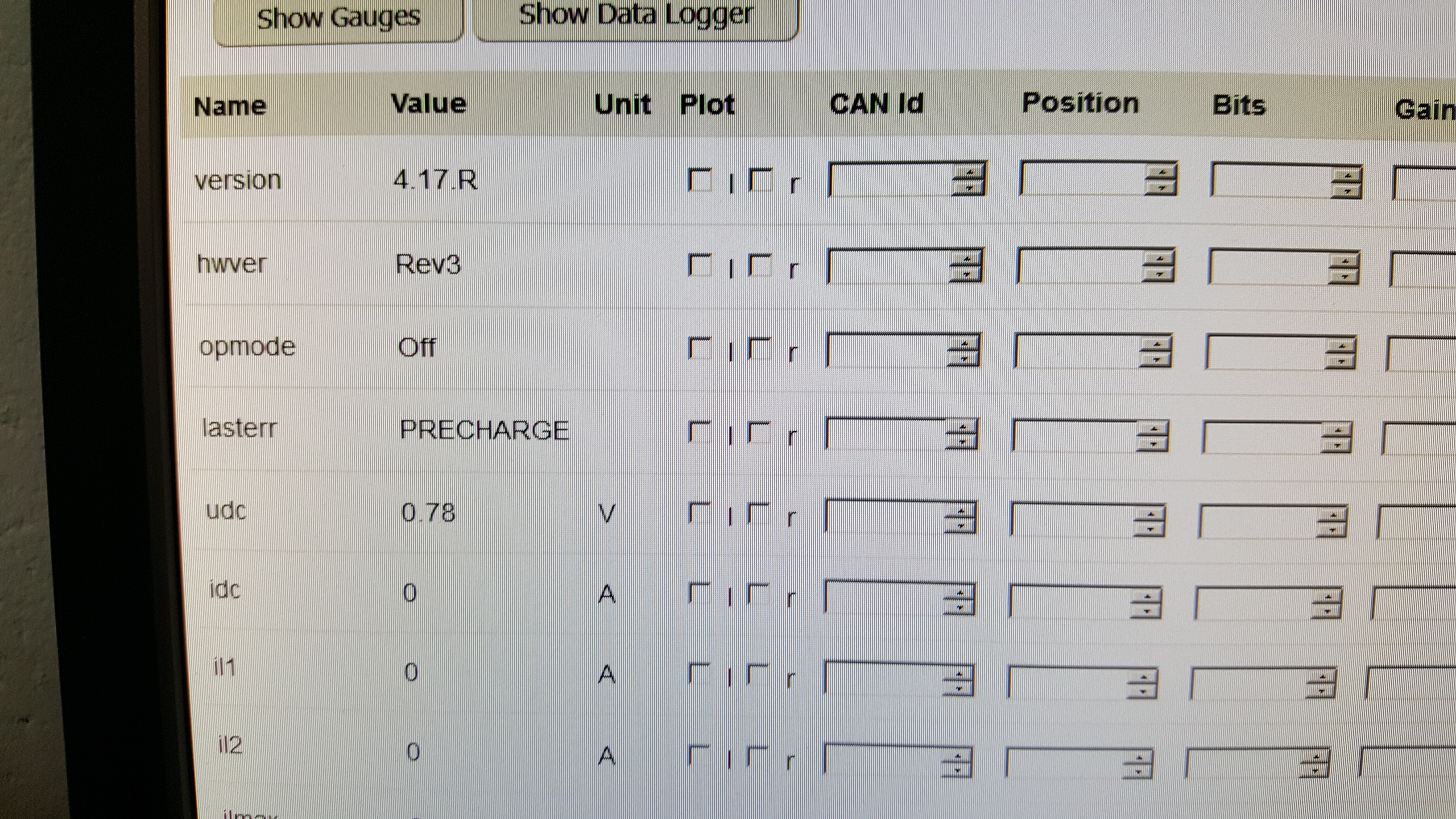

I also read about the STM32C8T6 to often have 128k of flash instead of 64k. This is somewhat important because the parameters and CAN mapping is stored in the last two flash pages. So if you can't store and reload you're parameters that would be why.
Spacewise bootloader+firmware+parameters would also fit inside 64k so I could do this in the blue pill to be safe.
