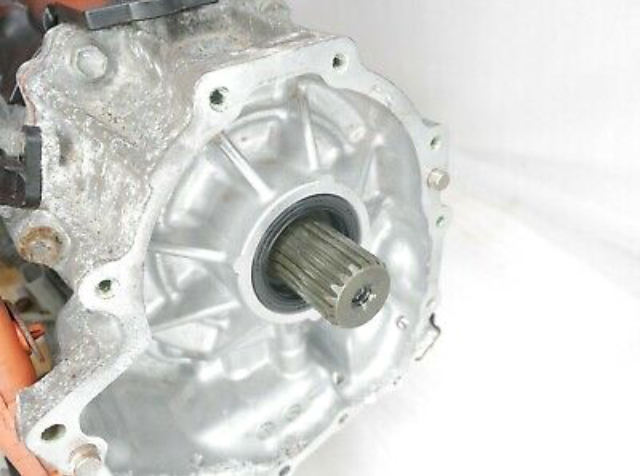

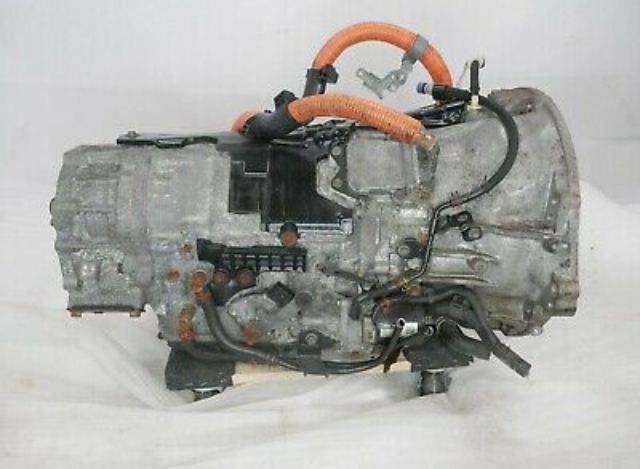

I have since received my first GS450h gearbox/L110. This weekend I removed the tail housing to find that it will not be as simple as I hoped, to design and machine an adapter from the GS450h transmission. It seems that the output planetary differential/gear assembly is housed in the rear housing, as well as the parking brake. More complicated than just an output shaft and bearing. Based on photos of the LS600h transmissions/L110F available for sale without the AWD transfer case, the primary difference between the two is the tail housing. The LS600h gearbox with its tail housing has a flange and 20- something spline output shaft for use with a transfer case.
I will need to get my hands on a LS600h transmission to compare differences, and whether the tail housing is directly compatible with the RWD/L110/GS450h. I haven't seen any tail housings available for sale, so the LS600 transmission may continue to be the best bet for 4WD for some time to come, though much more rare than GS450.
It would be possible to machine a new adapter to house the parking brake lever, output bearing output shaft speed sensor etc... but sorry folks, custom machined adapter price for GS450 trans wouldn't be competitive and it looks like the LS600h transmission is the cheapest route to get 4WD, solely due to the tail housing. The LS gearbox will be my new target for developing an adapter, unless we're lucky and it turns out that the LS tail housing is directly compatible with Toyota/Lexus transfer cases.
If the input shaft is compatible with a 21 or 23 spline shaft and only a custom flange is needed, a sale price within a couple hundred USD at current 7075 Al prices should be achievable, depending on batch size.
Will post any updates.

Dose any one have photos of a gs450h with the tail section removed?

For the GS450h L110F transmission, it is "like a conventional RWD automatic", so it has a drive flange sticking out the end. Needs a divorced transfer case and a short shaft connecting to it.

Found a 2008-2016 ls600h without the transfer case on eBay in the us. https://www.ebay.com/itm/133810595802?_ul=CA
Some photos from the posting

TinkerTan wrote: Mon Mar 22, 2021 12:58 am I have since received my first GS450h gearbox/L110. This weekend I removed the tail housing to find that it will not be as simple as I hoped, to design and machine an adapter from the GS450h transmission. It seems that the output planetary differential/gear assembly is housed in the rear housing, as well as the parking brake. More complicated than just an output shaft and bearing.
I don't suppose you have any photos of the GS450H without the tail piece on?
