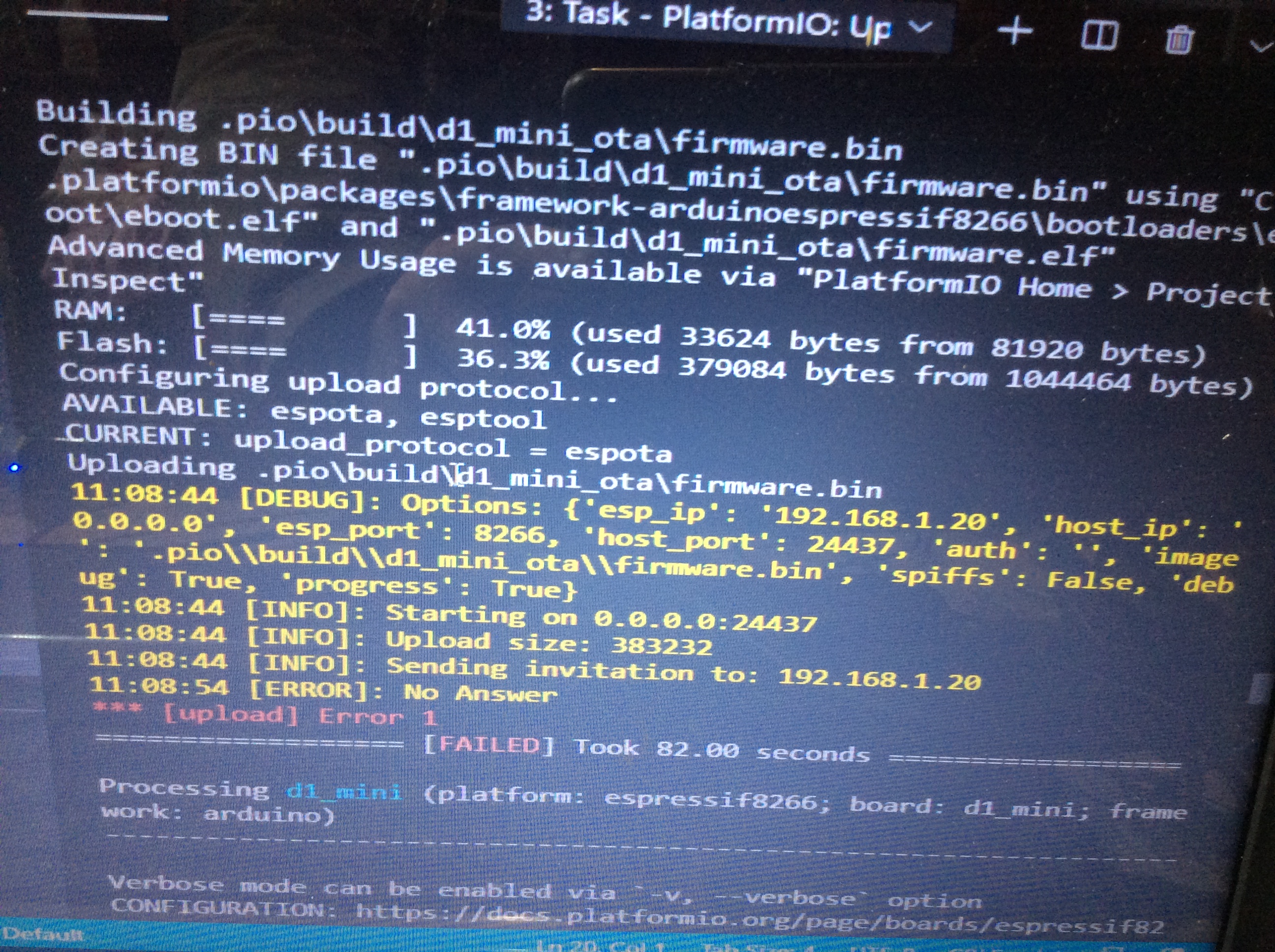

he second day I try to compile the Interfax WEB file (((constantly gives an error (((I tried to build it in arduino - and also failed (((please re-upload the files...

Re: Gen 3 inverter converter control software
Whats your error?
- Posts: 1779
- Has thanked: 83 times
- Been thanked: 428 times
Yea, your esp ip address wont be 192.168.1.20, that'll need changing to match your ISP, unless you've told it to join your network you will need to change to connect to the module wifi network and uss the 192.168.4.1 ip look in platform.ini you could also upload via the cable.
The photo shows a trial address ))) that's what you have to offer I also tried...I tried it -- the error is the same(((
Everything loaded normally) but does not work( what is the problem?
You also need to upload the filesystem.
Yes!!!! It worked.thank you so much for your help . Waiting for the updated files)))
