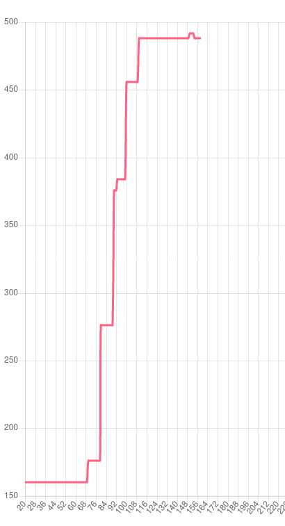

Mail from JLCPCB today :)
The board "in general" is working but has a few design flaws.
  • The 32V boost converter overheats and cuts back seconds after the PWM becomes active. It will need more cooling and lower switching frequency. 1 Mhz is too much. That also means larger inductor.
  • The communication between ESP and STM is disturbed and I cannot refresh the parameters once the PWM is running. Will need better routing and perhaps some low pass filtering.
  • SPI is not working because there is a voltage divider before the digital isolator. WTF? Anyway, seems my test board with LD1117 had like 0.07V higher 3V3 level and just made it, the mini mainboard with just 3.27V doesn't make it. Will need to add a buffer. On the pic you see one from my 74 collection.
There are also some minor mechanical problem. Before respinning the board I would like someone with a complete inverter to check whether it its inside and whether the ampseal is in a good position. Preferably in Europe because sending outside takes ages. Anyone? Board for free of course.

Did some more testing and finally found that right way too talk to the ADC. The reference needs to be set to 2xVref which means bit 6 must be set in the request. But for bit 6 to have an effect, bit 11 must also be set :geek:
So the final request: 4096 + 2048 + 64 + (channel << 7). So to sample channel 3 send 6592. I also found that channel 3 is also connected to bus voltage.
