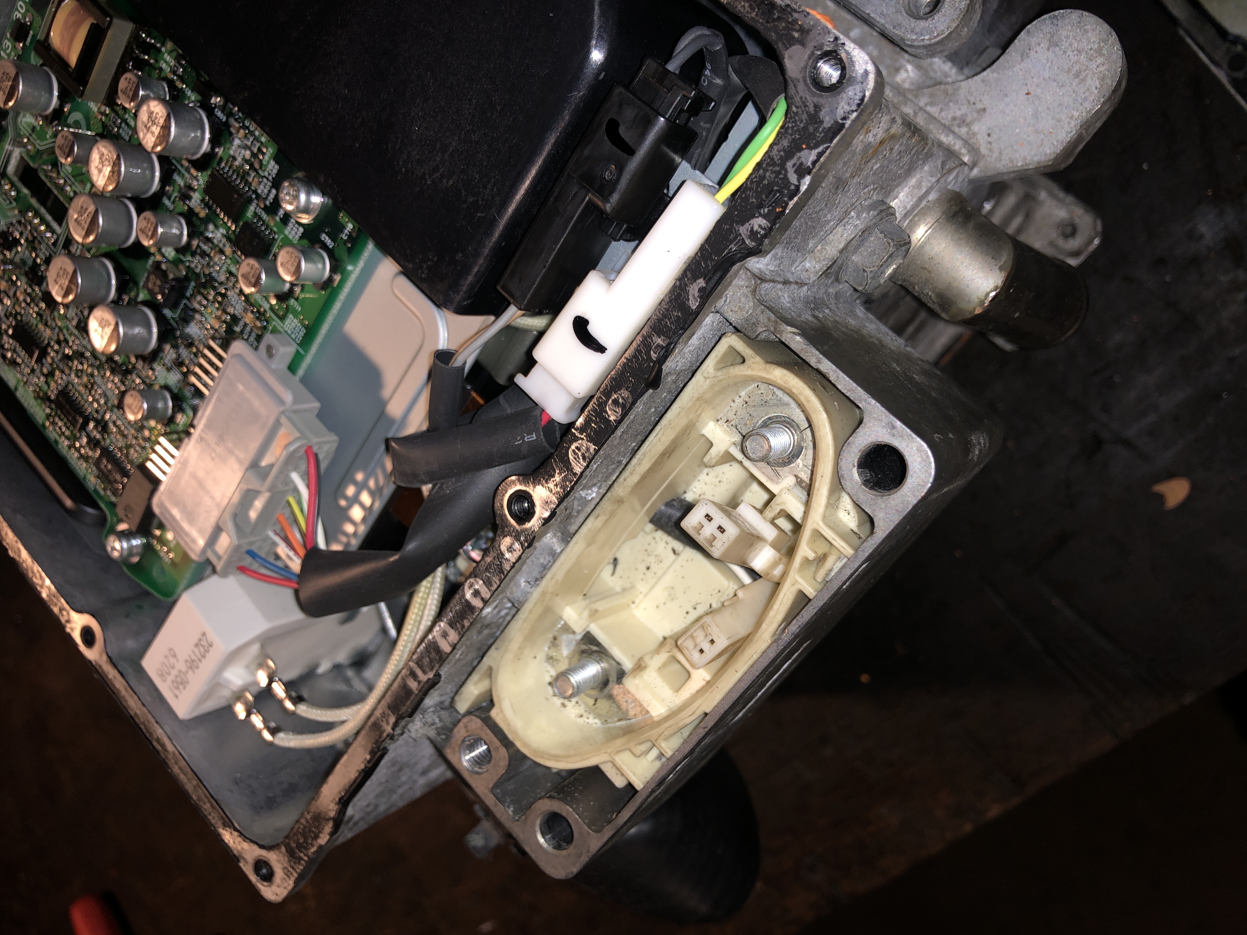

Gigas wrote: Fri Jan 29, 2021 1:57 pm Ok I must be missing something but I ordered two different connectors for this connection on the inverter and both connections off the wiki page don't fit - Also is there not a pinout for this?0127212138_HDR.jpg
I am following the pinout off the OEM connector.

Can anyone advise whether it’s safe/possible to remove the converter connector without any affect to the functioning of the inverter.
Doubt it has any affect but just double checking

Yes you can. You need to do something about the loose connections to the converter and the gaping hole exposing bus voltage. You can just remove the DC link bus bar and 3D print a cap for the hole.
If you plan on removing the converter hardware, let me know as I'm local to you and am always after more converters to work on for my converter controller development.
