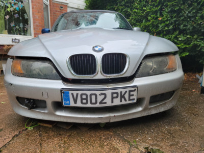

About 12 years ago the start-up I co-founded joined an accelerator programme. One of my takeaways from my time spent there (I was still running another business) was the phrase "JFDI", short for "Just f***ing do it." I think it is fair to say I have reached the JFDI stage on this project.
In April we are getting a load of building work done. This building work starts in the place I have currently stored a bunch of the body parts stripped from the car: bumper, wheel arch liners, etc. I need to clear this area, which means I need to have the car reassembled by April.
Fortunately, there has been progress while I've been quiet on the blogging front. That was for all the usual reasons: work, family, despair at the lack of variety in my life under lockdown. Mainly work though: thankfully that has been good, keeping me busy but funding this adventure.
Which leads me neatly to a confession: I have rather lost track of spending on this project. Or rather I had. What started as a passion project, and an educational project for my daughter, has become increasingly closely aligned with my work. In fact, it has helped me win some very interesting business. As a result my accountant advised me that my investments would constitute a legitimate business expense. Which was great, until he told me how much I had spent...
For now, let's just say that it is more than I imagined. When I'm done, I shall publish a budget based on what it would cost to replicate my project. But I shall say now that I might not be brave enough to share what I've actually spent. Though thankfully, I can say that the business it has helped to bring in more than covers the costs.

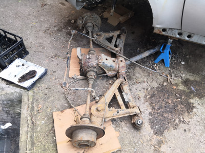

Yesterday: JFDI
Today: Just f**kin' did it.
Three drill bits, two different bolt extractor tools, two blow torches, an angle grinder, a hammer, a power drill, and an impact wrench. Oh, and a lot of swearing. But I got there.
Needs a good clean but despite all the crust, I don't think there's anything structurally wrong. Not liking the prices of new bushes though.

Rear axle assembly
Getting this apart proved a ballache. Lots of rusted nuts & bolts - was glad of new impact wrench. Brake lines were the worst. I ended up cutting most of these off. The calipers were pretty shot too. One was maybe rescuable but I decided to get a used pair off eBay and refurb them with kits for new seals and pistons etc. I have all the parts and kit to redo the lines and some new flexis have arrived.
I didn't completely strip this all down but everything has been cleaned up with a wire wheel and treated to a coat of black paint. It's not good and I will replace everything at some point. But it's OK.

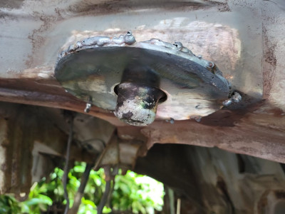

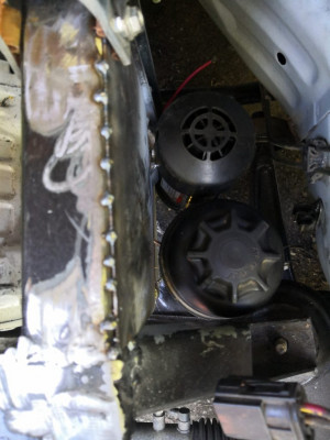

Part of the reason for wanting to get the fuel tank out was so that I could confidently weld around that area. Driver's side rear strut top was rusted out at its corner, as is the spring mount on both sides.
Fixing the strut top meant stripping the trim from the rear of the cabin and the boot, and a lot of patient grinding to uncover the true extent of the rust, which just kept growing. I have limited fabrication tools so the repair had to be made up of lots of small pieces of metal welded in progressively. It's not beautiful but it is structurally sound and that will have to do for now. And no-one is going to notice once it is covered in seam sealer. For now it is covered in a couple of layers of primer while I see to the spring mounts.
In an ideal world I would replace these with some off the shelf repair panels, but I can't find any. So, I'm making up some over-engineered repair pieces. 3mm steel rings to reinforce the rusted parts and a 1mm folded steel brace on the top. These are largely measured up and templated and when I get time I'll get them cut out and welded in. Then the back axle can start to go back in, along with the refurbed brakes etc.

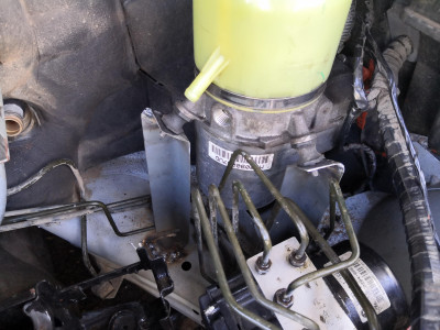

I’ve finally welded in the brackets for the Zafira power steering pump. This was delayed by stuck connectors to the ABS pump – I needed to move some of the brake pipes to access the space where I wanted to weld. I managed to get all but one undone without shredding anything with the liberal application of WD-40 over a few days. This created enough space to grind away the paint with my new finger sander and weld in the three brackets.
In retrospect, I wish I had made them from slightly thicker steel (I think it’s 0.75mm), but with the three of them it should be fine. If needs be, I can brace one of them off the heater mounts (below).

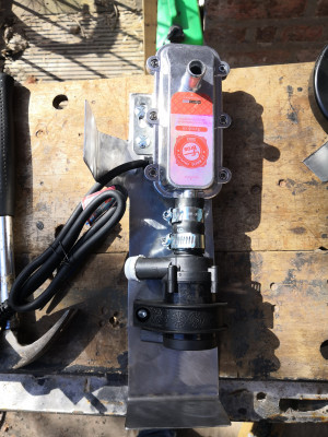

Heating

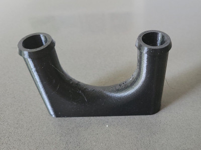

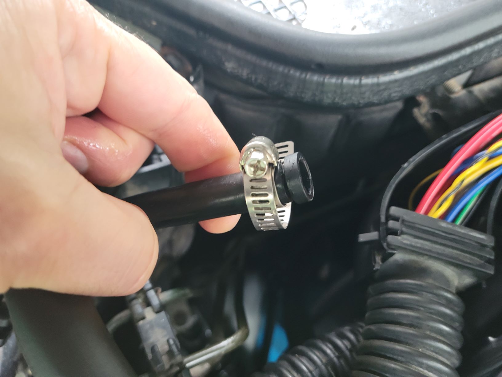

I bought and modified an AC car pre-heater to remove the pump so that it can run on DC. The full 350V of my main pack may be a little much but we shall see. There is now an external 12V DC pump to keep water flowing through it rather faster than I think the internal pump would have managed so that should balance it out.
I fabricated a bracket to hold the heater and pump next to the bulkhead that will be welded to the frame and a former solenoid mount that protrudes from the bulkhead.
I’ll need some sort of filler arrangement. And I need to make up a pipe to take an in-line temperature sensor that I picked up off eBay (irritating 1/8NPT thread that you can’t model in Fusion360). This will connect to an Arduino that will drive a contactor on the live line – a feed from the old A/C connector on the inverter. Plan is to take a simple on/off signal from the wiring from the old solenoid valve that I believe must have routed water from the engine through the heating loop when the heating was turned on in the cabin.
Just waiting on paint to dry on the back of this before it can be welded in, as this won’t be accessible once it is.

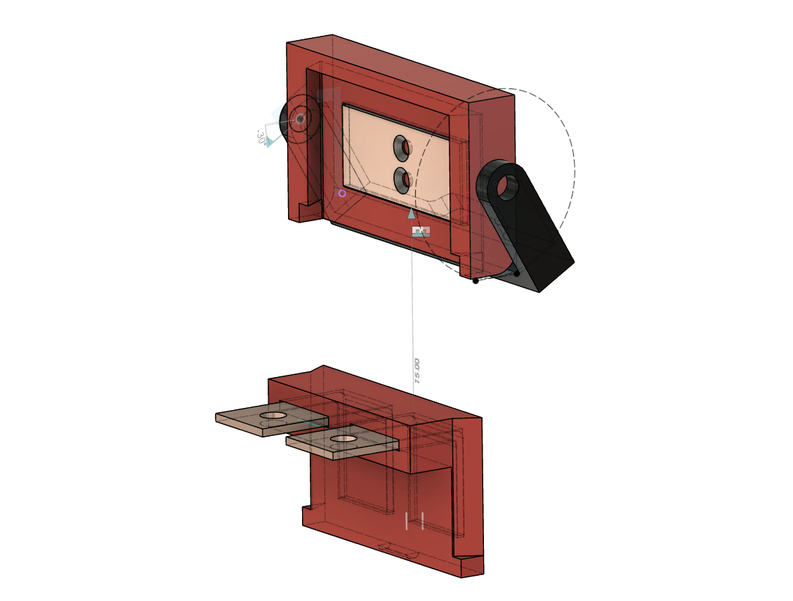

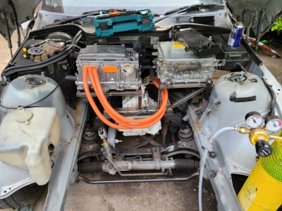

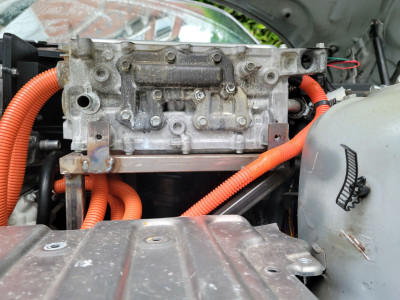

Inverter & charger mounts
I’ve cut off my inverter & junction box mounts that were welded to the top of the engine mounts (as seen in the picture). This is because I wasn’t particularly happy with them after lots of modifications, and because I now have lots more space to play with. The charger is a lot smaller than the old high voltage junction box (replaced by the BMW ‘safety box’ now integrated in to the battery box). Plan is to make up some new mounts with fresh steel so that the inverter can be rotated through 90 degrees. This will create more space for the battery box so that getting the lid on and off isn’t a total PITA.
This should also create some more space for the cooling systems, both oil (for the motor) and water (charger and inverter).

I'm curious how it works with your heater. I threw it out again. Tried to make a PWM control for it but that immediately blew a fuse.
So it is 27 Ohms. P=U²/R. So 2kW for 230V, 4.5kW for 350V. Also the internal thermostat won't be able to interrupt DC. You could put a snubber cap across it maybe...
I'll let you know when I get to it. Have put that on one side for now to focus on getting the thing actually moving. See next update!

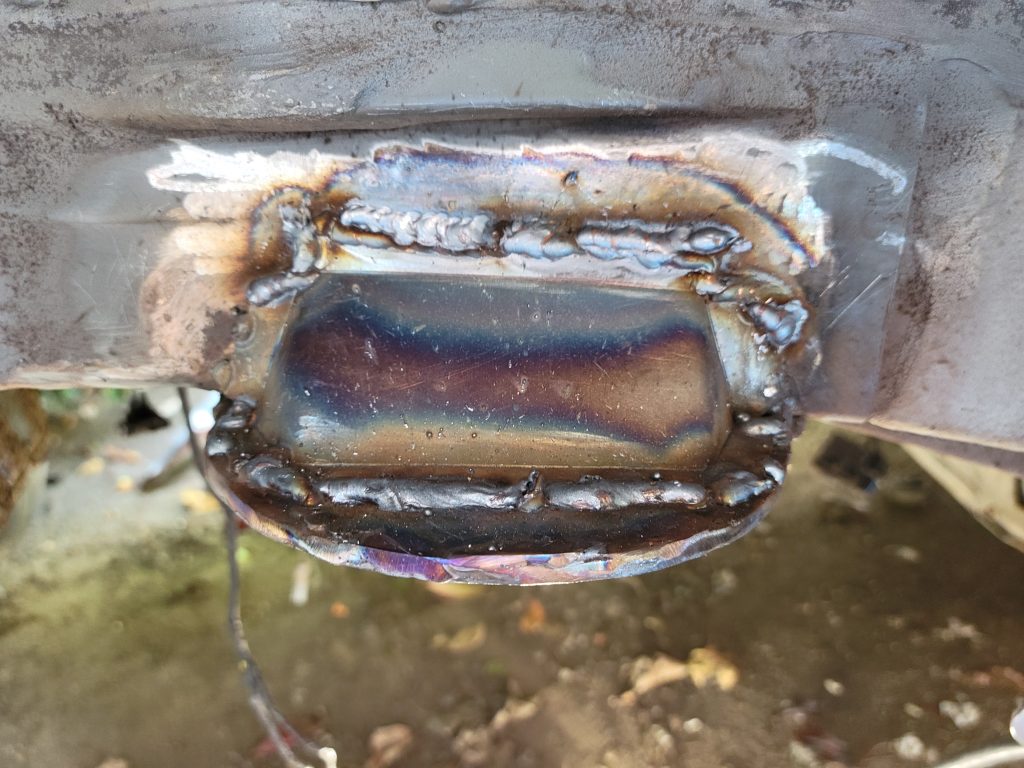

If you have been following this project, you will know that I bought an absolute lemon that required a lot more welding than I planned for. Anyway, that is all now done. Is it pretty? No. Do I think it will get through an MOT? Yes.
The main problem areas were the top mounts for the rear springs, and the strut top for the offside rear. I welded that up a while back and wasn’t very happy with it at the time. But when I came back to it with a bit of distance I decided that though it was far from pretty, it was actually very solid.

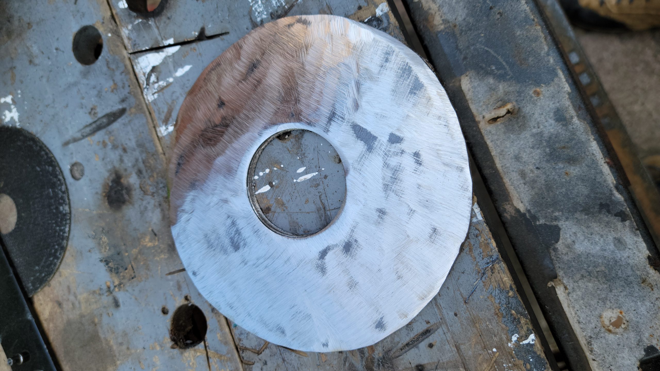

The spring mounts required some serious fabrication though. Two parts had largely dissolved. The mount itself, a disc of metal with a round locating nub in the middle. And the cover/brace piece that sits between the disc and the upright section of the car body. You can probably make better sense of this from the photos.
I couldn’t find repair panels for these parts so I decided to half repair, half make my own. I cut some 130mm discs out of 3mm steel, and then drilled large holes in the centre so that the locating nubs – which hadn’t rusted – would protrude through. This means there is less ‘nub’ than there would have been originally, but having tested it with a spring, they still seem to locate fine. The springs will sit a couple of millimetres lower as a result – and perhaps the car a little higher – but I don’t think anyone is going to notice.
My neighbour asked if I was going to get these laser cut. “Um, no, I’m doing it with an angle grinder.” Next time, I will get them made by someone who can draw a circle.
I couldn’t get the discs to locate perfectly flat against the car tub, so had to put some chunky welds in, in places. But I think the weight should be fairly well distributed. And they seem to be at the same angle as what was left of the original parts. I may have some issue when it comes to reinstall the rear suspension assembly, but we shall see.
For the cover/brace, I used the classic CAD (cardboard aided design) approach and then cut and folded some steel to match the pattern. Can’t remember the thickness off the top of my head (I’m writing this after a couple of beers) but they are very stiff. Maybe 1mm? I partially seam welded these in so they add a lot of rigidity.
The whole lot was then coated in red oxide primer, then paint, then seam sealer, then a coat of stone chip for good measure. If I’ve done it wrong, it will be easier to scrap the car than get all that crap off. And TBH, if this fails its MOT on structural issues, that is what I will do. The car owes me maybe £300 and I can get that back by selling off parts. So I will just treat this as a training exercise/development mule, strip out the bits I’ve added and move them to a more solid donor.

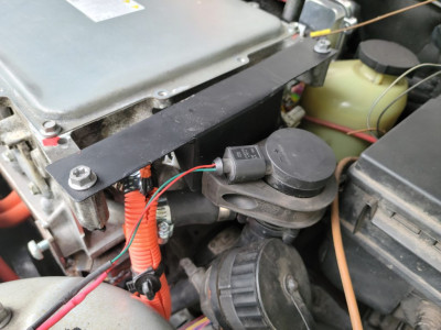

In the last update I said I needed to redo the mounting brackets for the inverter and charger. I didn’t mention that I still needed to make mounts for:

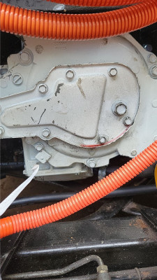

  • The oil pump (for motor cooling)
    The oil reservoir
    The oil cooler
    The water pump (for inverter and charger cooling)
    The radiator/reservoir
Starting with the big parts, I went and bought some new 20mm box section with fairly thick walls (1.5mm again I think) and started fabbing up some new mounts to sit across the top of the engine bay, close to the firewall. The inverter sits in front of the driver and the charger on the passenger side. With a bit of fettling, these now sit nicely lined up and leave plenty of room to get into the battery box. They also leave room for all the cooling bits.
I made up a bracket to hold the oil cooler down to the left of the motor on the engine bay image. It’s horizontal, which is a bit weird. And the clearance to the cross member isn’t amazing. But it doesn’t seem to touch it under pressure. And it means it can act as a giant U bend, taking the warm oil out of the motor and feeding it back into the reservoir. For this, I have re-used the old ATF reservoir from the old power steering system.
The reservoir and the oil pump are mounted on a plate to the right of the motor on the picture below. This is welded to the frame that carries the charger, and bolted to the transmission adaptor plate as well. I should cut away the excess on the plate but I decided to leave it for now in case anything else needed mounting there.
From the pump, the oil goes through a right angle bend then up and over and into the top of the motor. Don’t have any pics of this pipe yet.
That pretty much completes the oil cooling loop. I just need to make a plug to block off the secondary outlet on the bottom of the motor. I’m going to 3D print this from PETG. It’s fairly chemical resistant and I don’t foresee the motor temperature getting very high. If it does, I’ll get one machined out of brass or something.
The water pump is now mounted off the side of the charger on another bracket I made up. Could do with a bit of a trim and the paint isn’t great but I’m focused on function for now.
The pump runs water through the charger, then into the inverter via a bit of a dogleg using another 3D printed part. Designing tubes for printing is a ballache, especially if you are trying to avoid using support materials. Hence the funny shape.
From the inverter, the coolant runs down to the little motorbike radiator, now mounted in front of the battery box. Lots of air flow and well out of the way. These brackets are welded to the old front valance (and yes, I will give the whole thing a coat of paint eventually).
Cooling loops
With all the components in place, adding the cooling loops is ‘simply’ a matter of running the right sized hoses, elbow pieces, and lots of jubilee clamps. These are proving to be another ballache, especially in tight spaces. I think the jumbo pack of jubilee clamps I got from a discount supermarket about ten years ago maybe aren’t great quality. Who knew?
Anyway, most of the hoses are now in apart from the last links to the radiator, and the dogleg between inverter and charger (I snapped the first 3D printed part so currently reprinting with thicker walls). I’m looking forward to testing these, not least because no-one has mapped the resistance on the thermistor in the motor I’m using yet, so I won’t be able to get accurate temperature readouts until I do.

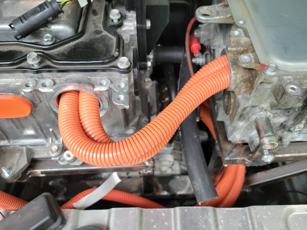

HV Wiring

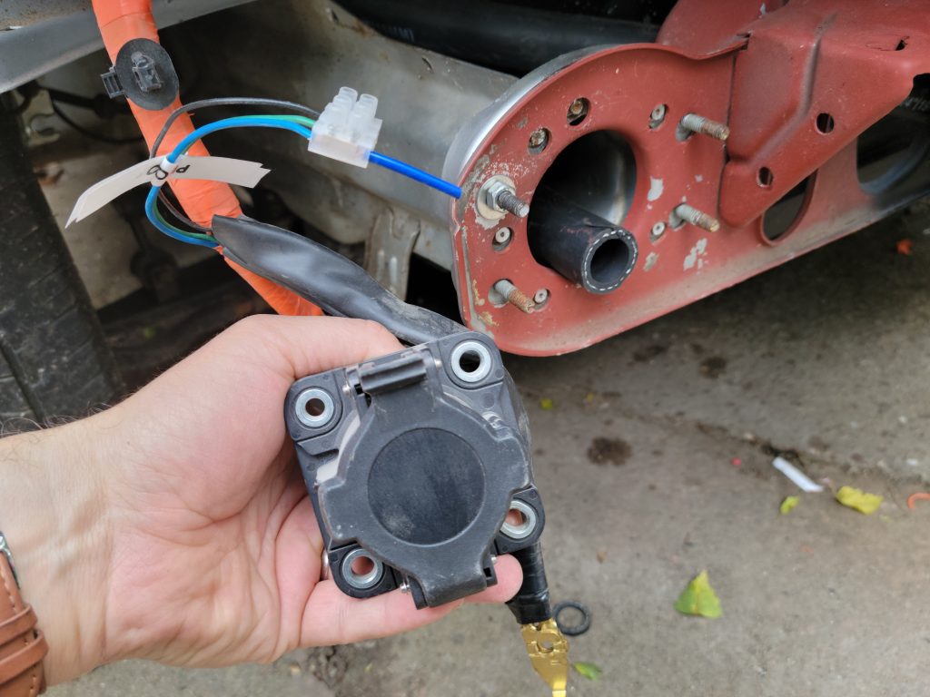

Finally on this monster update, wiring. The HV wiring is largely done, with the exception of the heater. I still need to find space for a box to carry an Arduino, or similar, and contactor, to provide me with sensing and switching for the water heater and pump. And I haven’t yet made up a part to integrate the temperature sensor into the heating loop, though I now have an idea for how to do this.
The last wires I had to make up on the HV side were to carry DC from the inverter auxiliary connection to the charger. Using the same 35mm2 cable for this and it’s just two short runs. I still need to make up some shrouds for the ends of these to keep the inverter and charger better sealed from moisture. Tried a couple of designs so far but nothing I’m happy with. Don’t really want to just dump a load of silicone in there.

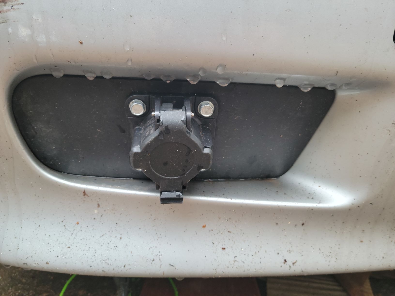

I have decided to mount the charging port in the front bumper for now, in one of the blanked off fog light spaces. It’ll get a little mucky but it’s not like it’s going to be there for long, or like I’m going to be travelling long distances on 8kwh. It just means I don’t need to extend any of the cables. When I do the rebody, I’ll put it somewhere proper.

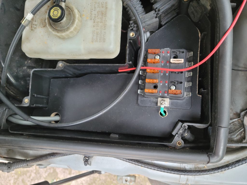

12V Wiring
Absolutely last for this update is the 12V wiring. This is time consuming. And right now, a mess. I’m having to strip back some of the loom I thought was pretty finished in order to get the charger connections in neatly, and also because I have come to the conclusion the stubs on my CAN bus wiring were too long. Very grateful for my gas soldering iron right now, so I can cut and join things in situ.
I’ve done a couple of things to try and make it all a bit neater. First, I’ve ditched the plastic insides of the sealed ECU box on the driver’s side of the engine bay and replaced them with a flat MDF shelf. This will allow me to lay out my fuse boxes and relays nice and neatly, and hide away any unused wires from the original loom. I stupidly painted this before making all the final holes so I will have to pull it out and repaint it at some point.
The second thing I’ve done is start to re-introduce some of the original plastic and rubber wire management pieces, including the shelf/conduit that bolts in along firewall. This needed some trimming in order to fit, but it should keep things nice and tidy.
I don’t want to start wrapping anything just yet until I know it all works. And the AMPSeal connector on my inverter is a total mess, as are the connections to the motor for temperature and position. Lots of work still to do here.

More pics:

And last couple

BUZZING!
It works. It bloody works.
Video here: https://projects.tomcheesewright.com/wp ... 091221.mp4
After a frustrating few days with it sort of working, and some minor mishaps (I shorted something on an unshielded 12v connection – but everything seems to have survived). A firmware downgrade (5.05 to 4.96 if you’re interested) has fixed everything. The wheels spin like a dervish now and the motor makes an absolutely wicked noise. My homebrew coupler seems to be doing a decent job too, much to my surprise and delight. I was expecting a lot of vibration and clanking! The clicking you can hear is a loose brake flexi pipe clacking against the wheel (whoops).
Needless to say, my daughter and I are absolutely buzzing. We’ve spent the whole day talking about the all the fun cosmetic bits that now feel much closer.
What’s been done since the last update?
  • Wiring is all finished apart from the fact I need to take the last chockblock out. I’m now confident I have the resolver wired in correctly
  • I’ve tried and failed to calibrate the temperature sensors in the motor by taking resistance readings while pumping through oil heated to a known temperature (and probably ruining a rice cooker in the process). I just couldn’t get stable enough temperature control, and it turns out my oil pump is massively overpowered for the purpose, emptying the rice cooker in just a few seconds.
  • I’ve torqued up all the front end bolts, and finished refitting the propshaft
  • I’ve completed the refurb on the rear calipers
  • The charge port has been installed in the front bumper
  • Discovered the only problem with the electric hood is a flaky switch

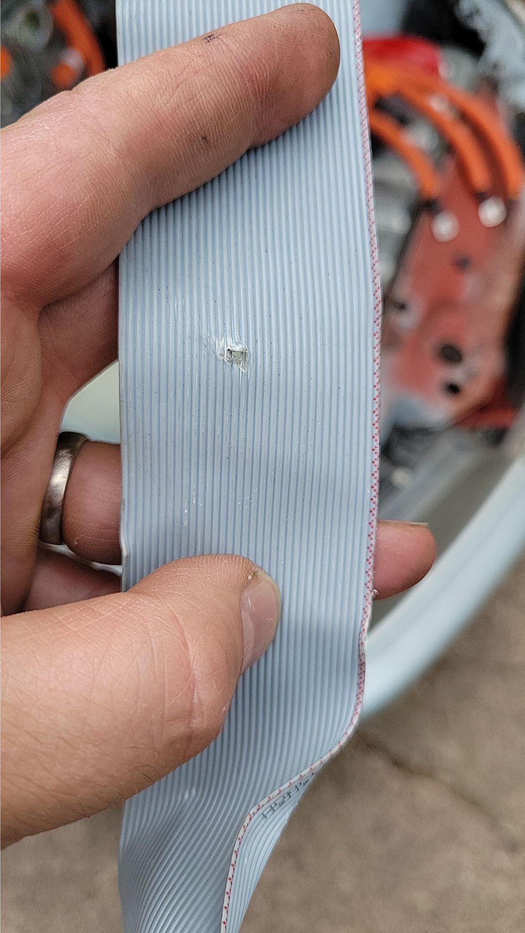

  • I’ve changed out the Prius control board (number four?) as I was getting some wonky readings. Turns out this was probably the firmware, but hey, it works now.
  • In the process, I managed to put a hole in the IDC cable that connects the board to the outside world and had to make up another one to keep testing while I waited for a replacement. You see! It’s good that I was still hoarding three old floppy disk cables!

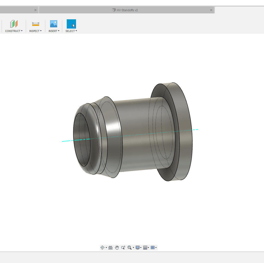

HV disconnect
I need to add a safety disconnect for the HV, as at the moment if the contactors welded themselves shut (something I’ve already done to one set) there would be no way to disconnect the battery without a spanner. Still deciding which model to go for, or whether to make one (they are damned expensive – £100-150 for some plastic and copper). This will be bolted on to the side of the battery box.
First sketch of a possible homebrew design in the images below - this one is very flawed but I'm working on a V2.
Relocate the radiator
Dumbass here forgot about gravity, so unless I’m going to seal up the steam pipes on the radiator and add a header tank, I need to move the radiator.
For now it will get mounted where I was originally planning, in front of the charger and inverter. But first, I need to…

Complete rear axle fitting
I had to destroy four allen head bolts to remove the read axle assembly. The first replacements I ordered based on a recommendation from the forums were the wrong size. Second set fit much better. Need to get these in and then get everything torqued up.

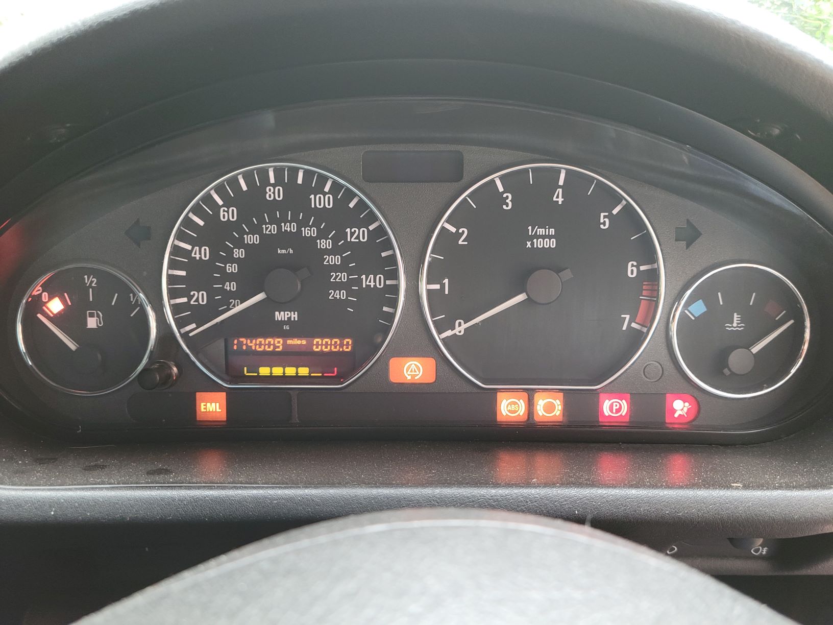

Turn off dash error lights
Various error lights on due to lack of ECU/brake system in pieces. This will take some diagnosis. Still not sure which lights are controlled by CANbus and which (most, I think) by direct 12v signals.
I’m hoping that once the brakes are all reinstalled, all the brake related errors go away, but I suspect the ABS may need a little more than that. Then it’s the EML, which I don’t *think* is an MOT failure, but want to fix.

Reroute oil cooling pipework
There are two outlets on the bottom of the motor for oil. I picked the wrong one. So now need to relocate my oil cooler and replumb the system – slightly complicated by this needing different-sized hoses and hence me needing a different-sized connector on my oil cooler. Unless I bodge it together…
Per the note at the start about calibration, I could also do with a controller for the oil pump. This is likely to be as simple as possible for now. Adding in a way to get an external temperature probe in for calibration wouldn’t be a bad idea – maybe using the spare outlet.
Also, when I was trying to calibrate, it leaked like a sieve. So I need to check gaskets and nip up some bolts.
Seal charging port
The back of my charging port is currently more open than I would like. Need to remove it to finish the design I have for a cowling that will fit the rubber boot currently on the cable.
Fix power steering return
My homebrew return line for the power steering fouled the bottom of the battery box. I’ve trimmed the battery box support bar but I still need something a bit lower profile.

Fix my crap repair
One of the first repairs I did on the car was on the inside front of the sill behind the offside front wheel. It’s crap and needs redoing. I don’t think it’s structural but I don’t need to give the testers anything else to complain about.
