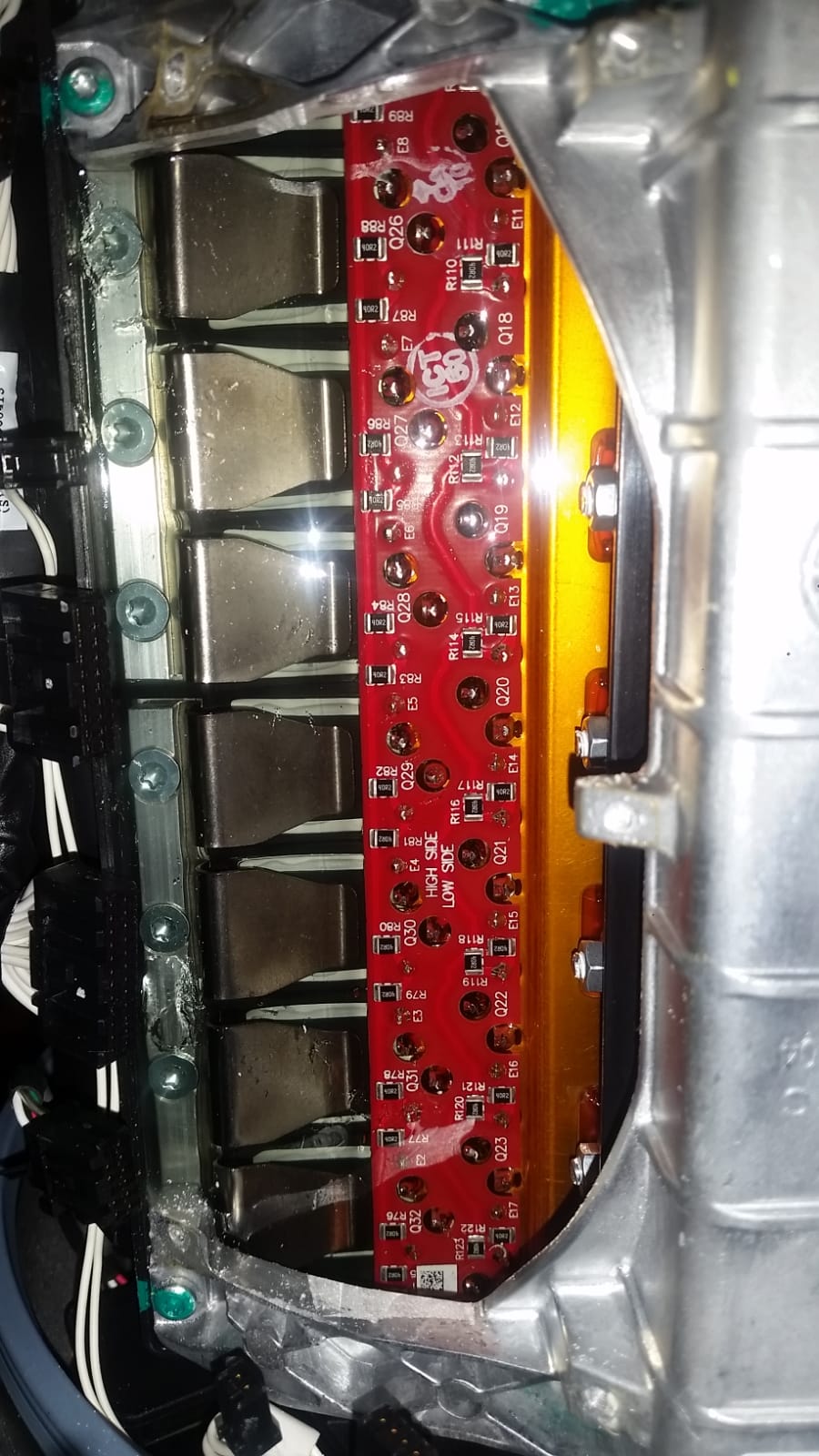

I have also a 25s 33p Tesla Model 3 Battery Pack ~96V and 158Ah. I have the Idea To Split The Pack in have and Conect these to a 50s 16p ~192V 75Ah. I Will Update the Capacy Later when i became a good Pack.Actual i think as Daily Driver is 14,4KWh enouth. It Needs A Box under The Bus and a BMS.
I Have Calculated that on 192V @50KW i have a Current of 260A what equals 16,27A on each Cell or ~3,4C. That i thik is OK for the Cells. But its only 192V/1,41=136Vrms i am not sure that i calculatet right.

Post by tollerteppich »
I got over the first shock tonight, I think.
I took a close look at everything this morning.
it gives the impression that there are only air bubbles.
the surface of the gel looks undamaged everywhere, that gives me hope that there are only air bubbles from the production.
Maybe jon volk can take a look at whether it looked exactly like that with him or whether it is different.
i took pictures and a video where i shine with the lamp from different angles.
I don't know exactly how to proceed.
Should I try to exchange the motor or give it back?
or to try to let it go first. Unfortunately I don't have the plug from ZeroEV yet.
if it is really broken and i don't get it exchanged i have turned a lot of money into smoke.
i checked the mouser website. The IGBTs alone cost around € 460 if all 96 pieces are identical. in such a case I would swap everything. questionable whether this is mechanically possible or whether the IGBTs are ultrasonically welded or something. i don't know i'm watching damien's teardown video.
a lot of questions ... it's really annoying.
i underestimated the emotional differences, from euphoria to excessive disenchantment. it is violent ...

It's the coppery throwout that looks scary. Did it come like this or did it happen to you?
With a multimeter in diode mode you can make some simple checks. You put positive lead on phase leg and negative on positive DC terminal. That should give you 0.3V diode drop. Likewise negative on phase rail and positive on DC-. Blown IGBT usually short circuits this path and you get 0V.
