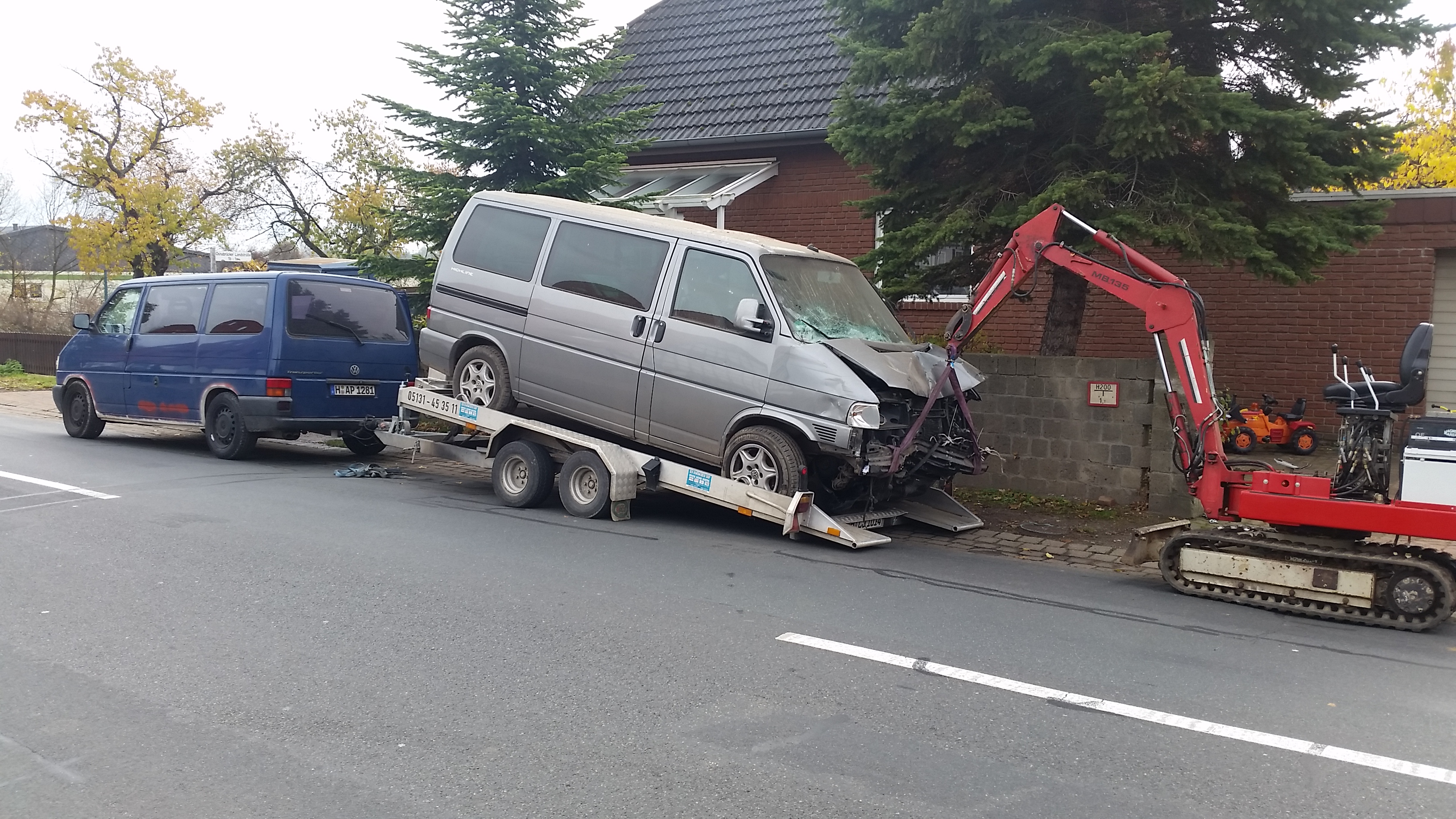

I have an 2001 VW T4 Highline Bus Its Front is a Litle bit Crunshi but i have all Frontparts Allready. I want to put in a Tesla Drive Unit. Original the Car has 75Kw (102PS). 50KW is ok For me.

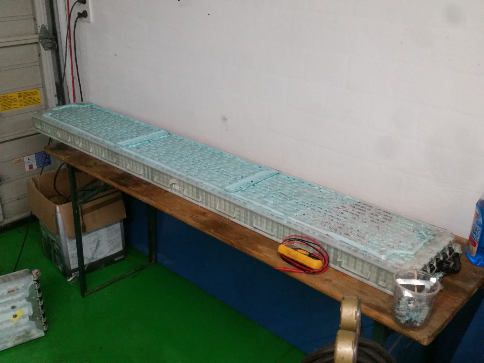

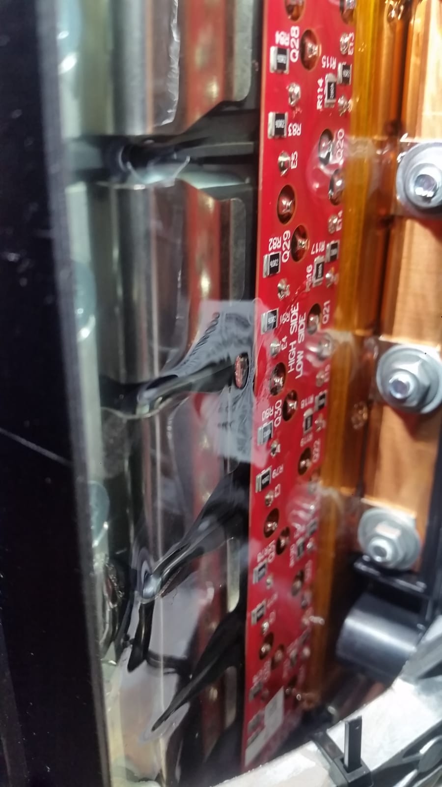

I have also a 25s 33p Tesla Model 3 Battery Pack ~96V and 158Ah. I have the Idea To Split The Pack in have and Conect these to a 50s 16p ~192V 75Ah. I Will Update the Capacy Later when i became a good Pack.Actual i think as Daily Driver is 14,4KWh enouth. It Needs A Box under The Bus and a BMS.

Jes the Highline is my Dreamcar, since 2010 I've only been driving T4 buses, it's my third bus. A friend had an accident with it and fatally injured someone with it, mentally he couldn't do anything with the bus and almost gave it to me for free. it has leather seats, two zones, AC back to back seats and a sleeping bench.
The right longitudinal beam must be straightened by 25mm and the lower window frame must be replaced.

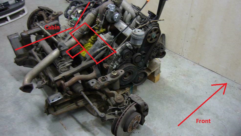

is the front engine possibly better suited due to the design? a 3d model i have only for the LDU.

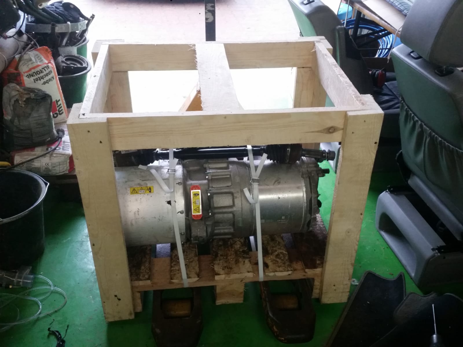

You can turn the LDU backwards if you need to. You'll just need a 'reverse oil pump' from ZeroEV.
viewtopic.php?f=11&t=210 Should have some good info on running the unit backwards.

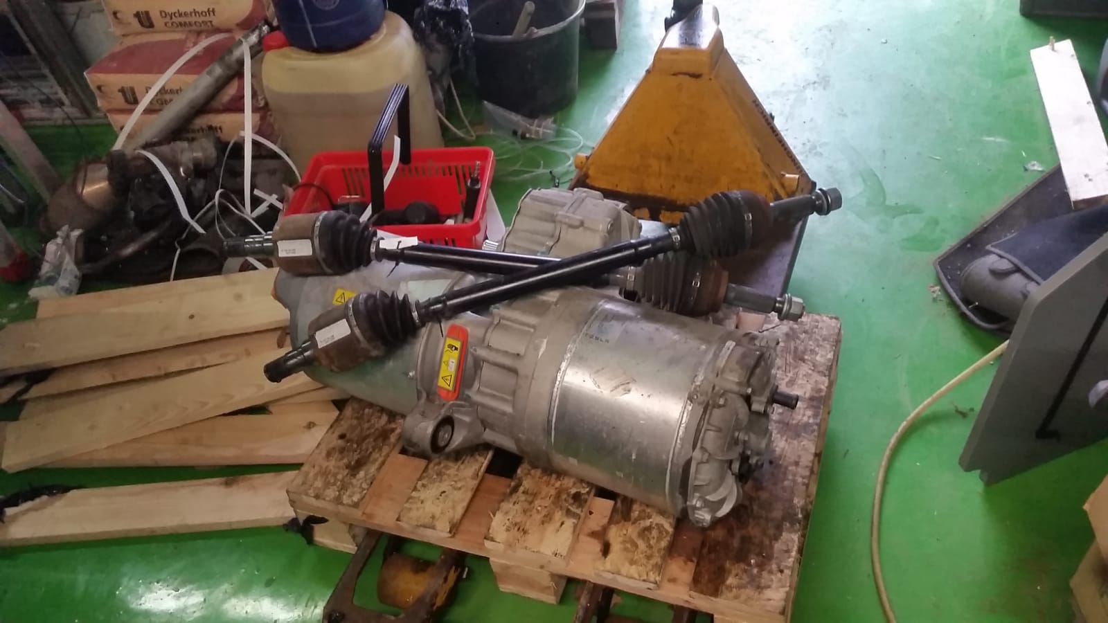

Do you happen to know what to do with the gear bearings?
The transmission is only designed for 15kmh in reverse. and the helical gears then push with full force in the other direction.
Do you know which bearings are installed or where you can get the information?

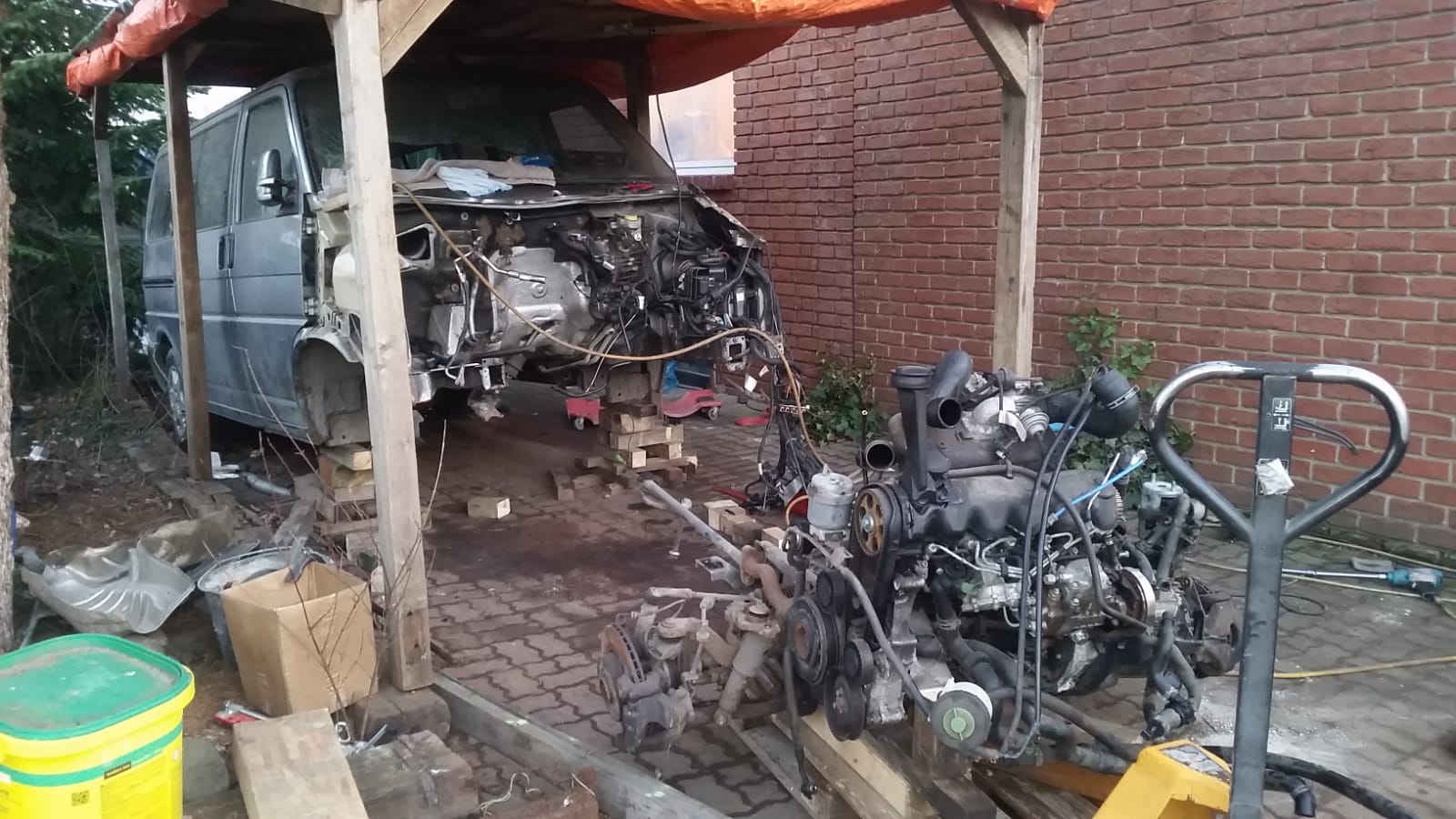

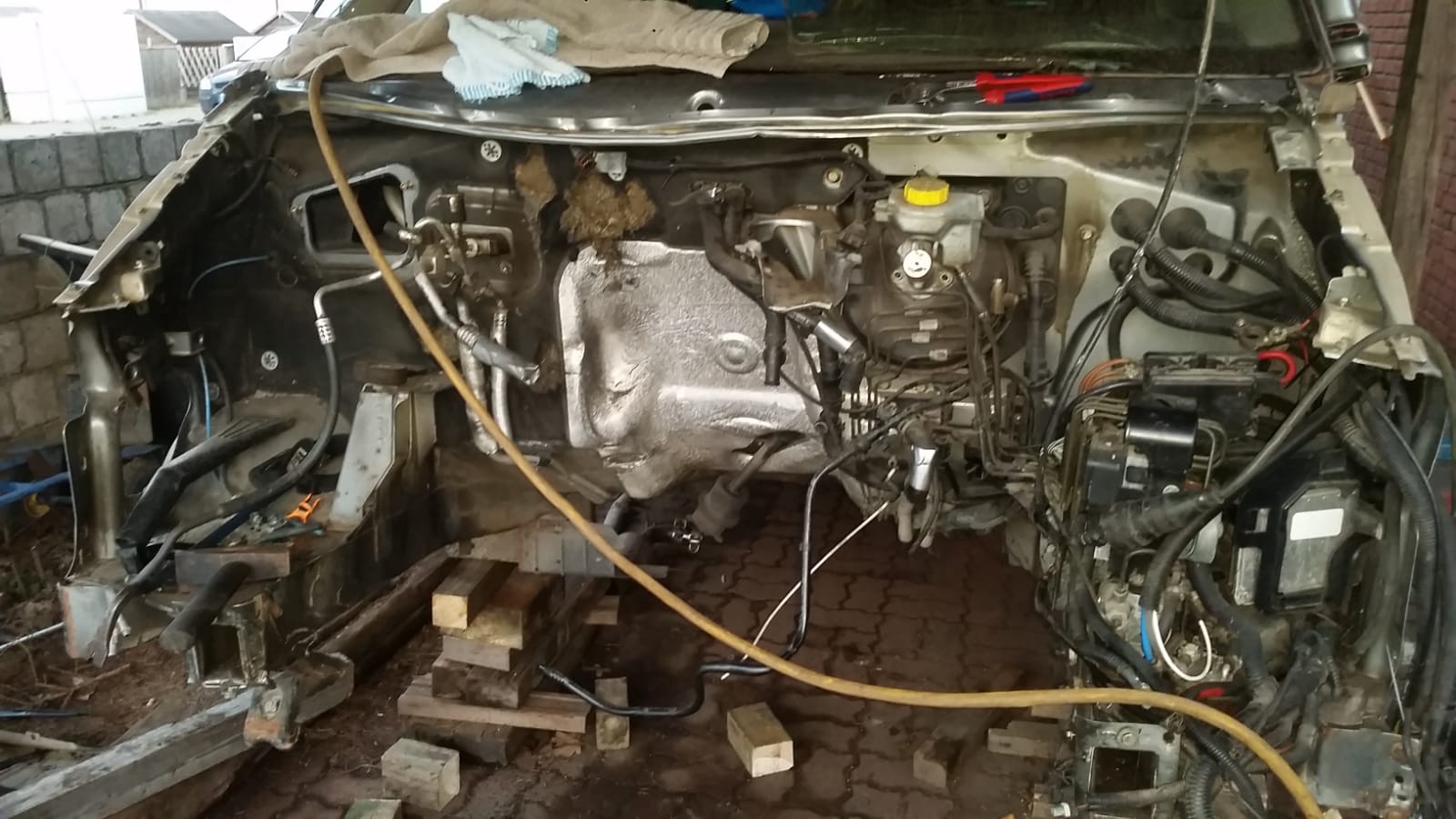

The conversion started yesterday, the next thing to do is to straighten the body.
Maybe I'll have a company do that or someone who has done it many times.
I have to do the removal of the axle / motor on the donor vehicle Nr.2 again. :lol:

tollerteppich wrote: Thu Feb 25, 2021 9:23 am Do you happen to know what to do with the gear bearings?
The TESLA stuff has been run in reverse rotation with success and for extended periods, the bearings are not the real concern, the lube pump IS. With the lube pump running backwards, no oil is delivered to the critical areas, which is why you need to change it as suggested above.

As mentioned by Isaac, I’m running a LDU in reverse with zeroEV oil pump.
I’ve done 5000 miles like this with absolutely no issues.

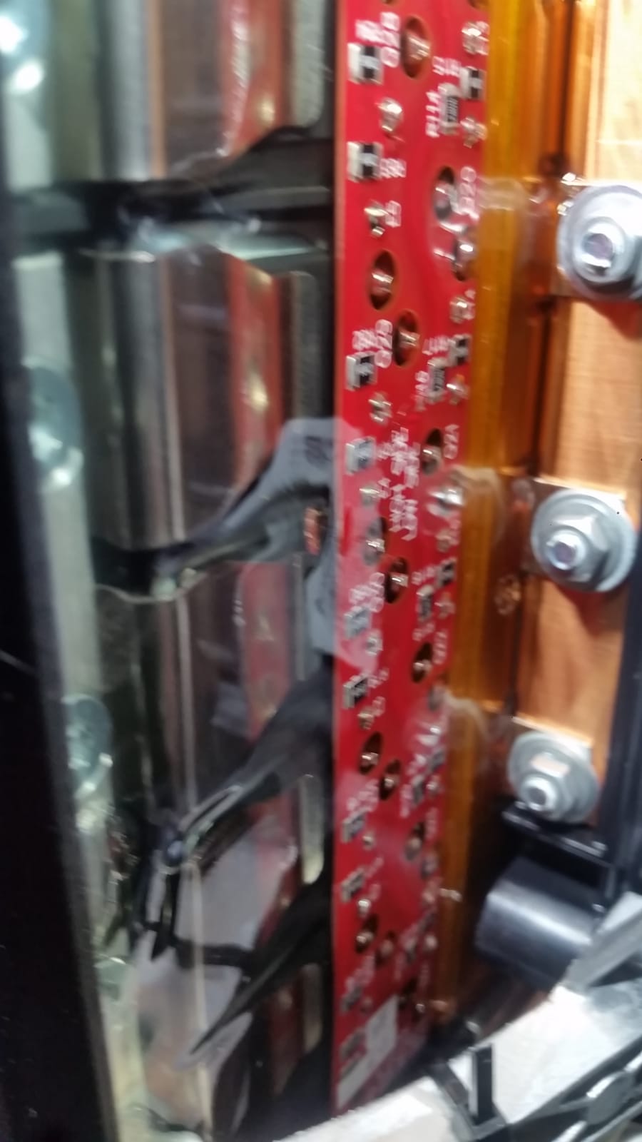

Has anyone of you ever bought a complete Model3 long range battery or has information about prices outside of Germany?
Are there good sources in Holland (4h away)?

muehlpower Thanks for the information of the bearings.
ok is that a provider from Koblenz? : D how satisfied were you with the purchase of the battery?
Did you install the battery in one piece or did you dismantle it?
what of the built-in technology were you able to use? Charger determined? the BMS too? what did the control cost you in total?
I would prefer to continue using the M3 battery as it comes only in a housing that fits under the Bulli.
Unfortunately I didn't see any cables on the LDU that he sells.
I ask because of that because 8500 is a lot of money for me. the same provider also has the LDU for 2500 and I will ask him for a package price if you were satisfied with him.

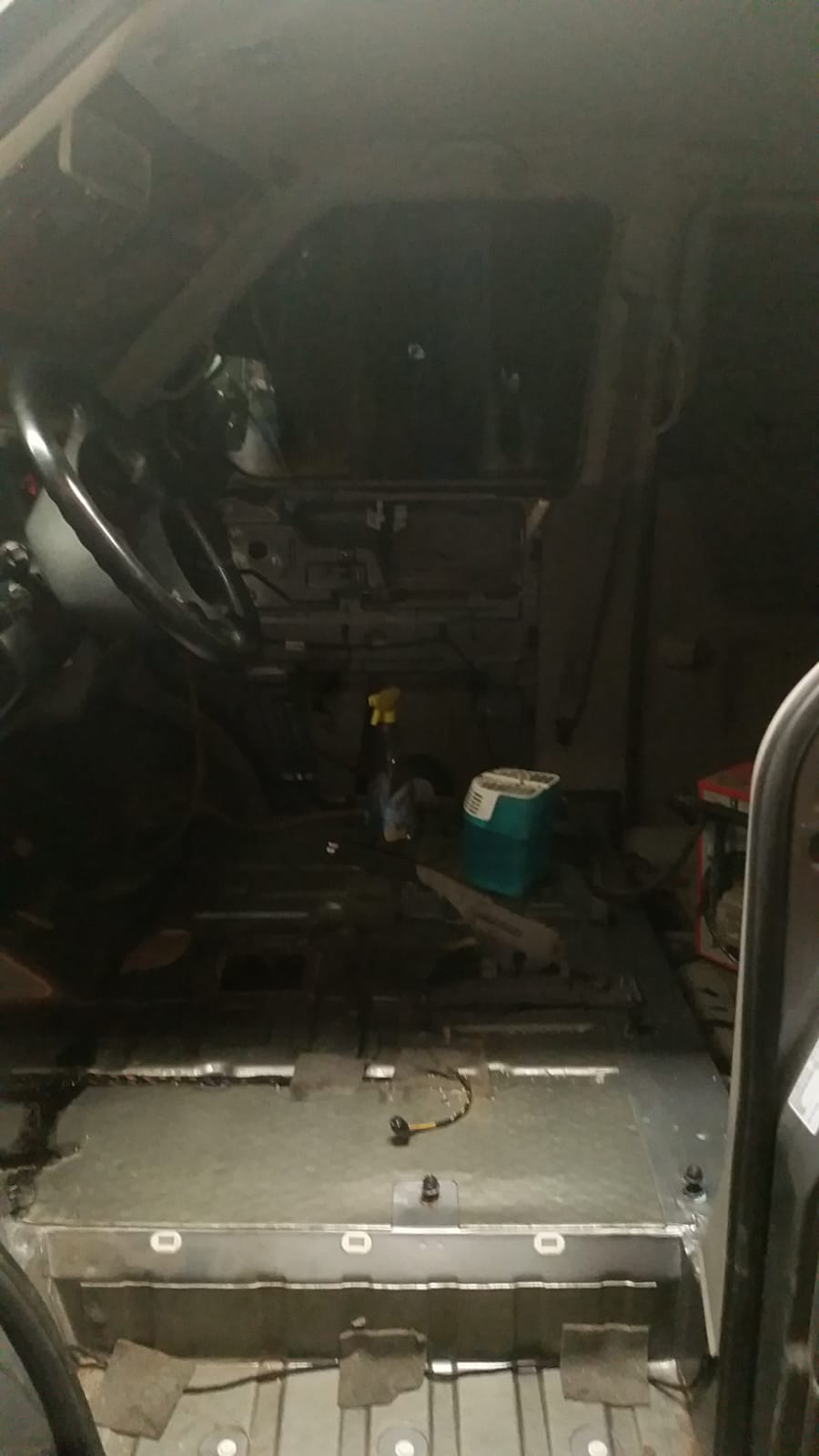

my goal is that little or nothing changes in the interior. no battery inside.

The LDU finally arrived yesterday.
I also got drive shafts together for 2700 €, but the motor cables are missing.

Today I removed my 63KVA generator with a 10L truck engine from the yard in order to get to the front axle of the second donor Bulli.
The 151PS TDI Engine Died in April 2017 https://www.youtube.com/watch?v=dUD97yN07K0.
No this is not the option for long journeys :D
it was too cheap not to buy. And Run how a Swiss Clock.
https://www.youtube.com/watch?v=9_c4gBOmlGU&t=72s
I put it on to my new storage Space, that i am build at least.

The board arrived today.
I then quickly built a holder for the engine stand.
Soldered the plugs. So far so good.

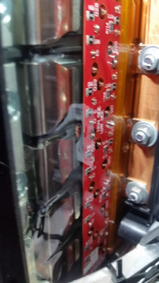

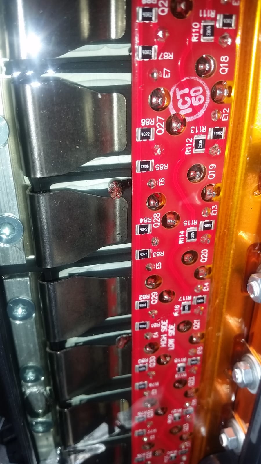

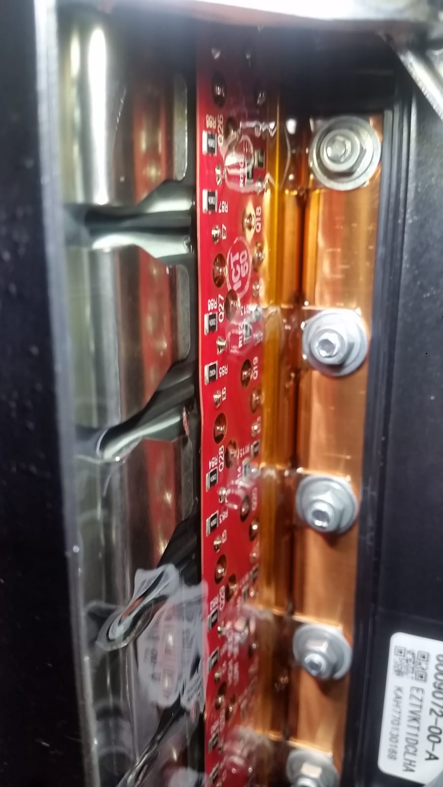

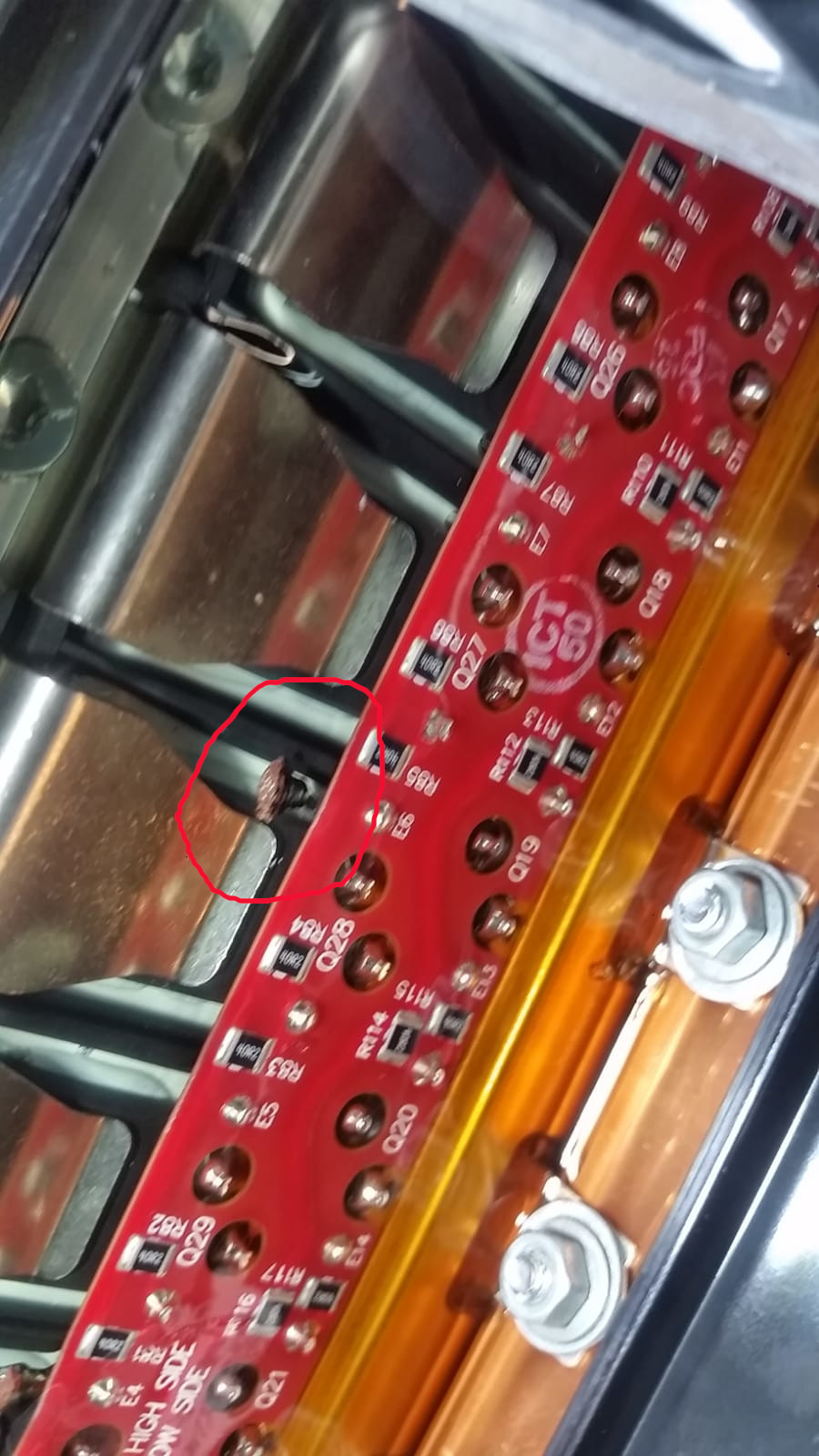

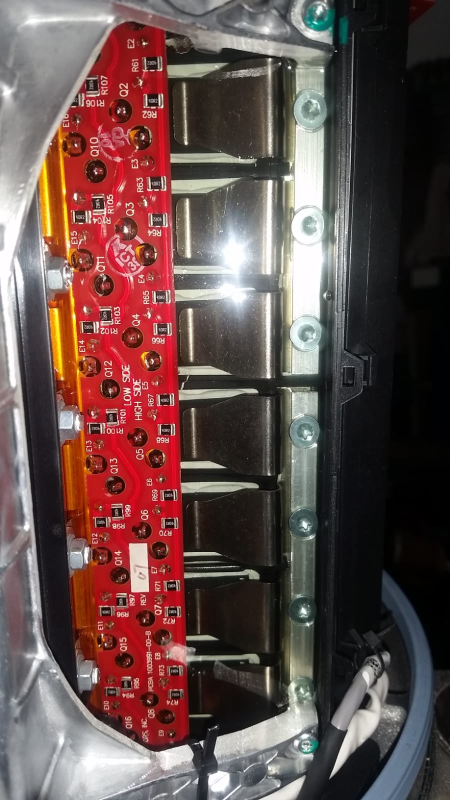

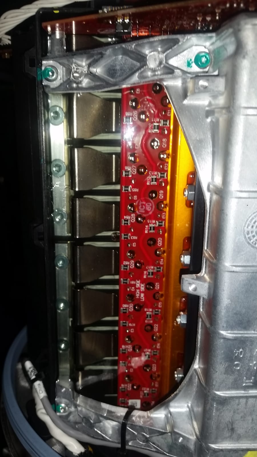

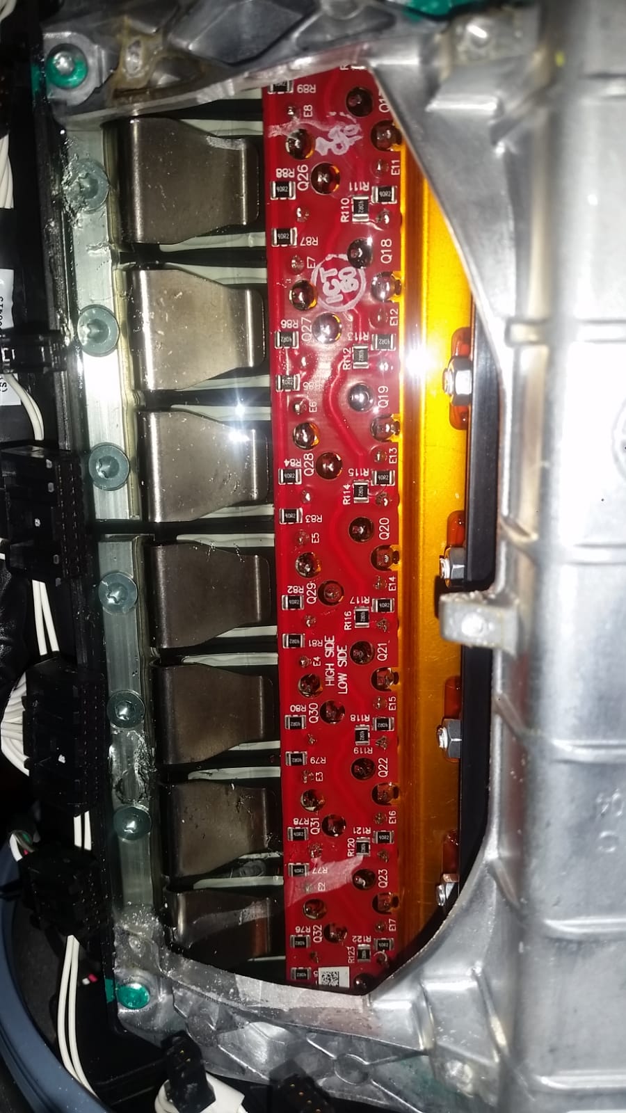

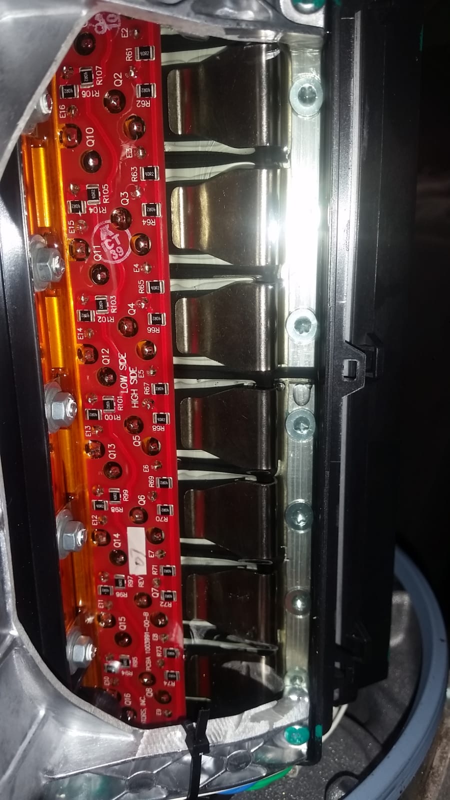

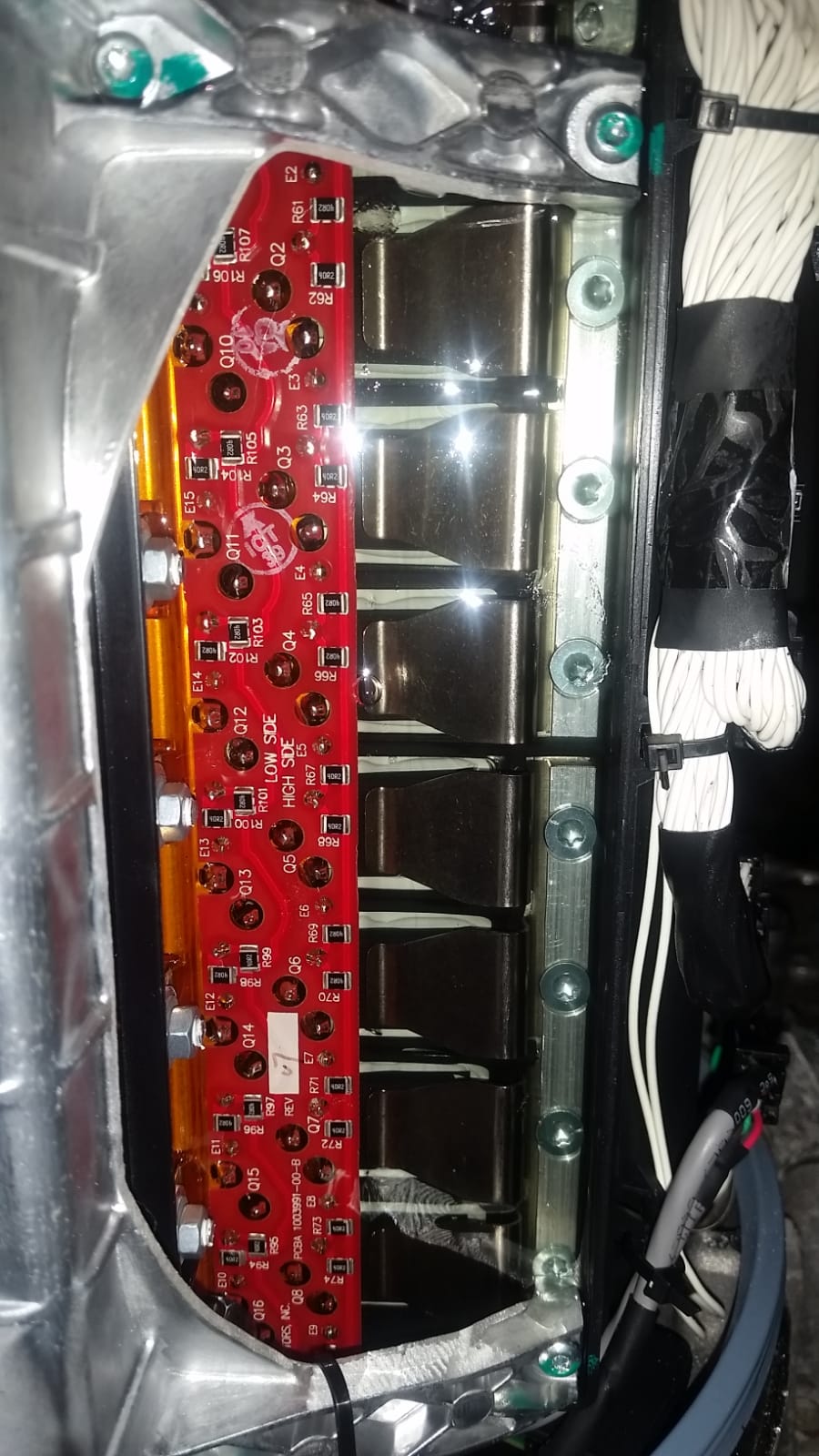

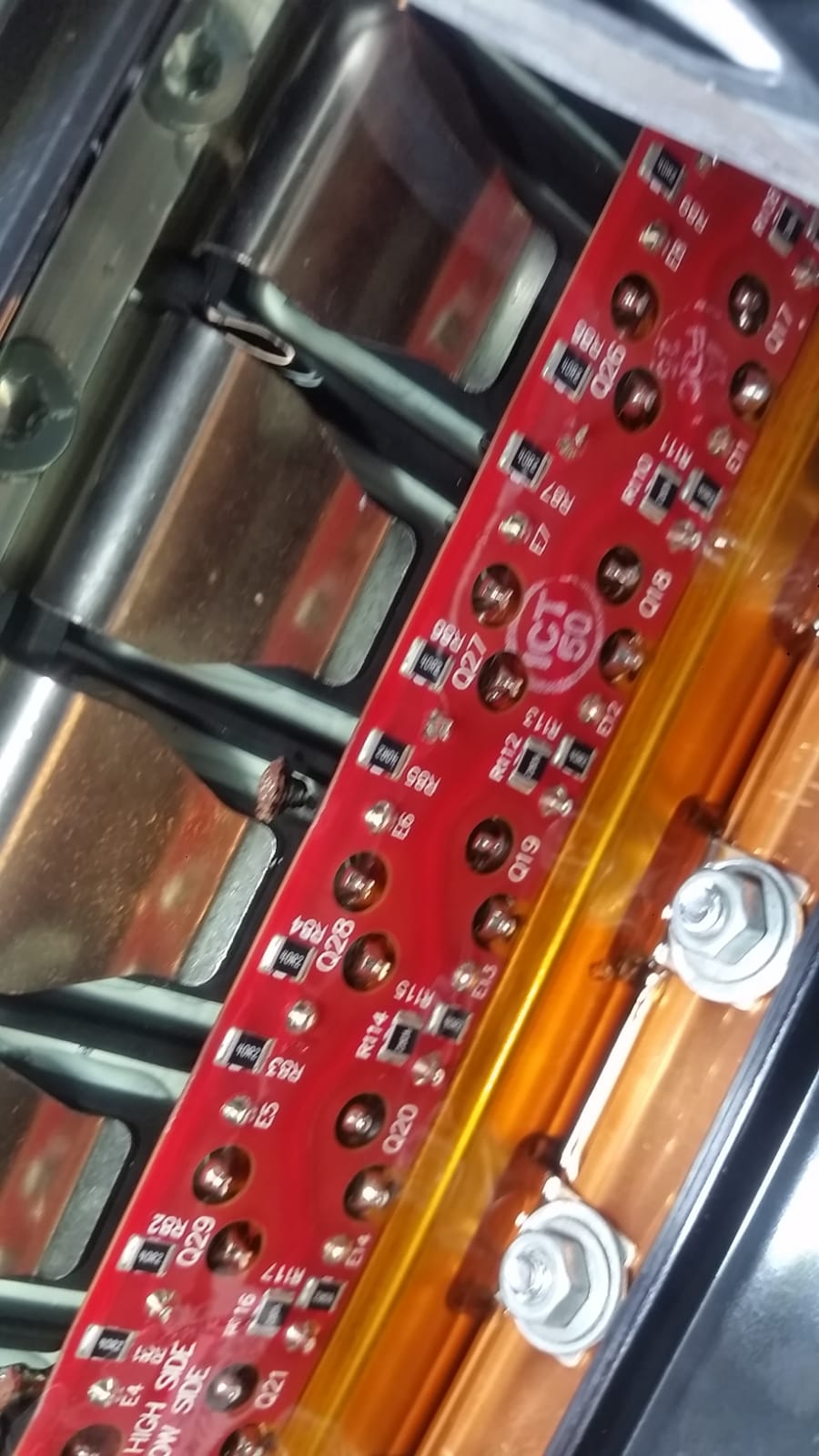

I just looked at the IGBTs after seeing a picture on page 2 in the LDU Threat.
Phase 1L
Looks OK
Phase 1R
Looks OK
Phase 2L
Looks like a blown IGBT in the middle
Phase 2R
Looks like a Air bubble in the middle
Phase 3L
Looks like 2 blown IGBTs
Phase 3R
Looks OK
It looks like life fucks me hard
what is the best way to go about checking the functionality?
test with low voltage i seen. witch voltage is good for save begin ?
I have the following power supplies available:
0-15V 40A
12V 40A
24V 40A
56V? 60A?
Model3 battery 96V
clear first structure according to the circuit diagram when I have the connector

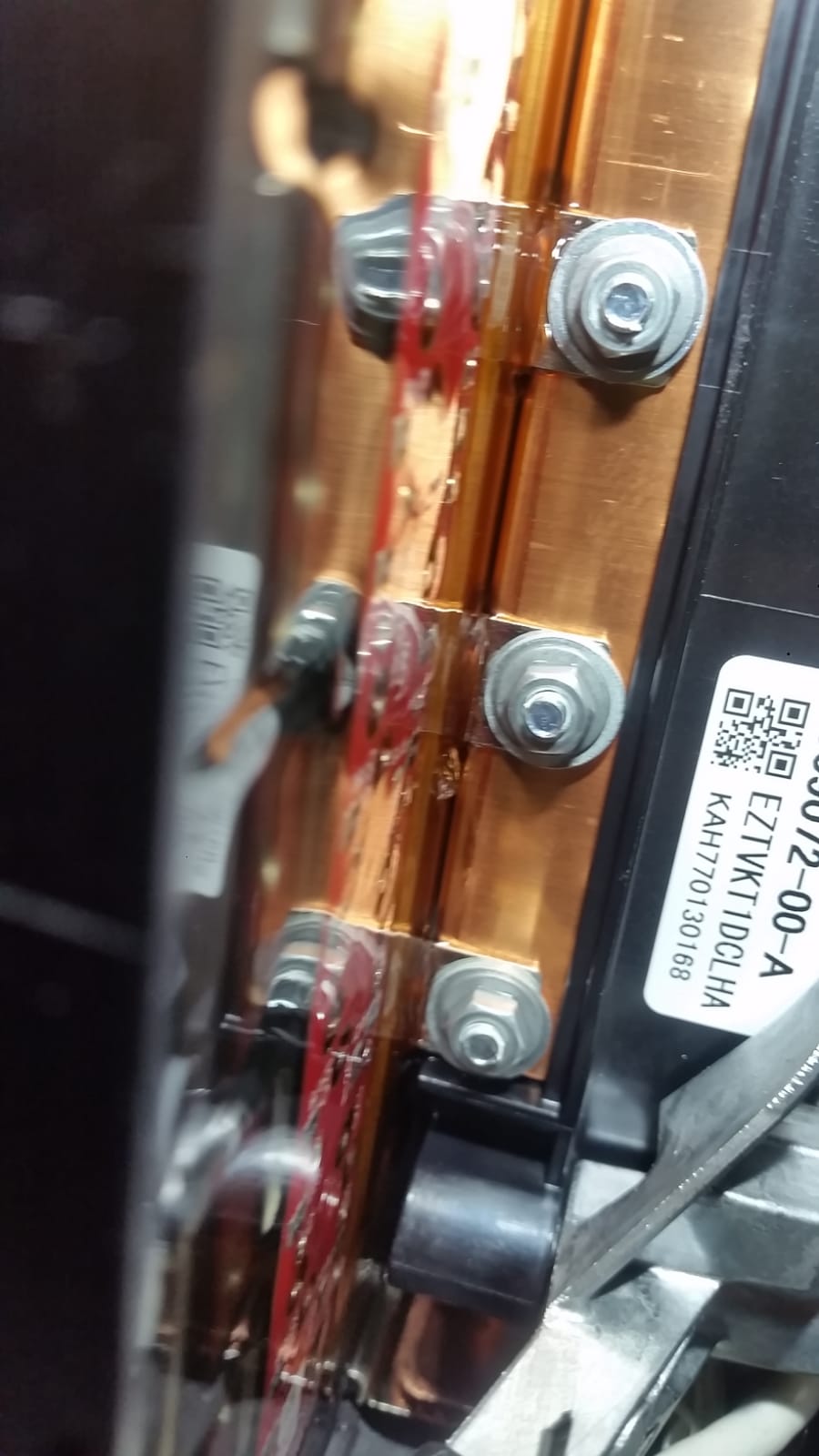

I got over the first shock tonight, I think.
I took a close look at everything this morning.
it gives the impression that there are only air bubbles.
the surface of the gel looks undamaged everywhere, that gives me hope that there are only air bubbles from the production.
Maybe jon volk can take a look at whether it looked exactly like that with him or whether it is different.
i took pictures and a video where i shine with the lamp from different angles.
I don't know exactly how to proceed.
Should I try to exchange the motor or give it back?
or to try to let it go first. Unfortunately I don't have the plug from ZeroEV yet.
if it is really broken and i don't get it exchanged i have turned a lot of money into smoke.
i checked the mouser website. The IGBTs alone cost around € 460 if all 96 pieces are identical. in such a case I would swap everything. questionable whether this is mechanically possible or whether the IGBTs are ultrasonically welded or something. i don't know i'm watching damien's teardown video.
a lot of questions ... it's really annoying.
i underestimated the emotional differences, from euphoria to excessive disenchantment. it is violent ...
When accelerating, the tears of emotion must flow horizontally towards the ear.
Walter Röhrl
Been thanked: 1913 times
Re: What Drive Unit is the best for Me ?
It's the coppery throwout that looks scary. Did it come like this or did it happen to you?
With a multimeter in diode mode you can make some simple checks. You put positive lead on phase leg and negative on positive DC terminal. That should give you 0.3V diode drop. Likewise negative on phase rail and positive on DC-. Blown IGBT usually short circuits this path and you get 0V.
