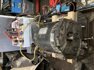

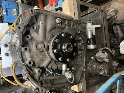

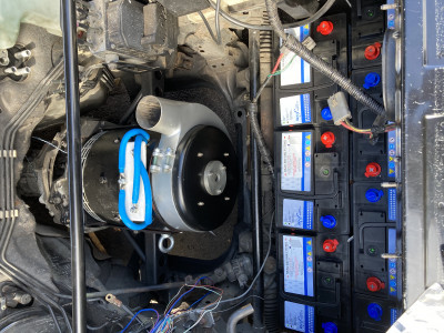

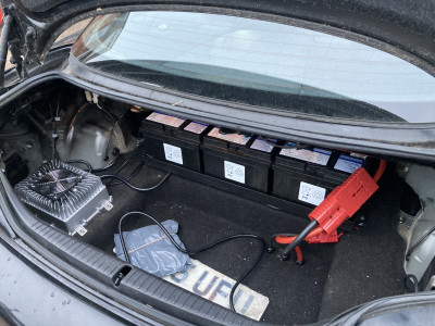

Hi all Welcome to my budget RX8 build thread, I’ll start by highlighting the budget theme, so don’t expect any Tesla parts here, if it wasn’t super cheap, free or I could build it myself it pretty much hasn’t been an option, it started of as and attempt at Damiens €1000 build bit is now progressing to include to use of bmw phev battery modules I have managed to get a good deal on,
Spec as built was:
13” series wound dc motor, new brushes bearings and armature balanced to 6000rpm
Direct coupling to gearbox
13 x 75ah flooded lead acid batteries (always destined as proof of concept only)
Prius gen2 dc dc convertor salvaged from a damaged £20
inverter
Chinese 3.3kw charger
Home built igbt chopper motor controller evbmw driver board arduino uno controlled logic
Ev8

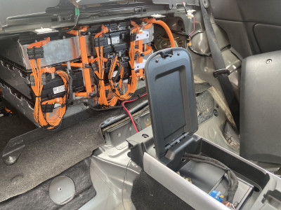

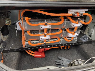

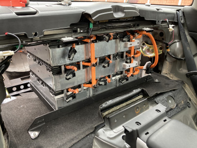

Currently I am working on battery boxes, bms and building a paralleled pack out of 3 complete bmw 330e phev hybrid battery packs total of 15 modules arranged 5s3p for a total of 24ish kwh
Ev8
Posts: 835
Has thanked: 44 times
Been thanked: 173 times
Re: Budget RX8 build
Post by Ev8 »

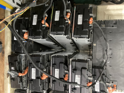

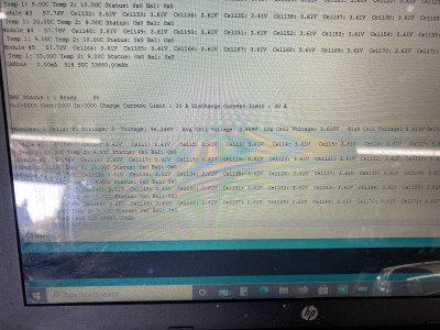

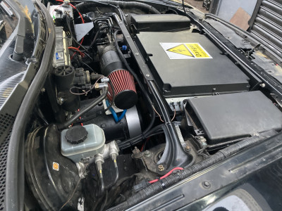

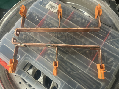

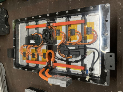

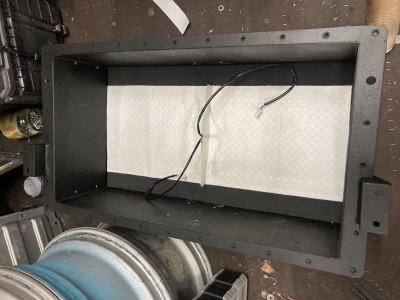

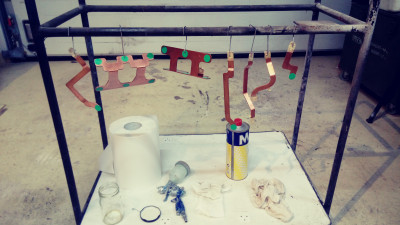

So work on the battery conversion has been ticking along, and the front pack is done and ready to be mounted, I’m using bmw330e modules 3 whole packs worth in a 3p5s configuration, paralleled at a module level with big bus bars using the original connectors soldered on, also paralleled at the cell tap level so each 3 modules is on one cell monitoring slave, have tested on a quick and dirty stripboard simp bms and everything is behaving

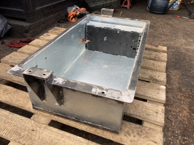

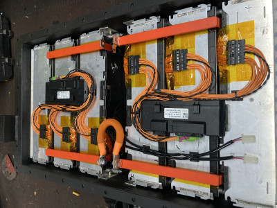

Have been working on mounting and connecting the last 9 bmw modules, still to finish the bms wiring and re mount the charger before I can test things

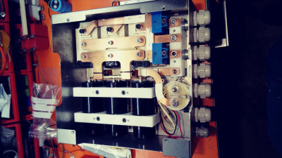

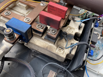

So the battery upgrade went well and all seemed to be working fine, when the controller popped, ultimately my fault as I was changing so stuff in my controller code, change...test...change...test....change, forget to let precharge complete before mashing the throttle to hit current limit main contactor closes inrush current pops the 2 drive side igbts and takes out the gate driver board also.
So aside from having to rebuild the controller and add an interlock with a small delay to the auxiliary contact, first impressions of the battery upgrade amazing!

If you want to make DIY power section you need to have:
a) desat protected drivers so you can calibrate your dead time and boost.
b) You need to stack DC rails and phase outputs as much as possible.
check this out...This one lasted for a year or so... https://mazdamx3ev.wordpress.com/2015/0 ... r-za-300v/
Then we designed proper DC rails. 3 years uninterrupted driving with Mazda DIY inverter speaks for itself.

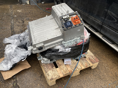

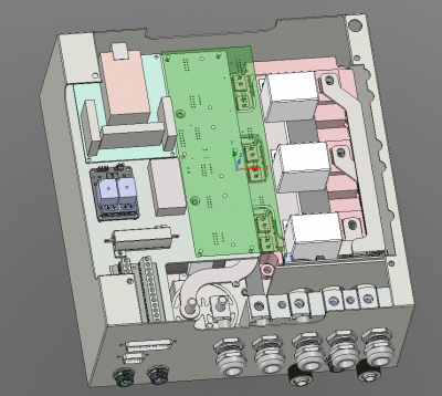

So, as a result of the magic smoke coming out I have decided to give making a dc controller from a Prius gen2 inverter a go, it would appear a few have tried and failed before me, specifically burning out the low side igbts, so I have a crazy idea about just using the all of (mg1&2) paralleled high side igbts for switching and then use a monster diode module mounted where the boost inductor would be as a freewheeling diode, effectively building a high side chopper rather than an half bridge, watch this space.,.

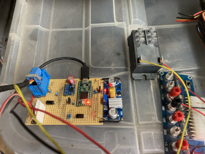

I have built a written code for a prototype board, with a teensy 3.2 microcontroller, incorporated mg1/2 control, current feedback from Toyota hardware, mg1/2 fail status, contactor and precharge control, brake and reverse switch inputs allowing different throttle profiles and current limiting in forward and reverse, 700amps and fast throttle ramp was interesting in reverse with the old controller! Oh and a temperature gauge driver, cos why not
Will release code and schematics when tested, but that won’t be for a while as I’ve just had elbow replacement surgery!

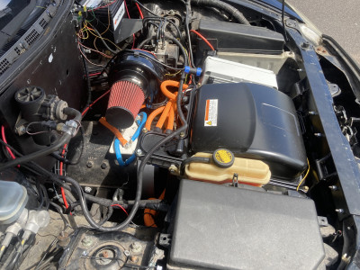

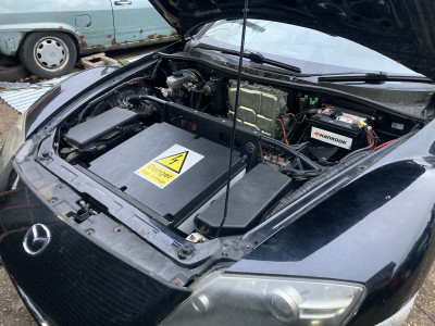

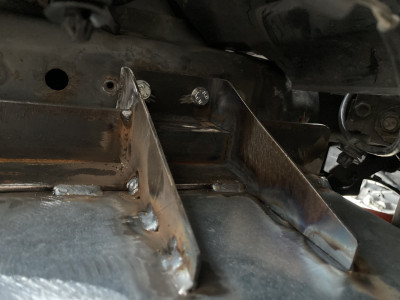

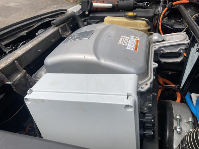

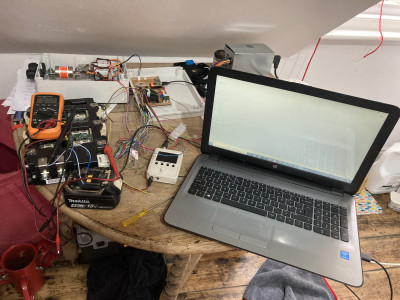

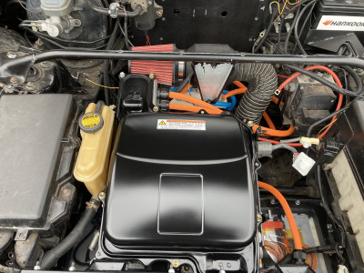

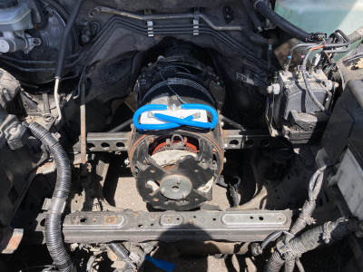

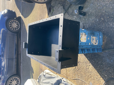

So a smallish update is probably due, just before my surgery I got a frame built to physically mount a gen2 inverter under the bonnet, and started a new box that’ll bolt on the side housing the positive contactor, precharge etc and the prototype board I have built to control it all. I have now got to the point of bench testing systems and things are going ok well I have control over mg1 and mg2, able to read current sensors, temperatures, voltages and fail pins, other inputs include a bms interlock, brake and reverse switch inputs, code includes different throttle ramps, rpm limits and current limits for forward and reverse modes, hopefully I will get to install into the car in the next couple of weeks
LRBen
Posts: 608
Location: Somerset, UK
Has thanked: 122 times
Been thanked: 290 times
Post by LRBen »

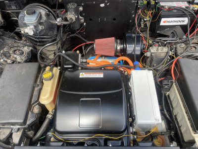

That inverter cover looks really tidy with a bit of paint on it. Might have to get the rattle can out for mine this week.
Just out of interest whats the air intake for?

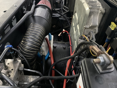

Ev8
Posts: 835
Post by Ev8 »
The fan cooling the big DC motor underneath! This is a Frankensteined gen2 dc controller
Ev8
Posts: 835
Post by Ev8 »
I just can’t help myself from painting things!

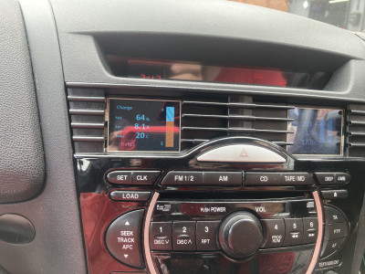

Ok a bit of a update, I have finished the gen2 Prius inverter as a DC driver install, upgraded my motor cooling fan and charged the battery pack, have just completed an 18.5 miles test drive to shake it down, inverter is behaving well but I need to work on my code a little as the throttle limiting based on current doesn’t work great and it seems to often overshoot and hit my hard current limit,
Simp bms seems to freek out and reset battery SOC to 100% if I go over the 500amps range of of the current sensor, need to look at that
Also the teensy controlling the bms decided to stop working and melt down literally could cook on it! No idea why this was the main reason for the test drive being only 18 miles

Post by Ev8 »

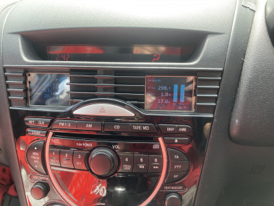

More testing today, I have replaced the teensy and found an issue with a short on the bms board, changed some things in the bms software to stop the strange behaviour under high load, no more resetting soc to 100%
I have managed 33miles of testing including an 80mph cruise, battery soc is down to 52% so hopefully I should see 60 miles range which seems pretty decent for 22kw worth of used bmw phev modules given that dc motors aren’t exa the most efficient!
