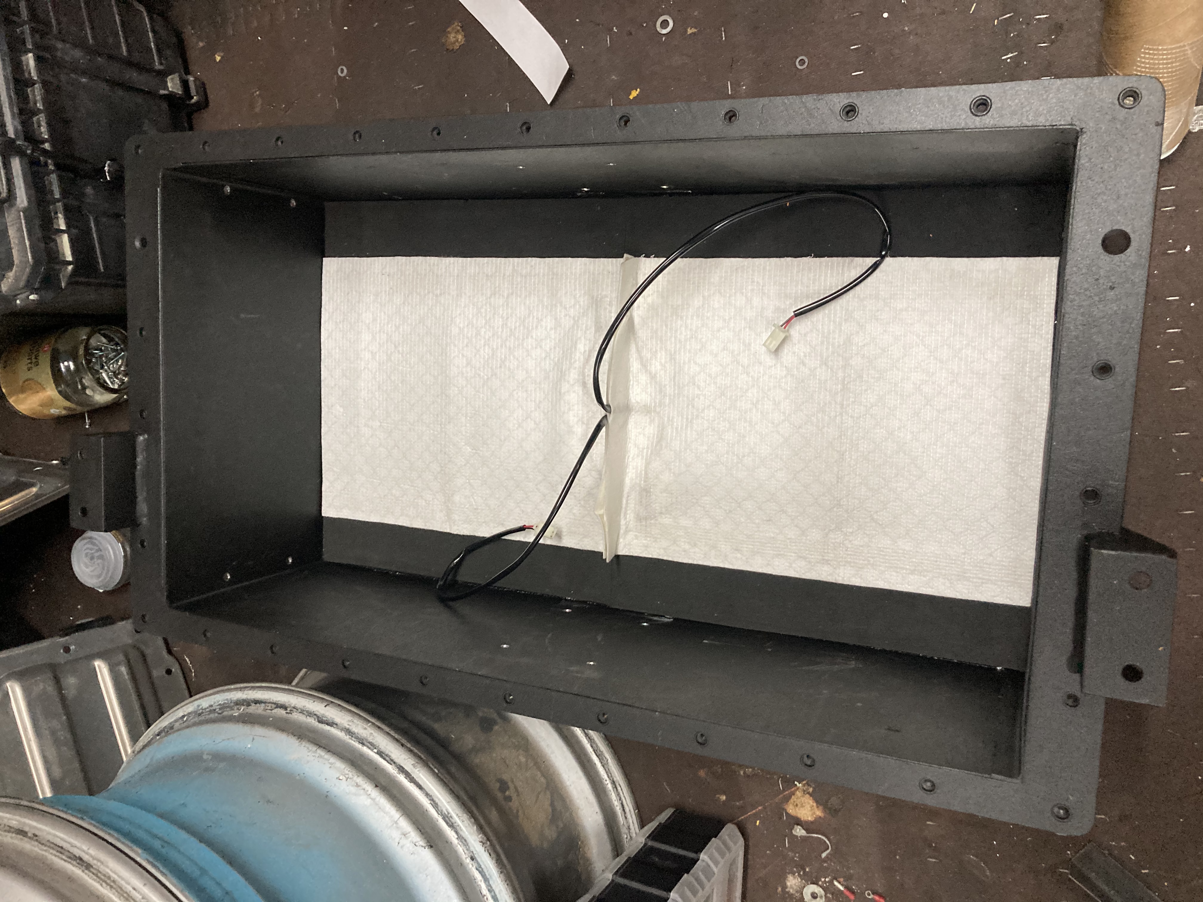

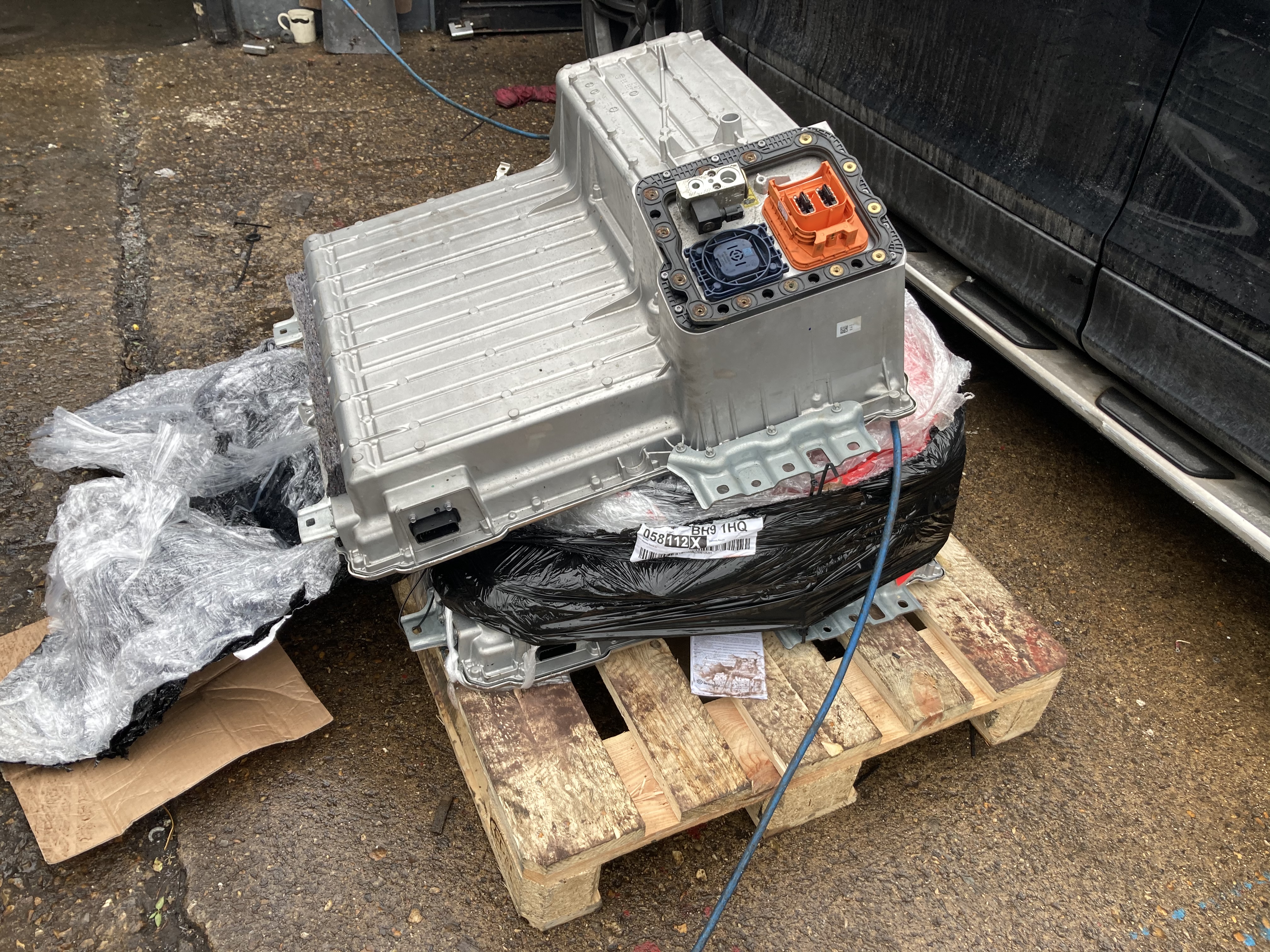

Currently I am working on battery boxes, bms and building a paralleled pack out of 3 complete bmw 330e phev hybrid battery packs total of 15 modules arranged 5s3p for a total of 24ish kwh

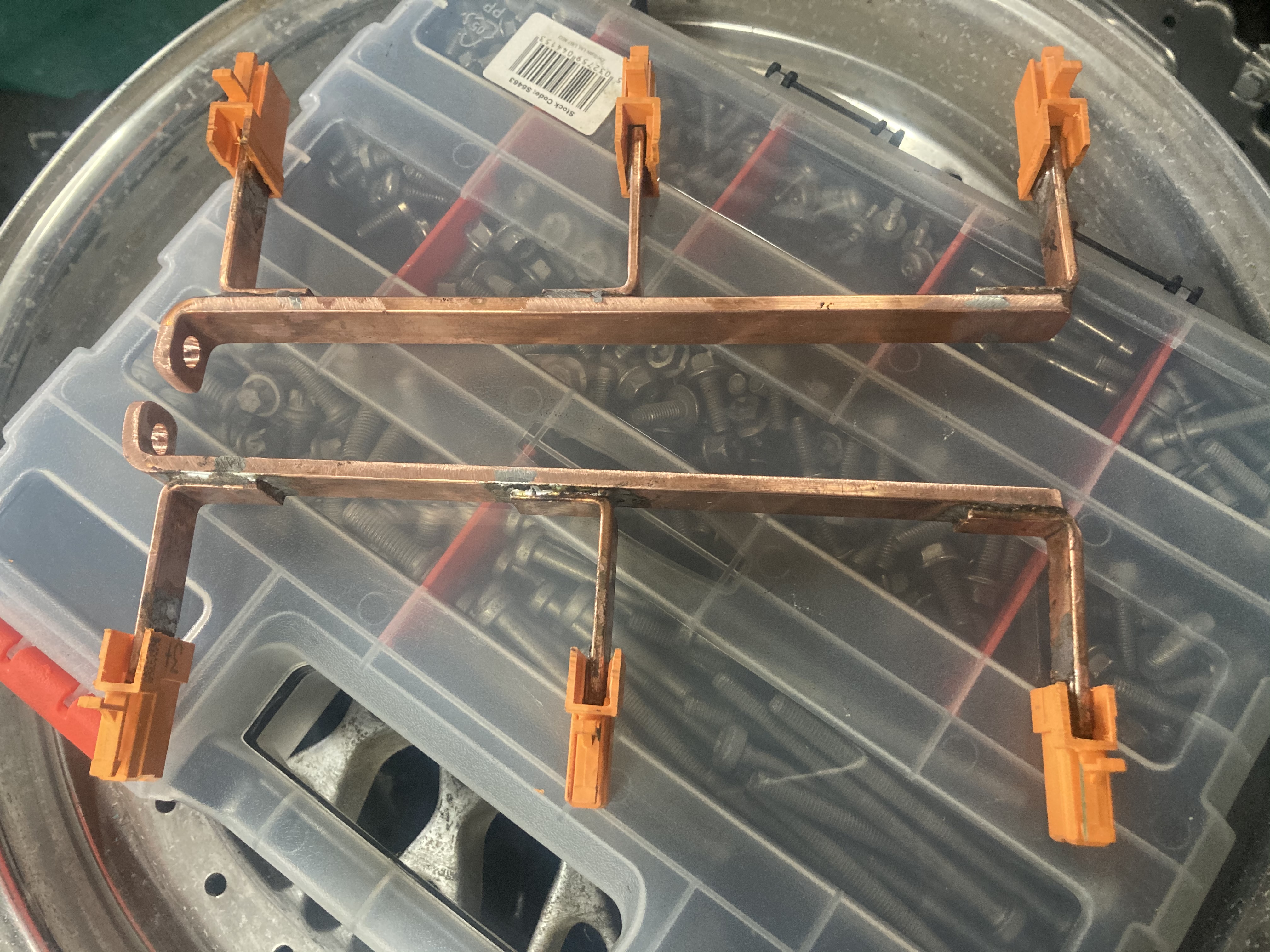

So work on the battery conversion has been ticking along, and the front pack is done and ready to be mounted, I’m using bmw330e modules 3 whole packs worth in a 3p5s configuration, paralleled at a module level with big bus bars using the original connectors soldered on, also paralleled at the cell tap level so each 3 modules is on one cell monitoring slave, have tested on a quick and dirty stripboard simp bms and everything is behaving

Have been working on mounting and connecting the last 9 bmw modules, still to finish the bms wiring and re mount the charger before I can test things
