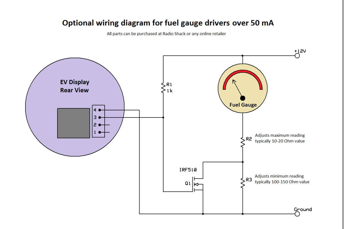

My EVdisplay has one output via which i can drive regular fuel gage. While original setup uses Nmos to pull gage needle from higher resistance (150R for american cars) down to GND via PWM i figured Peugeot fuel gage is wired in reverse.
So how to find out what the values are for my car? Simple, i made a small variable pot and wired it into my dash. I used 500R variable pot and tried limit values. I got 16R for "tank full" and 340R for "tank empty". Linearily before needle reaches empty it shows yellow light when still near 310R which is good because i can anticipate empty condition before my battery is actually empty.
Now i needed to make transistor setup that will pull PWM inversly from the original EVdisplay setup. I chose to use original setup first with IRF510 transistor and both resistors. Of course i still needed to use SFH615 optocoupler because EVdisplay is NOT isolated from main battery! So i got inverse function empty when full and full when empty.
Next i added another Pmos to my design. IRF4905 is capable Pmos about proportional to IRF510. Together they make negative PWM signal which pulls less duty when battery gets drained. This means the more PWM EVdisplay is showing the less duty pulls the gage to GND. That way i get inverse effect.
My wiring in the contact box. Output of EVdisplay i use to connect to opto and then convert PWM signal to 12V.
EDIT: My Pmos wiring didnt quite work out. I wonder why... I had since replaced Pmos with a simpler PNP BD244C transistor and some arranged resistors. What i needed to take into account was different PWM behaviour of cars gage circuit at 8Khz that PWM was operating on.
Results were a bit different with 47R value for FULL and 460R for EMPTY thus R2 vas set at 415R. I add circuit below...

I am adding some additional pics. I have setup my system in such a way there is logic behind the needle position. It now goes through positions of Full, 3/4, 1/2, 1/4 and Empty/reserve with reasonable accuracy. Pics show 43% SOF with a little over 50% of needle travel.
However the function is a little slow and if you would drive all the way i expect the function would show with a little time delay unless you stop.

2N2222 is not strong enough. You need to use Nmos to quickly show GND to the dial. Now you are probably getting shark teeth...

Would an IRF520 be up to the job? I have a couple of those laying around?

Your resistor could be too small or too large. What make is the car? Is it US or EU made?
Or you might have to use one PNP transistor before Nmos to reverse PWM duty.
EDIT: I see you drive it with Arduino so you can also reverse duty if needed.

arber is right, 2N2222 is too weedy for this application. For the amount of current you can source from your Uno, there isn't enough gain to drive the gauge properly. It just about works but you need something better. You can use an NMOS FET, or a darlington pair should also work. IRF520 is massive overkill but will work fine for testing.
