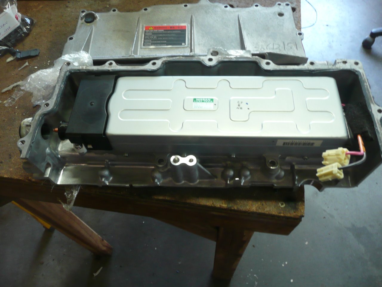

I am not sure if this was already documented here somewhere. If so please consider this only a documented "how to" from me...
A friend lent me a HV contact box out of Nissan Leaf Gen1. He said i should try confirming if it works by simple DIY means.
When i googled around in true engineering spirit i noticed this particular DCDC is documented on various sites and videos, however not with schematics or wiring diagrams...
I used some photos and wiring from here: http://myimiev.com/forum/viewtopic.php?t=4533
Starting with connection of the 12v positive terminal to battery
And then GND the case back to battery negative terminal
I connected HV directly to DCDC input wires.

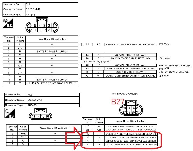

Then referring to plugs F11 & F12
Terminal 3 and 11 would need +12v for Battery power supply
Pin 1 needs a PWM signal 9Hz 50% duty to it

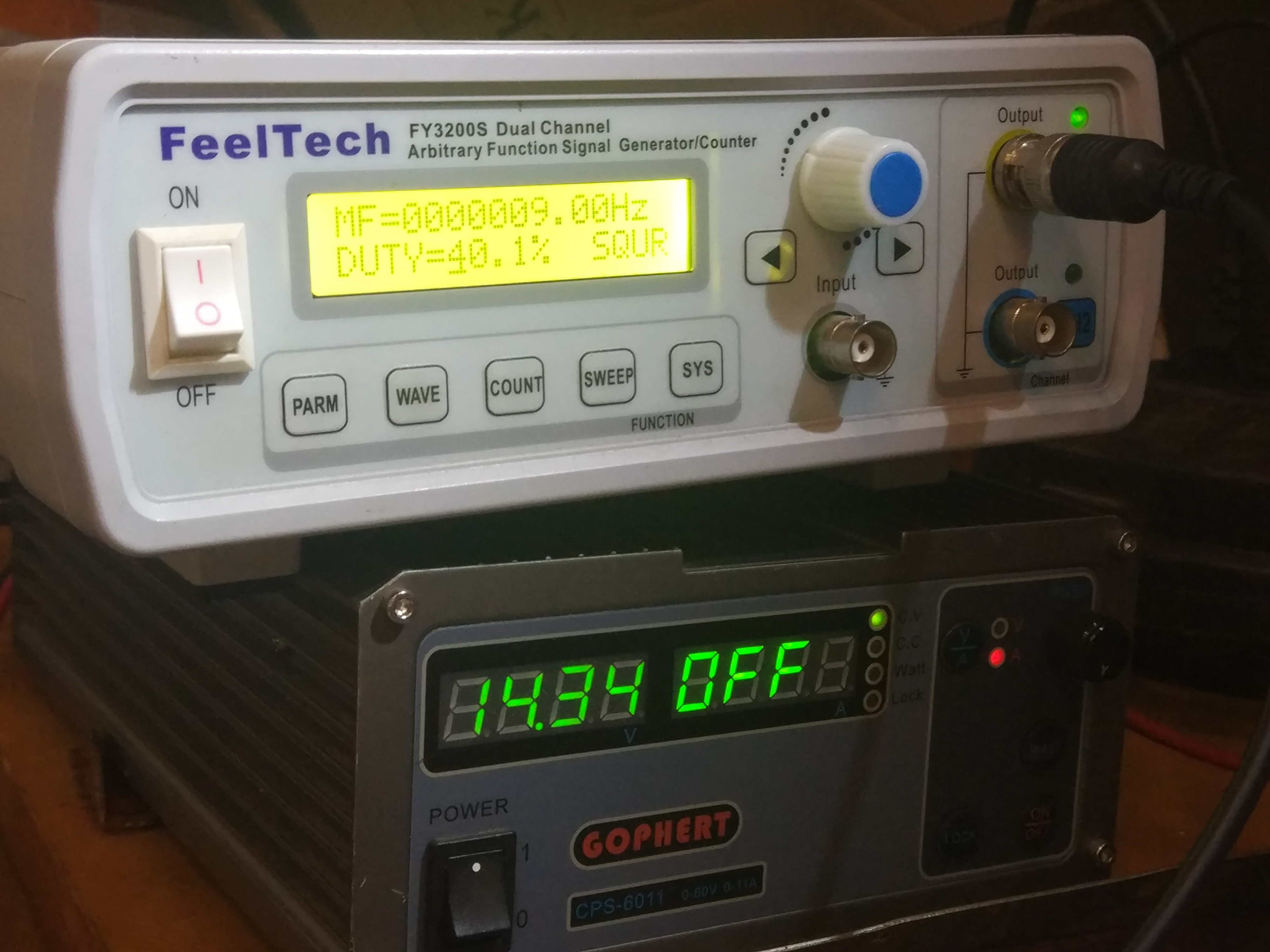

Well it was all good and well with the wiring obtained online, however i noticed that DCDC starts as soon as i provide 12V to pins 3 and 11 of connector and provides 14V power to charge 12V battery.
When i added 9Hz PWM to pin 1 of connector F11 i got following result:
PWM voltage
80% 13,10V
70% 13,40V
60% 13,70V
50% 14,00V
40% 14,30V
30% 14,70V
20% 15,00V
If i remove PWM from pin 1 i again get 14V on DCDC output.

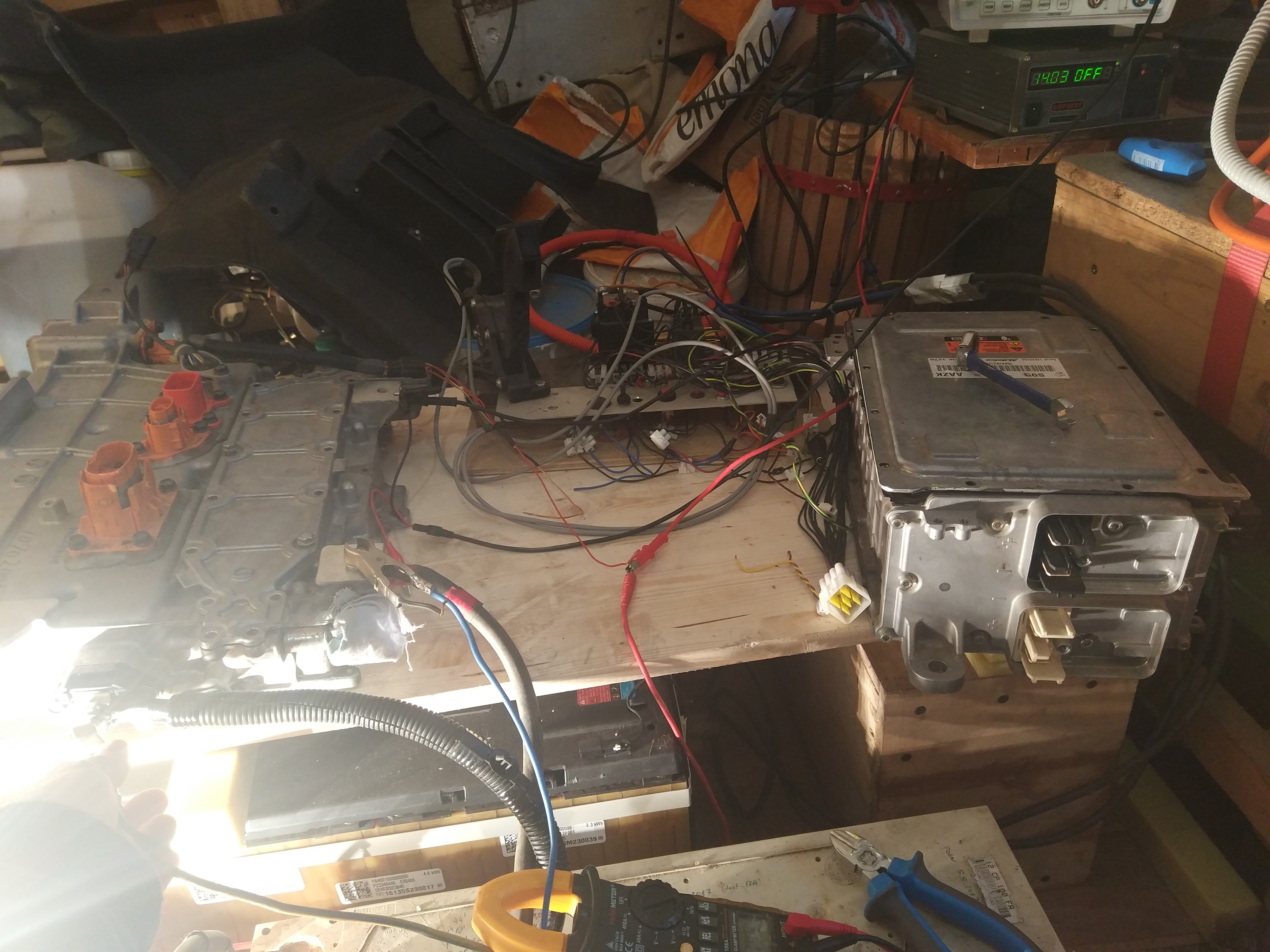

Also i tested the output with 14V 85A load (9x H4 light bulbs and 60Ah Pb battery) and DCDC provided true and steady 14V power.

The Nissan manual also indicates the PWM signal is 5v.
I have checked that PWM signal straight from a UNO pin does control the DCDC voltage.

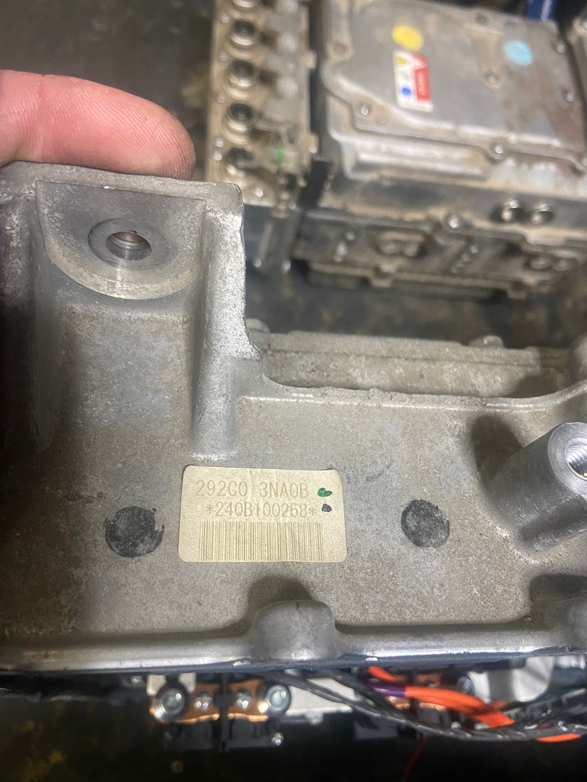

Can I have the part number of the module?
serssh
Posts: 1
Joined: Thu Feb 10, 2022 10:02 pm
Re: Nissan Leaf Gen1 DCDC control
Post by serssh »
Renegate2020 wrote: Mon Jan 31, 2022 4:19 pm Can I have the part number of the module?
292C03NA0B

After disassembling the block, it seems to me that the use of pin 11 is not necessary. only pin 3 (+12v) and pin 1 (pwm) can be used. Pin 11 connects to the high voltage relay, not to the dc/dc box

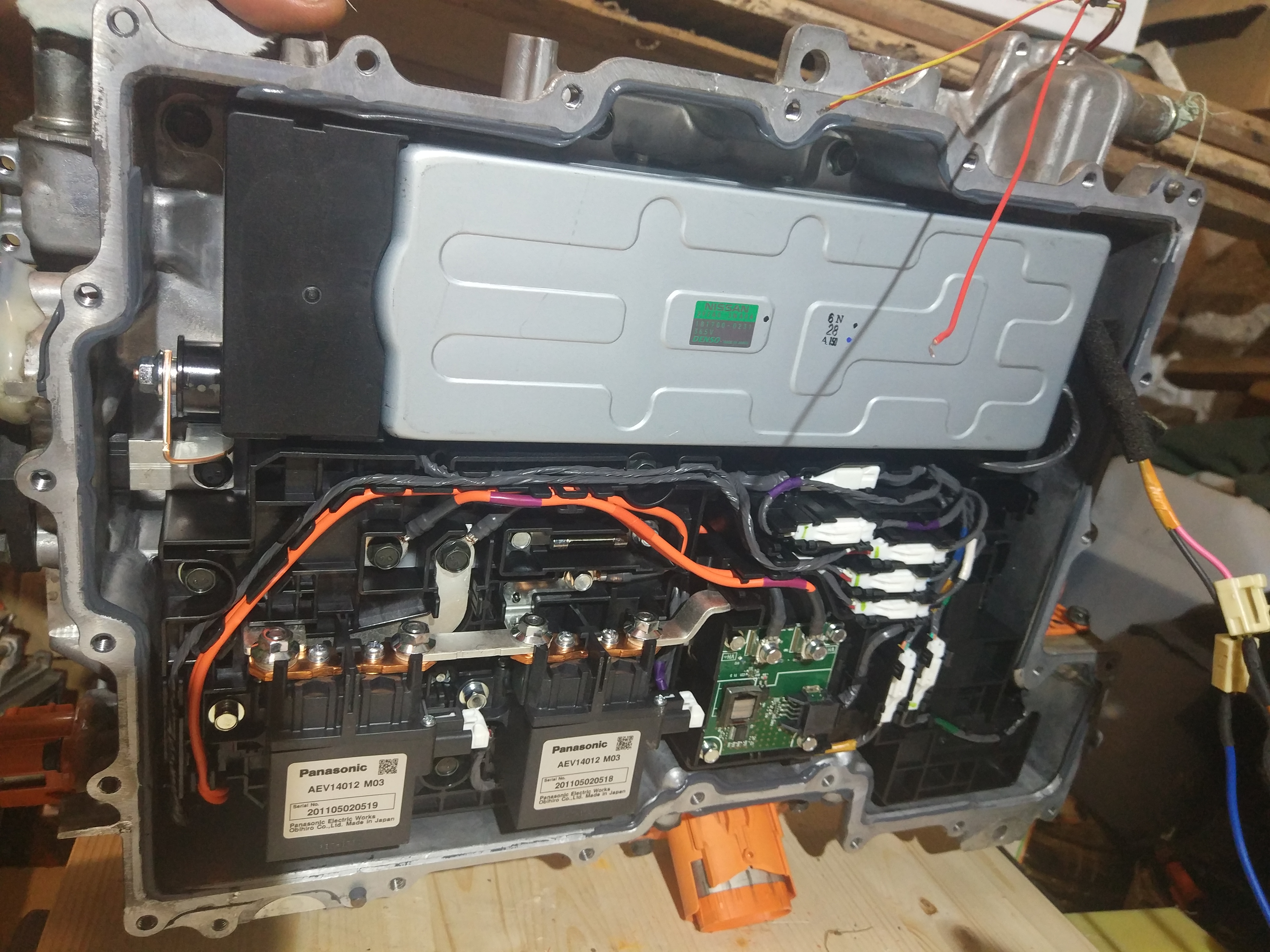

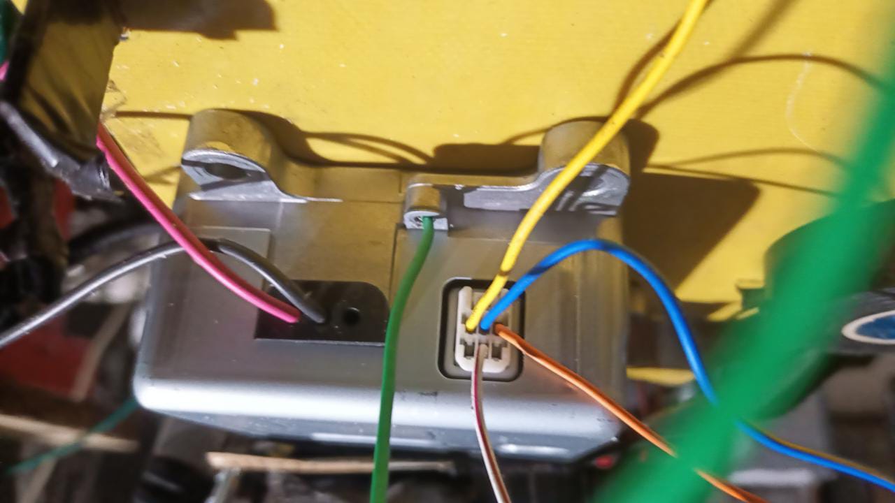

I can answer everyone for the future myself. Connect a 12 volt battery to the output, supply a high voltage to the input, supply +12 volts to the blue wire. That's it, the output will be 14 volts.

Is that module in the photo the dc-dc converter from inside the PDM?
Romale
Posts: 550
Location: Romania
Has thanked: 346 times
Been thanked: 101 times
Post by Romale »
Alibro wrote: Wed Jun 01, 2022 5:05 pm Is that module in the photo the dc-dc converter from inside the PDM?
yes. today I checked by applying only 240 volts to the high voltage input and it started perfectly, 14.03 volts are produced at the output.

Yes I was able to get mine working but it's still inside the PDM
I'm not sure it is important to control the voltage as I think the 12V battery is happy enough at 14V.

Alibro wrote: Wed Jun 01, 2022 6:52 pm Have you tried getting the Gen1 240Vac on board charger working stand alone?
yes. it works great. but for the initial start, the output must have a 12 volt battery. after starting the battery, you can remove it and use the DC/DC as a power supply

Alibro wrote: Sat Aug 13, 2022 11:32 am Would you mind sharing how and the code? I messed about with it for a couple of weeks but didn't really know what I was doing.
I gave the picture above. plug in a 12 volt battery to the output (this is mandatory!!) then put a high battery voltage on the input. put +12 on the blue wire from the battery connected to the output. that's it. it will start
