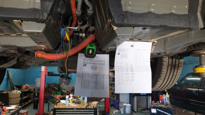

Posts: 4006
Been thanked: 1134 times
Re: Leaf Gen1 battery swap
I've just done this myself and will make a video on the process. As usual there are quite a few "hidden" technical issues that are not discussed.

Jack Bauer wrote: Sun Apr 04, 2021 9:51 am I've just done this myself and will make a video on the process. As usual there are quite a few "hidden" technical issues that are not discussed.
So... Did you swap for the 30kwh battery or another battery?
I am preparing to swap Volt gen2 battery in our Ampera to extend range. It will include BMS tansplant too.
A
Posts: 4006
24kwh to 40kwh. Gen 1 2011 Leaf.
