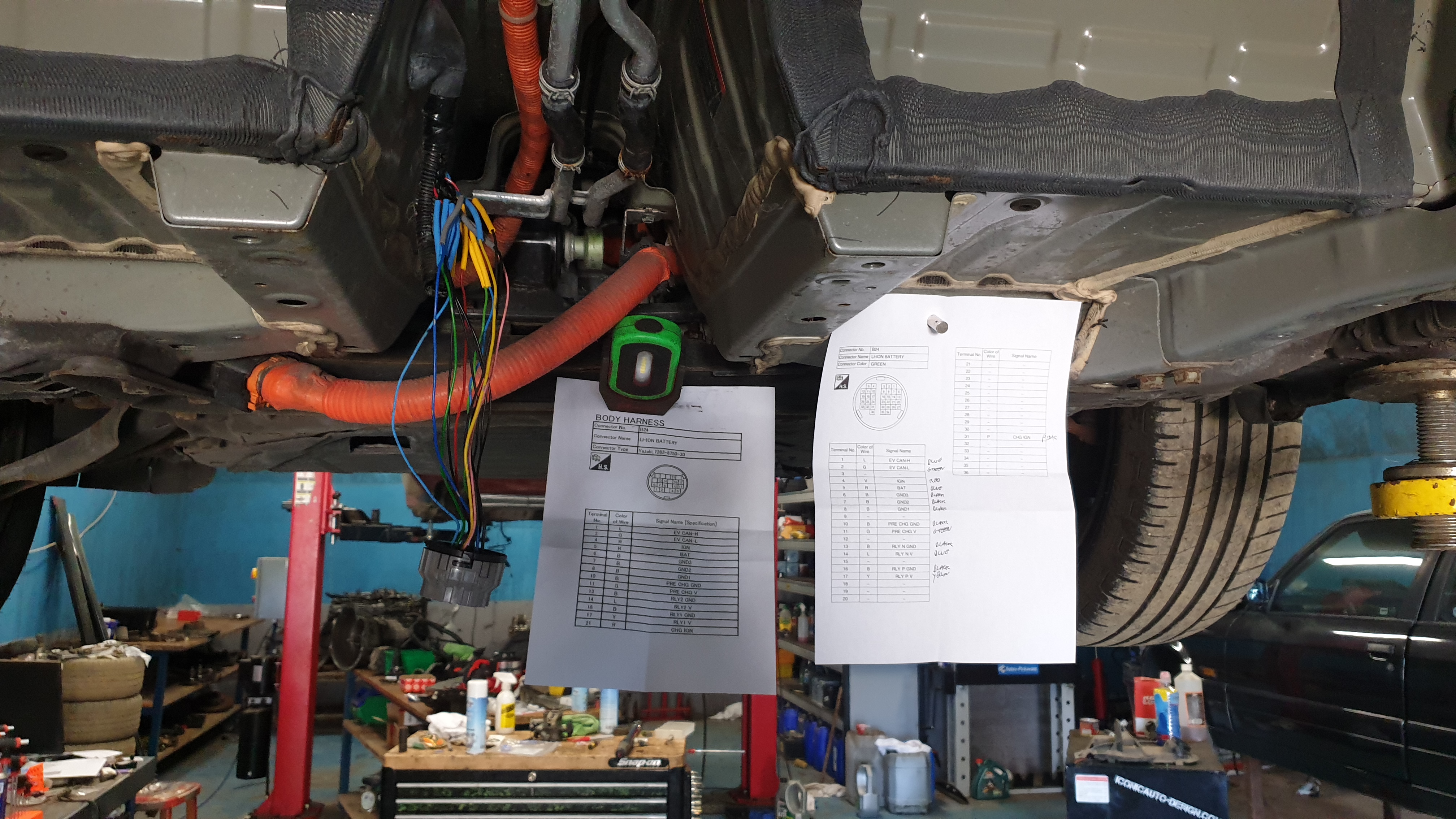

I've just done this myself and will make a video on the process. As usual there are quite a few "hidden" technical issues that are not discussed.

Jack Bauer wrote: Sun Apr 04, 2021 9:51 am I've just done this myself and will make a video on the process. As usual there are quite a few "hidden" technical issues that are not discussed.
So... Did you swap for the 30kwh battery or another battery?
I am preparing to swap Volt gen2 battery in our Ampera to extend range. It will include BMS tansplant too.

24kwh to 40kwh. Gen 1 2011 Leaf.
Hacksaw worthy?? LOL!
I can hardly wait to peel the lid of mine!
