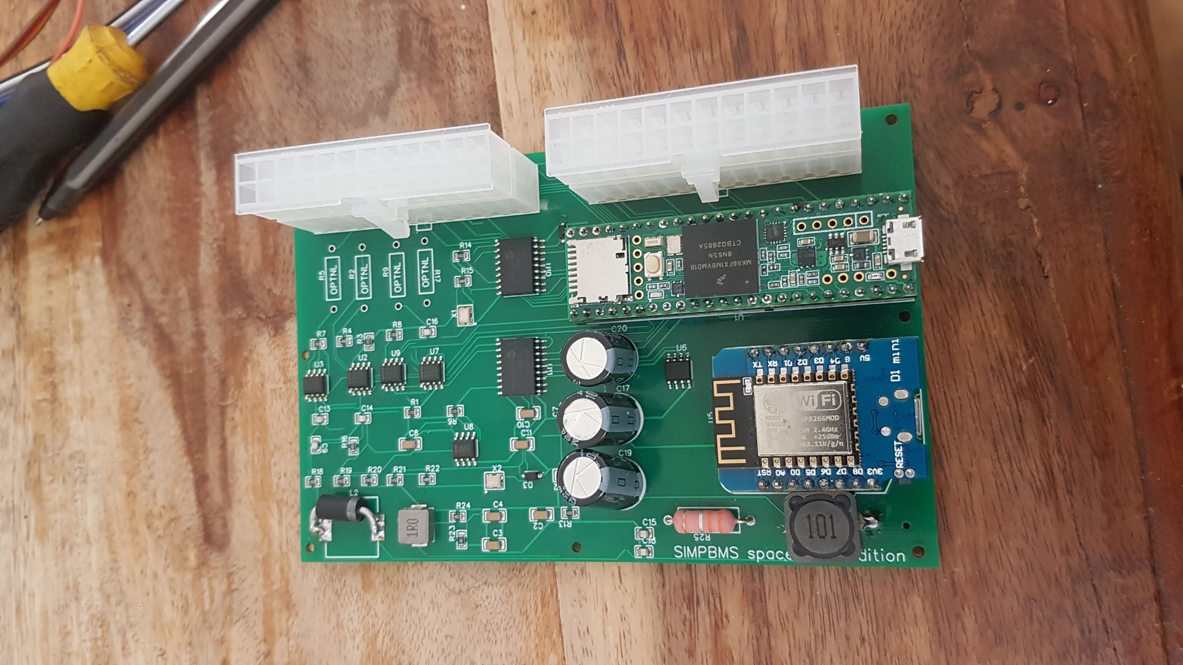

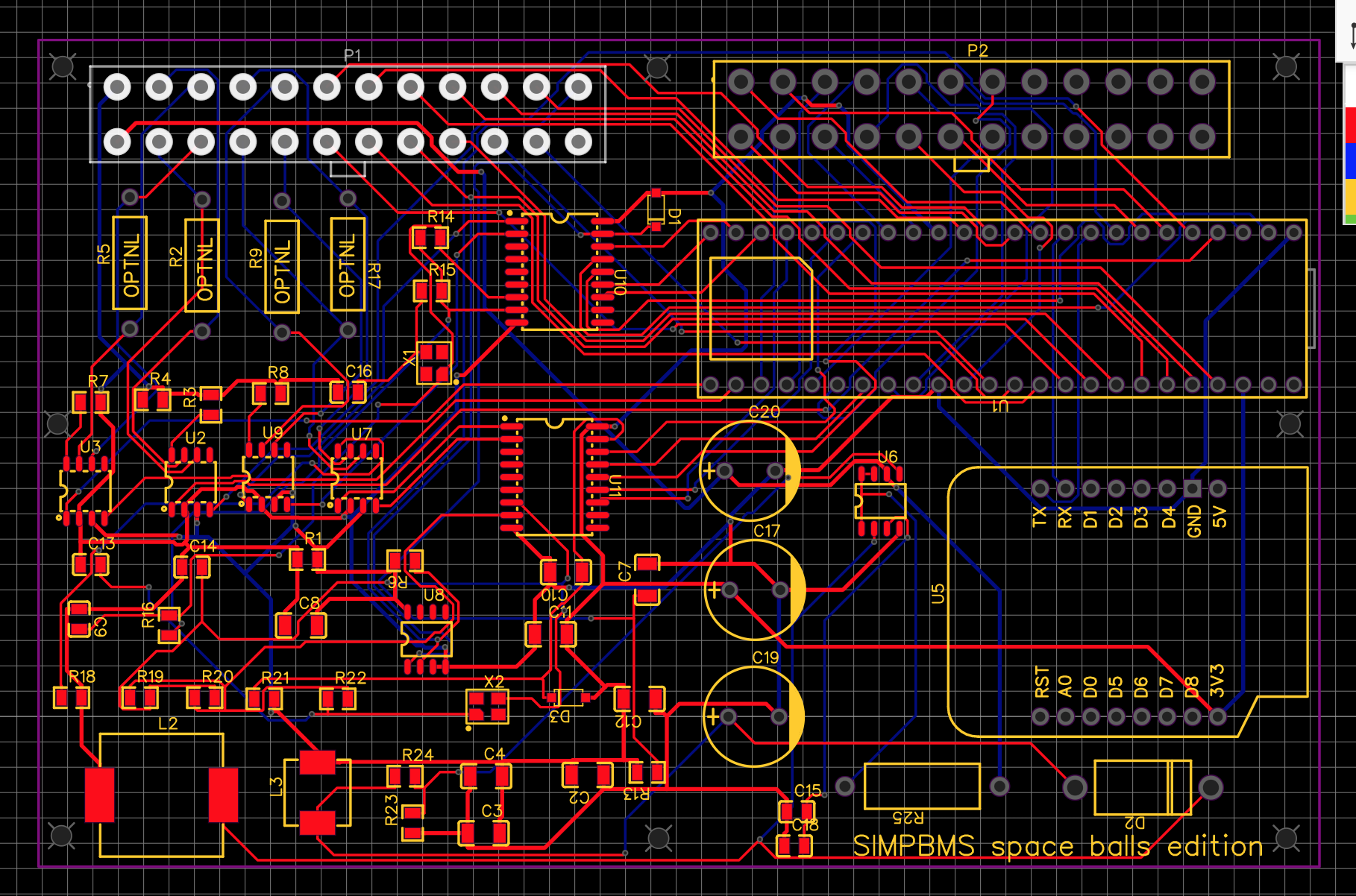

Will do a screen recording of the process of ordering an assembled board from JLC and upload if that'll be useful. Starting from downloading the files from Damiens/Johannes GitHub and uploading etc.
Also JLC have a great circuit/board designer that makes ordering from them super simple. https://easyeda.com/editor, you can either order assembled with a few clicks or order the boards from JLC and the components from LCSC. Also checkout https://oshwlab.com/ as a side note.
rstevens81 and myself have used it to design a 4 can board for a teensy 3.6 for simpbms (will open source once we've corrected the error, as seen in the assembled board and done some more testing)

Brilliant!

Nice Bigpie!
Great to have so many people doing documentation here.
