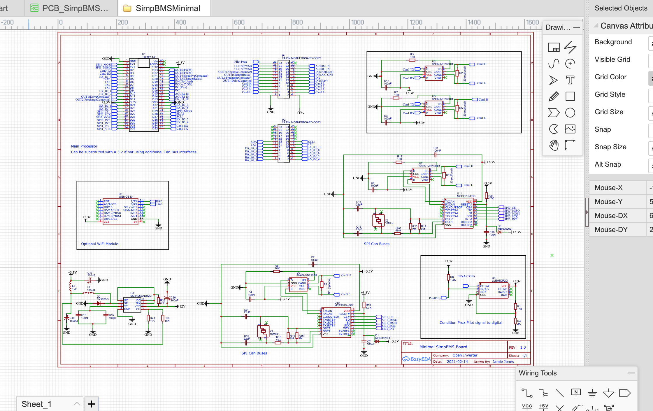

HI GUYS today I WAS TRYING TO ORDER GS450H VCU.V3 FROM JLC PCB WITH SMT Assembly
BUT THE PAGES ASKES ME TO Fill in layer sequence THAT I DONT KNOW
CAN SOMEONE HELP ME WITH THIS
THE PAGE ASKES ME for ALL 4 layers sequences
L1(Top layer)
L2(Inner layer1)
L3(Inner layer2)
L4(Bottom layer)
thanks

Lol v3 vcu. That’s in active development. It’s not a production design...
This is a hard game to play.
damien (+others) have sunk enormous time and risk into developing these projects. Everything is open, but setup in a way for some what stable economic way of keeping development going.
giving step by step on how to by pass that is a hard thing I think for many of us todo in this case.
That being said:
Have you checked if the gerber files are complete? Design files should just load into jlc and be viewable in their gerber viewer. Along with the bom and placement files

2: I figured out/inferred the what I hope is the "correct" stack-up (layer ordering) by doing some reading (viewtopic.php?f=9&t=124&p=2264&hilit=layer+order#p2264 and viewtopic.php?f=14&t=396&p=7347&hilit=layer#p7347 for example) of this forum and was foolish/lazy enough not to document it for myself and others since I haven't soldered and powered a board yet. Some of that reading implies you can't really get it wrong (as long as you put top at the top and bottom at the bottom,) but I ordered my boards with vcc as 2nd layer and ground as 3rd since that was the answer for the VCU board.

It would be super vibrant if you wrote a guide: https://openinverter.org/wiki/Ordering_From_JLCPCBStep-by-step instructions are not something to be avoided to protect your borders or "test" who is worthy or intelligent enough to participate, which is the feeling those responses gave me. In my Megasquirting days, I was on the edges of a _truly_ encouraging and vibrant community
The lack of a guide means nobody (including me) could be bothered to write one. Not that we* want to actively keep people from making their own boards.
Layer stackup is a bit of a challenge to me as well because I don't design 4-layer boards myself. I used to answer "Top - 5V - GND - Bottom" but last time they said "Sorry to say your answer is not clear, because the inner layer names are Tesla_V4B - Layer 2 (Powerplane) ... and Layer 3". I bailed out and said "do it like last time" which worked.

On the JLC order page, there is a (maybe normally collapsed) section for specifying the stack-up. I was unable to get them to complete my order by replying to the email, but re-submitting with that section filled out as desired got me thru the process with no emails from them at all.
