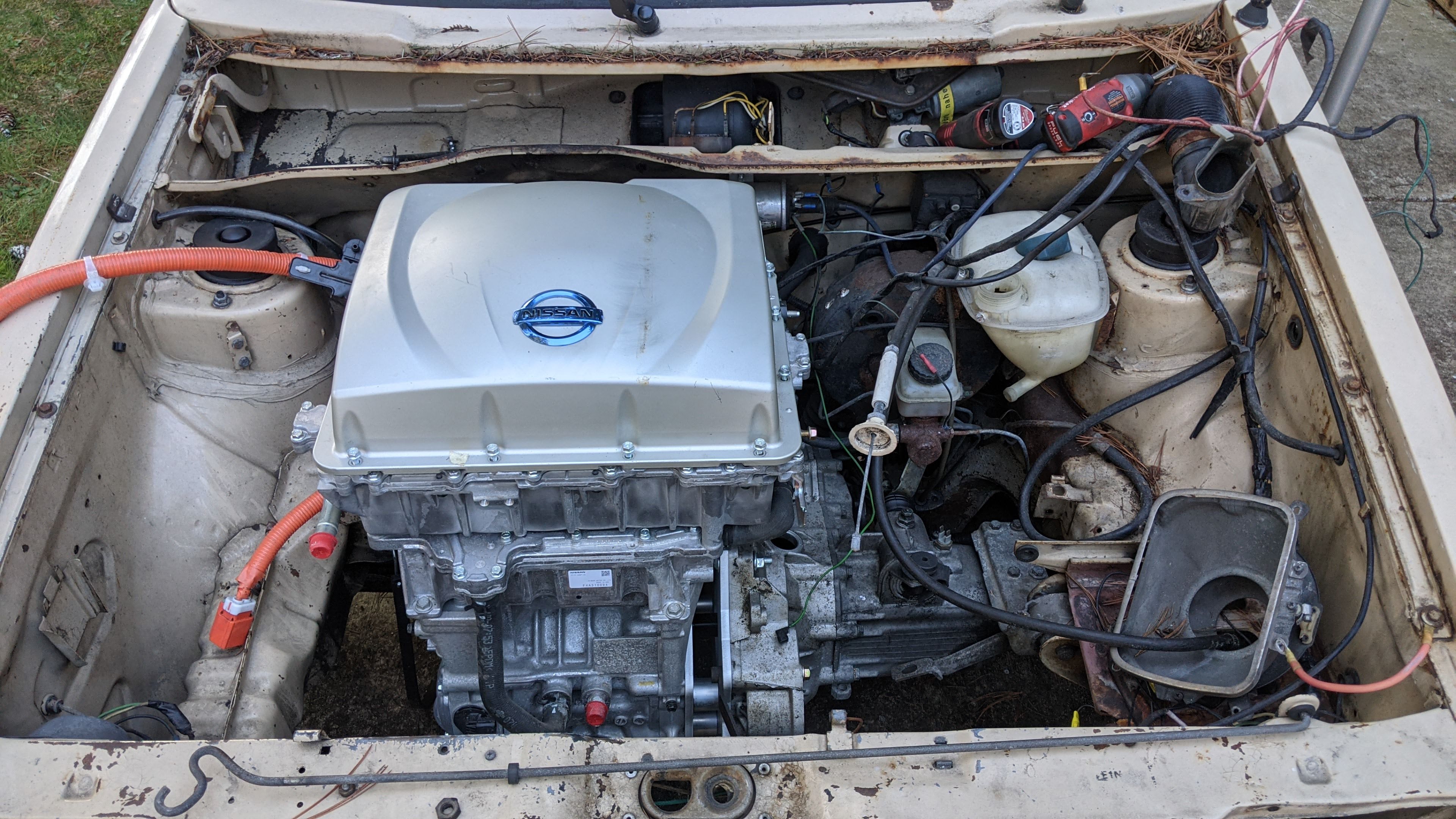

So i'm working on converting a mk1 volkswagen, and thought i'd be able to fit an entire gen2 leaf tower under the hood. Turns out, without lowering the entire motor/trans assembly, it's not going to fit. This got me thinking that the gen 2 charger+DCDC converter isn't that space efficient for what it is.
This conversion will have manual brakes and steering, meaning the 12v loads will be lights and controls only. As well, it is just for fun so I'm not after fast charging or going very far, but i would like to use public J1772 chargers.
other reqs:
1. 350V nominal system
2. ease of Leaf BMS integration
Question is, what space and cost efficient charger+DCDCs are out there that can serve this purpose? Maybe separate components if it makes sense.

Check out Mitsubishi Outlander charger & dcdc combo in one small package.

I used a 62A Meanwell AC-DC for a while but there are some caveats:
- you need to add an output relay because it becomes a 12V load when unpowered (100 mA or so)
- in the long run it overloads the precharge resistor so needs also an input relay
- it's not waterproof and has a fan
I ran it for 8 months and it provided sufficient power even to the quite modern Touran. Just not after I added a PTC heater.

If you need light DCDC check out Meanwell HEP-600-15. It is 600W and it works from 160Vdc up to 420Vdc. I use it in Mazda for 6 years now. Totaly enclosed IP65 and you can start it on demand with a remote wire. It was made for harsh enviroment like mining equipment. You can set it to 14V by a variable pot on its side.

Honda IMA 12V charger DC/DC converter modules are reasonably cheap and plentiful and built for the job?
I think there are two variants, the older on in a metal case and a newer one with a plastic case.
They have a large heatsink for forced air cooling and are not watertight no not suitable for in the engine bay without some modification. I've been looking at IMA stuff for a motorbike build and the inverter + DC/DC are often advertised with incorrect or misleading descriptions and I've seen some ebay sellers even mix the DC/DC and Inverters up in the descriptions.
Not sure exactly of the starting or and cut-off voltage from the main battery pack but I'm reasonably sure they are failsafe in operation, ie apply battery power and they give 12V (~14V) output, but please be sure of this before committing to it on my sayso.

thanks, Mouse! that actually look like a really good option. However, Peter says in his video that the civic one is only good for 160V. i hope to run @350V.
Ultimately it's looking like independent charger and DCDC is the best way to go here.
The Mitsubishi Outlander is not sold in the US so sourcing parts from them is difficult. The Tesla Gen2 charger is pretty cheap via eBay and with another EVBMW board this looks like a feasible option, though not super cheap overall. I really want to use J1772 charging, does anyone know if the Gen2 Tesla charger with board swap can do this?

Then you must go by the Volt gen2 route. I have made it sing and it made 1kW of 14V without cooling. I think with cooling it should be good for at least 2kW! viewtopic.php?p=15675#p15675
Volt gen2 Charger is also 3.6kW and is mentioned here... Both use simple PWM for control. I will soon get one sample to test control.

shoot, just realized the Volt is a 300V pack and i will be running a 96S 350V pack. So that charger may not work for me unless i change my BMS

No only Outlander charger can tap directly to Cp signal from EVSE. But really it still needs separate control. For each and every one you need to have some sort of controler which tells it what voltage and current to use. Even the OEMs have that.

As for voltage, i may just drop my system to 300V for now. But that could mean my Leaf BMS would have to lose 13-14 cells. I'm not sure how it will like that.

Than i think you would want to find Mitsubishi charger/dcdc because it is really compact in that regard. And it works well.

im not really restricted by space. i was just thinking of utilizing the GM components that i hastily ordered off ebay
the mitsubishi parts are way harder for me to source and ordering from the EU makes them about 4-5x the cost of the Volt stuff.
