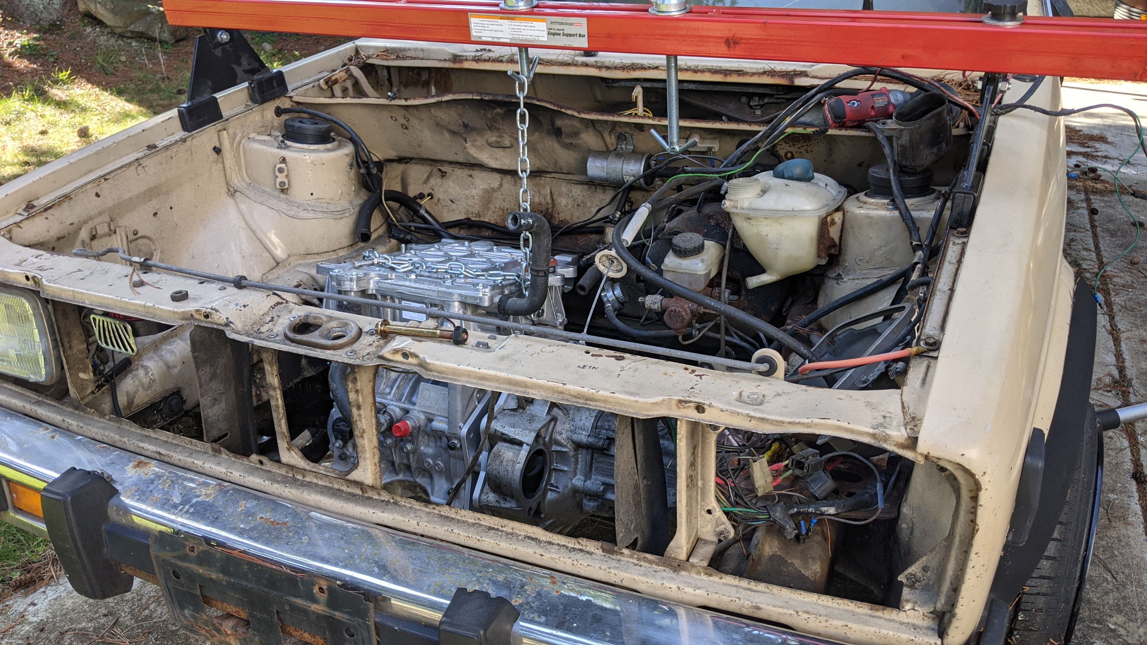

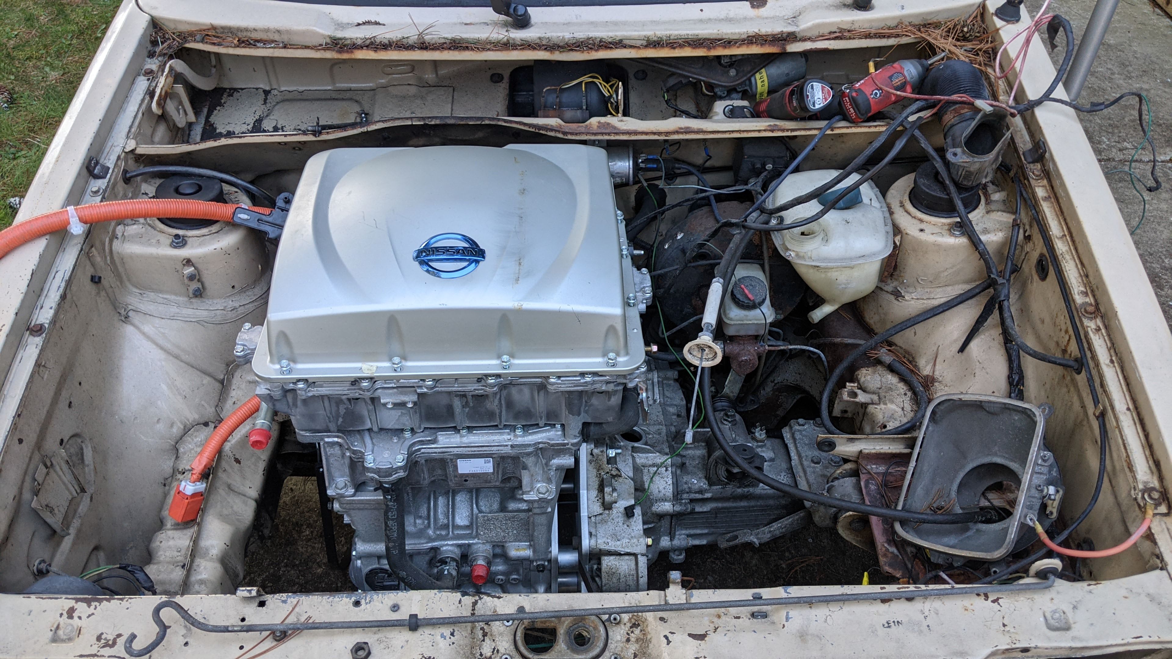

So i'm working on converting a mk1 volkswagen, and thought i'd be able to fit an entire gen2 leaf tower under the hood. Turns out, without lowering the entire motor/trans assembly, it's not going to fit. This got me thinking that the gen 2 charger+DCDC converter isn't that space efficient for what it is.
This conversion will have manual brakes and steering, meaning the 12v loads will be lights and controls only. As well, it is just for fun so I'm not after fast charging or going very far, but i would like to use public J1772 chargers.
other reqs:
1. 350V nominal system
2. ease of Leaf BMS integration
Question is, what space and cost efficient charger+DCDCs are out there that can serve this purpose? Maybe separate components if it makes sense.
