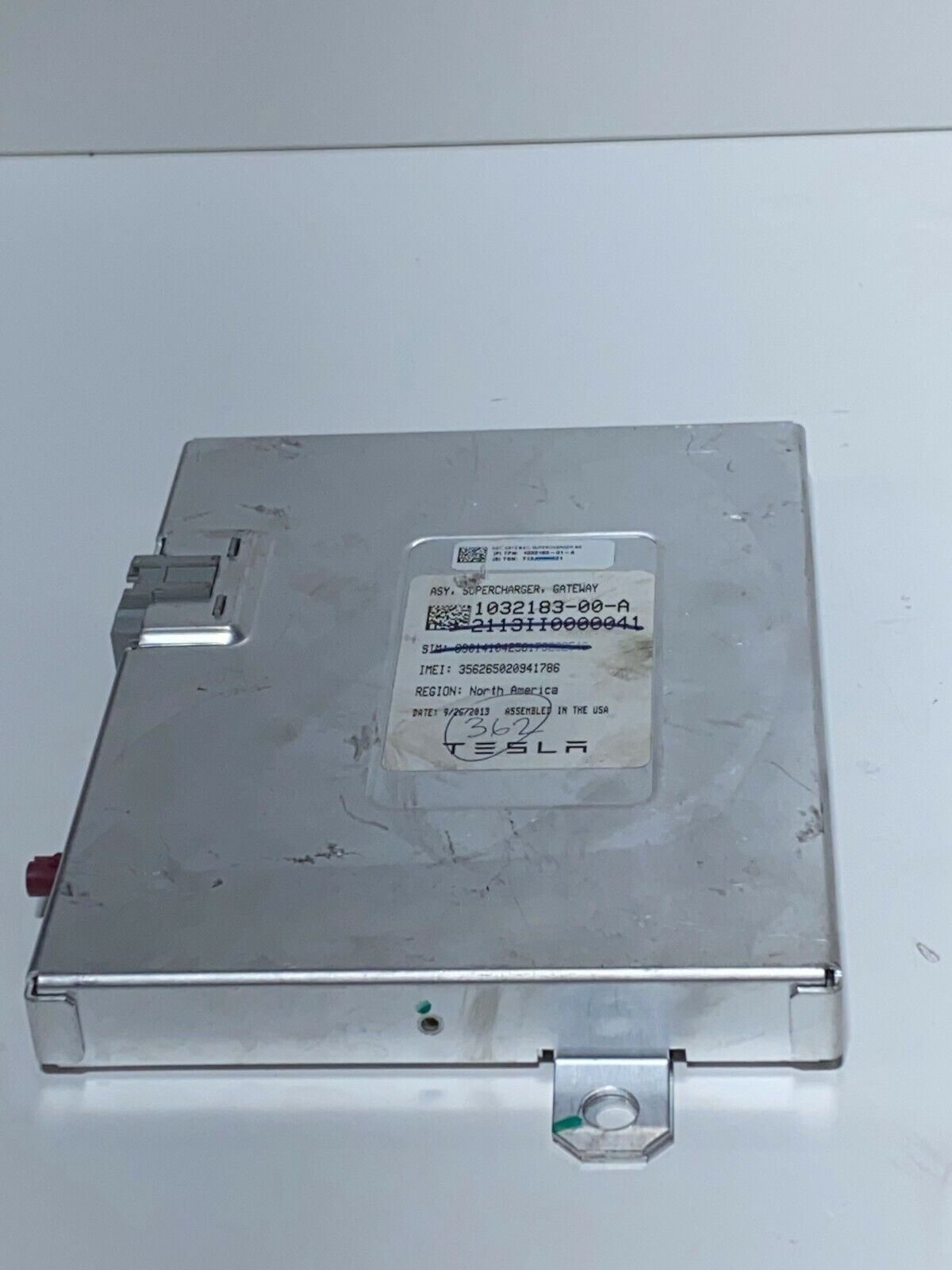

Came upon this : https://www.ebay.de/itm/234267863745
If it is what I think it is it might contain the necessary CAN to control all these supercharger chargers.

Yeah true, the question is what do we need to feed it....
In the end the order of connecting VAC and DC is reversed In a super charger...

Interesting. It bears a striking resemblance to the Tesla Gateway module used in the Toyota RAV4 EV 2012-14.Jack Bauer wrote: ↑Sun Nov 07, 2021 1:01 pm Came upon this : https://www.ebay.de/itm/234267863745
Pics of the Supercharger Gateway Module from that eBay ad:
Pic of mine in a 2014 RAV4 EV. Even has the antenna connector:
The blue OBDII port is not part of that Gateway Module, it's merely bolted near it, and its harness is part of the Toyota harness.
Vladimir Leshchenko posted a (360p, ugh) video of the internals of the Toyota version on YT last year: https://www.youtube.com/watch?v=J-nOMmLsYOY
