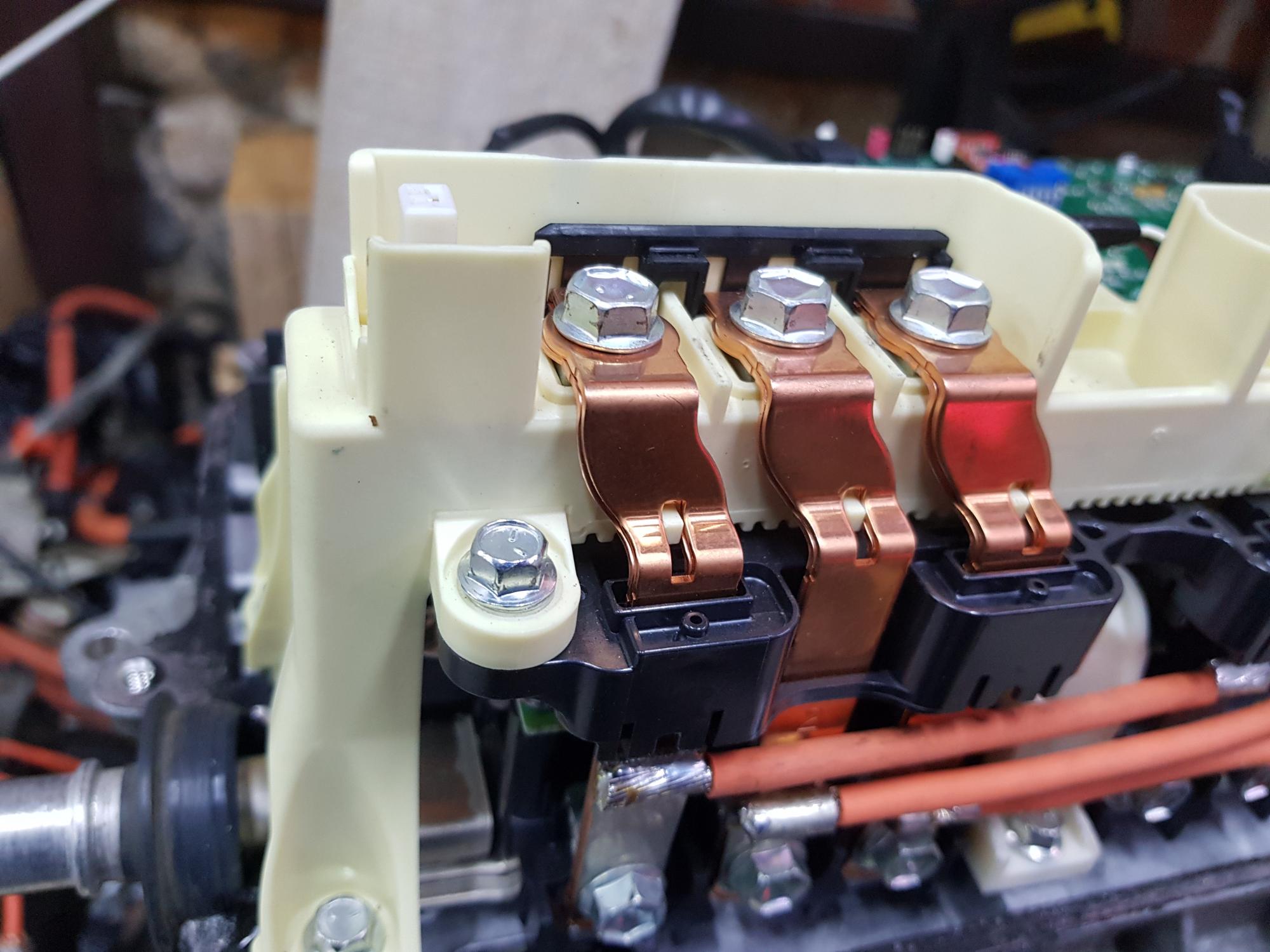

m.art.y wrote: Wed Mar 17, 2021 4:59 am Yes I would be interested in that too. By the way has anybody run MG1 and MG2 in parallel for more power on a single motor on V1c board? How do we wire the motor and which jumpers we need to solder up - just the 6 by the 50 way connector or also the one next to R81? Thanks 🙂
Yes. I`ve soldered 6 jampers and move busbars from MG1 power stage to MG2 with parallel, and made jampers from MG1 power stage to MG2 power stage. Now both currents go through MG2 current sensors.
It is works:

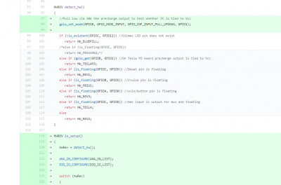

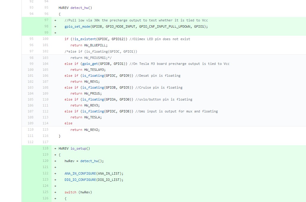

180jacob
Posts: 45
Joined: Thu Nov 12, 2020 10:55 pm
Location: South West UK
Post by 180jacob »
zilion wrote: Thu Mar 25, 2021 12:10 pm IMO they are reminescence of earlier iterations to be wiped. :)
Not necessarily earlier iteration, remember that the firmware and general design is used in several other inverter logic boards as well, some of which use those inputs. Detection of the board version is implemented in the firmware to some extent but at the moment I think when loaded on the prius board some of those are still being checked despite them being tied high or low as required.
Further still, the state of those pins is what is used to detect the board variant:
(taken from rev5, which I haven't downloaded yet)
Not saying you shouldn't remove/reallocate the pins, just pointing out you will need to make a few firmware changes as well.
zilion
Posts: 58
Joined: Tue Feb 02, 2021 7:50 am
Location: Poland
Post by zilion »
180jacob wrote: Sat Mar 27, 2021 11:21 am
This is gonna be a mess. And sooner then later. It can be contained to some degree for boards with one IC, but now Toyota has two IC's, and mine has three IC's to be programmed with one software.
Besides if you want to add another HW version, you have to revise all other boards that are using this software.
And I see, that Damien can't stop to stripe another inverters and chargers :)
Well, it works for now.
And to say something constructive at the end, I suggest to add some header file, like: HW_conf.h where you can uncomment HW version for specific board, and abstract their pins configuration.

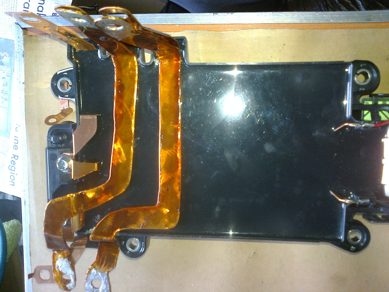

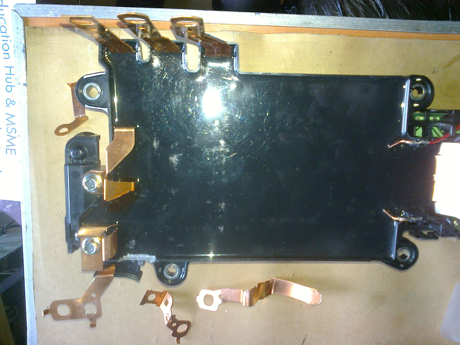

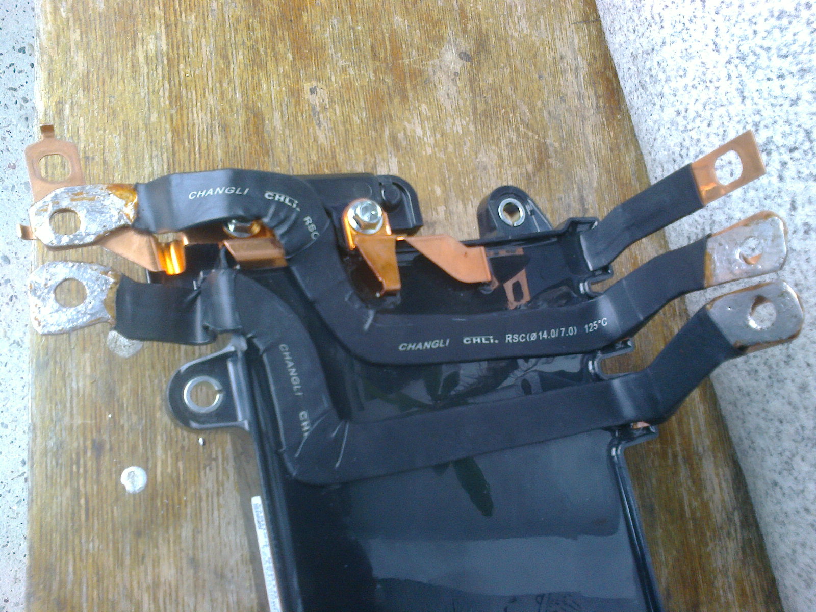

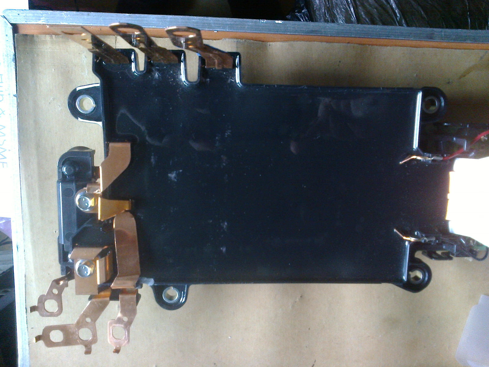

привет всем. для тех кто падает на инвертор высокое напряжение свыше 300 вольт с другой стороны, я подал там где подается 202 вольт. но после небольшими доработками.
на фотках видно все.
на конденсаторном блоке отрезали не нужны шины и добавили нужные нам самодельные медные шины.
теперь я смело подаю 350 вольт место 202 вольт.
Hello everybody. for those who drop a high voltage over 300 volts on the inverter on the other hand, I applied where 202 volts are supplied. but after minor modifications.
the pictures show everything.
on the capacitor block, we cut off the busbars and added the homemade copper busbars we needed.
now I boldly feed 350 volts place 202 volts.

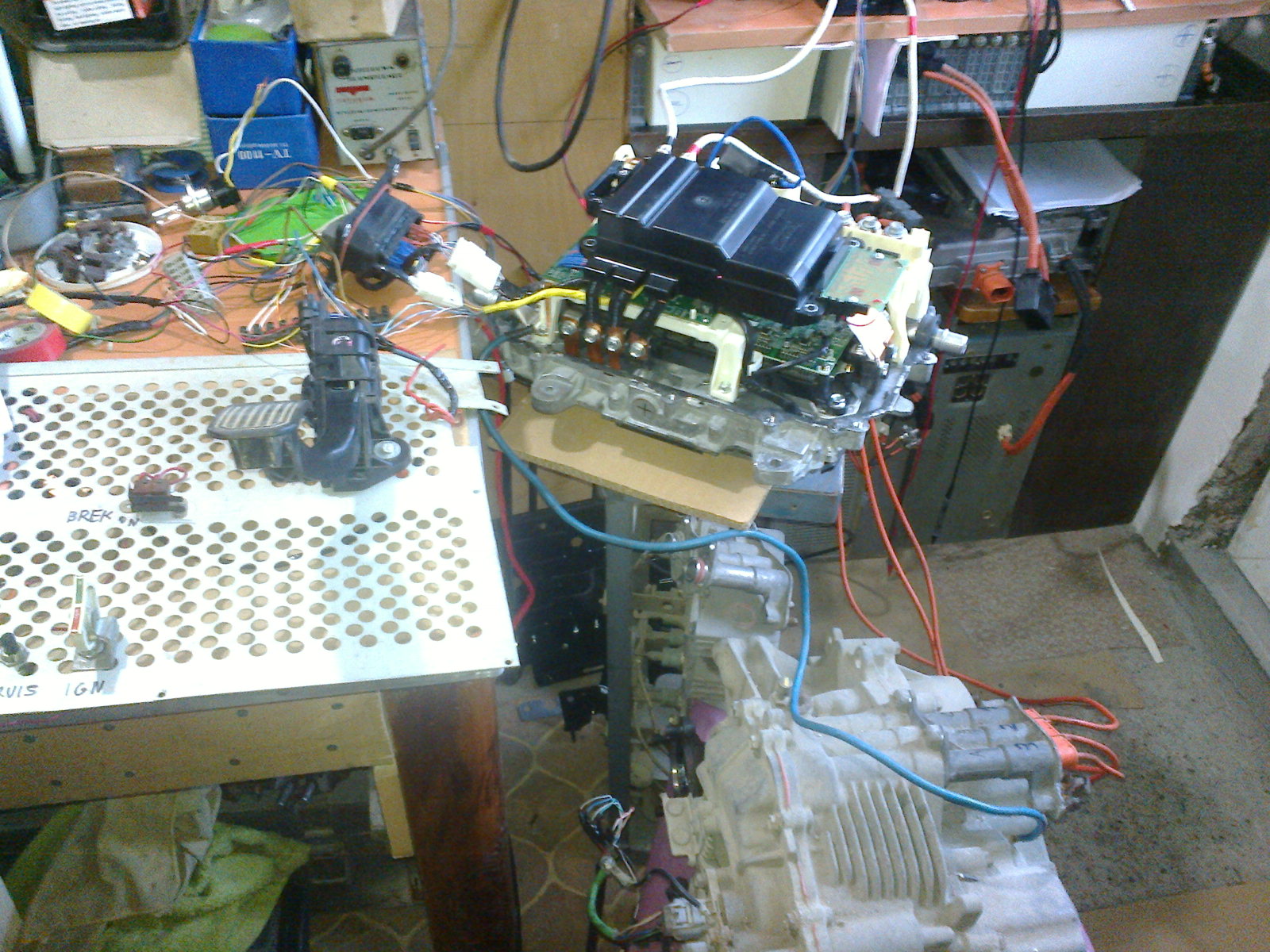

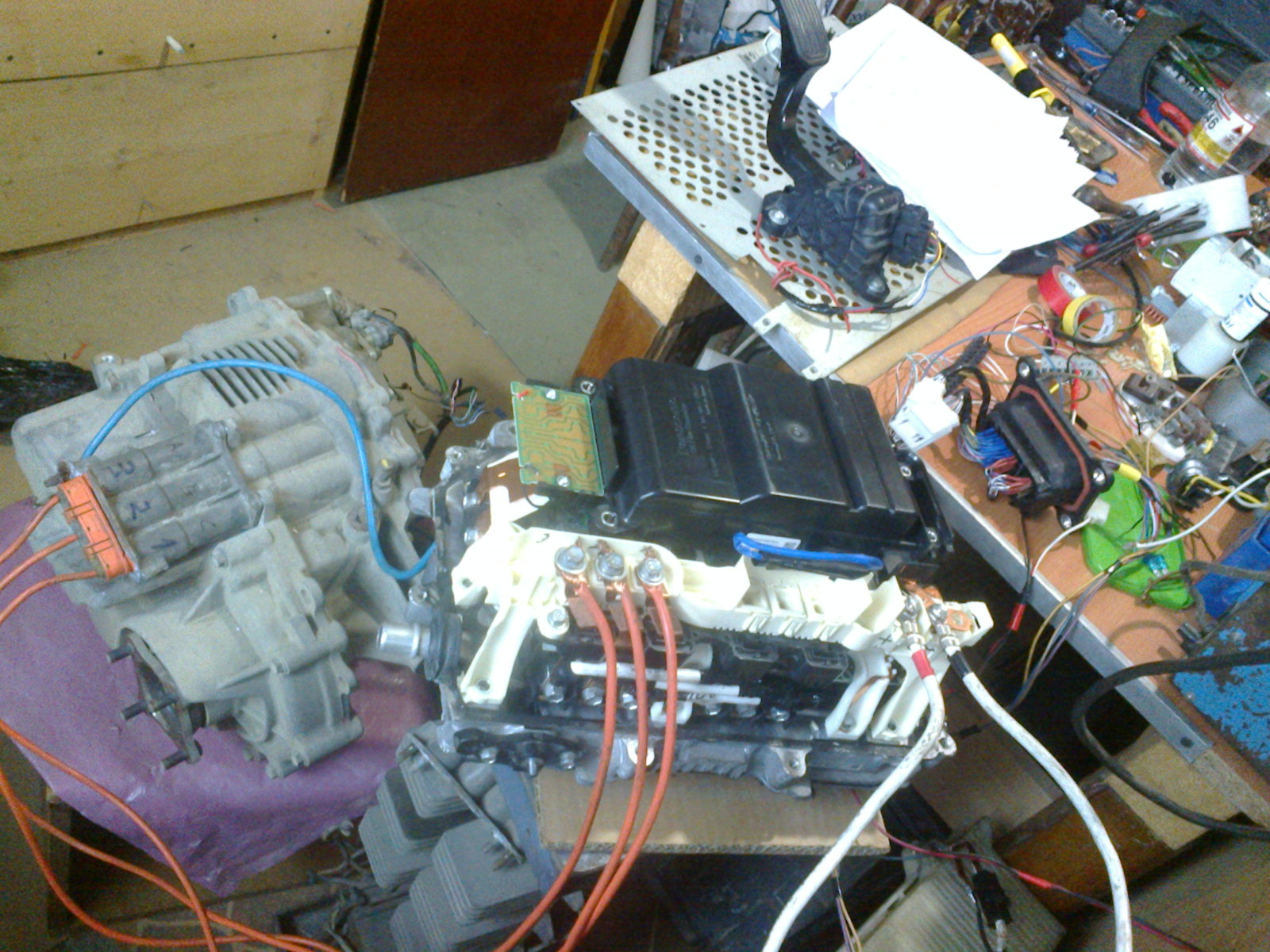

mikmur
Posts: 46
Joined: Sat Jul 18, 2020 7:37 am
Location: Georgia/Batumi
Has thanked: 34 times
Post by mikmur »
вот так выглядит установка
this is how the installation looks like
