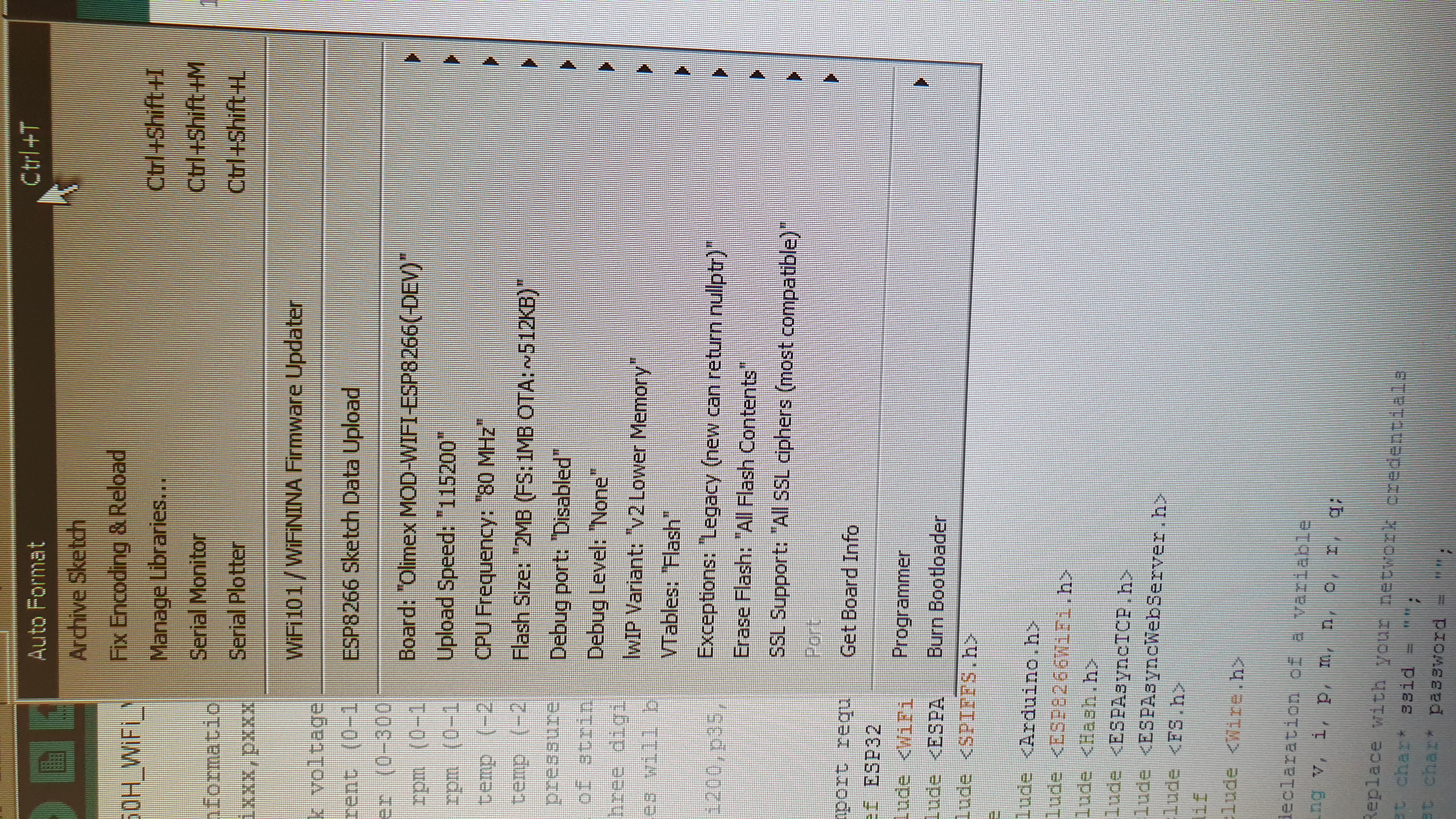

Ok lets just all slow down a bit here before we go off bringing even more variables into the mix. What annoys me here is that we have the folks and knowledge in the community to help out but its left on me once again. So here goes :
Part 1 : Lets all use the same software and ide.
https://www.arduino.cc/en/software
I've tested this on 1.8.13 so go ahead and grab that and install.
Next you will need to add the ESP8266 to your boards manager.
Tutorial here : https://randomnerdtutorials.com/how-to- ... duino-ide/
Go ahead and do that.
Download the wifi package from my Github :
https://github.com/damienmaguire/Lexus- ... aster/WiFi
Copy it to your arduino sketch directory. Close and reopen arduino, go to file, sketchbook and it should show up.
Go ahead and open it.
Now you need the correct libraries which is where the fun starts as they are a hot mess in arduino these days.
I uploaded mine to the repo :
https://github.com/damienmaguire/Lexus- ... /Libraries
Grab those and unzip both files to your /Arduino/libraries directory.
Next up go to tools and setup your board exactly as shown in the picture.
Close and reopen arduino then hit the tick box to compile. If you did everything right it will just compile.

One step that isn't mentioned in Damiens write-up above, is that you need to set the SSID and password! in the /data folder. You can do this by making plain .txt files with your own variables. If you don't do this, you will have problems.
Because I was struggling to get my ESP board programmed on my normal dev system, a Macintosh, I just went out and bought a used Panasonic Toughbook with Windows 10 pro installed, and set up the all the Arduino IDE, downloaded the necessary libraries, and FINALLY was able to compile the VCU V3 User software, and program onto my WEMOS D1 Mini R1 the WiFi interface. For now, I have the D1 held in place on the VCU board with 3M VHB tape, and jumper wires connecting the proper pins to the 5x2 IDC header on the VCU PCB that was originally designed for interfacing with the OLIMEX-ESP board. I'm going to make up a simple PCB and have them made at JLCPCB to adapt the WEMOS D1, to just plug in to the VCU, just like the OLIMEX. If anyone wants one of these little adapter boards, PM me.
The Wemos DI has a MUCH stronger wi-fi signal that the OLIMEX. It's also much easier to program. It has a USB host controller built in, you just plug that little sucker into a USB port with a micro USB cable, and program it. No fucking with solder blobs or any of that bullshit.
My problem is now solved. I have a full strong wi-fi signal, in my ride, with the doors closed, and windows rolled up. I'm stoked that I don't have to re-mount / re-wire the CINCH containing the VCU in my setup just to get wi-fi working. Did you know that some window tint films are not wi-fi signal friendly? I learned this the hard way.
Thanks everyone for the help / efforts to help. It is very much appreciated.

Hello,
people seemed to struggle with programming the Wifi modules. I copied instructions from a bunch of forum posts together and added them to the Olimex wifi page. That way they can be edited in the future.
https://openinverter.org/wiki/Olimex_MOD-WIFI-ESP8266
The page has two sections, at the top what worked for me with the Tesla boards, at the bottom I copied damiens post.
Please feel free to add stuff & correct mistakes.
I added the binaries that Basshunter made for the GS450H path, and added my binaries to the Tesla/Generic webinterface path.
Posts: 4007
Been thanked: 1139 times
Thank you very much! I'll update the first post.
