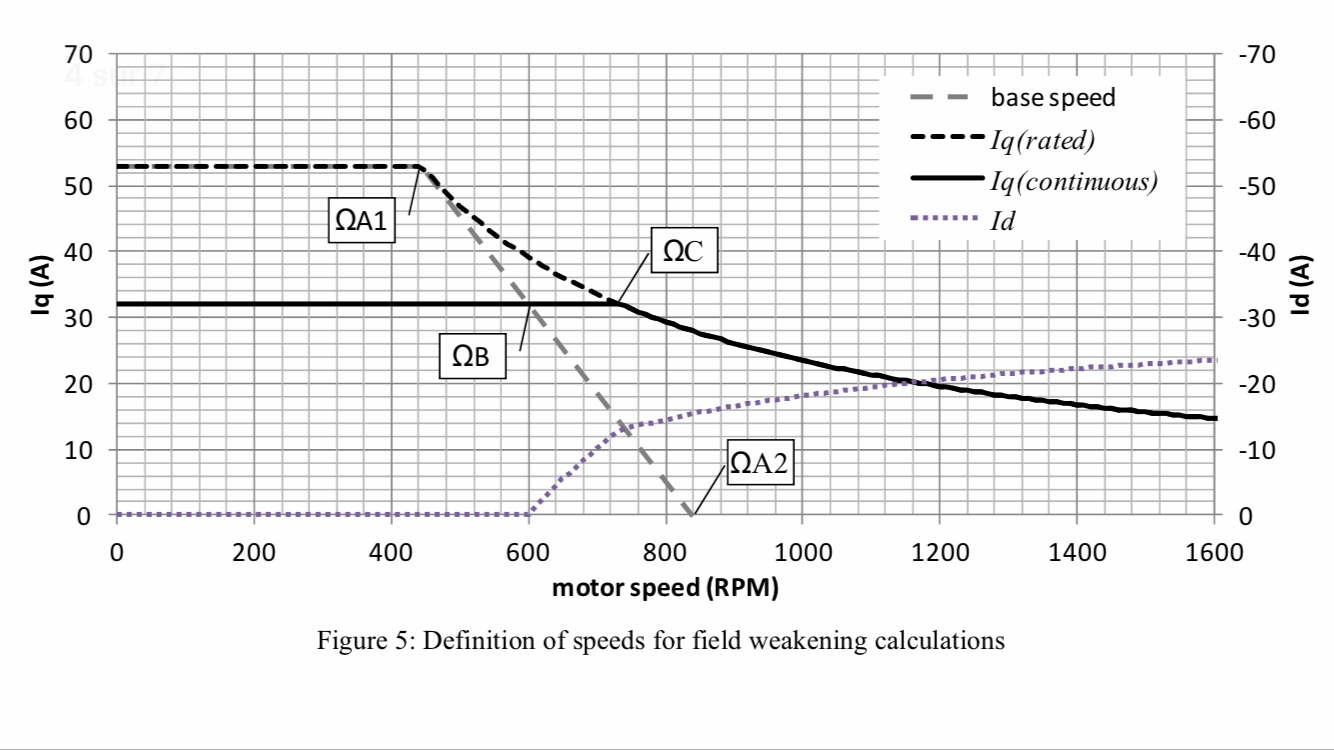

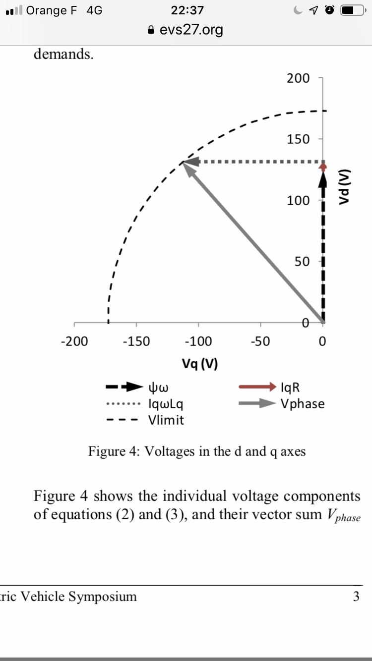

Yes i understand that.
But when i check all the graph attached i don’t realy understand what is the d and q axes, and so What is the Iq.
Re: what is field weakning ?
Assume that the motor phase currents (a,b,c) are three vectors that are 120 degree apart from each other. After you apply the Clarke transformation on the three phase currents (a,b,c), you get Ialpha and Ibeta currents. Ialpha and Ibeta are two orthogonal vectors and their resultant is the same as the actual motor current vectors' resultant. But the Ialpha and Ibeta are rotating with the rotor flux speed, so you apply the Park transformation on Ialpha and Ibeta, and the output is Id and Iq. In the Park transformation, the reference frame is rotated with the rotor flux speed so that the vectors can be seen standstill w.r.t. the reference frame. In other words, Id and Iq are constant values in steady state. Id and Iq can be simply thought as the flux component (reactive power) and torque component (active power) of the motor, respectively.
In the field oriented control method, one sets the Id to the motors rated flux value. Id is there in order to create a magnetic field. The Id is (almost) linearly reduced to a value near zero beyond the base speed, that's what the field weakening is. The weaker the field is, the less back-emf motor produces, the more current your inverter can send to the motor.
Iq is simply the real power, it's the torque that the motor produces.
realy thanks for your answer.
i have now more information to understand.
so field weakening is made by sliping frequency over the omega B (on the fig5 in my previous post)
if i need more rpm at this torque, we enter in field weakening mode and then set frequency for somthing arround 1200rpm and then we have omegaC same torque at 660rpm ?
i'm wright ?

Field weakening is made when you are spinning the motor higher than the base speed. It looks like you have a 8 pole 50 Hz motor so your base synchronous speed is 750 rpm. Normally, field weakening is achieved by increasing the frequency over omega C for your graph, not B. But on some particular applications, one might start weakening the field earlier, so it looks like this is the case for your graph.
Beyond the base speed, you reach the constant power region of the motor. Power is the product of torque and speed, so as your speed increases, the torque decreases since you are in the constant power region. So you cannot have the same torque at 1200 rpm with the one at 600 rpm (for this particular motor, of course). That's why the Iq curve starts declining after 750 rpm.
