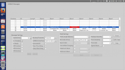

Orion BMS has chademo charging support. If you download setup java app for it, you can see from there canbus messages for Chademo that are implemented. Just click Canbus settings tab then select Chademo protocol and edit canbus messages.

Which file would that be? The file LoggerUtility.jar? I found some CAN references there, but not the ones i want...

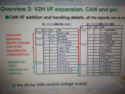

Thanks, also i found further explanation on 3rd page of the forum thread, http://www.mynissanleaf.com/viewtopic.p ... 4&start=20
1.Car sends “Vehicle Stand By for Charging” message. [0x20]
2.charger responds with “Information about Charger” message containing “charging mode”, “max output voltage”, “max output current”, “max output power”. [0x31]
3.Car sends “Constant current request” message containing “voltage upper limit value” and “required current value” [0x26]
4.charger responds with “Constant current status” message containing echo of the “voltage upper limit” and “required current value” [0x37]
5.If no errors or interruptions repeat 3 and 4 while charging.
6.Car sends “Charge finished message”. [0x29]
7.charger sends “Charging stopped message” [0x38]
8.Charging stops.
Car to charger:
102 - Charge amperage is byte 3. Byte 6 is SOC, expressed as .1kWh per bit.
charger to Car:
109 - Byte 3 is again charge amperage.

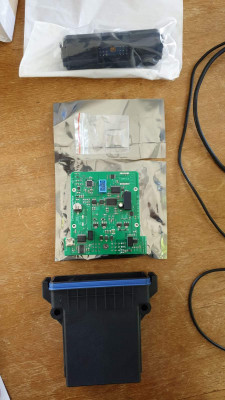

New Electric have a generic CHAdeMO interface controller that's designed to interface to any CAN based BMS. It's been fitted to two test mules and has recently completed it's compatibility tests. I don't have pricing or availability today but will know more after Fully Charged Live

Is there any sort of info available on which bms systems it currently support and if the code will be made available to be modified by individuals?

I don't have all the details but the New Electric team is at Fully Charged Live next week... they'll be able to answer all your questions

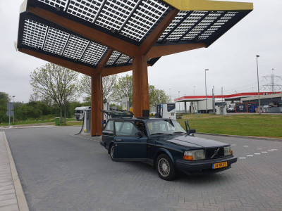

A quick thing i noticed in the video, Damien says his battery is full yet the station still gets requested to pump 125Amps into the car and then shuts down.
This is a very rudimentary way of controlling the end of charge, or actually not controlling it at all. I would expect current to taper, requested by the car, the closer it gets to full.
- Posts: 3831
- Has thanked: 75 times
- Been thanked: 696 times
Re: DIY CHADEMO charging
Agreed. The code I linked above from Colin Kidder did in fact do current taper and shutdown when I last tested it 4 years ago. I didn't delve too deep into this new software as I didn't give it much chance of working:)
