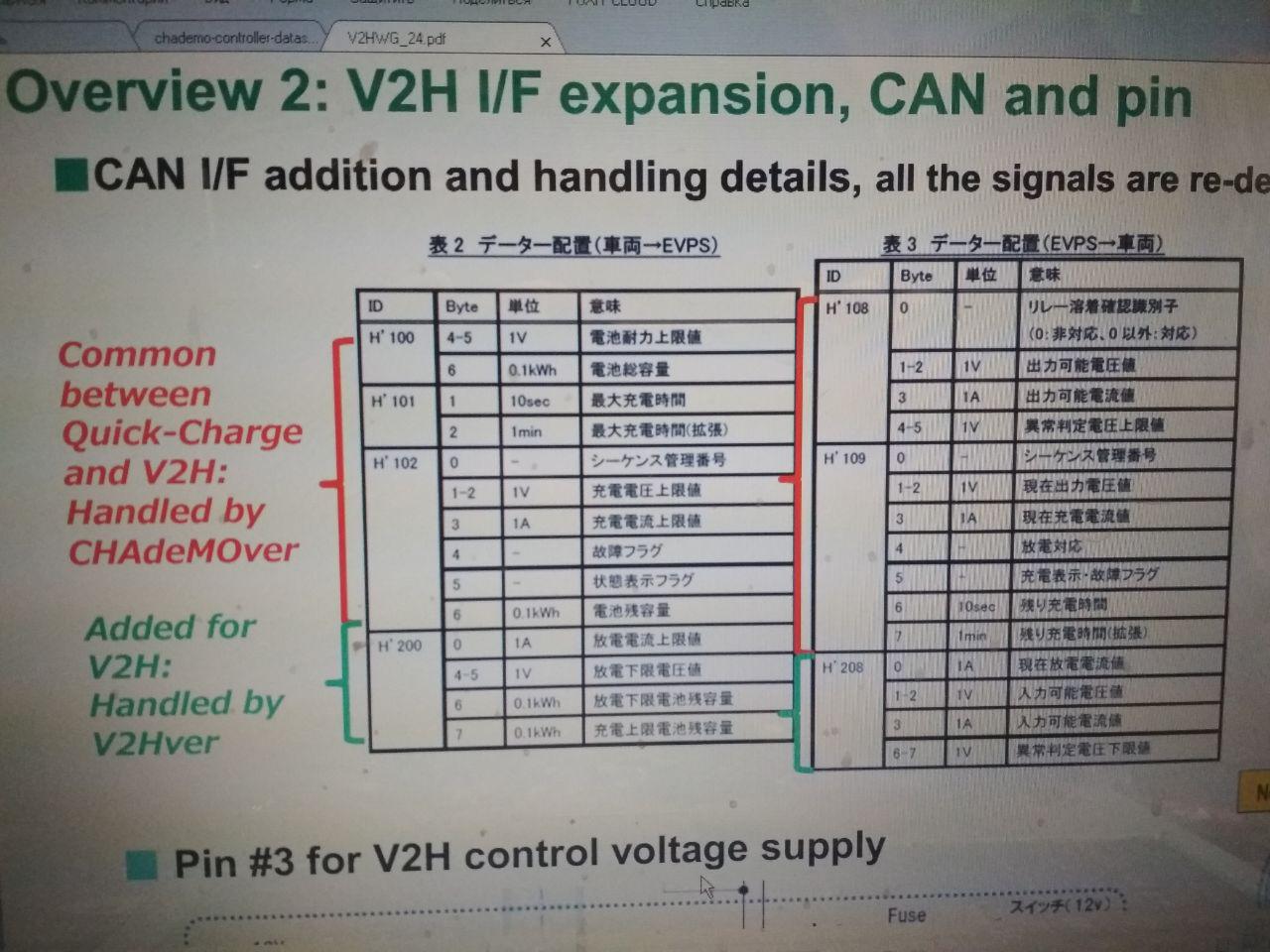

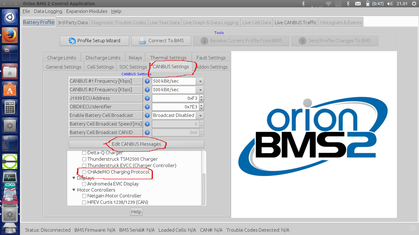

Hi all!
Does anyone know if CHADEMO CAN protocol was published anywhere? I seem to find the propper wiring and sequence of operation, but i wasnt able to find the actual CAN messages that car needs to send to enable charging.
http://www.mynissanleaf.com/viewtopic.php?t=7764
https://code.google.com/archive/p/open-chademo/
https://www.diyelectriccar.com/forums/s ... ht=chademo
If someone has knowledge of those CAN msg can you please share?
Or does someone know where to buy the protocol file?
Thank you

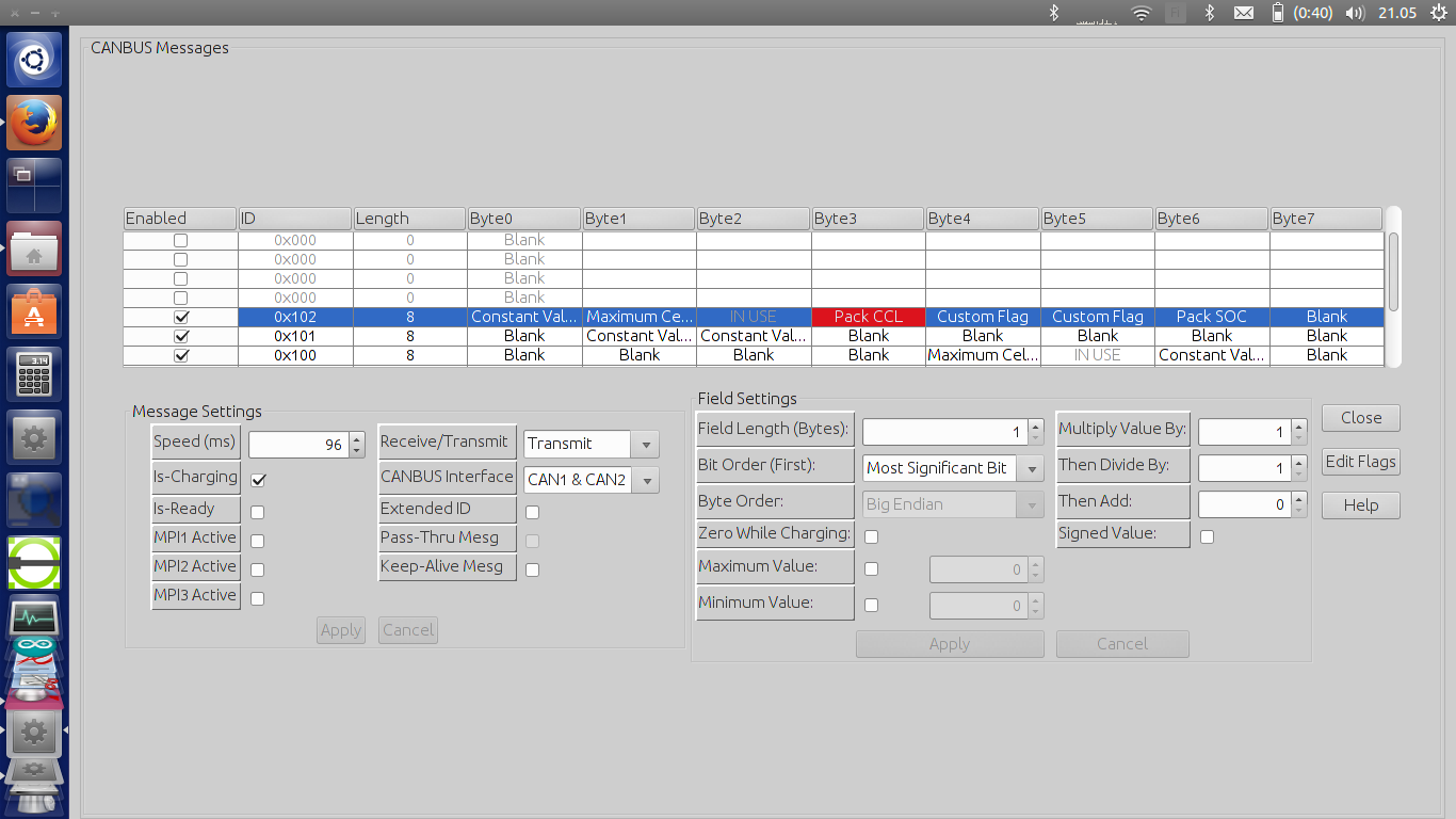

Re: DIY CHADEMO charging
Hi!
Orion BMS has chademo charging support. If you download setup java app for it, you can see from there canbus messages for Chademo that are implemented. Just click Canbus settings tab then select Chademo protocol and edit canbus messages.

Which file would that be? The file LoggerUtility.jar? I found some CAN references there, but not the ones i want...
Thanks, also i found further explanation on 3rd page of the forum thread, http://www.mynissanleaf.com/viewtopic.p ... 4&start=20
1.Car sends “Vehicle Stand By for Charging” message. [0x20]
2.charger responds with “Information about Charger” message containing “charging mode”, “max output voltage”, “max output current”, “max output power”. [0x31]
3.Car sends “Constant current request” message containing “voltage upper limit value” and “required current value” [0x26]
4.charger responds with “Constant current status” message containing echo of the “voltage upper limit” and “required current value” [0x37]
5.If no errors or interruptions repeat 3 and 4 while charging.
6.Car sends “Charge finished message”. [0x29]
7.charger sends “Charging stopped message” [0x38]
8.Charging stops.
Car to charger:
102 - Charge amperage is byte 3. Byte 6 is SOC, expressed as .1kWh per bit.
charger to Car:
109 - Byte 3 is again charge amperage.

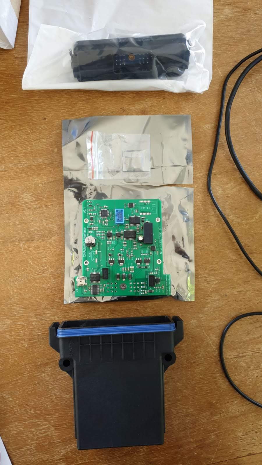

New Electric have a generic CHAdeMO interface controller that's designed to interface to any CAN based BMS. It's been fitted to two test mules and has recently completed it's compatibility tests. I don't have pricing or availability today but will know more after Fully Charged Live
Hi arber,
Download from orionbms.com Orion BMS 2 Software Utility (for Linux), extract it, run BMSapp.jar

I don't have all the details but the New Electric team is at Fully Charged Live next week... they'll be able to answer all your questions
