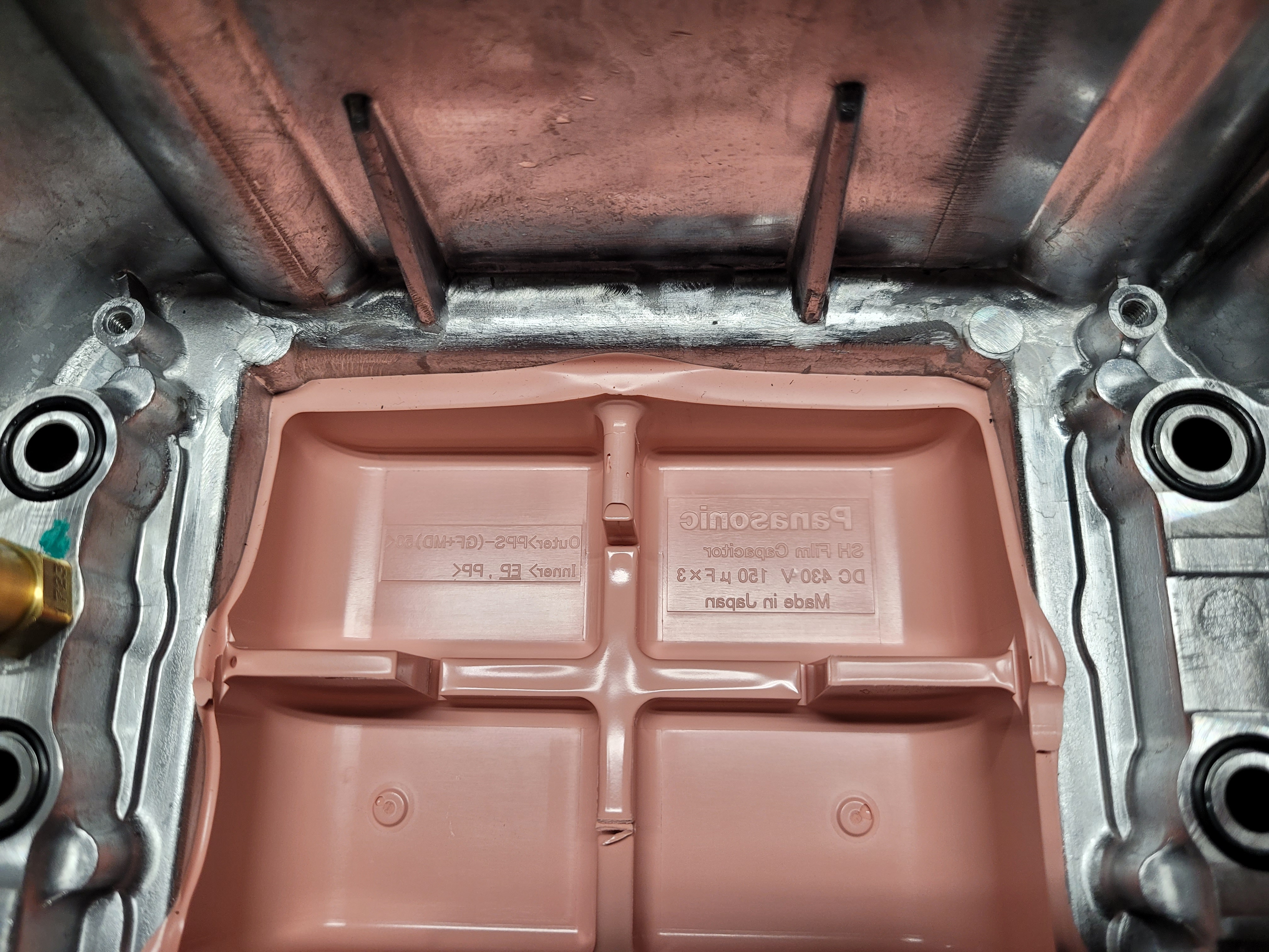

The panasonic capacitors are marked 430V 150uF x3

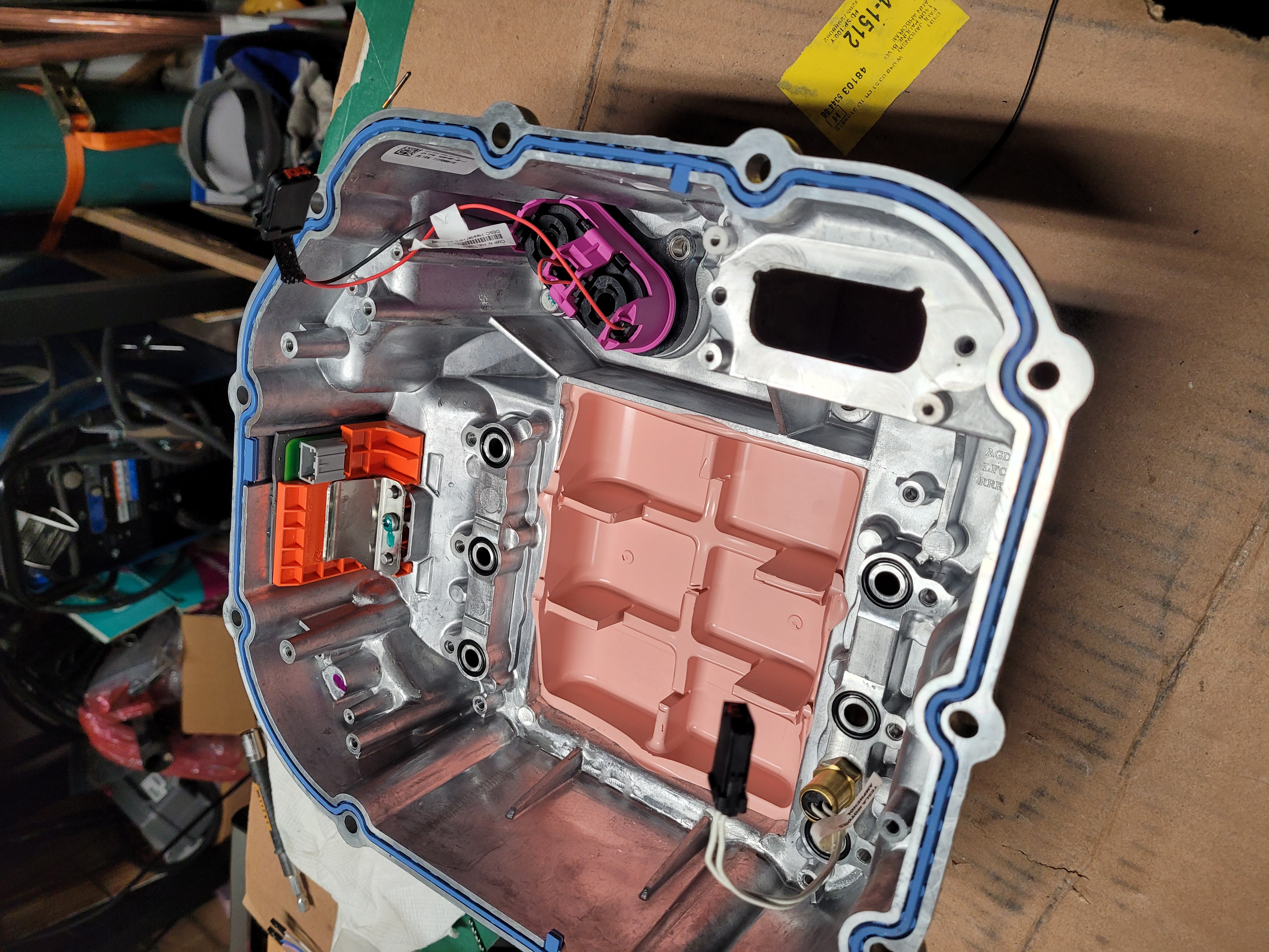

I am learning about this topic, i wanted to understand if it is an electrolytic capacitor?
Posts: 6759
Has thanked: 383 times
Been thanked: 1580 times
Re: Tesla SDU capacitor size / precharge
Only film caps are used nowadays for better reliability. Capacity is not important, ripple current rating is. And that is always quite poor for elcaps.
