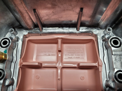

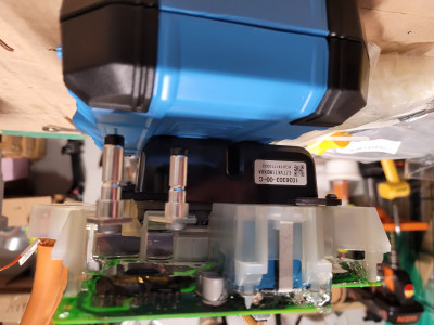

The panasonic capacitors are marked 430V 150uF x3

Re: Tesla SDU capacitor size / precharge
Only film caps are used nowadays for better reliability. Capacity is not important, ripple current rating is. And that is always quite poor for elcaps.
