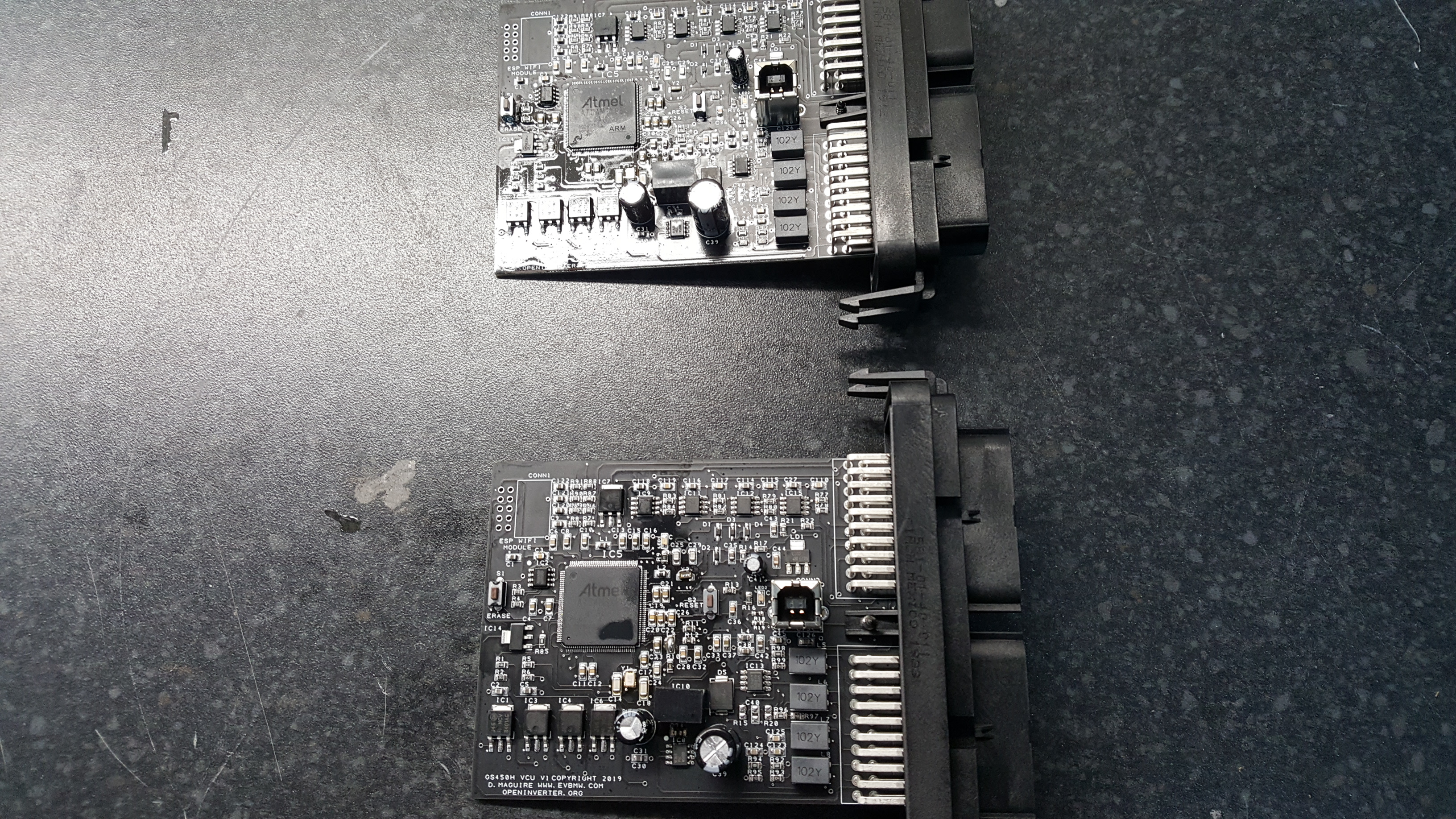

Bare pcbs for the Gs450h inverter controller have arrived:)

Built up two prototype controllers and starting in on decoding the wiring harness on the gearbox.
