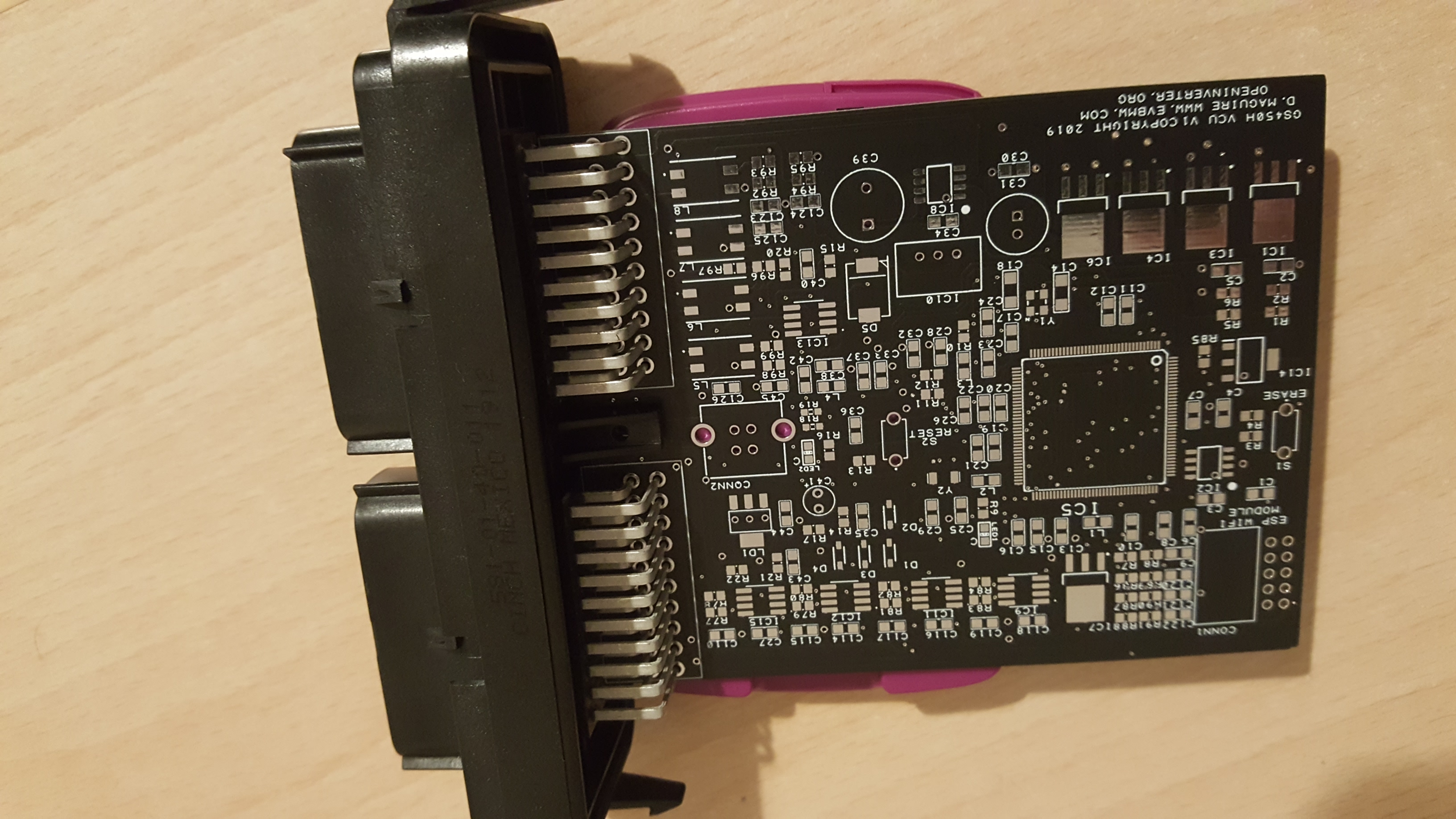

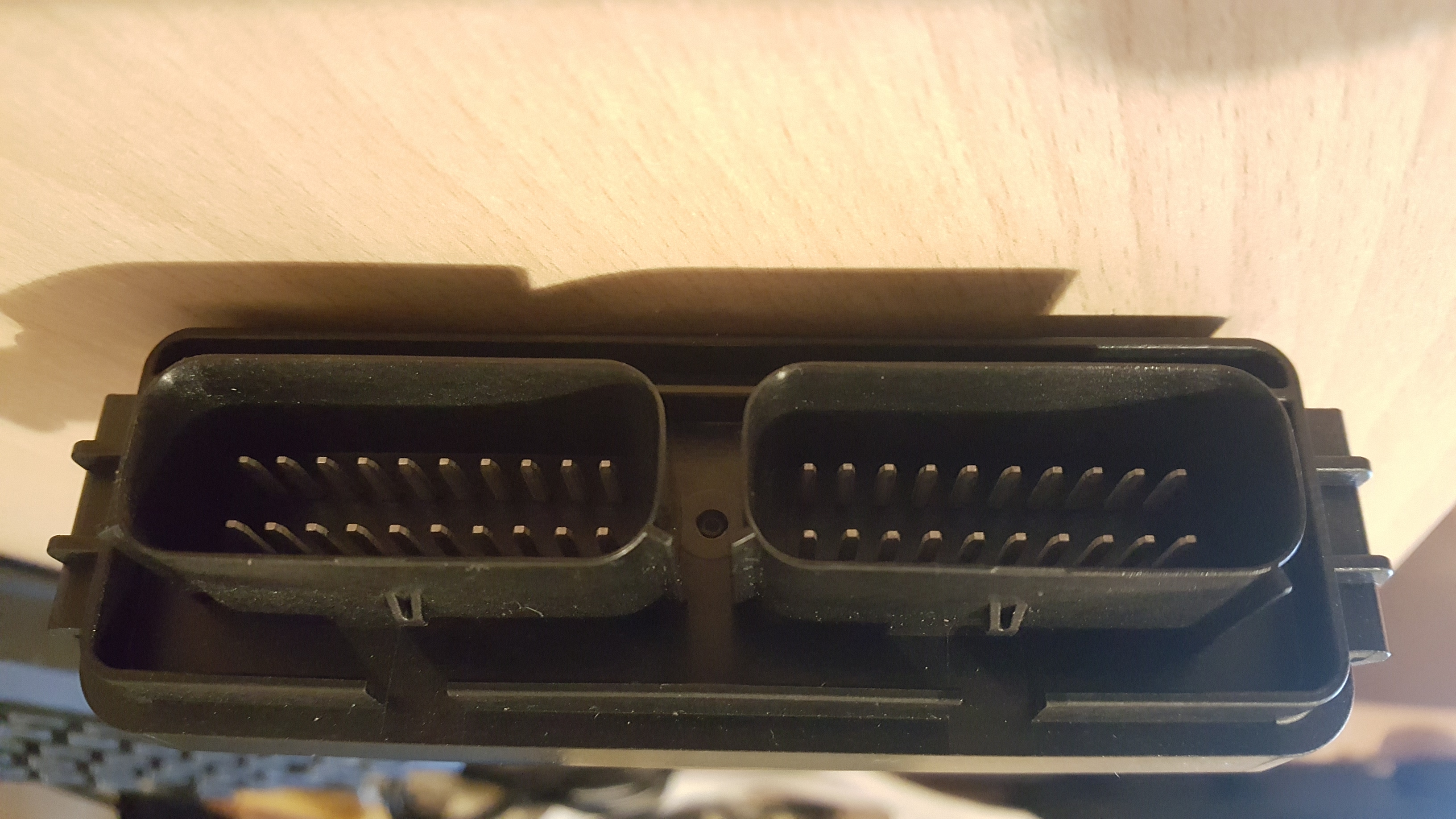

Update time!
I have the PCB fabricated and have populated it, everything on it seems to work fine except for the temperature sensing of MG1, MG2 and the oil pump, not sure what's wrong there, here's my circuit:
I have the inverter wired to the PCB and can communicate with it correctly for the first time! Here are some pictures:
The connector is a 34 pin AMP Superseal. I might not choose this connector again, it was a nightmare to assemble.
You can see a few additional wires on the board, I thought that the STBY lines on the MCP2562 had an internal pullup, I was mistaken!

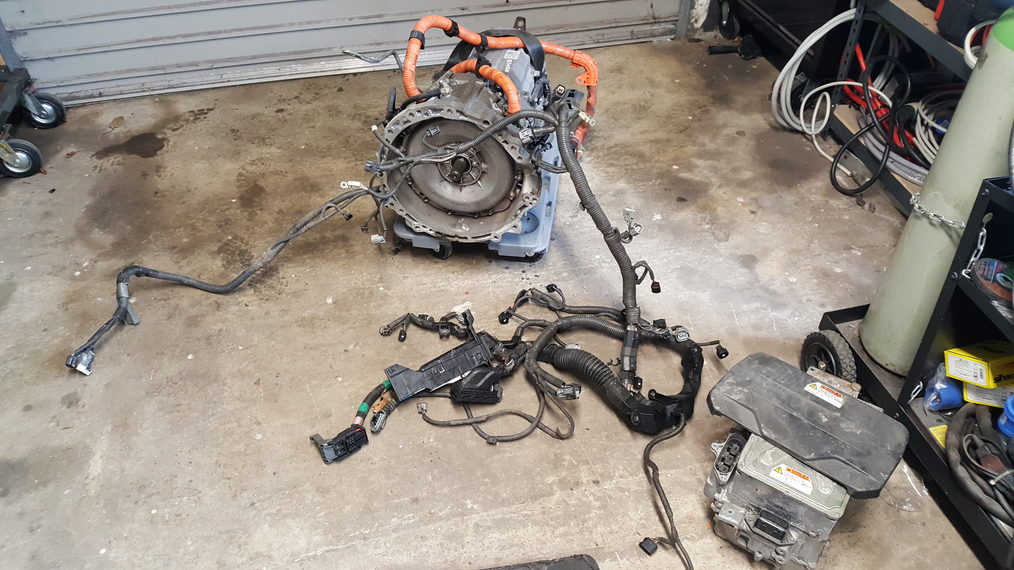

I now have the inverter working and the motor spinning from my control board with an accelerator pedal. Not much power or speed range right now as I'm running from a 12v 50A PSU, but this is plenty to prove the concept.
Regarding the ILKI, ILKO, and HSDN lines, here's how they work:
ILKI is interlock signal from the inverter. It is shorted to ground when the cover plate for the fuse, and the AC compressor cables are connected. There are small shorting plugs fastened to these. This is not monitored and can be removed, or wired into your own controller.
ILKO is the interlock signal from the HV ECU, it is shorted to ground when the safety plug/fuse is connected to the HV battery. The inverter seems to ignore this signal, this can be removed.
HSDN is the hybrid shutdown command. Connecting this to 12V disables the inverter drivers but keeps the control functional. Useful for when powering down, before opening contactors, perhaps. If this is left floating, the inverter will run.
The pinout for the inverter internal plugs, and what to do with each wire, is here:
Other connections are here, I have labelled the inverter with a marker:
The white connectors are connected together. The larger one is for the battery and goes through a fuse. The smaller one is for the AC compressor - you can see the interlock cable.
In reality, the "battery" connection would go to a 300v HV junction box, for charger, DC-DC, heater.
I wasn't able to correctly order the pins for this connector, and did not want to wait to reorder, so I extended each wire to the SuperSeal connector on the housing. You wouldn't need to do this if you had the original mating connector for this unit.

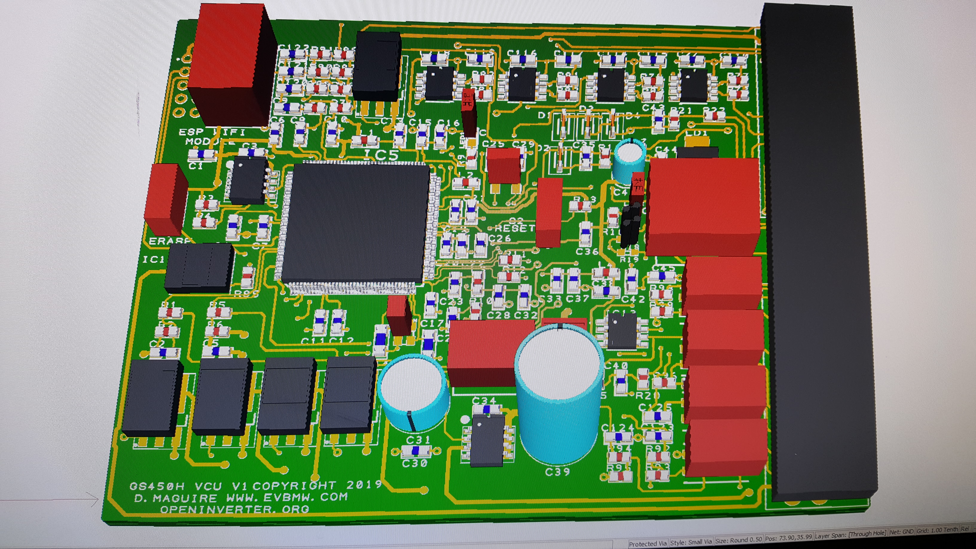

Have started on a design for a generic controller for the GS450h inverter and gearbox based on xp677's work.
https://github.com/damienmaguire/Lexus- ... Controller
This will be tested in the E65 7 series when complete.

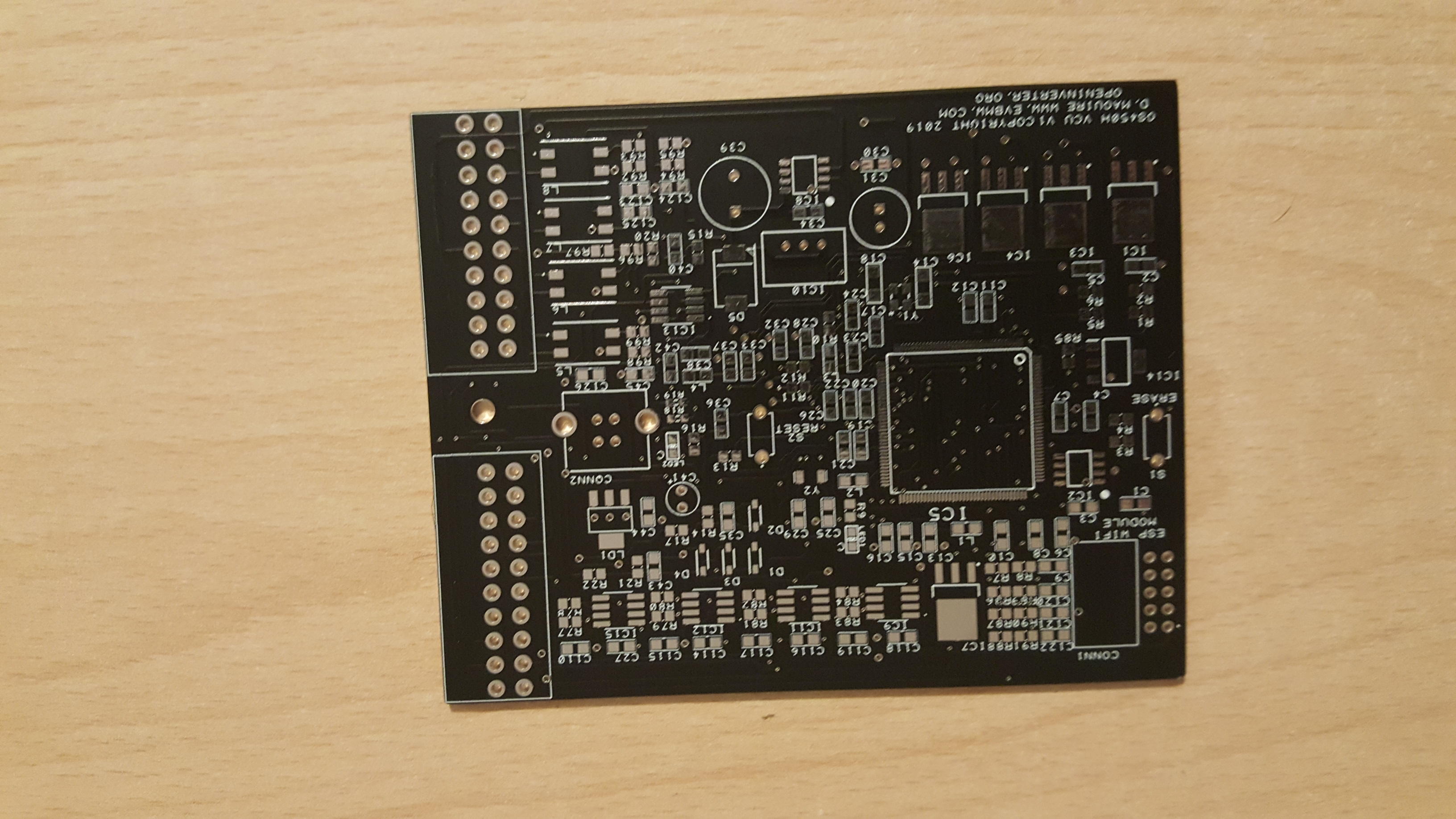

PCB design done.
xp677
- Posts: 441
- Location: UK
- Been thanked: 15 times
Re: Communicating with the Lexus GS450h Inverter/Converter
This looks great! It's much more compact than my design which was made to fit a specific enclosure and PCB header. Integrating the SAM3X8E has helped with this a lot - one of the things I struggled with on my design was the layout and size of the Due board. I've just finished version 2 of my own board, I kept the Due as I already have one, but did consider switching to an onboard microcontroller.

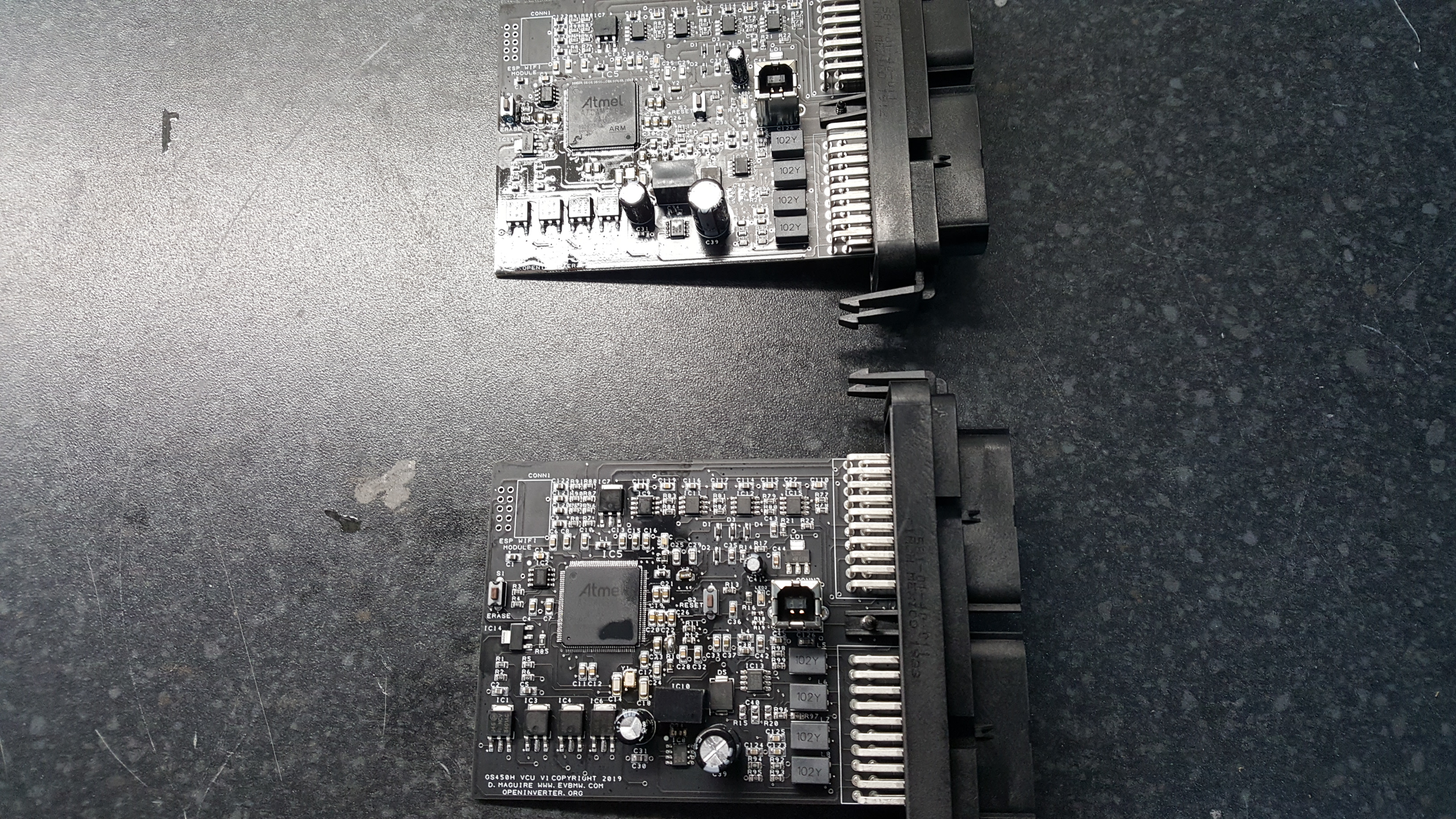

The 2nd revision of my board. As you can see by the long traces, the Due itself isn't ideal. Much nicer to use the onboard microcontroller. If I'd done that, I'd have likely got it all onto the left half of the board, saving on fabrication costs!
This board is further optimised to work in the FD RX7, and has many changes based on the IO of the car, and how functions will be shared between this board and the BMS (this board handles all cooling, for example, including during battery charging).
Examples of the changes include:
I'll likely not reference my work on this hardware again, as it doesn't apply to other peoples projects. Next up is finalising the programming for this unit. The program will be identical for both mine and Damiens controllers, other than pin assignments.

Bare pcbs for the Gs450h inverter controller have arrived:)

Built up two prototype controllers and starting in on decoding the wiring harness on the gearbox.
