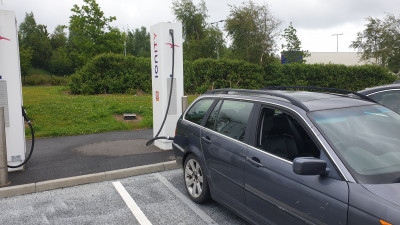

Few pics from yesterday

Raw shaky phone video from yesterday. I won't post this to pootube as I'll just get ten comments complaining about the audio and another twenty wanting me to fix some obscure problem with their Tesla. Hope to have a bit more in a few days.

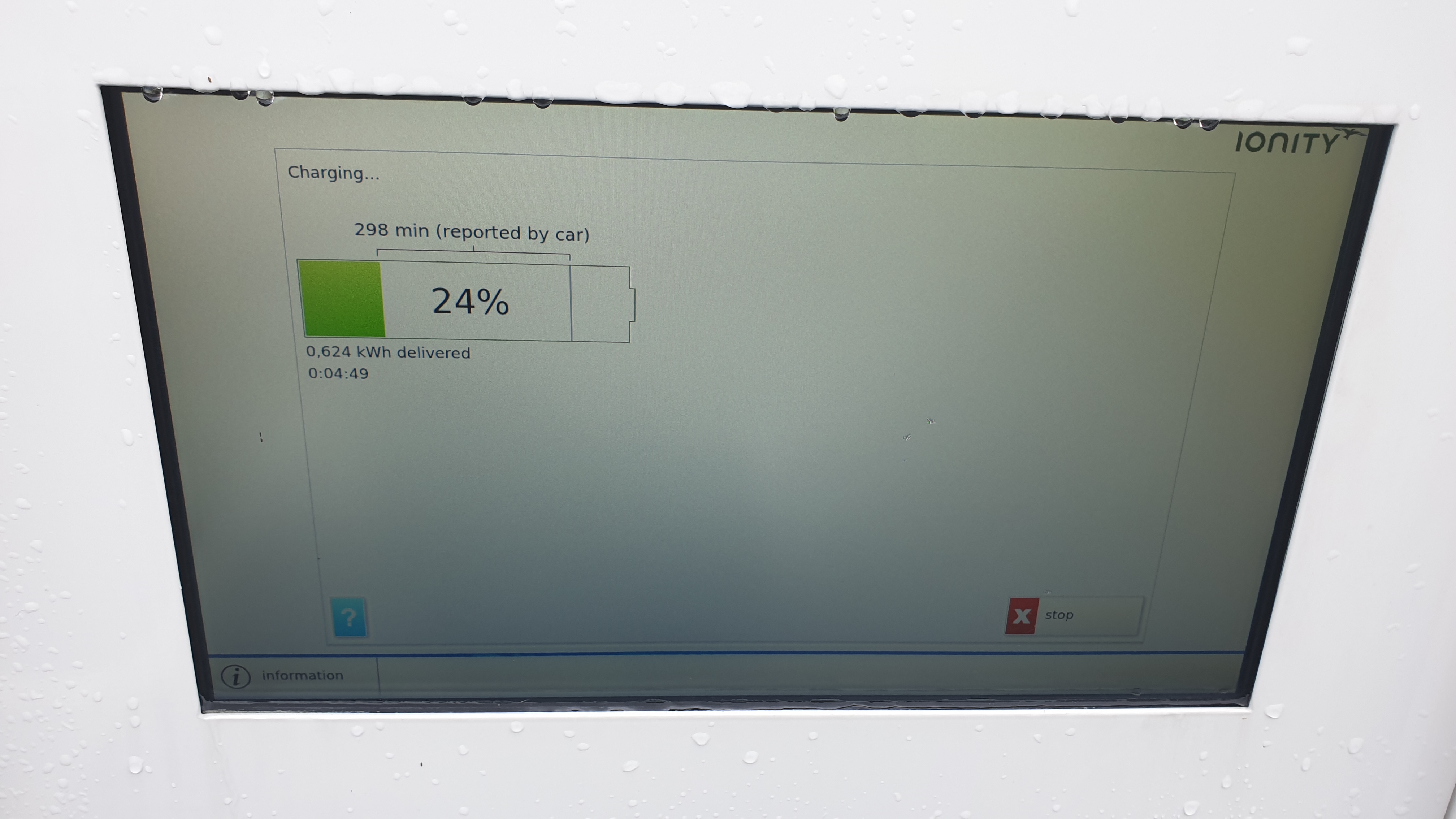

Don't you just hate those chargers that don't even show charge rate.
Saw a video recently (Gridserve's Ecotricity replacements I think), which actually showed voltage, current and kW - that's what we want!

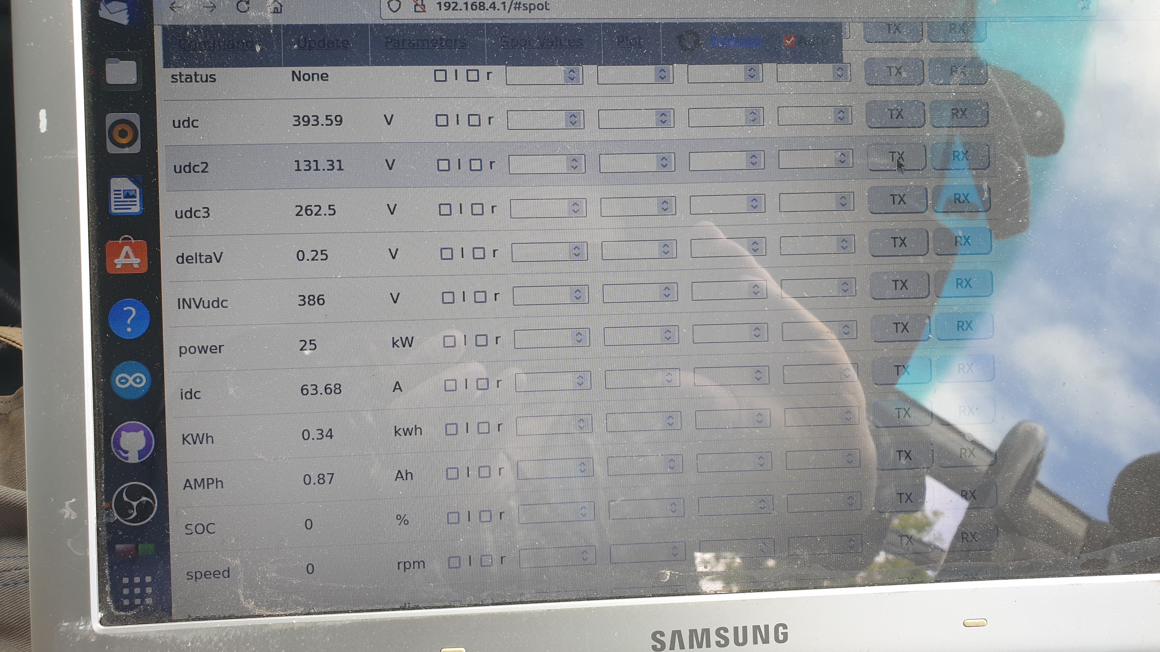

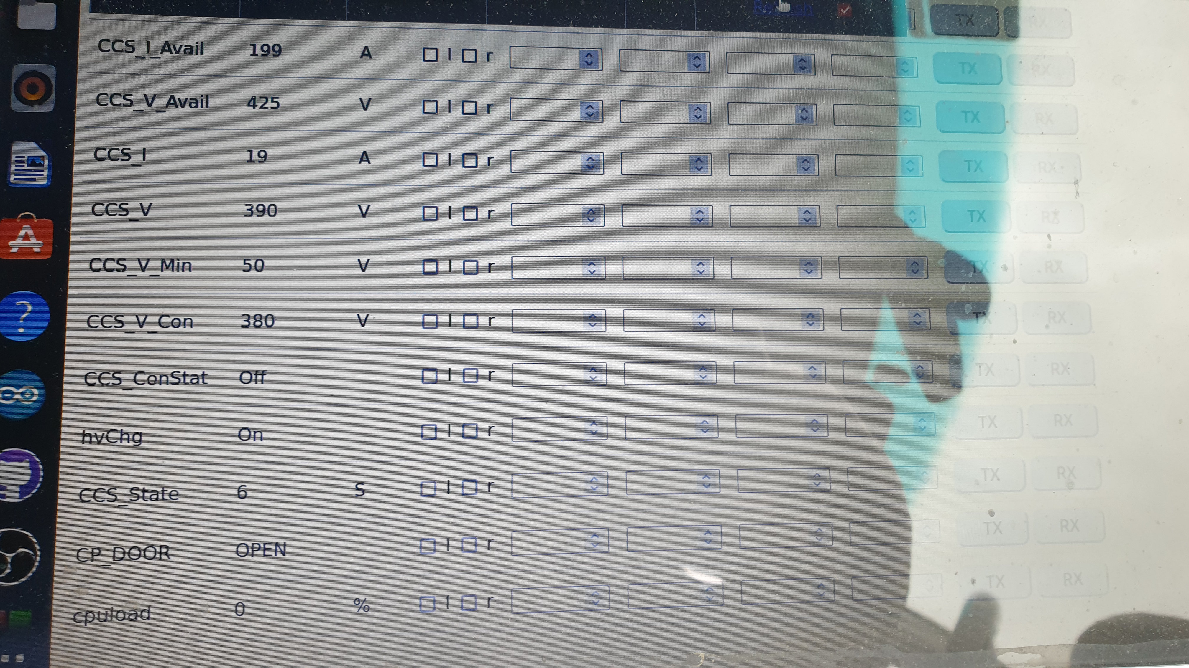

Today went for a bit more power. 25kw. Had to use the less powerful power company charge point today as my stupid bank insist on this text verification nonsense when ionity do a pre authorisation of 1 euro for every session start. This drives the app loopy and the charge point won't authorise.
Did a few tests :
1)Shutdown session, drive car, new session. No problems
2)Shutdown session, start new session. no problems.
3)LIM weld detects when cp door closed and ign on but happy to restart a session if not done.
4)My stupid cc/cv software actually sort of works.

First off, congrats to Damien for getting this working! You tested on an ABB which is great, they are particularly picky about isolation.
I’m working on finding an inexpensive PLC monitoring solution so we can verify the can vs the plc side. I’m also trying to get a plc log of a stock i3, to see its plc “accent” if you will :p. Unfortunately I am really busy for a short while, and it will probably be a bit before I capture an i3 plc log. As soon as I can, I will.
As far as the “negative” current ability, I think this is a vestige from the CHAdeMO code. In Japan, cars by law must support v2g, and I believe this defacto means CHAdeMO v2g support is mandatory. DIN 70121 (pre ISO 15118) does not support bidirectional, nether does ISO 15118 except for the latest -20 version. I can’t wait to see what the car is saying for this negative value.
