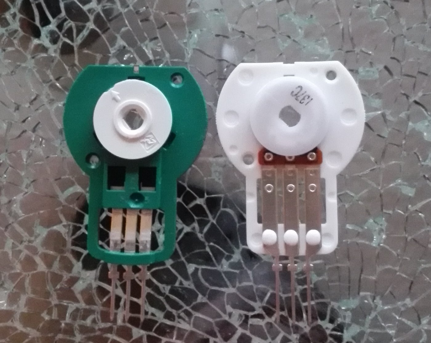

I found that the PTC heater wouldn't stay on consistently and therefor didn't produce much heat either. So I checked. Now, I have fitted a microswitch to the heater flap servo, to enable the heater when the flap is in "full heating" position. But it turned out the servo drove back and forth so much that it disabled the micro switch for prolonged periods.
The servo has a simple pot inside for position feedback. These pots tend to wear out and the dust that gathers around the wiper will produce inconsistent resistance. Simple mans fix: WD40 :D The servo is now also much quieter as it doesn't move around anymore and the heater stays on, yay :)
Posts: 6769
Has thanked: 383 times
Been thanked: 1589 times
As always, the WD40 "fix" didn't last long. So after a long search I found sortof compatible feedback pots (the white one is new, green original).
https://de.aliexpress.com/item/4001252117889.html
When measuring the old pot with multimeter you could see it never really settle on a value. So now swapped out 3 of the servo pots and it is again quiet and hopefully the passenger side servo stops getting stuck in cold position.
Also reprogrammed the heater control. I had made it cut back heater power when voltage sags below 13.2V but at the point where it measures this seems to be the case. So now 12.8V is the derating point. Good enough to never run on the 12V battery alone.
