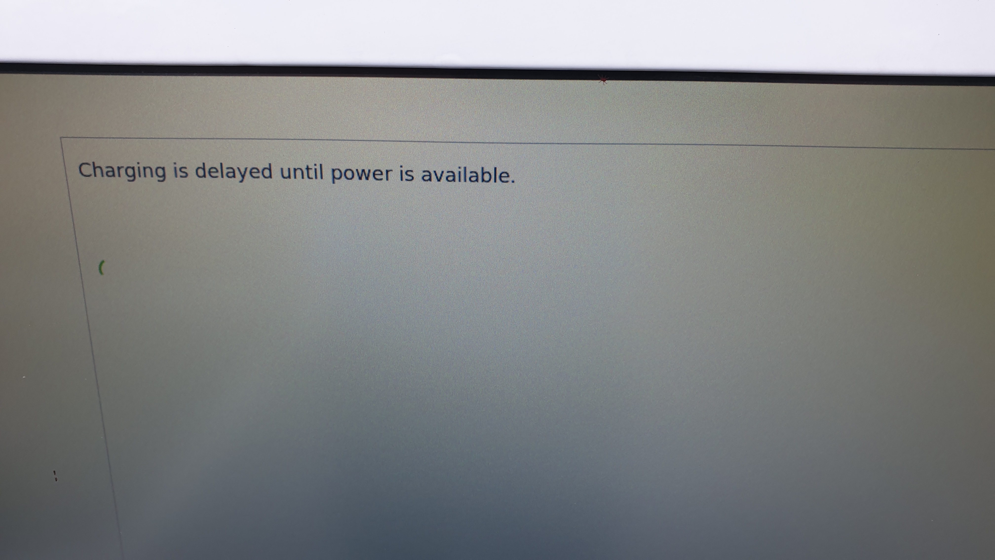

Can log time from the E46 at various charge points.
Efcaec QC45. Works perfectly : https://github.com/damienmaguire/BMW-i3 ... harge1.csv
Ionity ABB : Fails at init stage and display as per attached pic : https://github.com/damienmaguire/BMW-i3 ... _e461.2csv
Circontrol Rapiton 50 : Starts up, closes contactors, faults out. Now tested on 3 of these units they all do the same :
https://github.com/damienmaguire/BMW-i3 ... _fail1.csv
All tests done with the same setup.

Jack Bauer wrote: Thu Jun 17, 2021 10:31 am Ionity ABB : Fails at init stage and display as per attached pic : https://github.com/damienmaguire/BMW-i3 ... _e461.2csv
That might not be the lim here!
I have seen that charging delayed message about 2weeks ago with Model 3 on a 50kw ABB unit when I started from the app. App showed it didn't start. Then after short while I tried again to start from the app and it said it cannot start because it is allready charging and indeed it started while app didn't seem to have a clue what is going on.
Did you start with app or tag?
Posts: 3667
Has thanked: 12 times
Been thanked: 353 times
I used the app and yeah had all sorts of problems. Interesting. Thanks for the heads up. Jesus, imagine if petrol pumps worked like this!

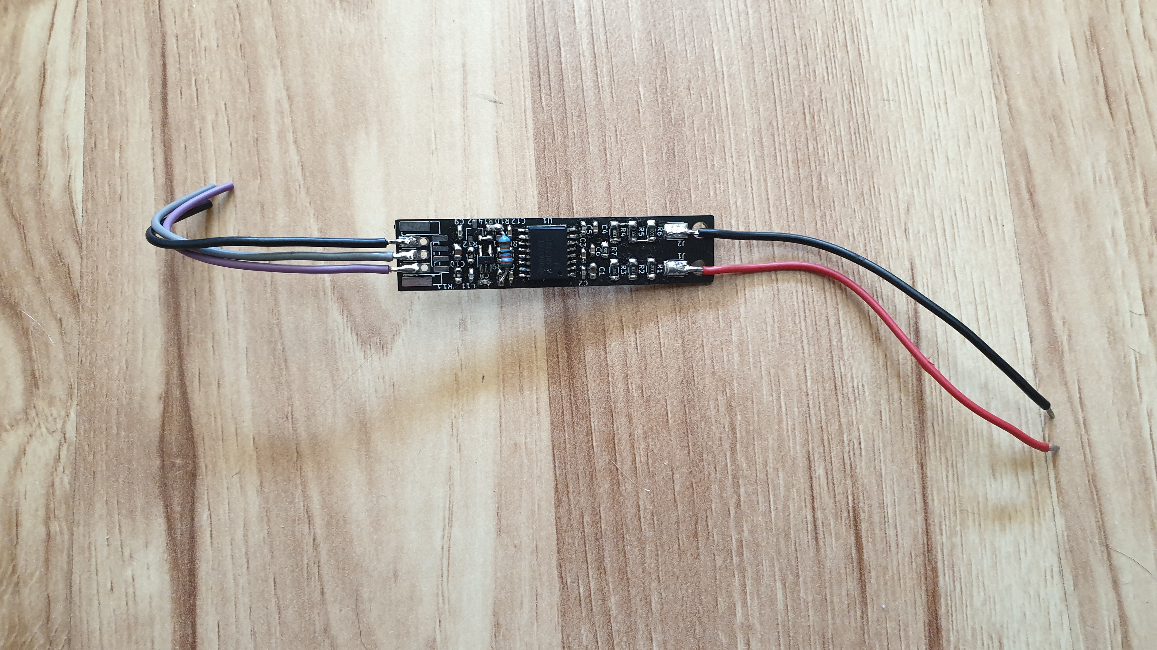

Voltage sense board just arrived thanks to muehlpower :D
Also got the keys to my i3 ....and a bdc...
