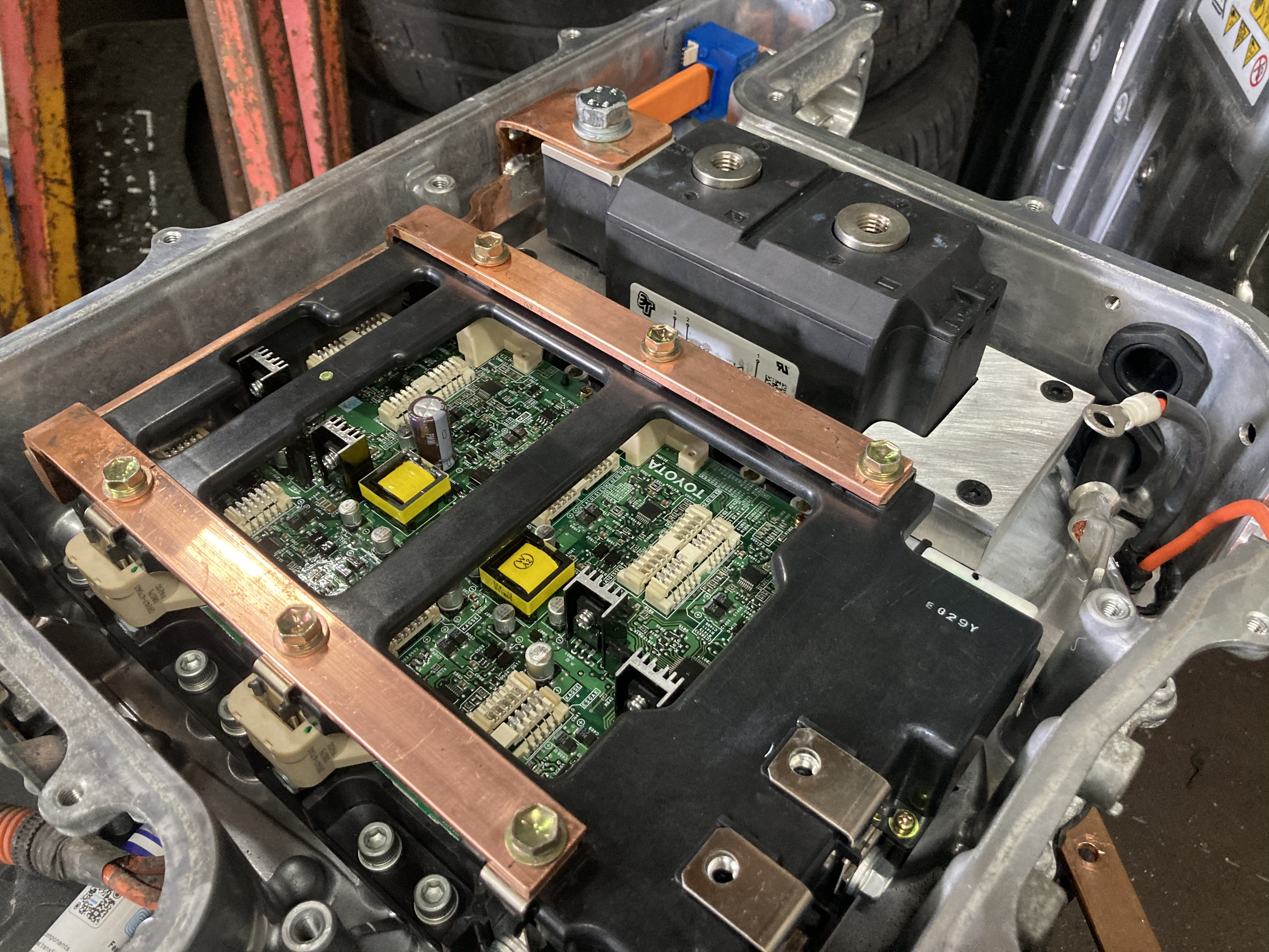

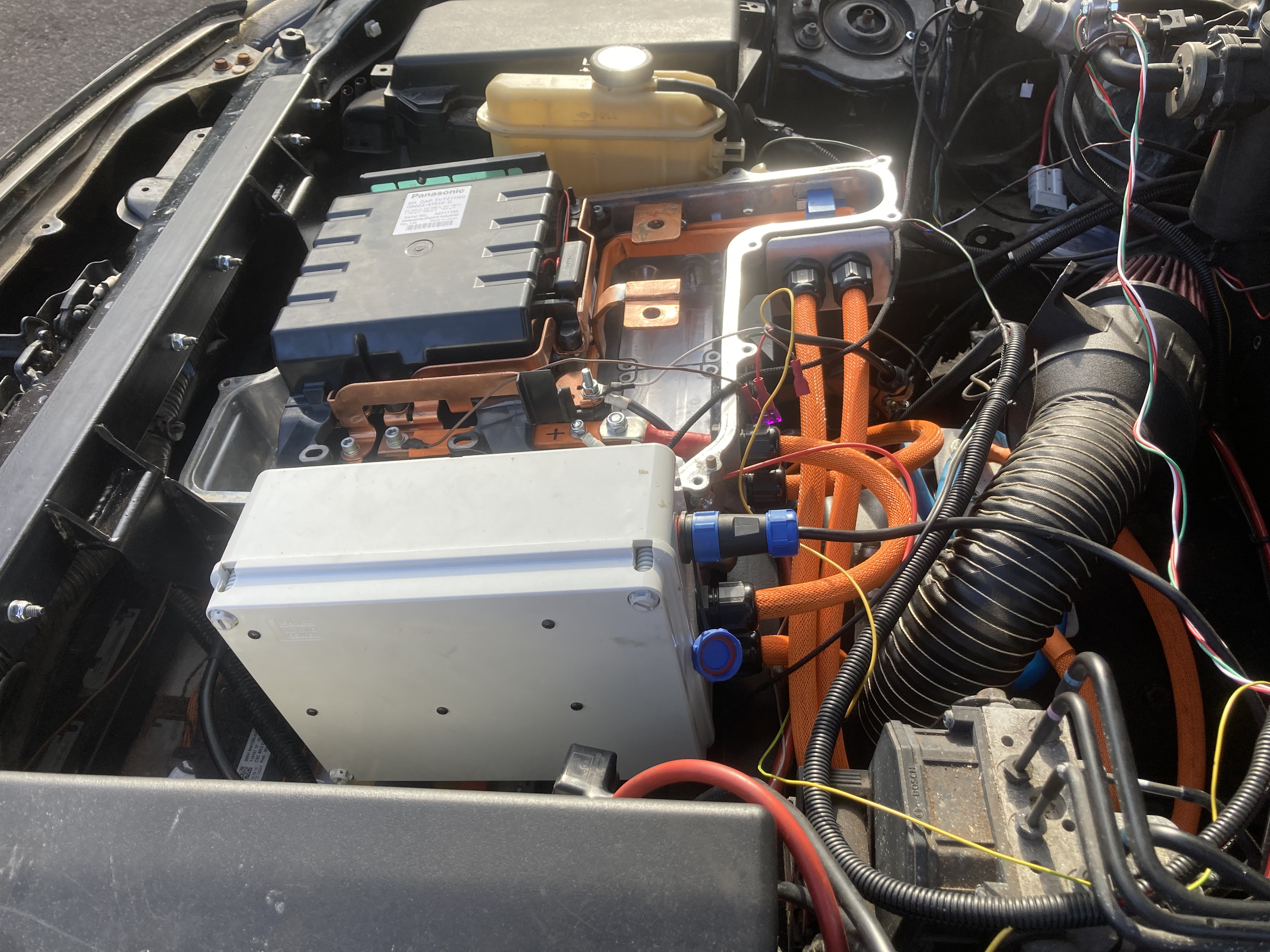

Well a little reconfigured today swapped out the power stage for a good one, removed the big diode, sorry for the mess, but I’ve managed a few laps around the block and have hit 150kw according to the bms. No pops or bangs yet.

Post by Ev8 »
Currently switching at 4.4khz, no cooling plumbed in yet just looped back into itself and filled with water but inverter temps not gone over 40c

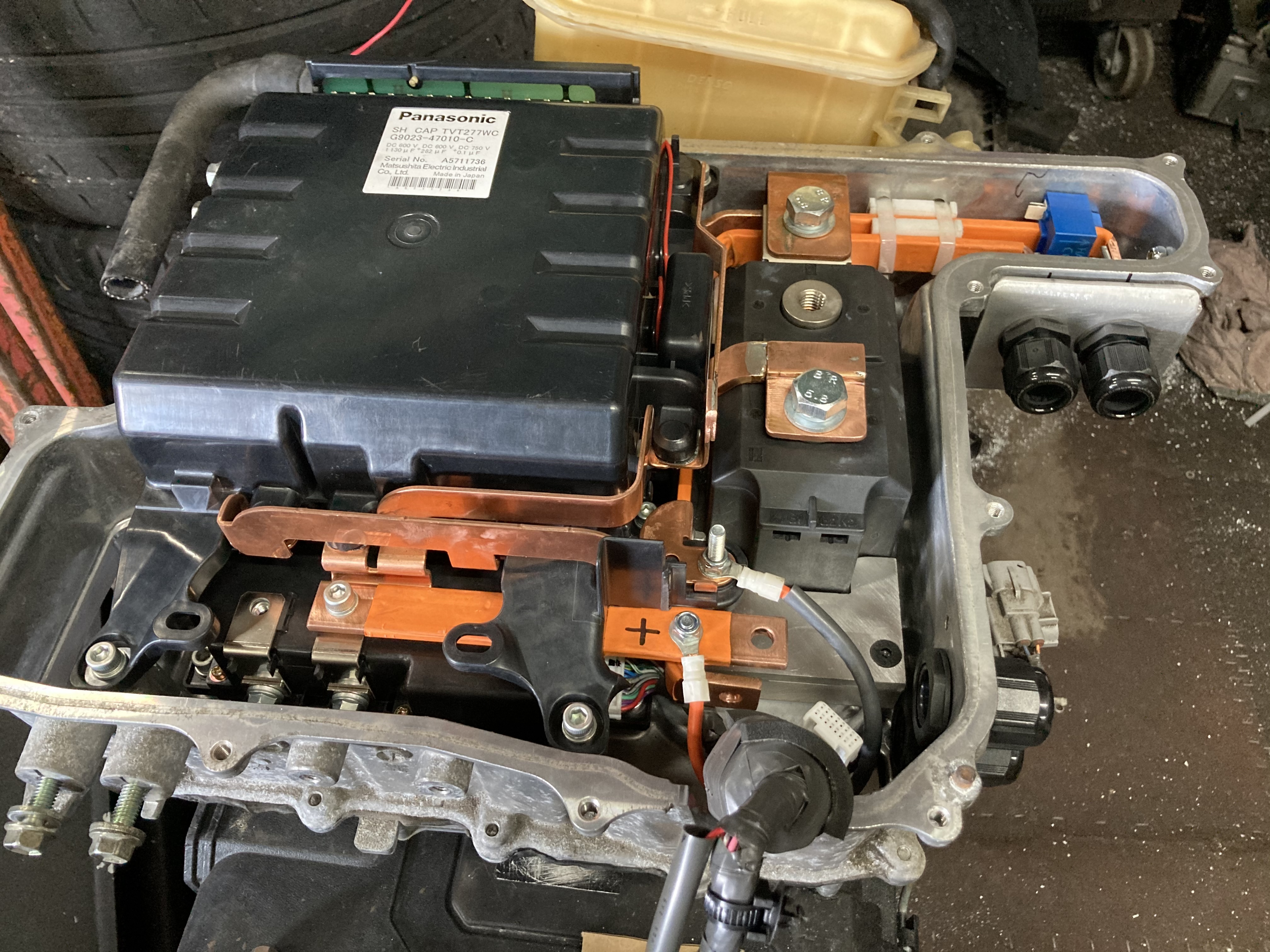

Ev8
Posts: 818
Has thanked: 43 times
Been thanked: 163 times
Re: Prius Gen2 Inverter DC Motor Controller
Post by Ev8 »
yes running as standard half bridge, all phase outputs paralleled to positive motor terminal, all phases switched together from the same pwm source,
Battery positive to positive on inverter brick , Battery negative to inverter brick negative and motor negative, capacitor modified so all positive and negatives are joined and pick up from the inverter brick terminals (as standard one part of the capacitor is linked to the boost stage only) no boost inductor or brick, I will take some pictures once ive tidyed up my bus bars and removed the legs that went to the diode i dont need.
i am Running 300v nominal 80s BMW PHEV modules (3 packs in parallel)
