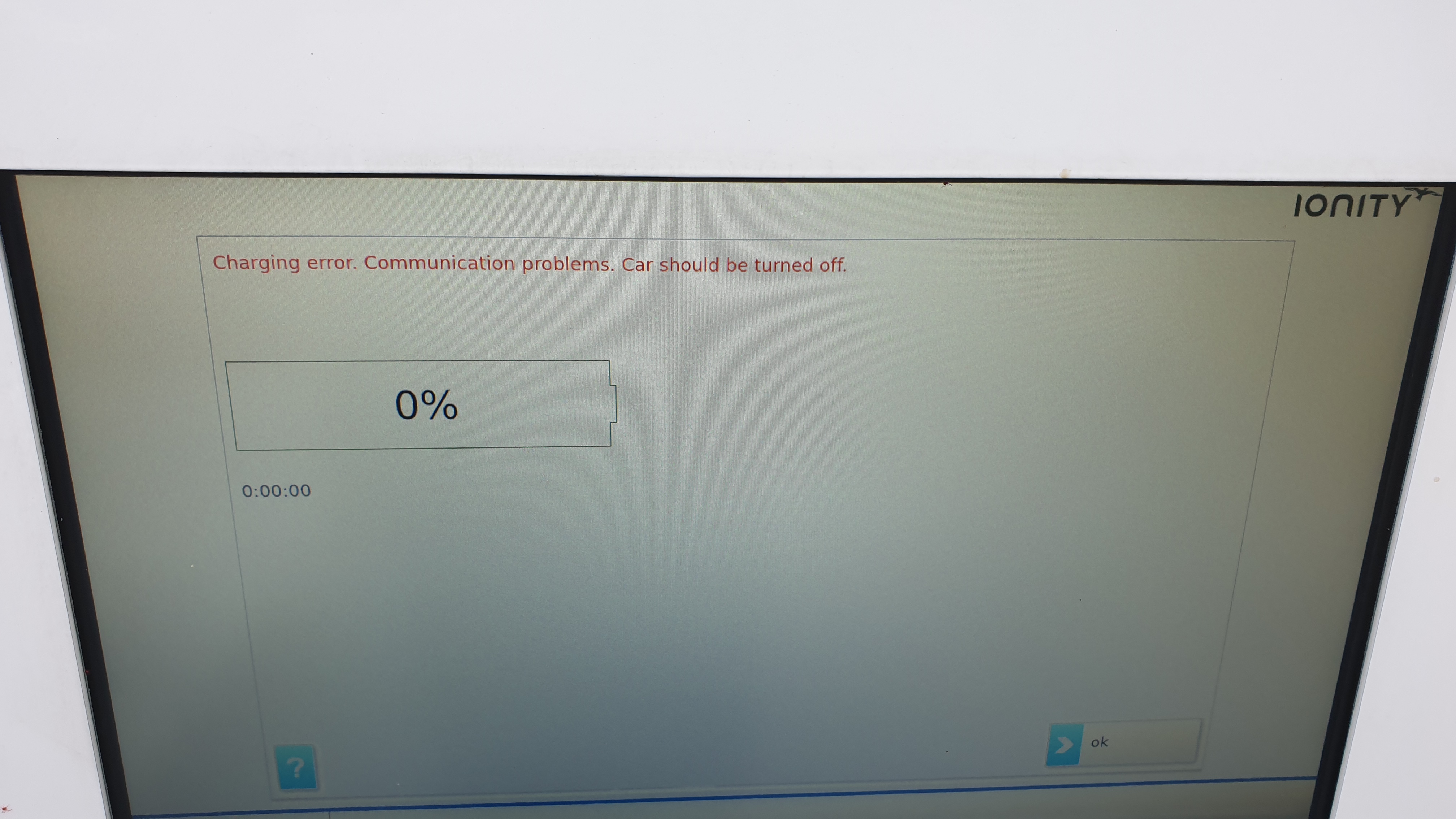

Mr.Ionity still doens't like me and complains about power availability even with plenty of money on my account. I did a capture and let it fully time out and got the attached on the screen before unplugging.
Now I caught something interesting. After pulling the plug I caught a burst of spi data. In afterplug.sal
Gassing up the car now and fortifing myself for a trip to the worst located charge point in the entire country to get a Circontrol capture.

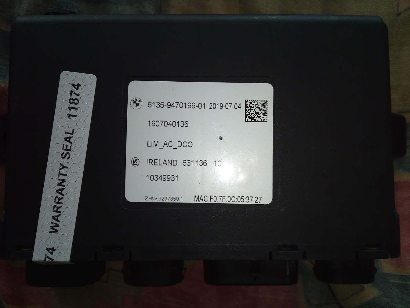

Just turned up in the post...

The ionity thing has me driven a little mad. I even called their support line. Rebooted the charger etc. No joy. Support can't see any feedback info from the charger either.
Edit: huh. We never even see the SLAC commands in the ionity file ...

I think you are dead right about the ionity plug issue. I actually called their support line and the agent was adament about having the plug inserted fully and asked me to hold it in place at one point. That and my crappy cheap Aliexpress ccs socket.... Yeah. Need to do some investigations.
