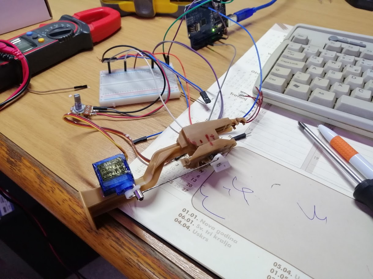

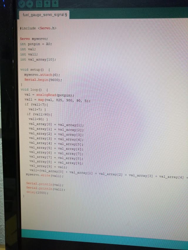

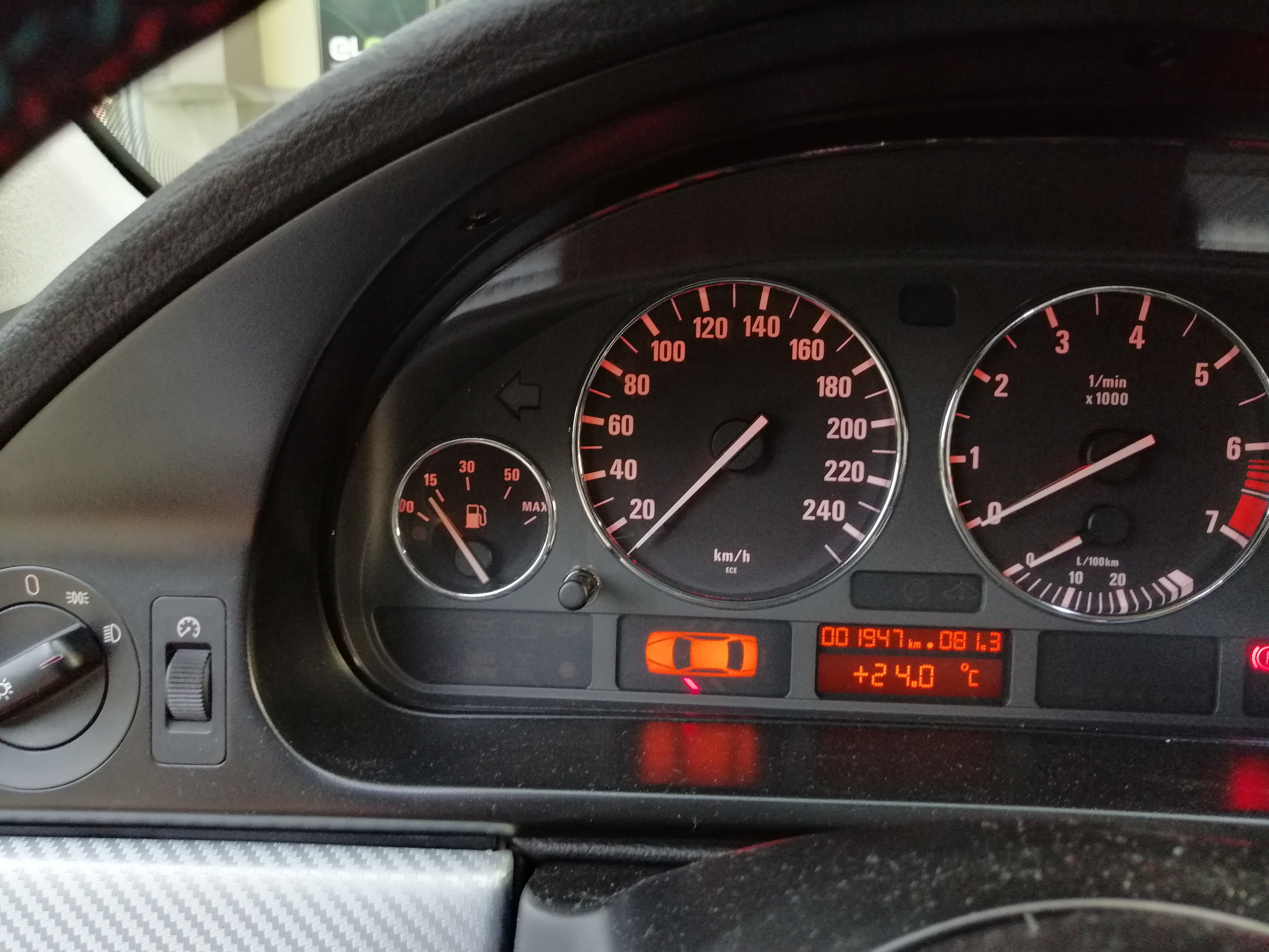

Car got new odometer kilometer . I finished fuel gauge function. Arduino is reading voltage every ( with voltage devider) 1 second and calculate average of 10 last readings to reduce significant current voltage drops and it is working :)
