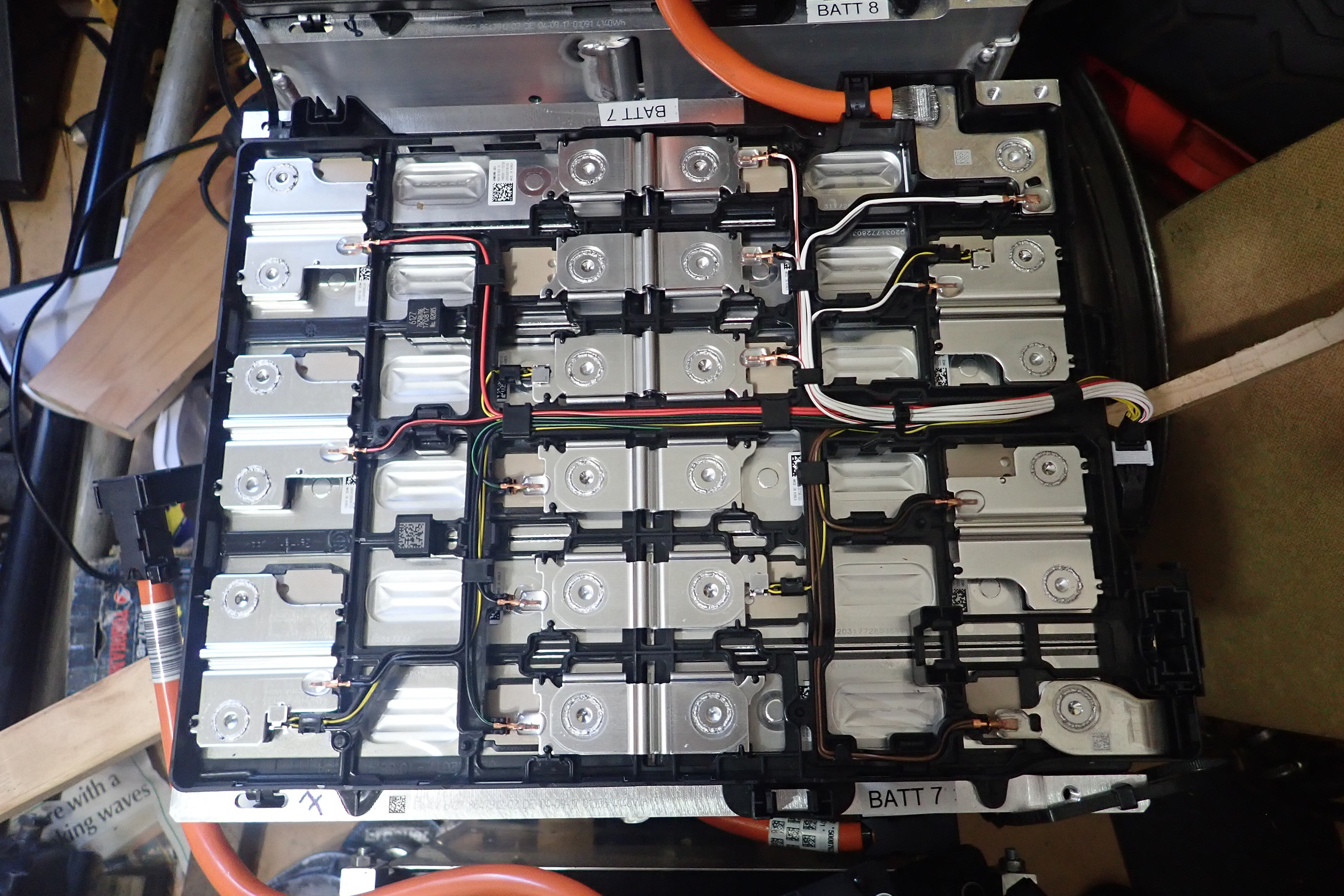

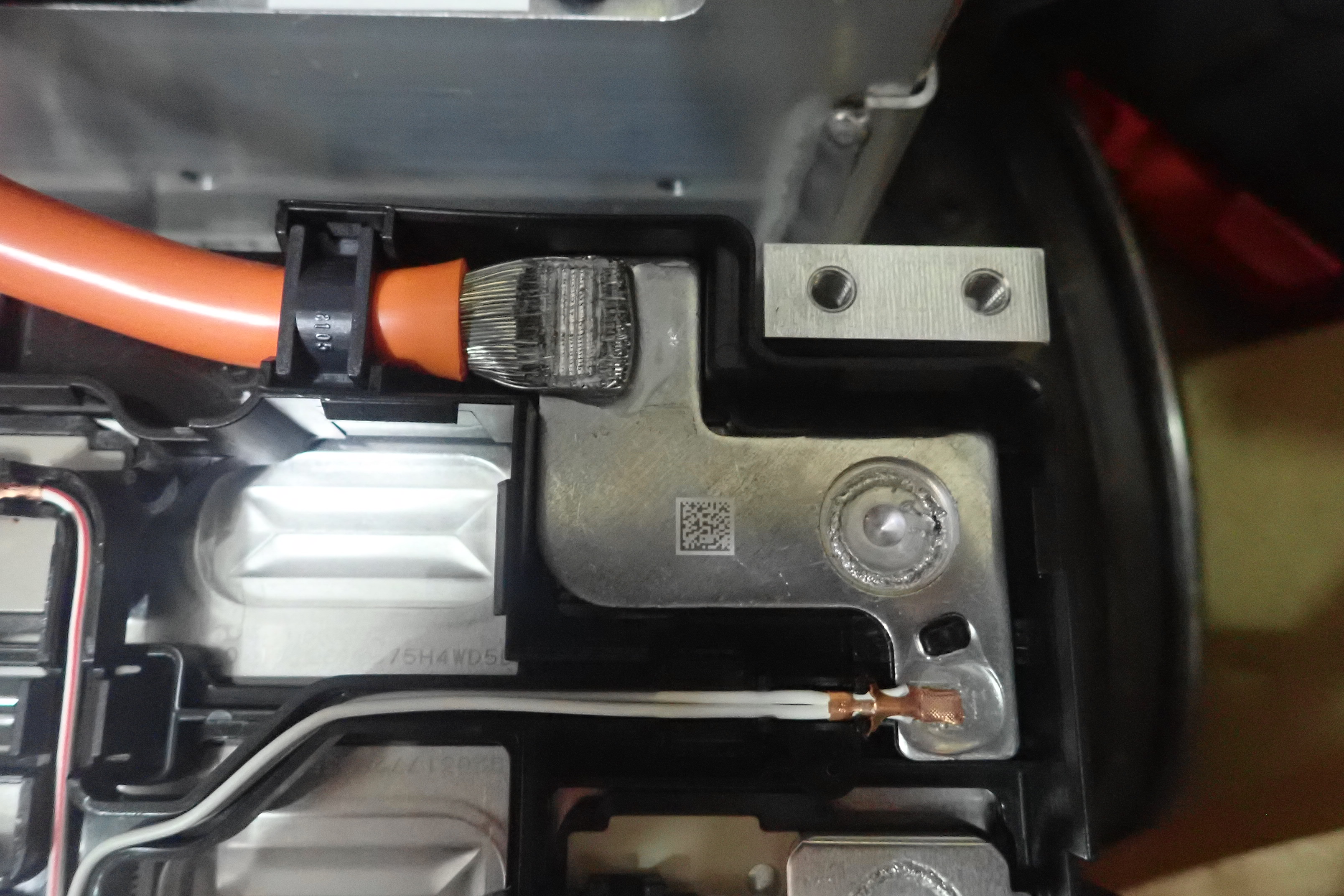

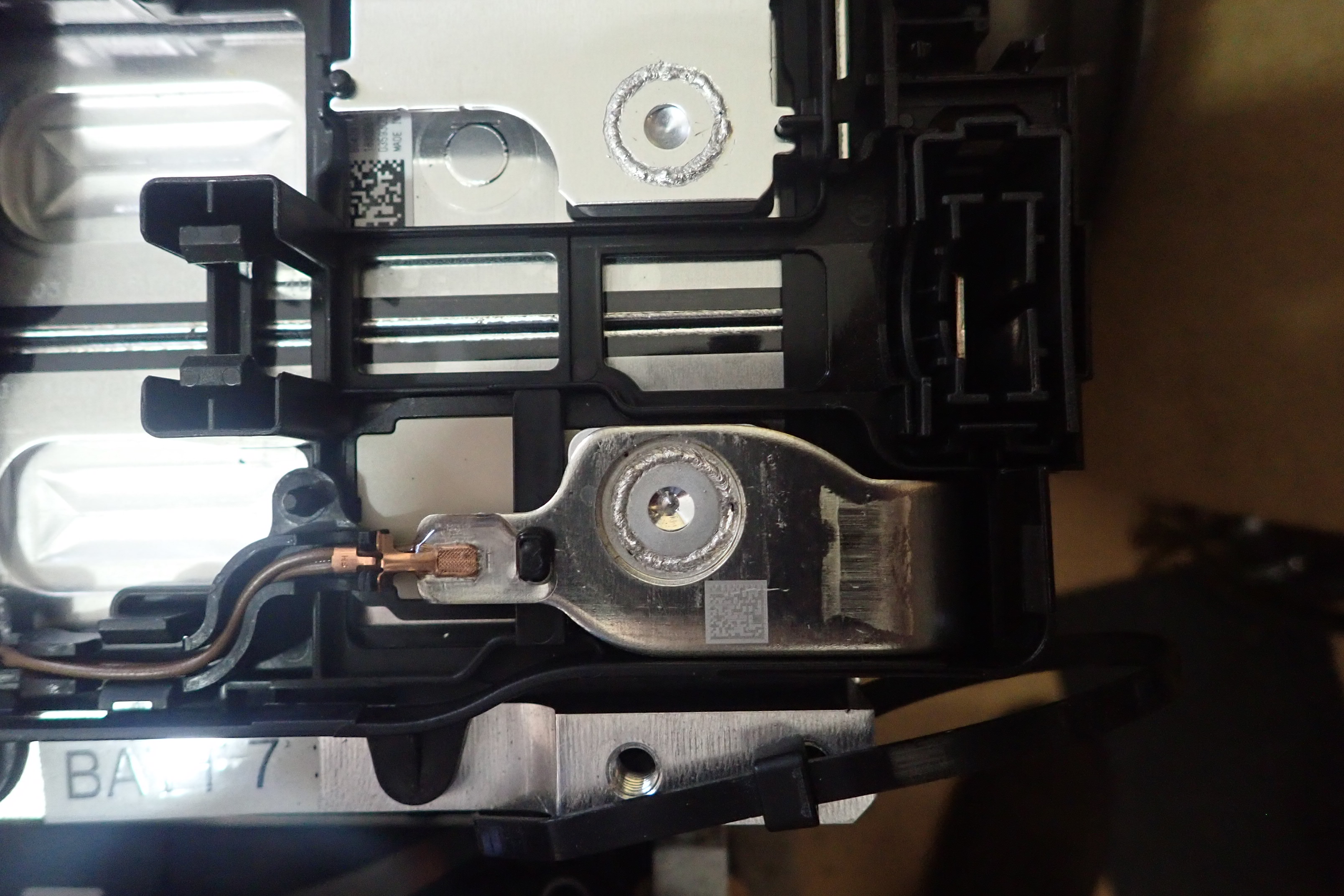

At some point I'm going to have to alter the aluminium cables on the BMW i3 battery modules to allow them to be connected together in the new pack orientation and to the inverter etc. Not only are the cables aluminium but the bus-bars coming off the battery terminals are aluminium and are laser welded to the battery terminal.
The main difficulty I see the dissimilar metal reaction between Copper and Aluminium when joined which with the slightest moisture will be an intermetallic nightmare. Also the practical process of joining two aluminium cables with good electrical integrity is a bit of a mystery to me.
I've no experience working with aluminium cables let alone large high power power ones like this so an after any experience or workarounds for this problem.
Some photos of the battery terminals and bus bars.
