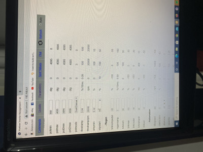

Post by Lowcoe »
Hello all. Regrettably I have a question. Test fire stalled at getting positive contactor to engage. I’ve read everything many times. Sorry for this but I’m stumped.
I have 4 tesla modules in series for 95 v. Test settings as follows from reading all posts.
Udc nom 95
Occurlim toggled from neg to pos and back
Udc min 0
Udc max 100
Throttle pot : dual channel
Idle mode off
Udc sw 85
Contractor trip : precharge on changed from default
These are listed in order they fall on page. All others are defaults.
Error message reads
[18] stop- over voltage
If nothing is obvious I probably need to pull the motor and check solder contacts as this was my first attempt at fine soldering
Thanks in advance. Apologies for my ignorance

Post by Boxster EV »
Lowcoe wrote: Sat Jul 24, 2021 8:08 pm Hello all. Regrettably I have a question. Test fire stalled at getting positive contactor to engage. I’ve read everything many times. Sorry for this but I’m stumped.
Udc nom 95
Udc min 0
Udc max 100
Idle mode off
Udc sw 85
Error message reads
Please post a full list of your parameters.
What firmware are you using? Have you tried a known good LDU version like this (.bin):
viewtopic.php?p=26478#p26478

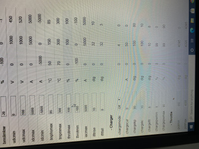

Look at UDCSW. It’s not been lowered so main contactor won’t close. Try that first and make sure you save. After testing, put the settings back.
I think most people are still running the LDU firmware I mentioned in my last post. I’d suggest you try it as it’s known good. Click on the .bin file, save as to your PC. Then go to the inverter firmware field and upload it.

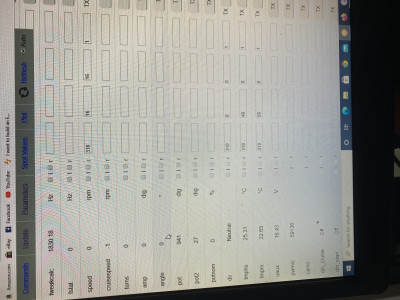

I ran into some problems with the LDU after a 2mins test driving on the street. I think we did 10kmh maximum. It has worked flawlessly on the bench with 400v. The cooling wasn't working during test drive.
After the test drive car was powered off. 1min after we turned it on again but this time the following accured and has been happening ever since: Press start, main contactor closes for 1 sec, then opens again. Overcurrent is displayed as error.
50% of the time it actually goes in run but when throttle is applied it immediately blows the battery fuse. (400A fuse). Im testing with a 80v battery with a 30a fuse now. No need the blow more 400A fuses than necessary=).
Is there anything else I can do before disassembling motor from inverter to ohm-measure the igbts?

Clanarn wrote: Fri Aug 27, 2021 9:28 pm Hi,
Hello
Did you have readings of inverter and engine temp?
I have experimented with pwm controlled pumps, when driving at aprox 50km/h there is som heat produced, not mutch but with no active cooling you have some real problems i guess =(
Dont know what brand of fuse you using, but short therm load can be 3-5 times greater than rated current.
When you describe your problem it sounds that a row of positive or negative igbt is shorted to ground or positive.

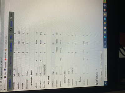

I’d be surprised if you damaged the inverter on such a short run with no cooling. Be interested to see what your max temp settings for motor and inverter are.
Sounds more like something is loose on the board, although that doesn’t explain why you’re blowing fuses.
Clanarn
Posts: 56
Joined: Sun Oct 18, 2020 6:42 pm
Location: Göteborg Sweden
Post by Clanarn »
Motor was 25°C and inverter 47°C. Max setting 100°C for both. I can see how a row of positive or negative igbt could be shorted to ground or positive. That would explain it. Boxster EV- I will inspect the board when dissembling it.
From reading this thread and I understand that the IGBTs can get damaged but not immidently "die" from back EMF. However, the test drive went fine and I have never had the contractors open on it when running.
Fredd90 - Ive used a ferraz fuse.
Been thanked: 1918 times
Check IGBTs
Put multimeter in diode mode.
Positive lead on B-, negative on the 3 phases. Should read 0.3V. When seeing 0V you found a shorted phase leg to GND. Other way around to check positive.
