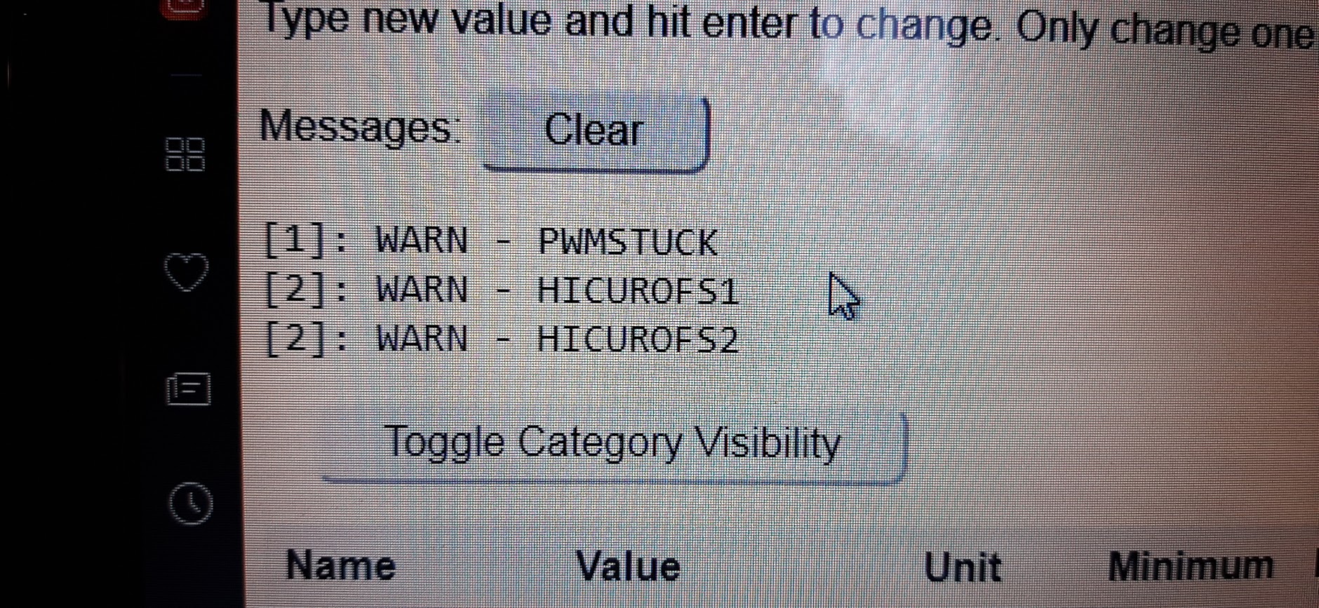

Re: Johannes in a Blue Pill
Well, it would seem the Blue Pill has a little layout problem. So no matter if you set the break input active high or low it trips out as soon as the PWM runs, even though the break input is tied to ground or VCC, respectively. If the break function is disabled per timer register, all runs ok.
Now, I disabled the PWM1N output which is adjacent to the break input. Et voila: no trip.
Next I tried to enable the internal pull-up of break input and this also leads to avoiding false trips. Now the pin can even be left floating and as soon as it's pulled to GND the PWM stops.
When scoping the open pin you can see some cross talk but only about 150mV peak-to-peak and far away from the low threshold voltage. So still not 100% sure where the cross talk happens.
EDIT: binary attached

I will create some simple arduino sketch to verify that the uart3 is working correctly and post when done.
