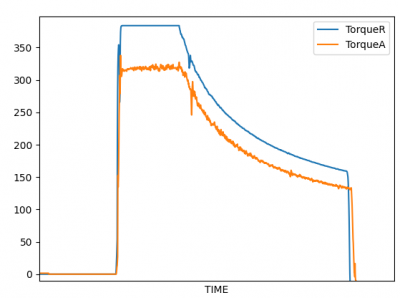

Today I tried to see if I could get more power/torque from this by spoofing the torque request. Turns out it's limited like the old inverter so the 160kW car must have different firmware.

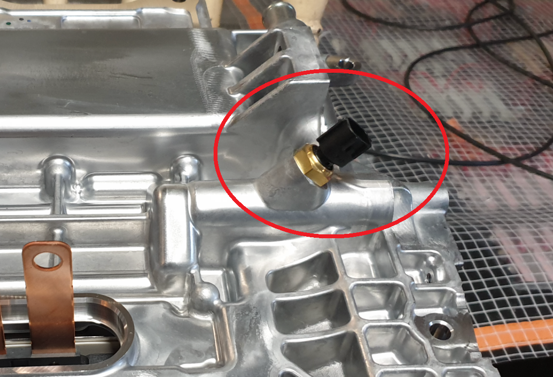

I have done this mod and can confirm that it works. I haven't totally finished but here are some of the things I have found:
- New coolant hoses needed
- The Gen3 has a coolant sensor underneath which needs wiring into the comms connector - this is the only difference in the wiring
- For some reason the motor phase connections didn't quite line up, so I had to shim the inverter up about 2mm
- I only modified 0x1D4 and 0x1DA and this worked
- The inverter has a fault code present due to CAN messages missing on the ZE0, I suspect these are battery messages and have yet to get round to finding out which ones so that I can recreate them. The car works fine, just has a warning light.
- I also modded the inverter internals to get a bit more torque, I did this by modifying the current sensors. It works well.

Re: Nissan Leaf Gen3 inverter
The sensor is screwed into the inverter base and comes with it as it is part of a coolant path. The main issue was trying to find a connector to fit, it's some kind of Denso plug I think, I just used bare pins and glue.

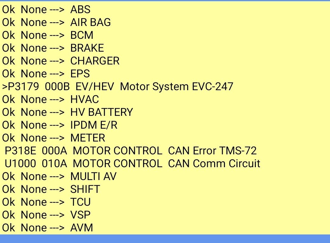

Ah, gotcha!
Can you say which fault codes are active? Can be viewed with leafspy!
Sure, see attached. I have access to a 110kW car so planned to send it messages and keep trying to clear, just haven't had the chance yet.

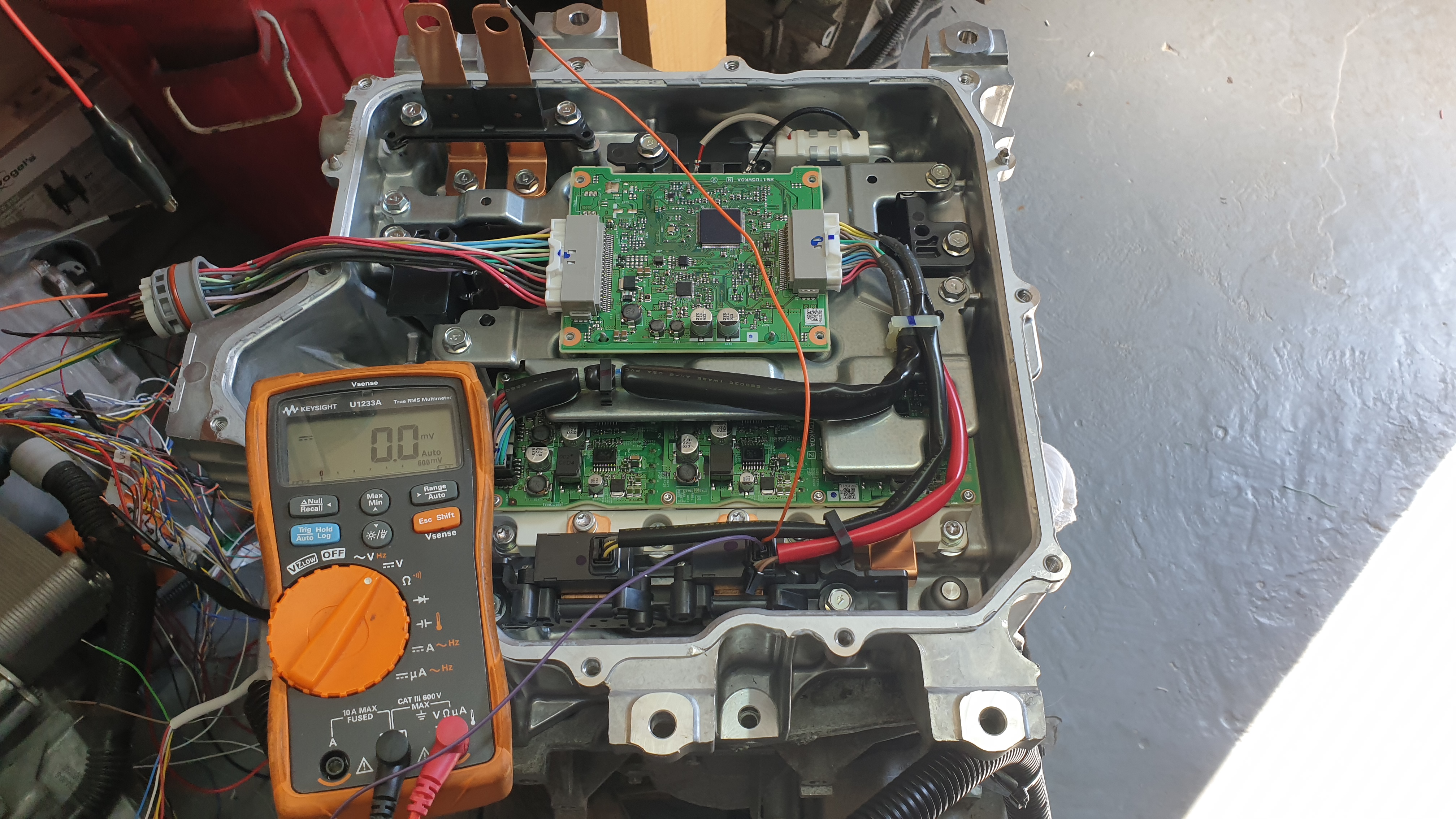

- Posts: 3666
- Has thanked: 12 times
- Been thanked: 351 times
Seems my gen3 inverter has a dead middle current sensor. Don't suppose anyone has a spare?
