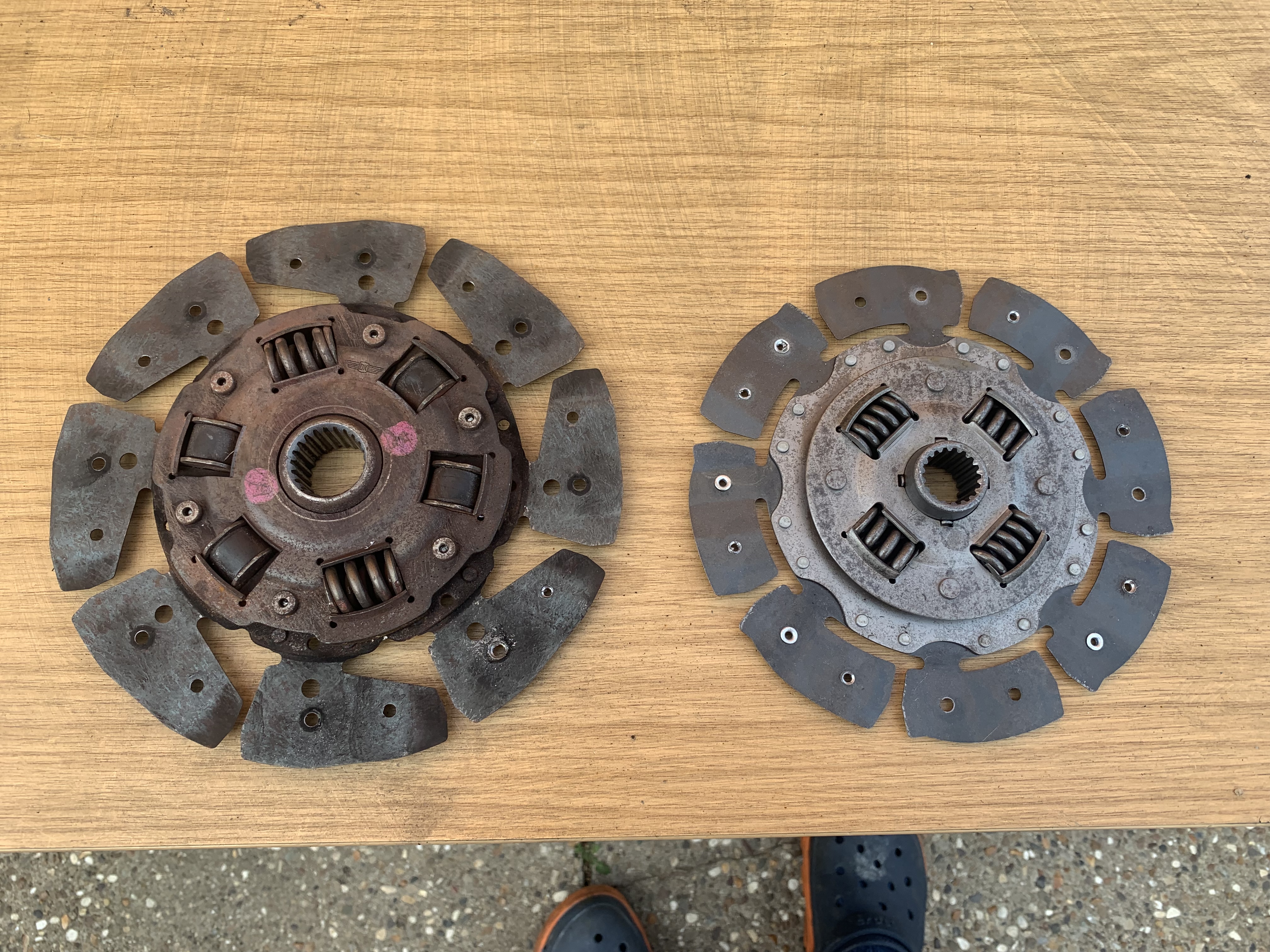

So I’m still working on my mini project but in order to reduce the timescale to actually owning an electric car I’ve started on an mx5 project alongside! Started by using a Jimmy clutch plate and the mx5 clutch plate to make a coupler. Next step is the gearbox to motor adaptor and then create the subframe for the motor and inverter! Physical engineering is what I do best - it’s electrical that challenges me!
