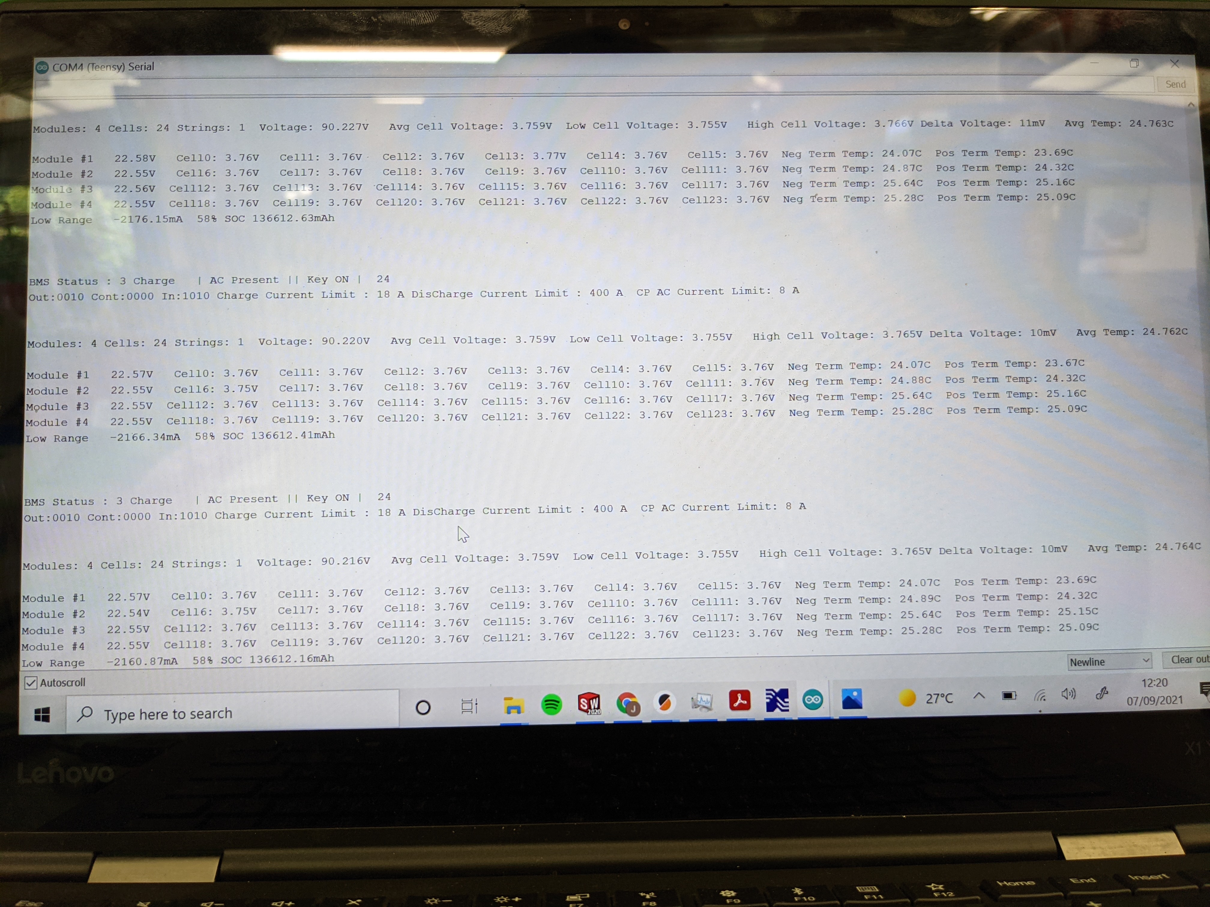

Please check the updated settings, and please show me the debug with the charge port plugged in.

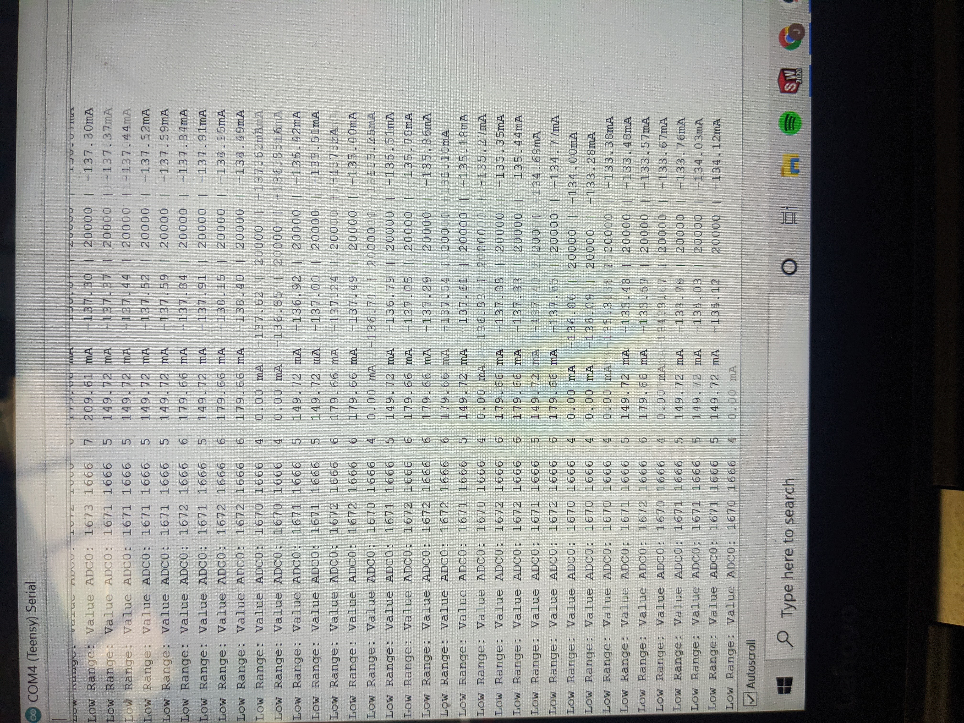

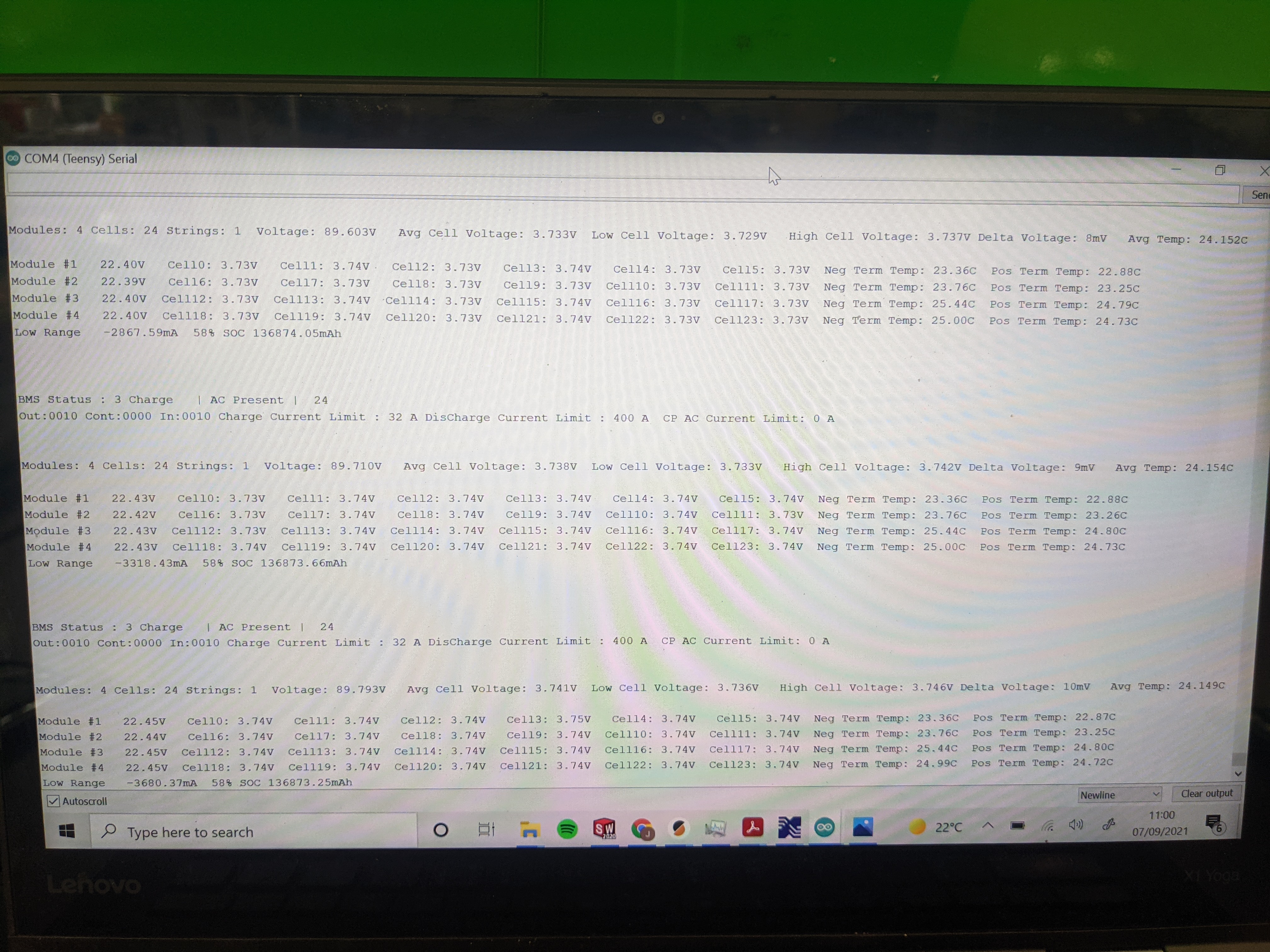

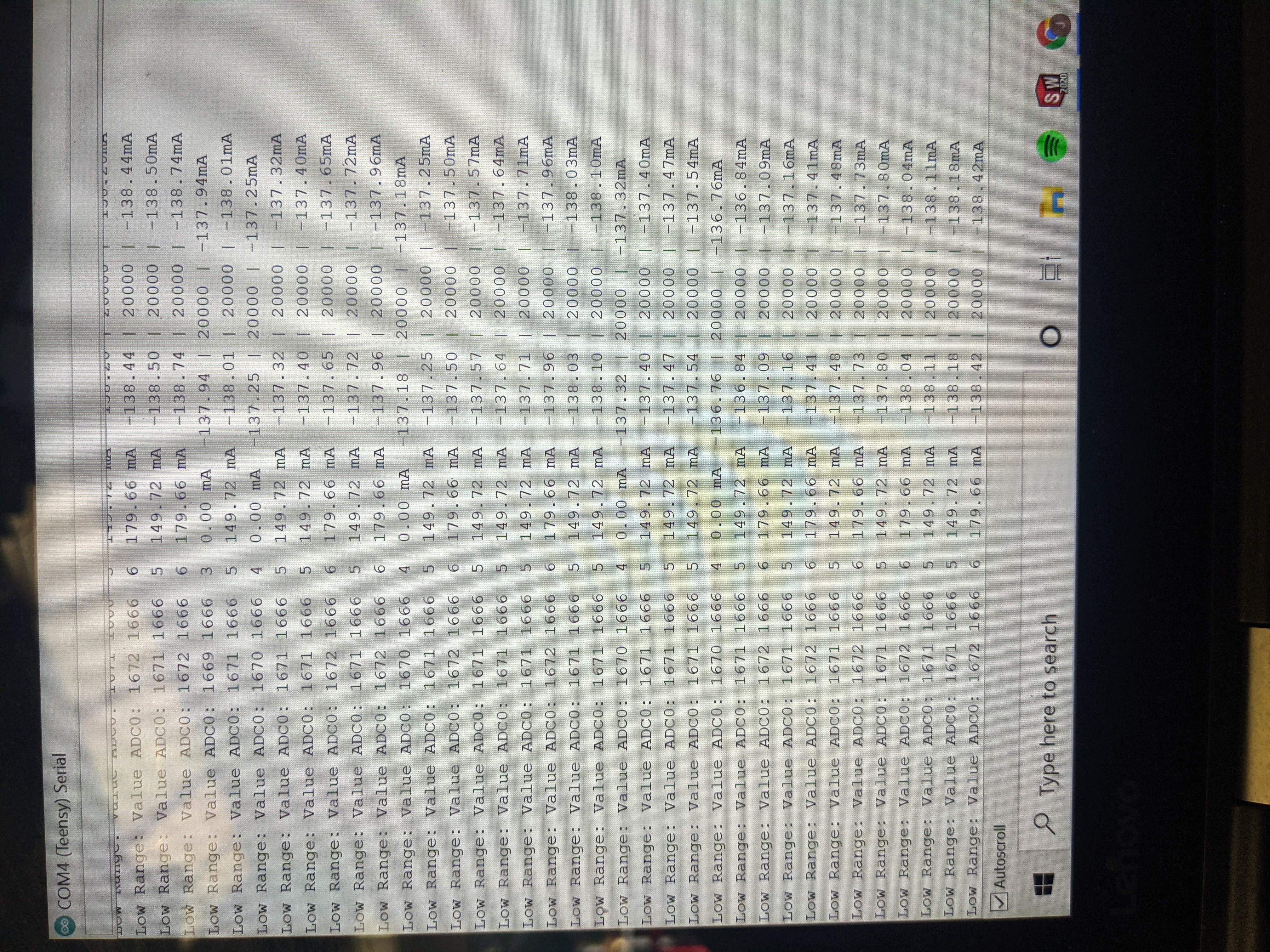

tom91 wrote: Mon Sep 06, 2021 8:30 pm Please check the updated settings, and please show me the debug with the charge port plugged in.
Hi Tom please see attached....
Note that if I reboot simp I get current flow from charger for maybe 5 seconds before it goes back to 0.

Re: Simp BMS

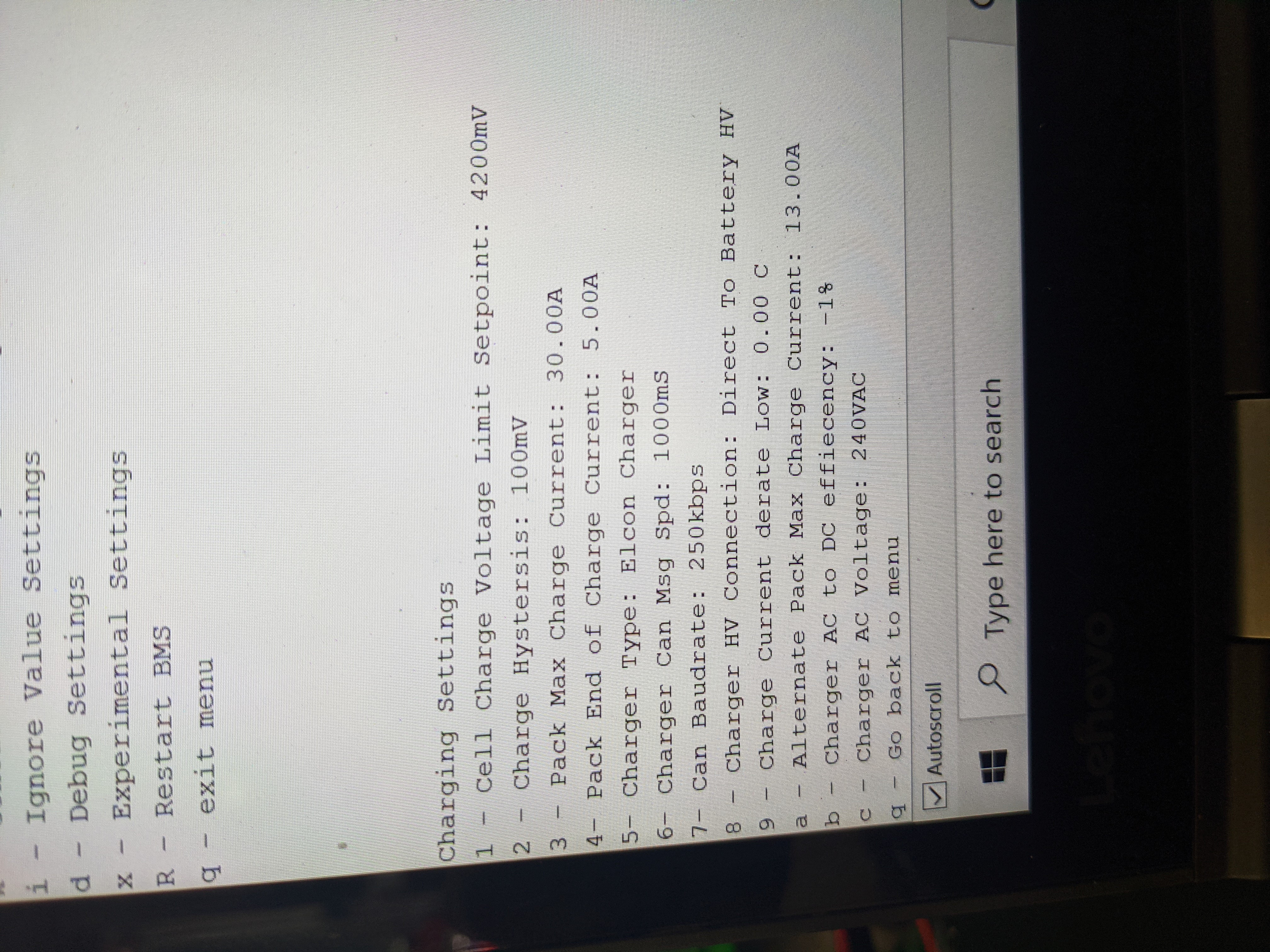

Charger efficiency is set to -1.... set this to 85
Also show me the scrolling debug so I can the relevant data not the current sensor.

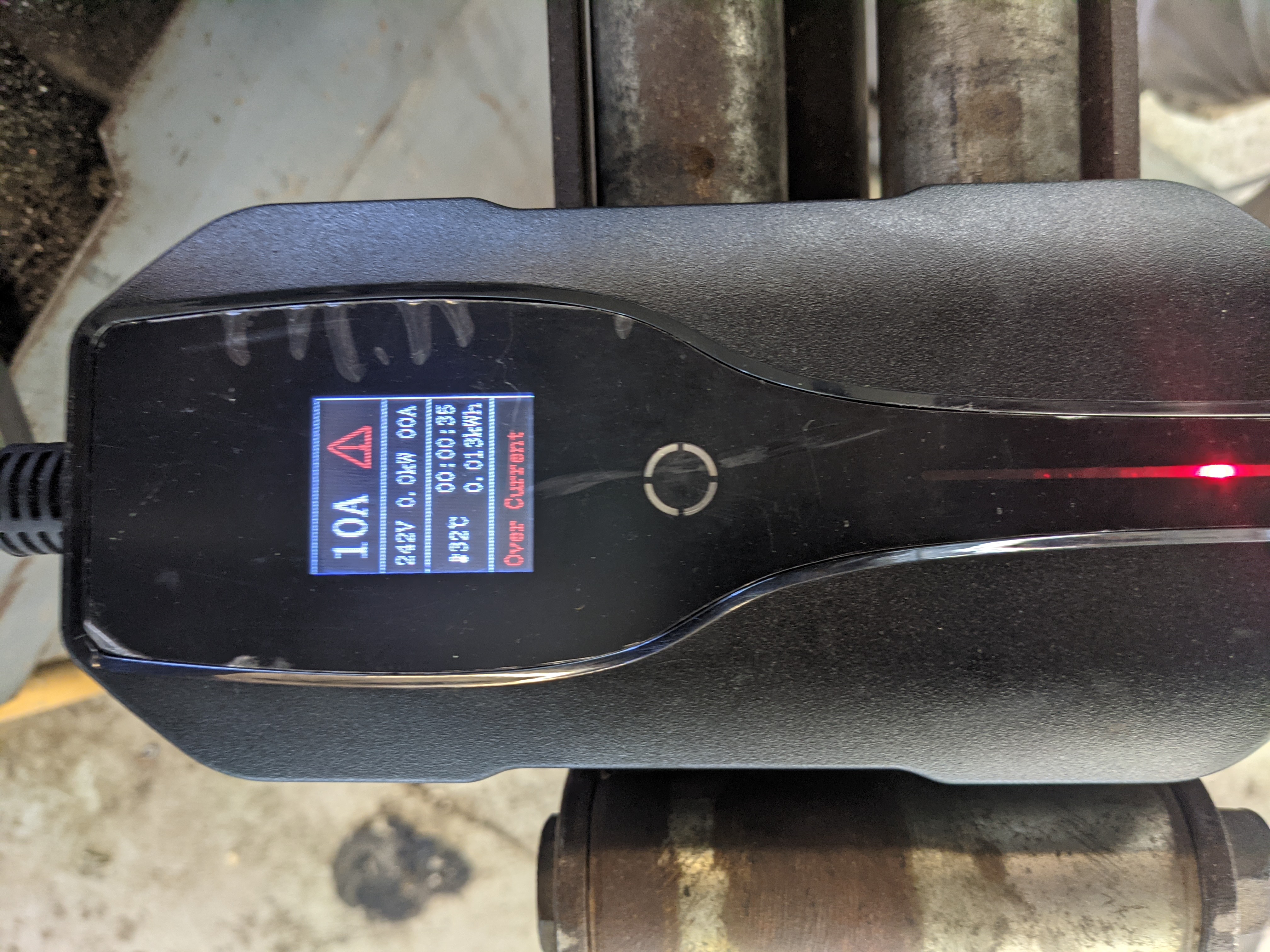

Set efficiency to 85% now getting current fault with evse....see pic .

Re: Simp BMS
Again, please just show me the "standard" scrolling debug showing the status and cell voltages. This will give me some insight into what is happening.
Does the evse allow some charge and then turn off?

Right now the charger is just kicking in and out getting over current fault ...so yes evse allows about 5 seconds of charge .. before fault.

So it turns out the CP signal is not being read right. Do you have a 1K resistor to replace the 5K? Possibly the signal is not strong enough.
I am not too sure about how susceptible this 1Khz pwm signal is not external noise. I would recommend having the run from the SimpCharge to the SimpBMS be the shortest run possible.

Ok now with the new 1k resistor inline we have constant charge ( 5 minutes in so far with no current fault on evse )
Although my clamp meter and anologue current sensor is reading about 20amps. 10 amps shy of what it should be. Would changing this resistor value alter DC current ?

Actually ignore the lower current. My evse was set to 10a AC.

Have people managed to successfully get SOC to work using coulomb counting?
Took the car for a trip earlier (30miles ish) and my SOC increased by 10%..... does this mean ive cracked free energy?
The current sensor is happy and calibrated but for some reason only happy up to 200A. If it goes over 200A then it immediately reads 396A until i let of throttle completely... then it resets.
My current sensor is a LEM DHAB-S-18 and is rated up to 350A. I do not believe I'm exceeding that by much...
any ideas I'm a bit stuck on what to do...

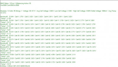

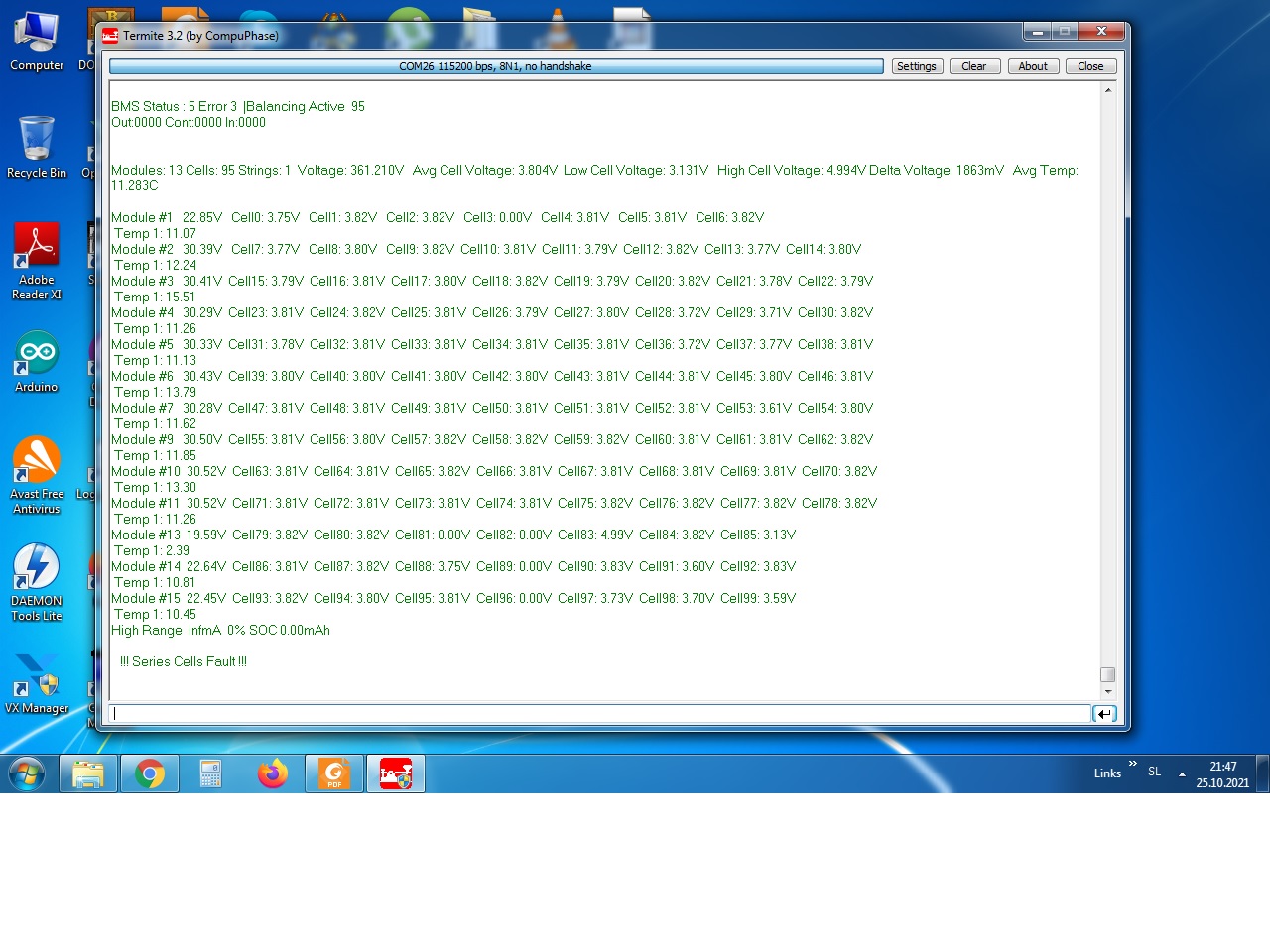

Hi

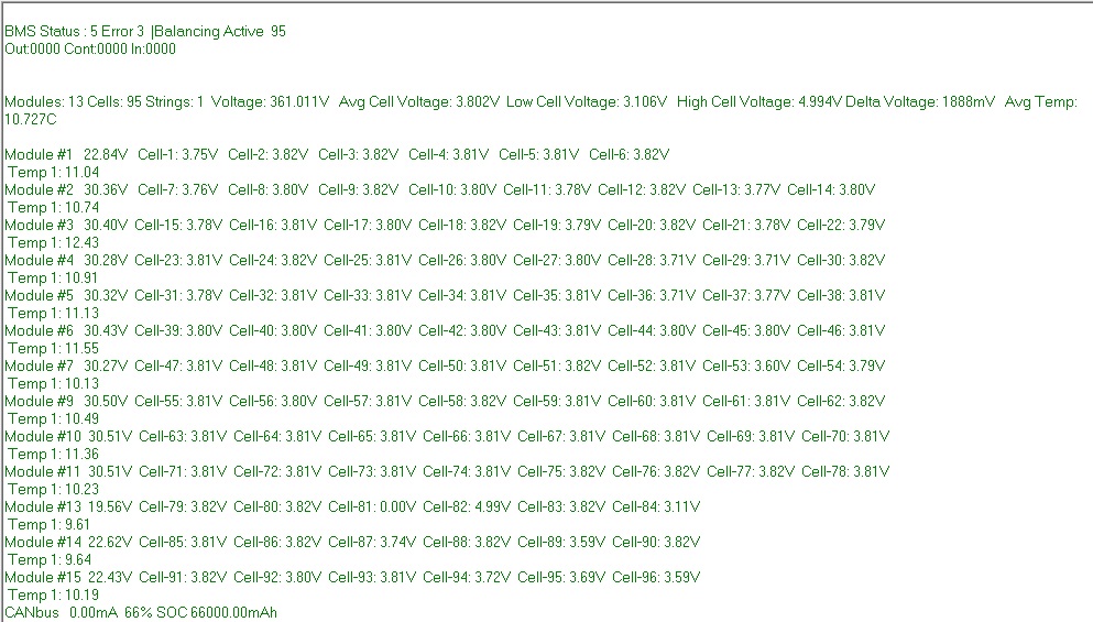

After some time unused i dusted up my Volt BICM modules and i connected them to SimpBMS and Volt battery.
Immediately i noticed error. Modules were telling me one cell is at 5V and another is 0V!
On display i only get 95 cells in series! But when i go and measure actual cell voltage i get every cell good above 3.77V.
What do you think is happening? Imade a screenshot...

arber333 wrote: Mon Oct 25, 2021 8:29 pm Hi
Damage to the wiring or one of the slave modules I would hazard a guess. It should not be ready 5V (which is an error state i believe)

tom91 wrote: Tue Oct 26, 2021 3:14 pm Damage to the wiring or one of the slave modules I would hazard a guess. It should not be ready 5V (which is an error state i believe)
I looked at the display more carefully and i got 96 cells for like 5 seconds then it changed to 95. When i tried to observe i sa cell no 81 plummet towards 0V in the first 5s after boot up.
I got another BICM board from a friend and it shows exactly the same behaviour with exactly the same cell no 81 at 00V and no82 at 5V.
This is too much of a coincidence to be BICM fault. Maybe the pins inside battery?
