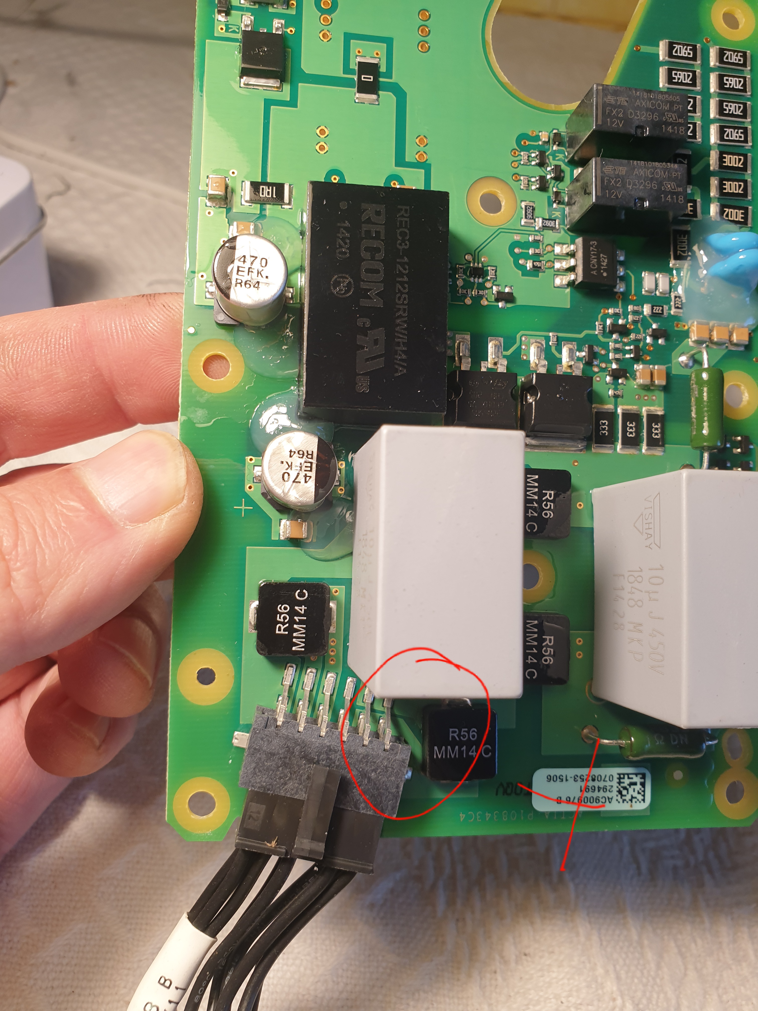

If you can post a picture of the control PCB inside the DC/DC I might be able to help.
- Posts: 664
- Location: UK/EU
- Has thanked: 36 times
- Been thanked: 34 times
Re: Higher lowest HV battery voltage. Boosting? Need advice
It's a bit hard to take a good resolution photo of entire pcb but I uploaded a bunch of pictures here:
https://mega.nz/folder/p0gD3C5Q#RntCVUCWYZfwLnE3e8hBRw
If you need me to zoom in on something particular I will. I could not see any extra wires going to HV terminals but HV wires come directly into PCB where the big screw holes are. I marked which is HV+, HV- and grounding to the casing. I noticed that after voltage was too low for it and I raised voltage till it was happy I heard a click and it started working. I could trace something with the multimeter if you tell me what exactly. I don't really understand how voltage sensing works. I found high voltage comes to those 2 sets of rather large resistors on the first board?

Can you find out the resistor values for the three resistors above the IC circled in red? The marking is to fuzzy when I zoom in. Or take a picture of these resistors.
Also, can you see and component number on the IC circled in red?

Hi, thanks. It was a job to read the markings on that chip but it looks like ST chip with number 2903Y? Could also be 2903V as it is so hard to read. I attach a zoomed in photo.
It's hard to find a IC with 2903 and TSSOP14 packing but it is likely some kind of comparator. lm2901 makes more sens in that package.
On the connector is the left HV- and the right HV+ circled in red. Needs to be connected to the other board I guess.
There seem to be a voltage division going on into the assumed comparator IC, marked by the red line.
HV+ - 221k - 221k - 221k - 47,5k - 7,5k - sens - 10k - HV -??
Would result in close to 4,5V at 330V input, if the above is correct.
Can you read what IC I've circled? A voltage reference or voltage regulator perhaps?
Yes, the former chip is definitely 2901Y when I looked again. And this other chip that you circled is 4264 G.
You're right all last 4 pins on the connector that I circled are HV+ as I can trace continuity to the HV+ terminal on the top PCB. I cannot trace any continuity to the HV- terminal and the connector pin on the left or in fact any of them. Perhaps HV- does not come in there directly and therefore multimeter does not pick it up? I attach a photo of how the top PCB connects to the bottom PCB.
Ok so the 4264G seem to be a 5V regulator.
My conclusion from this is that these resistors form a voltage division of the HV+ down to some kind of gnd (close to HV-).
HV+ - 221k - 221k - 221k - 47,5k - 7,5k - sens - 10k - GND1. Sens connected to 2901 pin 8 or 3IN-. 330V HV+ input results in 4,53V at pin 8.
There is a 01D (100k) and a 01C (10k) resistor to right of the 2901 which likely form a voltage division from +5V - ref - GND1. Ref connected to 2901 pin 9 or 3IN+. Results i 4,53V at pin 9.
Can you measure connection as marked in this picture to verify my guesses? The ultimate test would be to decrease the resistance of one of these resistors to 150kohm (1503). Or you can connect a 470kohm resistor in parallel with one of them for a result of 150kohm. This should then decrease the min voltage threshold to just below 300V.
Ok I traced the continuity of 01D and 01C and I attach a photo. If I missunderstood you please clarify and I will try again.
Sadly I could not trace continuity between all of the marked points. The board is sprayed with protective varnish that makes it more difficult. I attach a photo where I found continuity.
At the moment I have no other idea then to test to reduce the resistance in one of the 221kohm resistors (marked 2213) and see if the low voltage level decreases. Make sure that any resistor placed there can withstand at least 150V. Easiest way is to parallel with another resistor.
Ok I just put 470k resistor in parallel with the 221k one and nothing exploded. And dcdc started at 298 Vdc! You must have some training to be able to calculate that as I had no idea
Inverter also started. Well inverter didn't like going under 300 Vdc too much but just above it seemed to be fine. Dcdc gave ~13.53 V as usual.
I only had a through hole 470k which was 0.5W I think, not sure for what voltage it is rated. Do you think it would last or do I need to look for a higher voltage one?
Also what does this mod essentially do? Does it trick the dcdc into thinking the voltage is higher than it really is? And how does this affect the upper voltage limit?

I think a through hole resistor will be just fine voltage wise as the capsule usually is quite large. For a more permanent fix I would use very short connections and maybe some glue to make it more vibration resistant. Hot melt glue usually works fine.
The mod lowers the input voltage threshold. Will probably lower the high voltage threshold as well. I guess in some sense you can call it to trick the DC/DC into thinking the input voltage is higher than what it really is.
The calculations is a follows:
3pc of 221k in series with 1pc 47,5k and 1pc 7,5k sums up to a total of 718kohm. There is also a 10k to gnd so the voltage division output voltage into the 2901 IC is
330V*10k/(10k+718k) = 4,53V
This tells me the input threshold is 4,53V and so one need to change the voltage division to end up with 4,53V at 300V.
To get the new needed resistor value
300V*10k/(10k+R) = 4,53V
300V*10k = 4,53(10k+R)
300V*10k = 4,53*10k + 4,53*R
R = (300V*10k - 4,53*10k) / 4,53
R = 652k
R was 718k and now needs to decrease to 652k, thats a difference of 66k.
To do this one needs to reduce one of the series resistor values by 66k and the simplest is to reduce one of the 221k resistors by 66k to 155k, however this is not a standard value so 150k is the prefered choise as this small (5k) difference does not matter so much.
To just connect another resistor in parallel for a total of 150k the calculation is as follow:
1/150k = 1/221k + 1/R
1/150k-1/221k = 1/R
R = 1/(1/150k-1/221k)
R = 467k
Closest standard value is 470k.
Note that by paralleling one could get closer to 155k but now it is possible to replace the 221k//470k to one 150k resistor without changing the threshold level, if desired.
