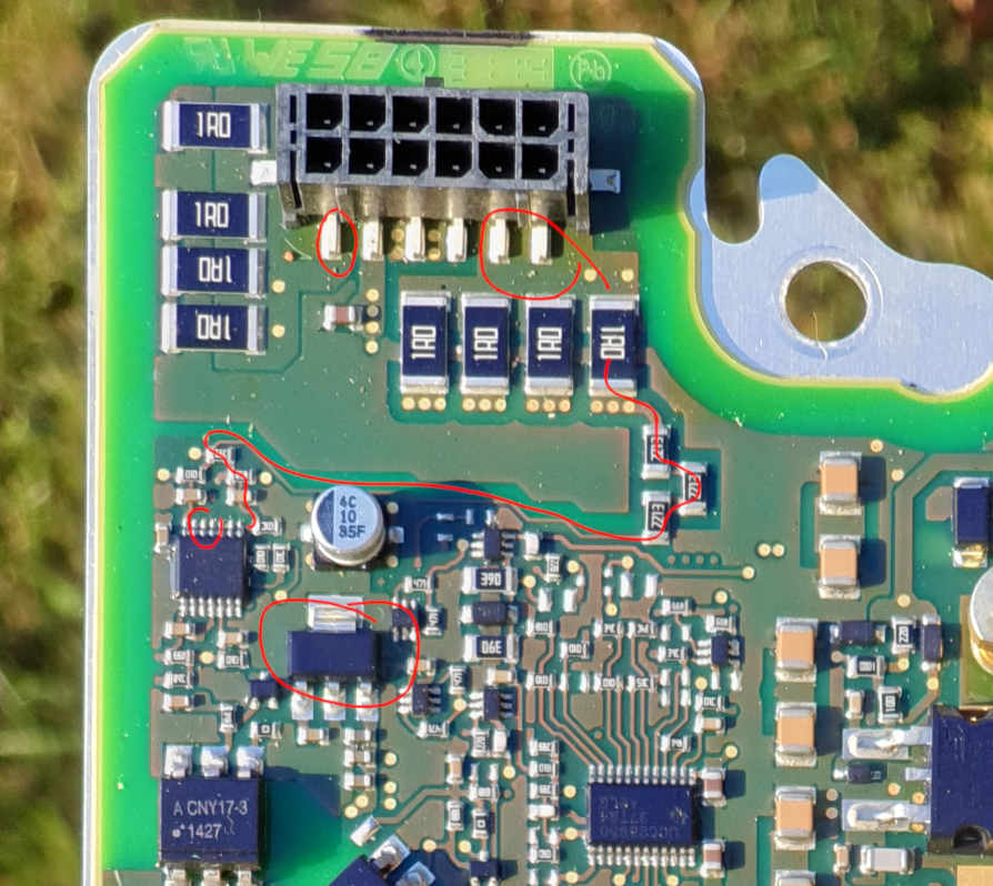

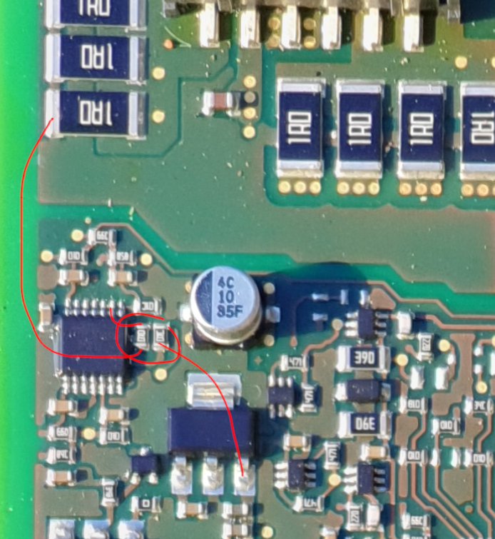

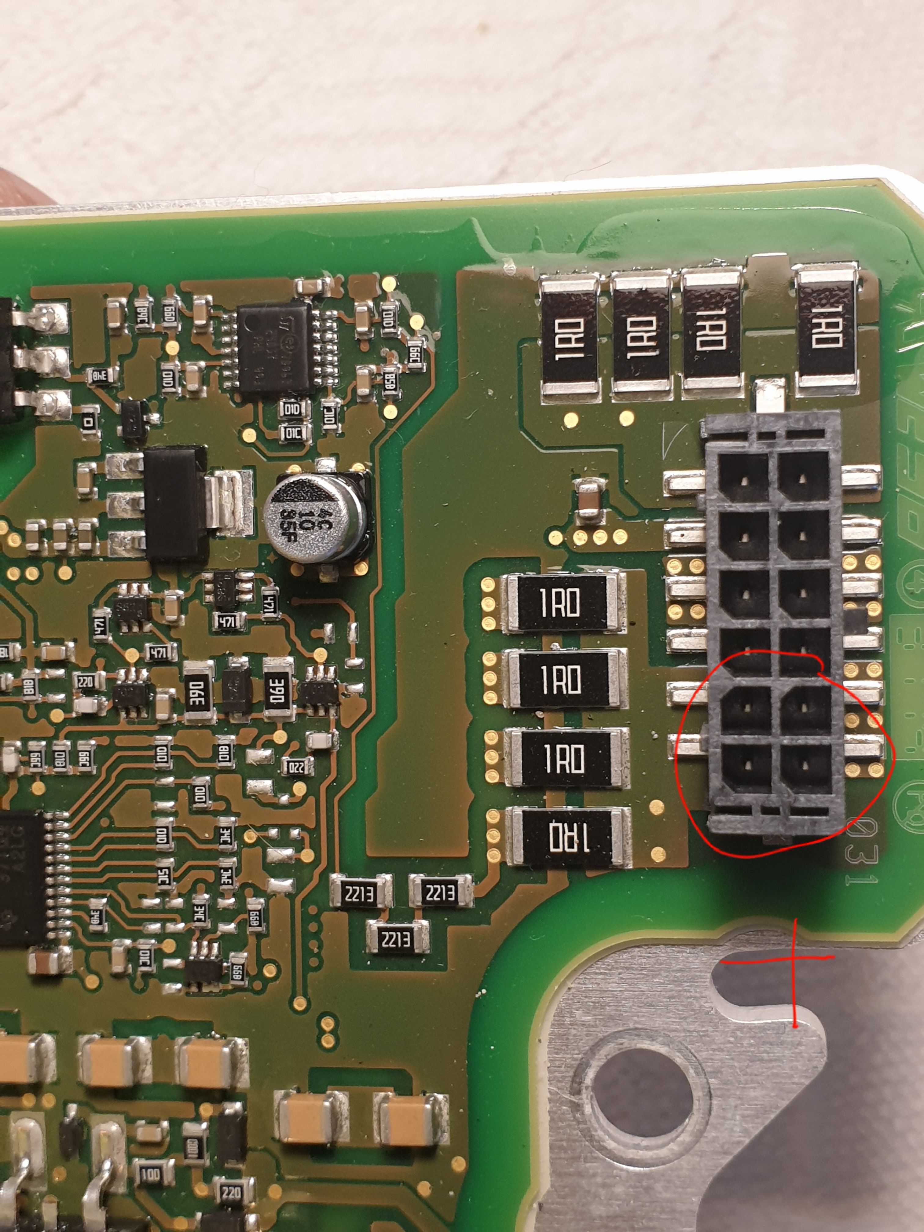

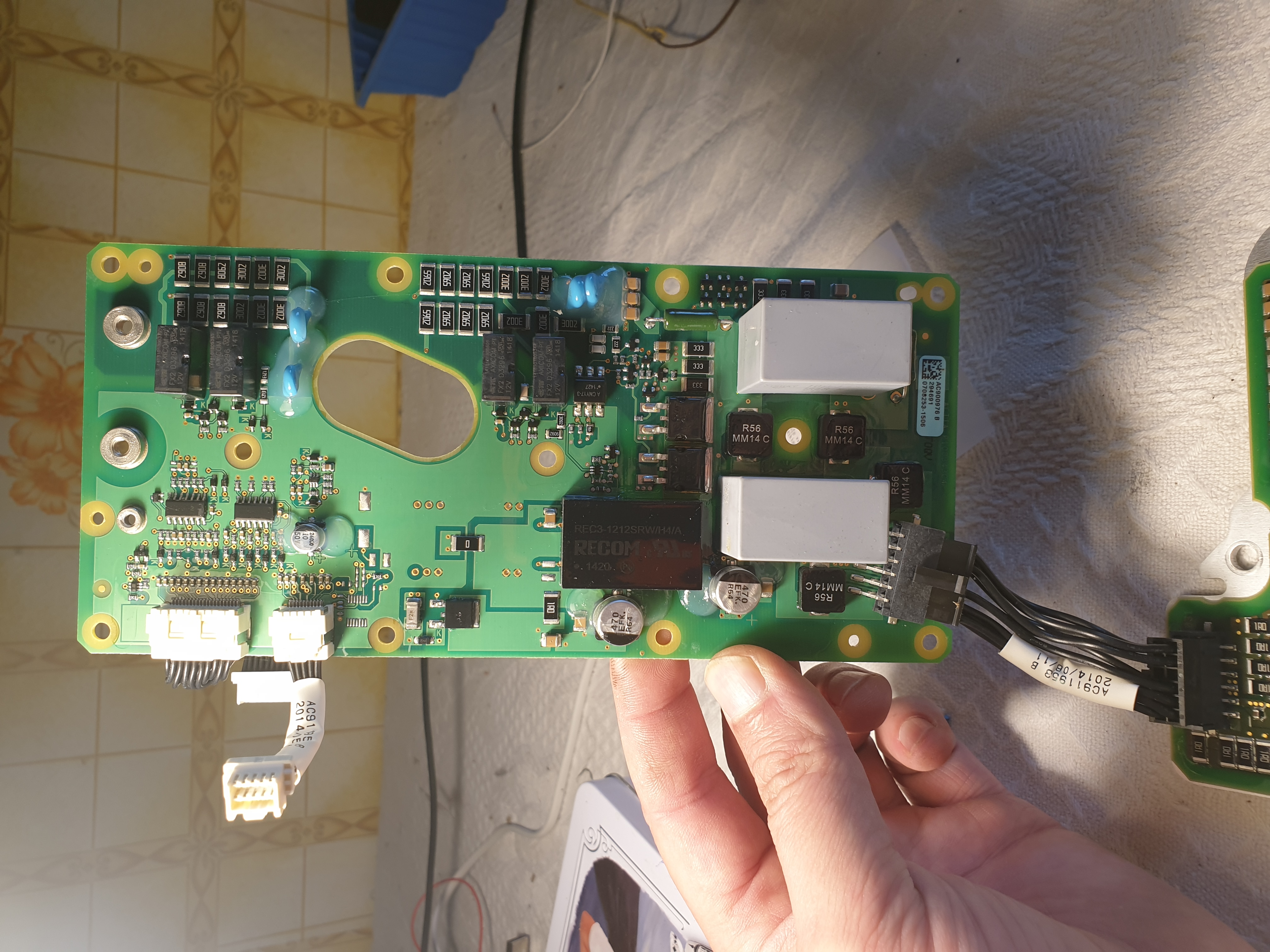

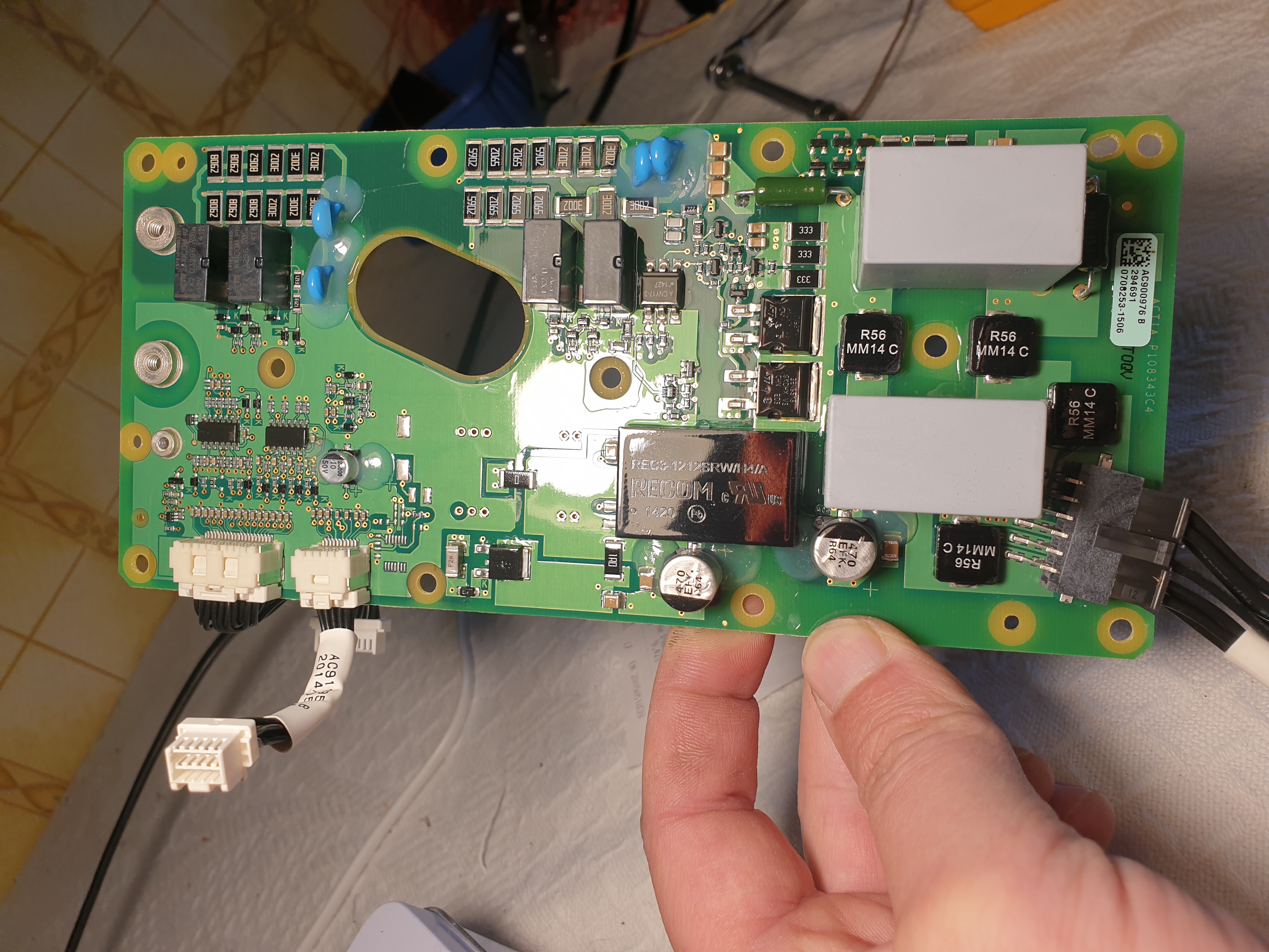

Re: Higher lowest HV battery voltage. Boosting? Need advice
It's a bit hard to take a good resolution photo of entire pcb but I uploaded a bunch of pictures here:
https://mega.nz/folder/p0gD3C5Q#RntCVUCWYZfwLnE3e8hBRw
If you need me to zoom in on something particular I will. I could not see any extra wires going to HV terminals but HV wires come directly into PCB where the big screw holes are. I marked which is HV+, HV- and grounding to the casing. I noticed that after voltage was too low for it and I raised voltage till it was happy I heard a click and it started working. I could trace something with the multimeter if you tell me what exactly. I don't really understand how voltage sensing works. I found high voltage comes to those 2 sets of rather large resistors on the first board?

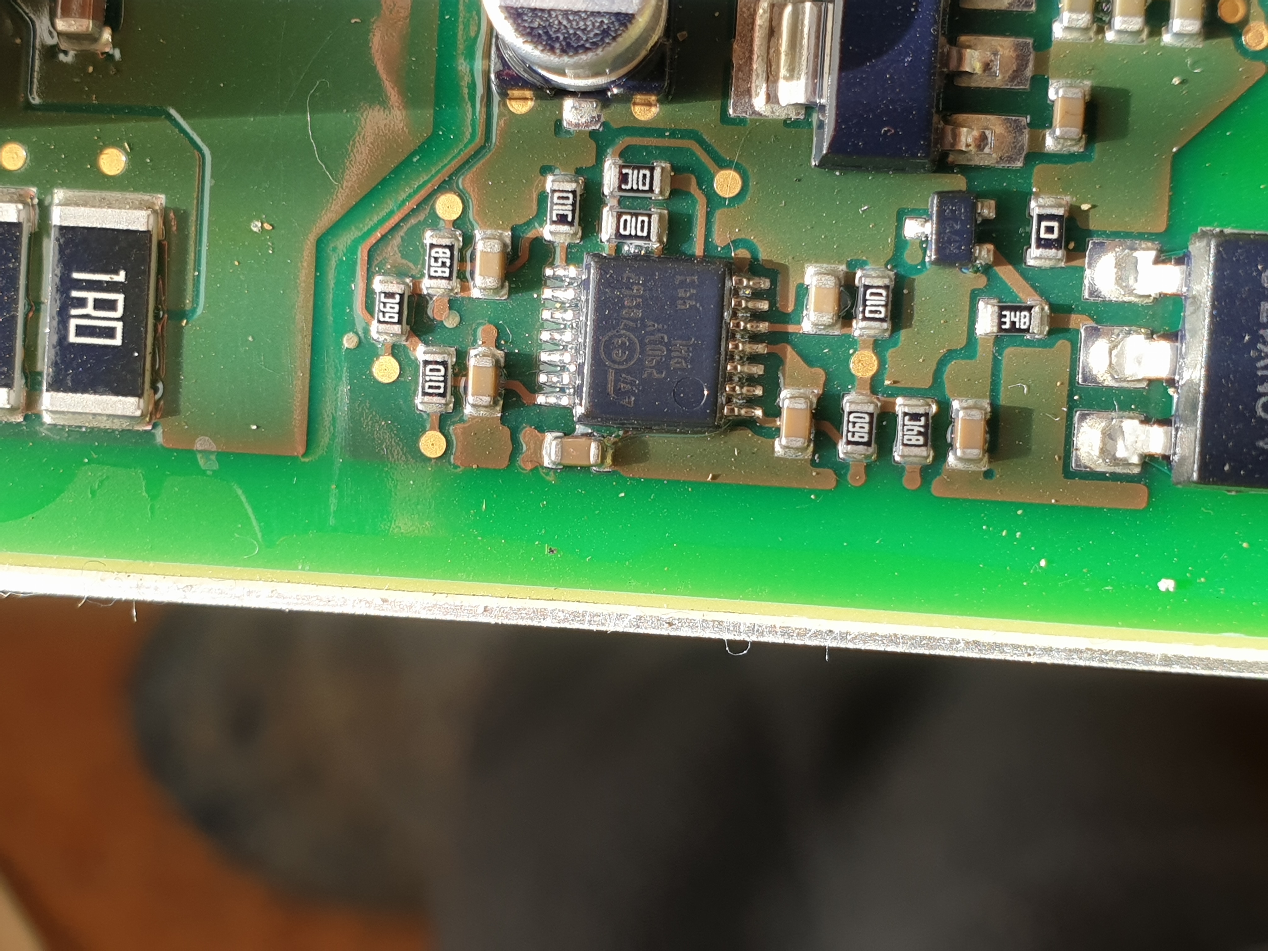

Can you find out the resistor values for the three resistors above the IC circled in red? The marking is to fuzzy when I zoom in. Or take a picture of these resistors.
Also, can you see and component number on the IC circled in red?

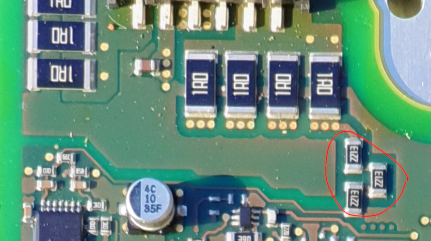

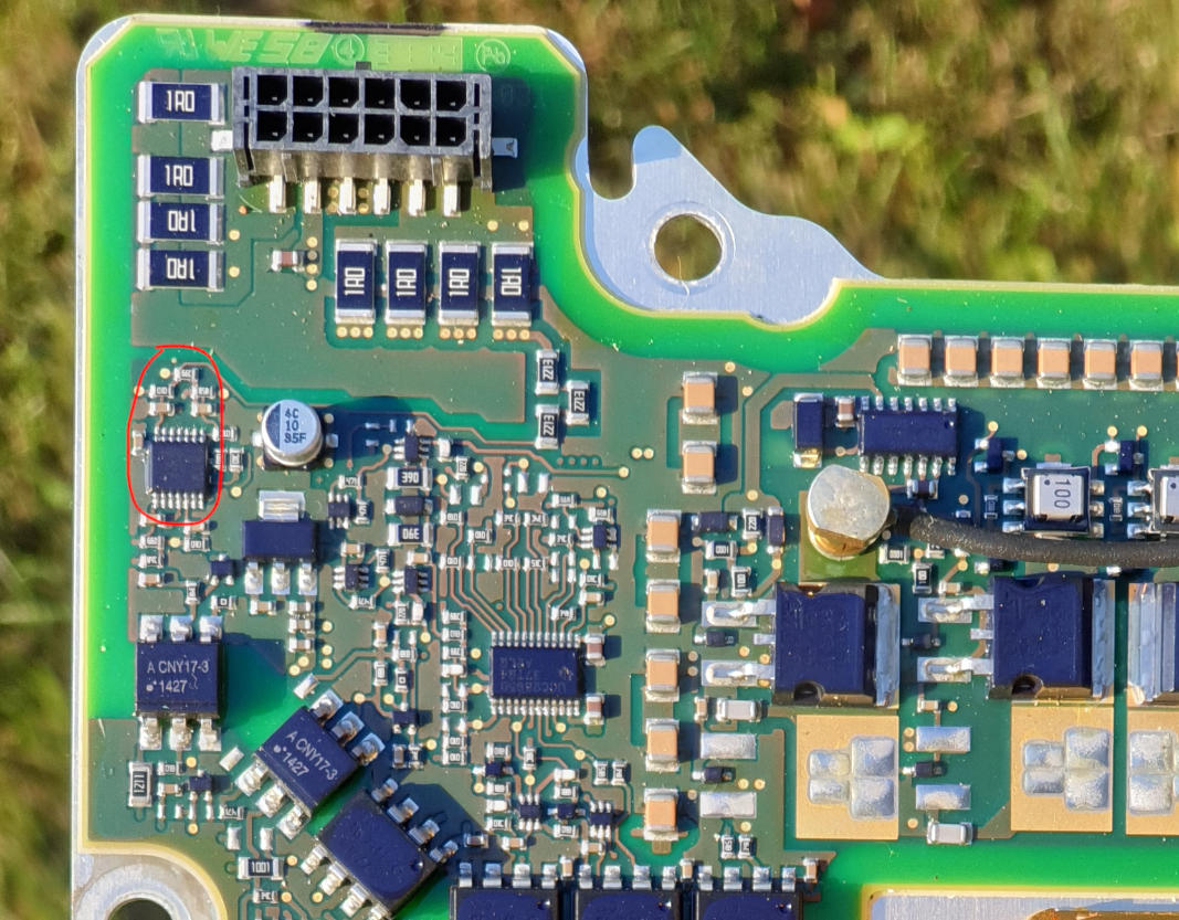

Hi, thanks. It was a job to read the markings on that chip but it looks like ST chip with number 2903Y? Could also be 2903V as it is so hard to read. I attach a zoomed in photo.

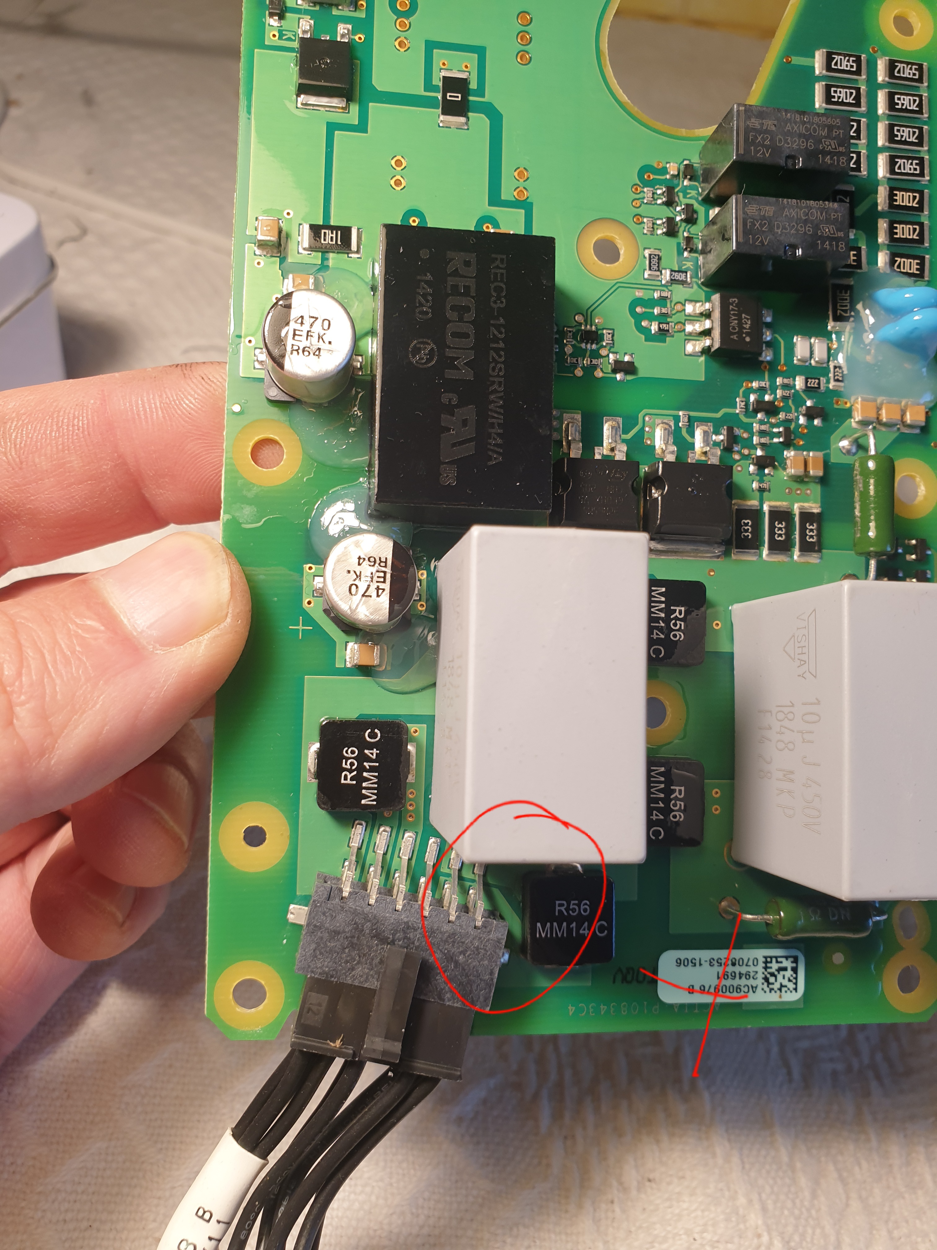

It's hard to find a IC with 2903 and TSSOP14 packing but it is likely some kind of comparator. lm2901 makes more sens in that package.
On the connector is the left HV- and the right HV+ circled in red. Needs to be connected to the other board I guess.
There seem to be a voltage division going on into the assumed comparator IC, marked by the red line.
HV+ - 221k - 221k - 221k - 47,5k - 7,5k - sens - 10k - HV -??
Would result in close to 4,5V at 330V input, if the above is correct.
Can you read what IC I've circled? A voltage reference or voltage regulator perhaps?

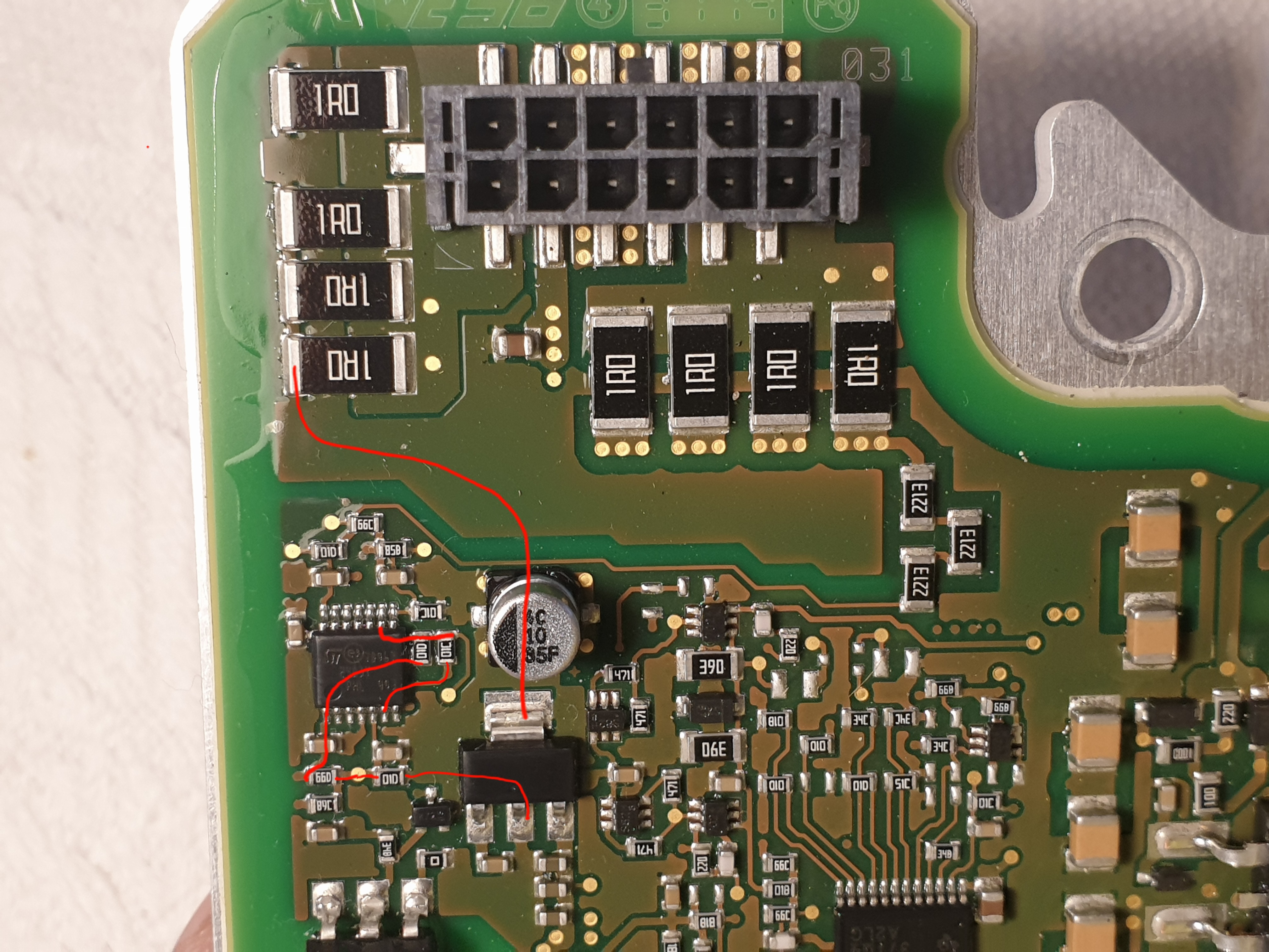

Yes, the former chip is definitely 2901Y when I looked again. And this other chip that you circled is 4264 G.
You're right all last 4 pins on the connector that I circled are HV+ as I can trace continuity to the HV+ terminal on the top PCB. I cannot trace any continuity to the HV- terminal and the connector pin on the left or in fact any of them. Perhaps HV- does not come in there directly and therefore multimeter does not pick it up? I attach a photo of how the top PCB connects to the bottom PCB.
All last 4 pins are HV+ that I circled on the top PCB.

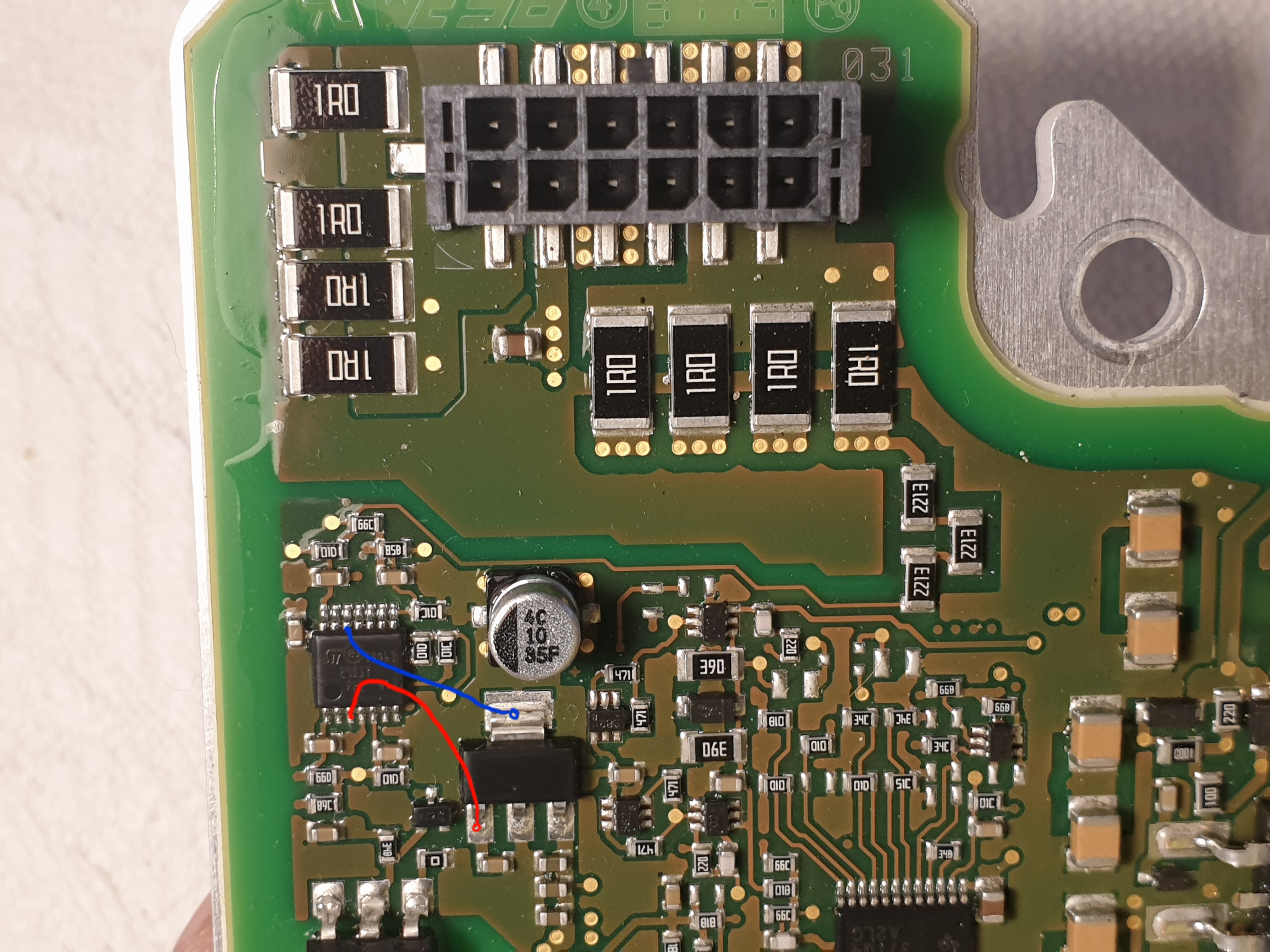

Ok so the 4264G seem to be a 5V regulator.
My conclusion from this is that these resistors form a voltage division of the HV+ down to some kind of gnd (close to HV-).
HV+ - 221k - 221k - 221k - 47,5k - 7,5k - sens - 10k - GND1. Sens connected to 2901 pin 8 or 3IN-. 330V HV+ input results in 4,53V at pin 8.
There is a 01D (100k) and a 01C (10k) resistor to right of the 2901 which likely form a voltage division from +5V - ref - GND1. Ref connected to 2901 pin 9 or 3IN+. Results i 4,53V at pin 9.
Can you measure connection as marked in this picture to verify my guesses? The ultimate test would be to decrease the resistance of one of these resistors to 150kohm (1503). Or you can connect a 470kohm resistor in parallel with one of them for a result of 150kohm. This should then decrease the min voltage threshold to just below 300V.

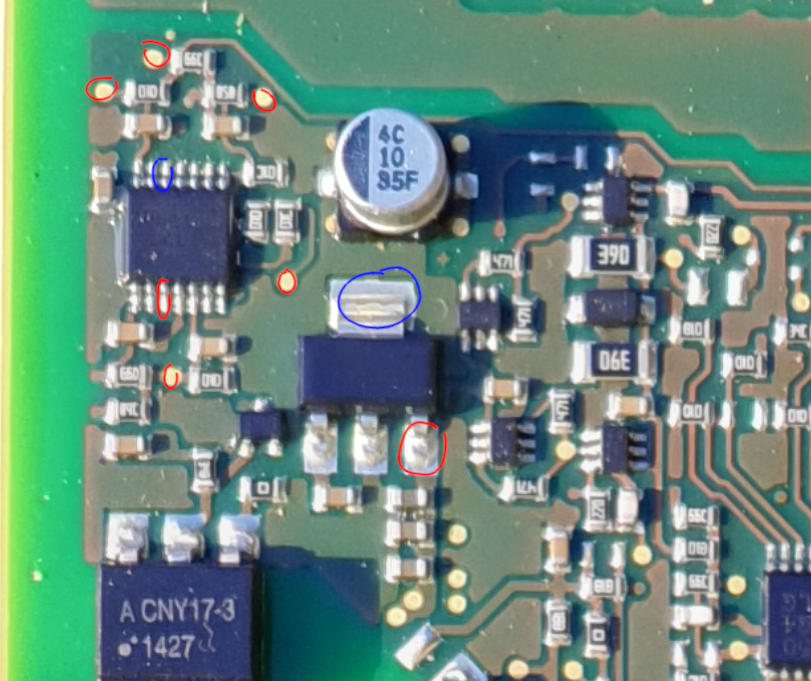

Ok I traced the continuity of 01D and 01C and I attach a photo. If I missunderstood you please clarify and I will try again.
Ok, so my guess was incorrect.
Can you get any continuity between colour matching points?
Sadly I could not trace continuity between all of the marked points. The board is sprayed with protective varnish that makes it more difficult. I attach a photo where I found continuity.
