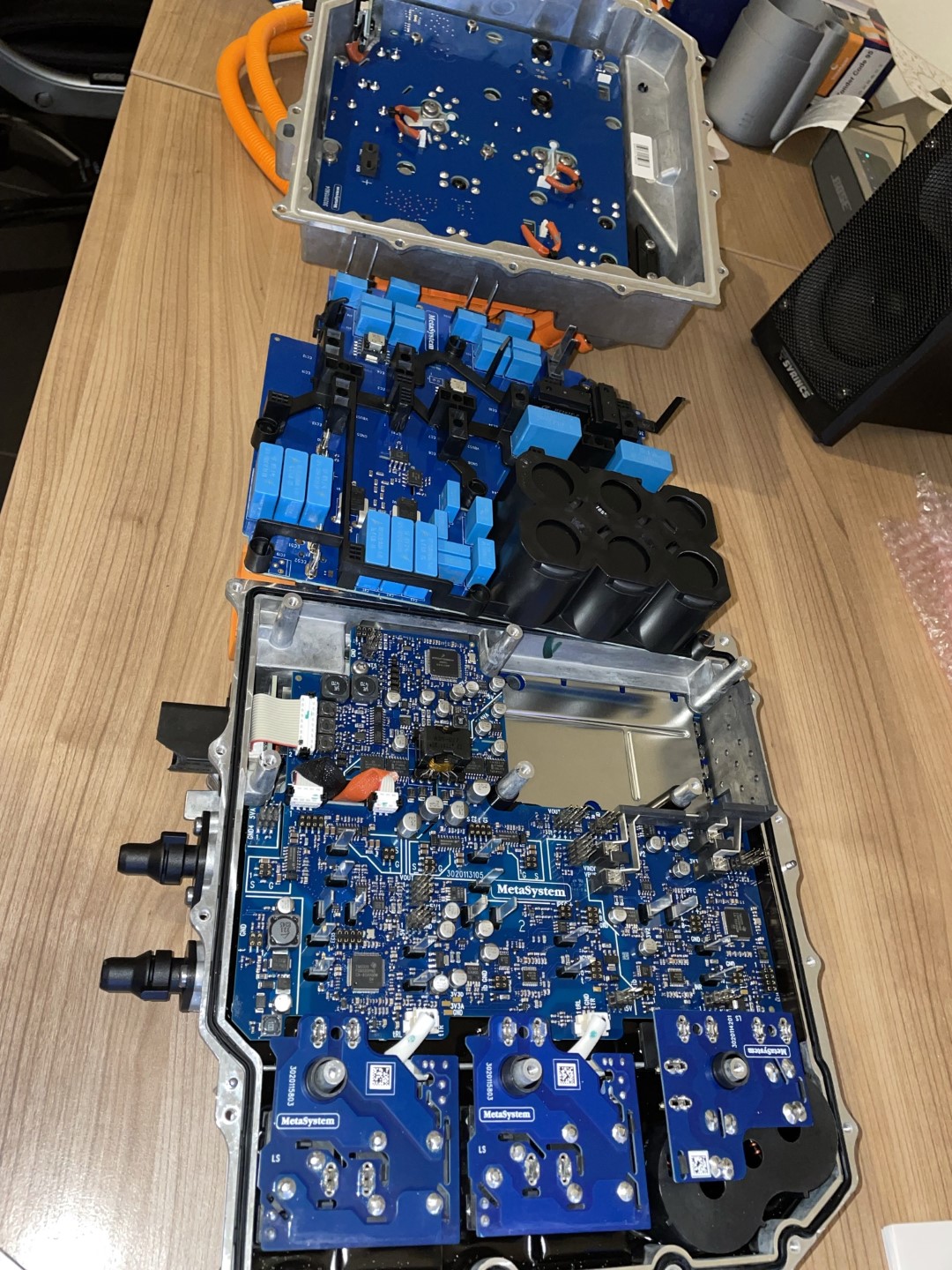

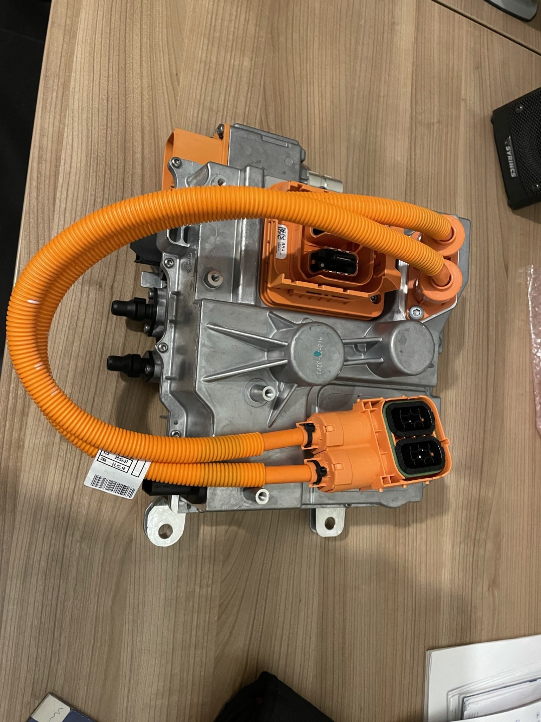

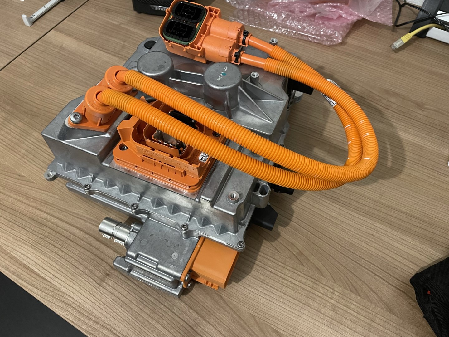

Looking for a lighter alternative for the bulky Tesla 11kW on-board charger, I came across the i3 charger.
- Half the weight
- CCS Fast-charge contactors integrated

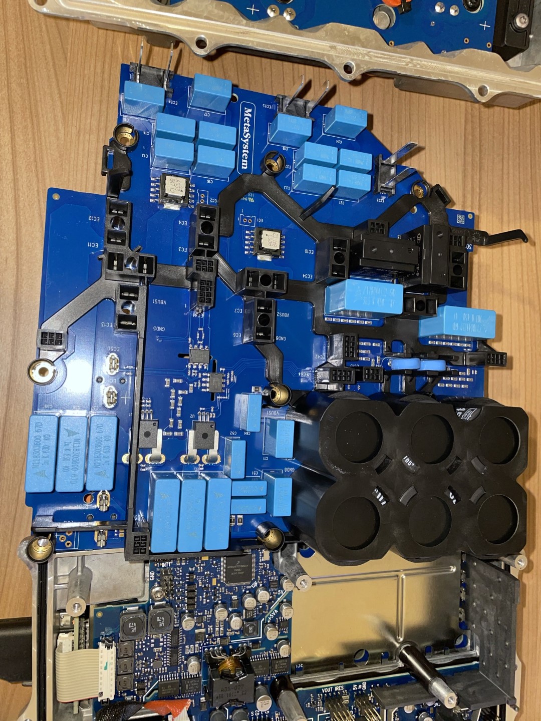

Scored one and took it apart yesterday. First remarkable thing I did not know; the KLE for the 3-phase chargeable i3 is just a 2-phase charger ! Charger for the third phase seems to be integrated in the EME.
Anyone already did some reverse-engineering om this thing ? I do have access to a 2019 i3 (with exactly this KLE inside) since a couple of days, so will make some CAN-logs one of these days.

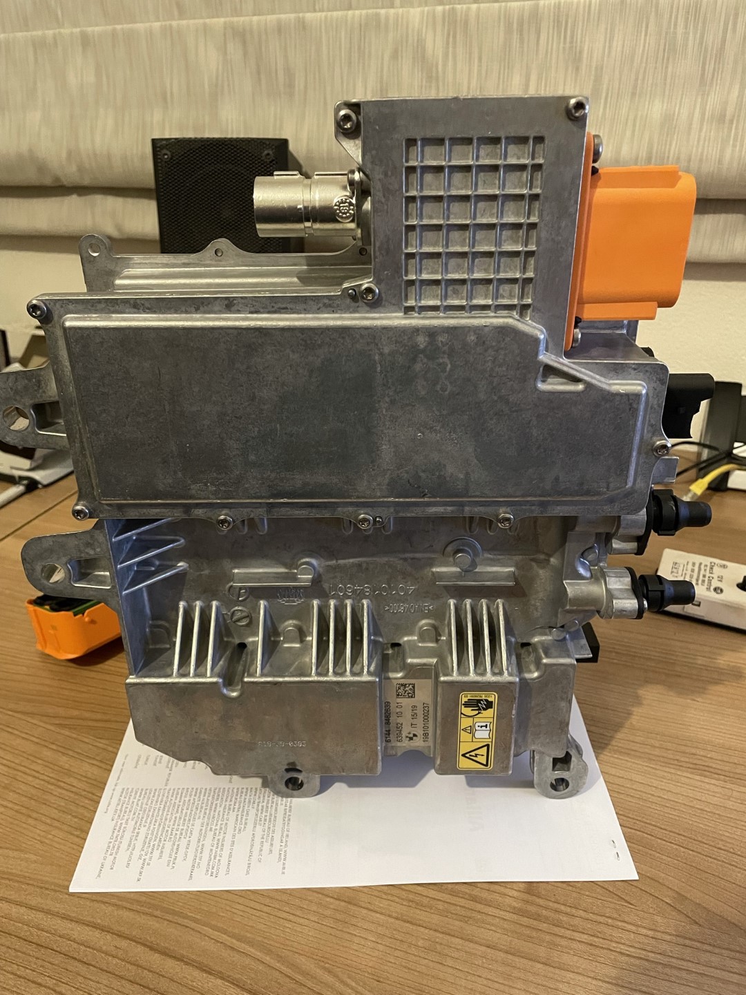

FJ3422 wrote: Thu Jun 24, 2021 9:03 am Looking for a lighter alternative for the bulky Tesla 11kW on-board charger, I came across the i3 charger.
Can you take a photo of charger stickers and P/Ns in detail?

This is the 6144 8482639 / produced in 2019.

Not yet. I hoped to find a 3-phase 11kW charger in this thing. Unfortunately it is just a 2-phase (6,6kW) charger, the third phase (3,3kW) is integrated in de EME, so the charger is less interesting for my build. Will figure CAN-control out somewhen, but it currently has no priority for me.
