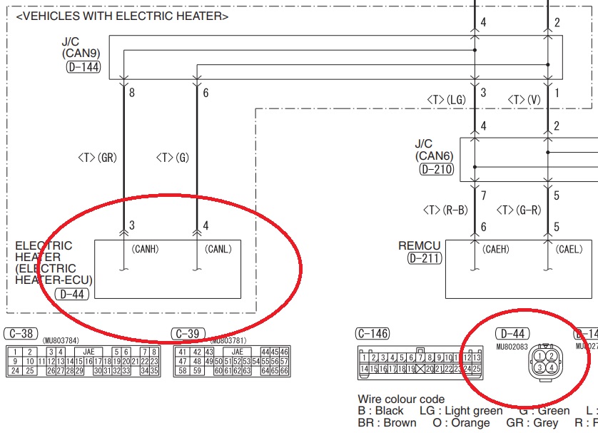

It seems heater P/N 7807A053 is CANbus controlled unit and it is connected directly to rear inverter via 20A fuse.
I am waiting for one heater to arrive. So i will first listen to its message.

Re: Mitsubishi Outlander PHEV heater
No! The one i got is CAN bus controlled with 4 pin connector. Top two pins are 12V(1) and GND(2) and other two CANh(3) and CANl(4).johu wrote: ↑Mon Aug 30, 2021 12:43 pm I think the heater is sorted: https://openinverter.org/wiki/Webasto_HVH50
I provided schematic pic with connector marked in red.
When 12V is connected i got 4 CAN telegram reports on 500kbaud.
0x398 ID 00 09 00 3B 3B 00 00 00 at 100ms
0x630 ID 00 00 00 00 00 00 00 00 at 500ms
0x062D ID 00 00 00 00 00 00 00 00 at 500ms
0x06BD ID 00 00 00 00 00 00 00 00 at 500ms
This is without HV connected!
I haven't seen pictures above becouse of connection restrictions at work. Now i know my pinout was wrong.
Sorry for mistake.

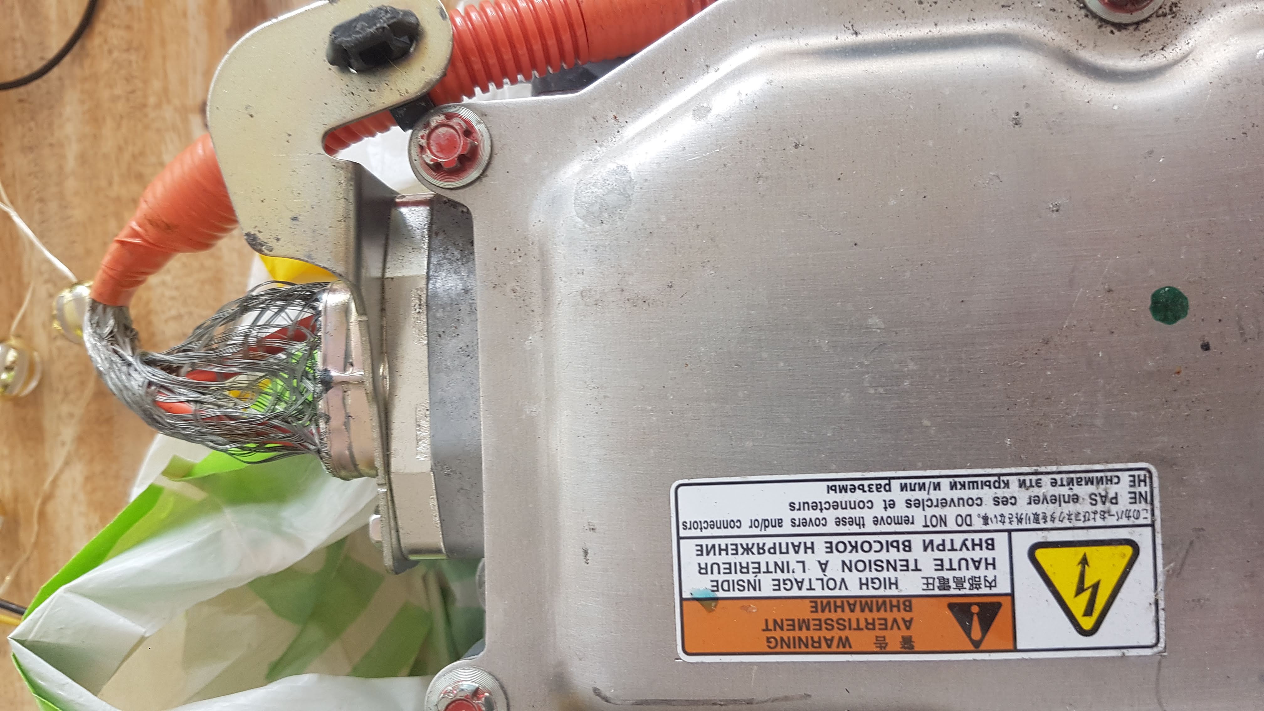

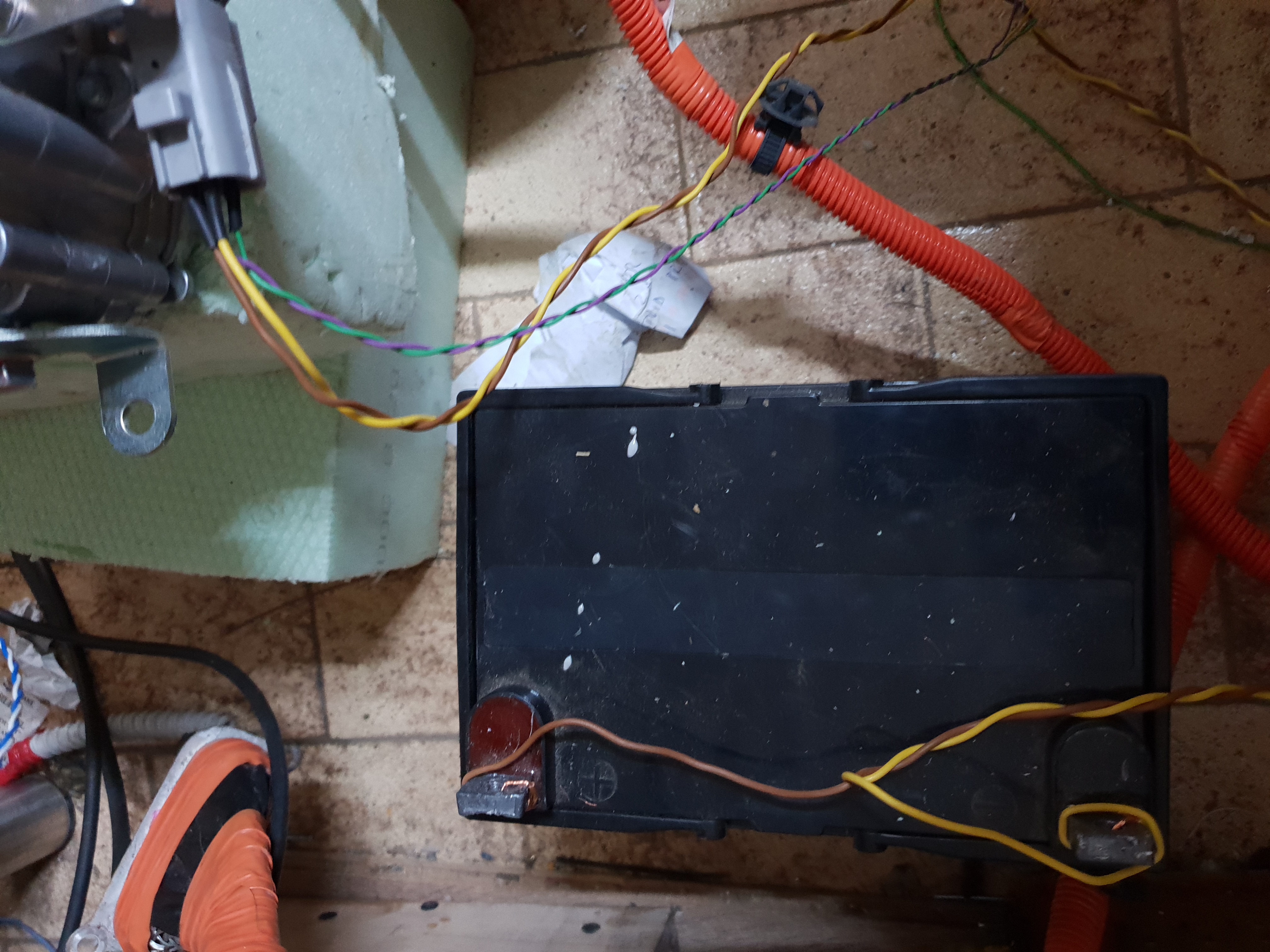

I have connected HV to the heater. I did not yet fill it with coolant.
HV cable orientation is Positive contact inside inverter on the side of 30A fuse.
When i connected HV sole change was in the 0x398 telegram. Now i got:
0x398 ID 00 00 00 3B 3B 00 00 00 at 100ms
I need to provide coolant and pump!
