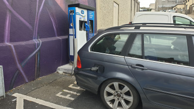

Do you have canlogs of both events?Jack Bauer wrote: ↑Sat Aug 21, 2021 2:33 pm Road trip! Went on a 160 mile jaunt today to collect some parts. 3 CCS stops.
1)Circontrol. No problems got full 125A available.
2)Efacec. No charge constantly failing around state 1/2. Modded the state machine so state 0 is "standby" for 2 seconds. Problem solved. Full power.
3)Efacec. As above. Worked fine with mod to state 0.
Not bad for a 22kwh Zoe pack in an E46 touring...

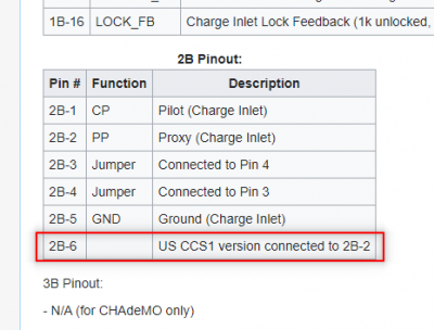

Hey, folks.
I believe CCS1 and CCS2 just differ in the charging plug. Also saw somebody confirming it in this thread too.
But the wiki (https://openinverter.org/wiki/BMW_I3_Fa ... LIM_Module) says that the US version LIM module has a jumper between 2B-2 and 2B-6 connections.
My LIM module have just arrived from IRELAND, so it got me wondering....
Anybody had success with the CCS1 here yet?
Thanks in advance.
Thanks in advance.
- Posts: 120
Could this be to do with latching behaviour, as the CCS1 has a manual latch release button?

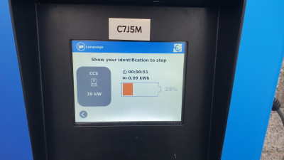

Back on the road again. Seems my favorite ccs stations in the whole world have had a sexy software update. The good : Nice display of charge power, The bad : station reported voltage is now wayyy over that recorded in the car. The ugly : yep you guessed it! fake "over voltage" shutdowns.

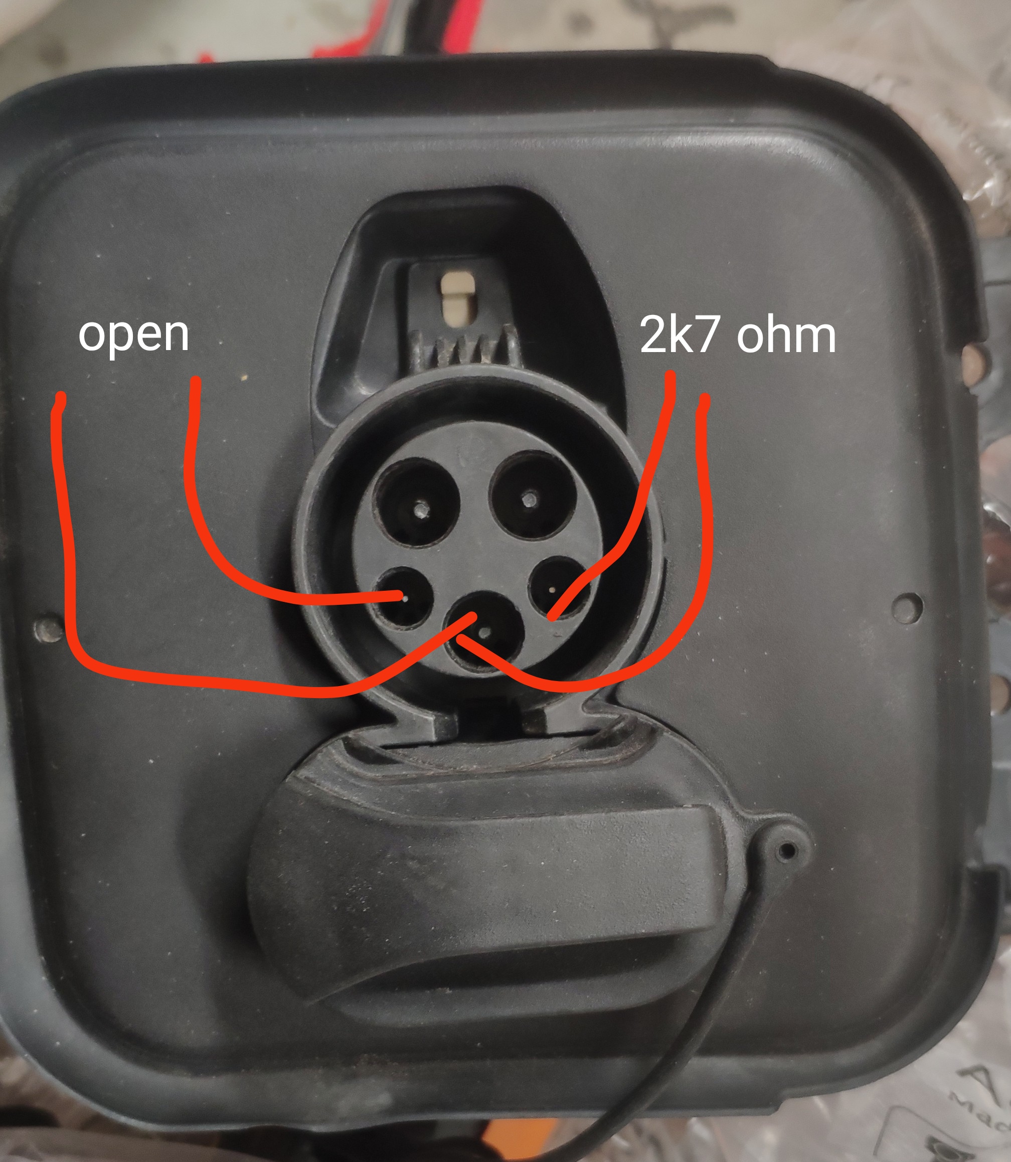

Got my charge port early! Yay!alexbeatle wrote: ↑Mon Oct 18, 2021 7:23 pmMine is arriving early November. Will post if nobody else has it by then.Jack Bauer wrote: ↑Sat Oct 16, 2021 5:36 pm Could someone with an i3 charge port check if it has any resistors?
It's a CCS1 charge port, from Feb 2018 - BWM part number 61126840439.
There's an open between PP and gnd. 637ohm between CP and gnd.

Sorry folks, there's been a mistake.alexbeatle wrote: ↑Sat Oct 23, 2021 1:15 amGot my charge port early! Yay!alexbeatle wrote: ↑Mon Oct 18, 2021 7:23 pmMine is arriving early November. Will post if nobody else has it by then.Jack Bauer wrote: ↑Sat Oct 16, 2021 5:36 pm Could someone with an i3 charge port check if it has any resistors?
1. I mentally swapped the pin out of the plug vs. socket.
2. Working on another project, I discovered that my meter isn't functioning well.
I bought a new meter and tested it.
CP to gnd - open. PP to gnd ~2k7 (2696 ohms to be exact). This seems to correspond to what the wiki shared here earlier is showing.
- Posts: 3639
- Has thanked: 9 times
- Been thanked: 275 times
Ok that makes sense. Now we just need someone with a type 2 ccs socket to measure.

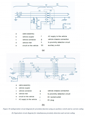

This is a nice document showing the differences between charging protocols...Jack Bauer wrote: ↑Tue Oct 26, 2021 7:16 am Ok that makes sense. Now we just need someone with a type 2 ccs socket to measure.
In other news contactors and connector kits for the LIM now available from EVCreate :
https://www.evcreate.nl/shop/charging/c ... om-bmw-i3/
https://www.evcreate.nl/shop/charging/c ... ng-module/
I have added these links to the wiki.
Page 35 shows a J1772 (Type 1 plug) PP circuit used in the US on top and a IEC 61851 (type 2 plug) circuit used in Europe on the bottom. https://www.researchgate.net/publicatio ... _Standards
This would mean there is no PP - PE resistor in the type 2 charging port.
- muehlpower
- Posts: 680
- Has thanked: 14 times
- Been thanked: 133 times
Phoenix Contact specifies for Type1 inlets 2k7 and for Type2 4k7 between PP and GND, regardless of whether it is AC/DC or just AC.
- EV_Builder
- Posts: 1205
- Location: The Netherlands
- Been thanked: 37 times
I just measured my VW ID3 CCS port: 4k7 between PP and GND.muehlpower wrote: ↑Tue Oct 26, 2021 3:56 pm Phoenix Contact specifies for Type1 inlets 2k7 and for Type2 4k7 between PP and GND, regardless of whether it is AC/DC or just AC.
With no car connected (the part with some loom) in my hands.
