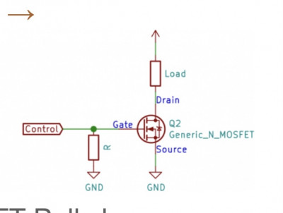

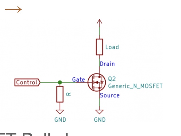

The code produces a pwm on the pwm pins, pin 4 being the inverter pwm signal, but with any pwm output on the teensy you need a simple circuit using a logic level n channel mosfet to switch gnd on and off…
If you’ve got 12v at the teensy pwm pins then it’s likely fried, here an picture of a simple low side mosfet circuit
I’d use a 10k pull down resistor

Just to be sure: Control is the inverter PWM pin(s) and Load is the Teensy PWM signal?
Using the 10k resister to lower the voltage. When I get an n channel mosfet, would 12v be ok?
Thanks again. Got 2 more Teensy 3.2 coming. I socket mounted the Teensy just for this reason.
Thank you.

Nope control is pin on the teensy, load is the inverter pwm pins, 10k pull down resistor where R is, (it’s not their to lower voltage) You need to make sure you are using a logic level (works with low voltage triggers) n channel mosfet
