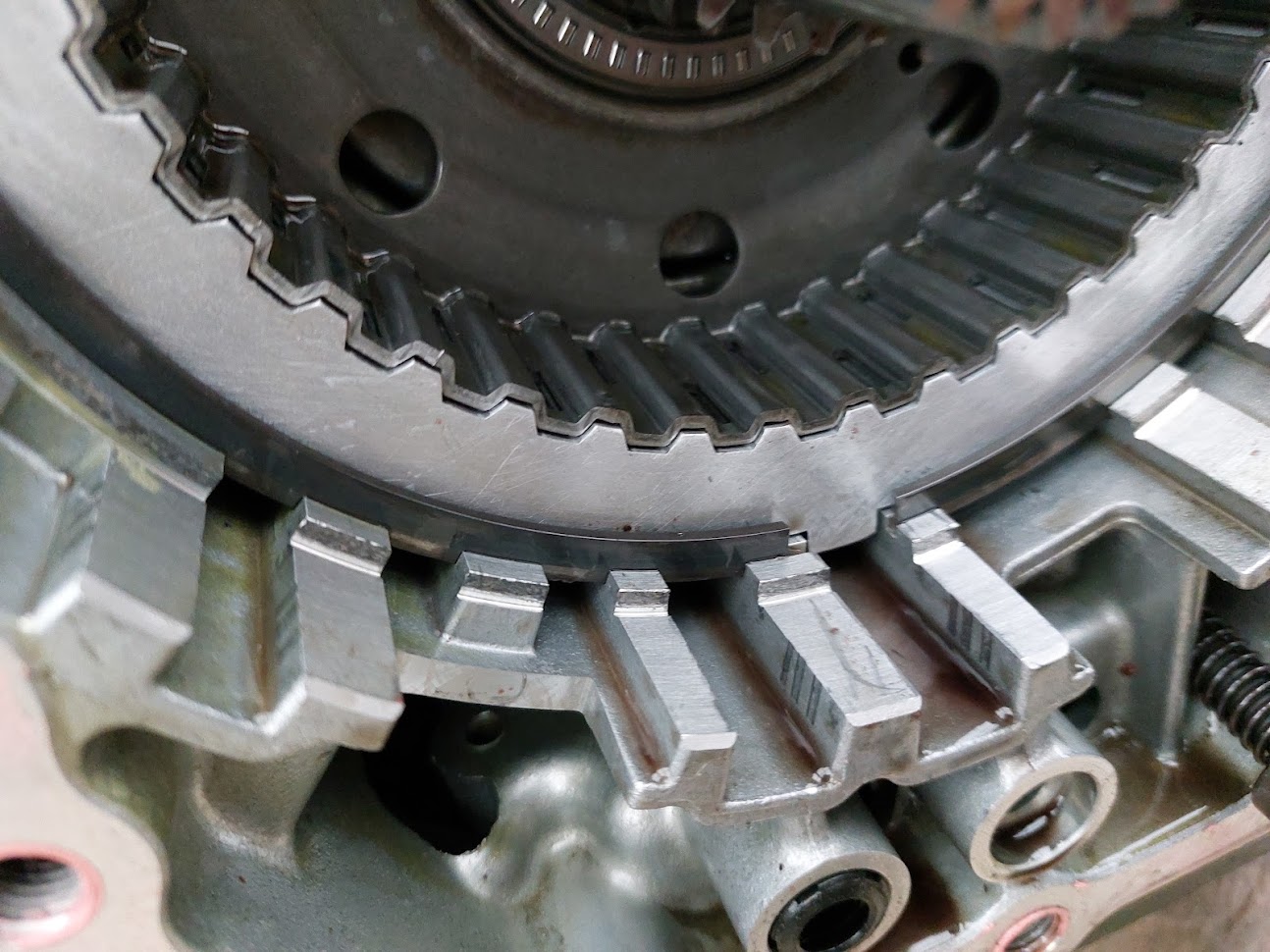

Test sample of the ring for permanently locking the high range was cut from PVC plastic. Laser wasn't really accurate(cheap model for advertisement production) and burned a little too much into the ring, but measurements seems to be taken correctly, so here dxf file for those who interested. You need to make a 32mm pack of this rings, preferably from some sort of 2-3mm thick stainless steel. Or make half of them and replace only rings with outer teeth.

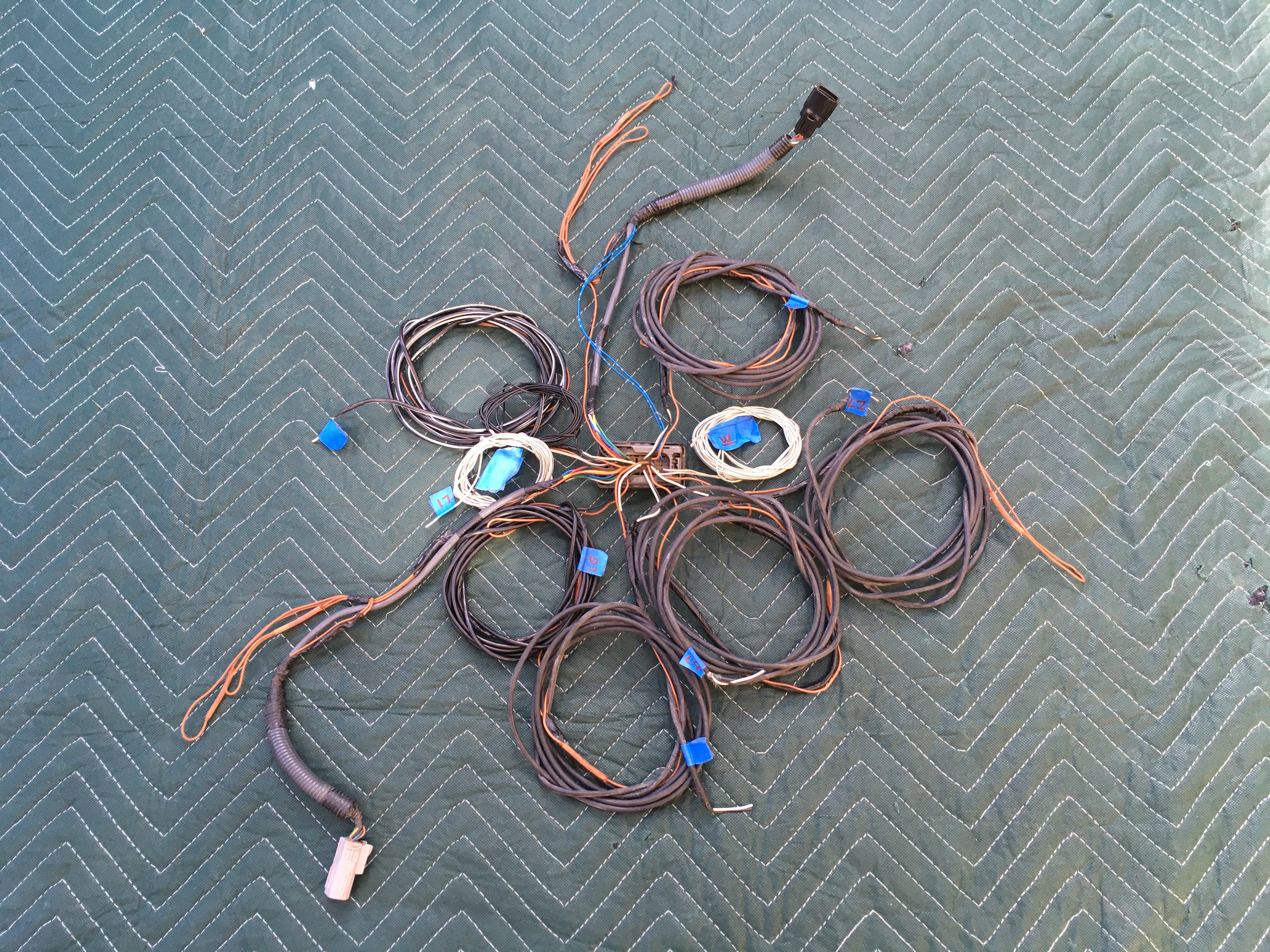

I skimmed this thread and did not catch the part numbers for the Engine/Transmission harness so I would like to share what I have recently learned when buying mine, I hope you don't mind, I also would like to share a link to me going through the detailed steps of "thinning" it out which I posted on the DIY Electric Car forum (I am still a little bit intimidated to post here on the accounts of lack of smarts and all, ha ha) 1971 GMCe Lexus GS450H BMW 530e Tesla Model S powered Electruck
ok so a little background, my transmission and inverted are both from the same 2010 Lexus GS450H, and this harness is from a 2008
now check this out and you tell me if this makes any sense to you guys:
Part Name: Engine Wire
Harness Part # 82121-30E21 is for 2007-2010 (this is the one I bought)
$1,369 at the local Stealership
Harness Part # 82121-30E22 is for 2009-2011 (based on my VIN I actually need this one, but the other plugs in to the transmission just fine)
$1,366 at the local Stealership
the large rectangular plugs on this harness plug into the Engine Control Module ECM / Hybrid Vehicle Control ECU which appears to be one and the same small metal box with two connectors on it
as mentioned before by some others, this harness does NOT include the INVERTER plug, that plug comes on a different harness, this harness actually directly plugs into the other harness, I have that information as well, but one thing at a time
and here it is all thinned out to just the sections we need

Nice! Looks like yours includes the VSS connector too. That could be helpful depending on how you plan to drive your speedo/odo. Yeah, I nearly sliced the end of my thumb off getting down to the simple, bare necessities on that harness! It's now numb on the very tip. I don't think anyone has found the harness with the inverter plug (I could be wrong), so great if you have that PN. My local Lexus dealership couldn't find it. Fortunately, my inverter came with it attached!Gregski wrote: ↑Sat Oct 30, 2021 4:53 pm I skimmed this thread and did not catch the part numbers for the Engine/Transmission harness so I would like to share what I have recently learned when buying mine, I hope you don't mind, I also would like to share a link to me going through the detailed steps of "thinning" it out which I posted on the DIY Electric Car forum (I am still a little bit intimidated to post here on the accounts of lack of smarts and all, ha ha) 1971 GMCe Lexus GS450H BMW 530e Tesla Model S powered Electruck

in the diagram below the TEAL harness is the Inverter Harness and the OLIVE harness is the Transmission harness the arrow points to how and where they plug in directly into each other (no intermediate box involved)
their proper names are:
Engine Room Main Wire - this is the Inverter harness
Engine Wire - which is the engine and transmission harness that we need and has the part numbers I listed in the previous post this harness has two rectangular plugs of which the larger one plugs into the Engine Control Module ECM, and a smaller one plugs in to the same box but they call that plug Hybrid Vehicle Control ECU

I've fabricated that locking ring for high range, I've shared here before, from solid piece of aluminum.
It fits like a glove.

Mother of god... When my pump fails, I'll be reaching out... Watching the space very closely.

this is the Inverter harness, officially called Engine Room Main Wire part numbers:
82111-30K62 fits 2008-2009
costs $7,144 new
82111-30K64 fits 2010
costs $6,341 new
The Resolver plugs from the transmission harness plug in directly into the Inverter harness like so
if you can prevent the seller from just cutting off the pig tail and get them to unwrap about 18" away from the Inverter plug then the Resolver plugs come with the Inverter plug like so
and if you unwrap just a little more you won't cut the brown wires that simply loop back on themselves, so the actual remaining Inverter Plug wiring is not that much that runs to the Hybrid Vehicle Control ECU larger plug.
the full anatomy of this harness can be viewed here: 1971 GMCe Lexus GS450H BMW 530e Tesla Model S powered Electruck

Re: GS450H Discussion
SWEET! I am certain this is superior to my (alternate) plan of just filling that space with J-B Weldkonstantin8818 wrote: ↑Wed Nov 03, 2021 1:08 pm I've fabricated that locking ring for high range, I've shared here before, from solid piece of aluminum.
It fits like a glove.![]()

I just had an option of milling this part for free. It is less costly to cut those from 2mm stainless steel with laser and replace only metal clutch rings.
Atleast now I'm absolutely certain that this part will fit where it belongs.
