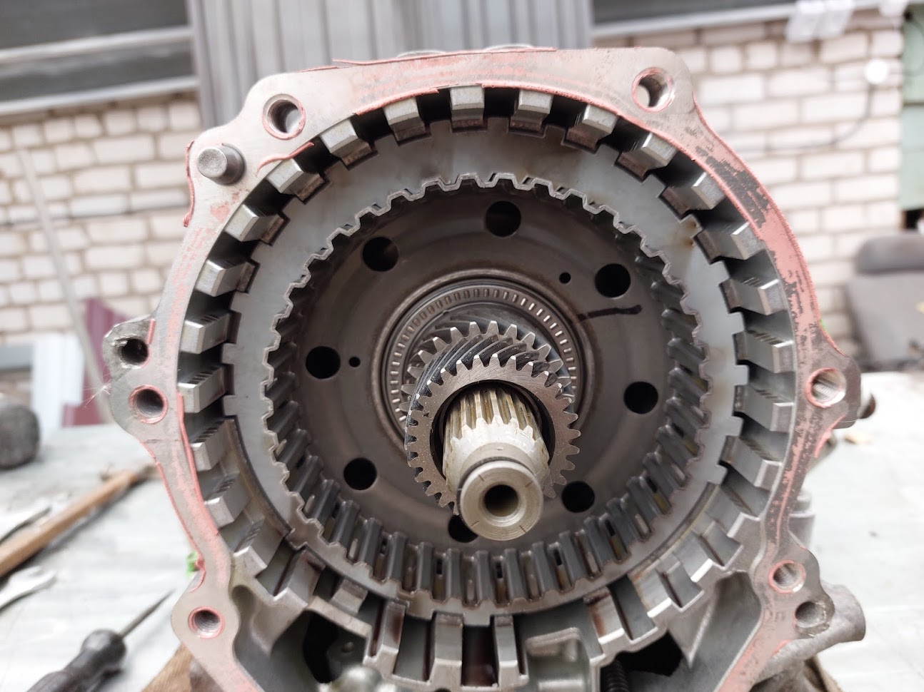

Test sample of the ring for permanently locking the high range was cut from PVC plastic. Laser wasn't really accurate(cheap model for advertisement production) and burned a little too much into the ring, but measurements seems to be taken correctly, so here dxf file for those who interested. You need to make a 32mm pack of this rings, preferably from some sort of 2-3mm thick stainless steel. Or make half of them and replace only rings with outer teeth.

konstantin8818
Posts: 290
Location: Minsk, Belarus
Been thanked: 10 times
Re: GS450H Discussion
Post by konstantin8818 »
Markos wrote: Sat Oct 16, 2021 12:45 pm If I'm right, the mechanical pump is connected to the ring gear (green) of MG1. If the engine (blue) is locked and MG1 (yellow) turns, then the ring gear will turn and I would say the mechanical pump would also turn. But I think the pro's here can give the correct answer.
Watch my post at previous page. Mechanical pump connected to blue part, wich is ICE input. If you go same way as Damien, locking up input shaft, then you need external oil pump. I'm now at process of locking planetary carrier, to use original mechanical oil pump. Only one issue is it won't work while in reverse, so I need to lock mechanically one of the gear ranges.

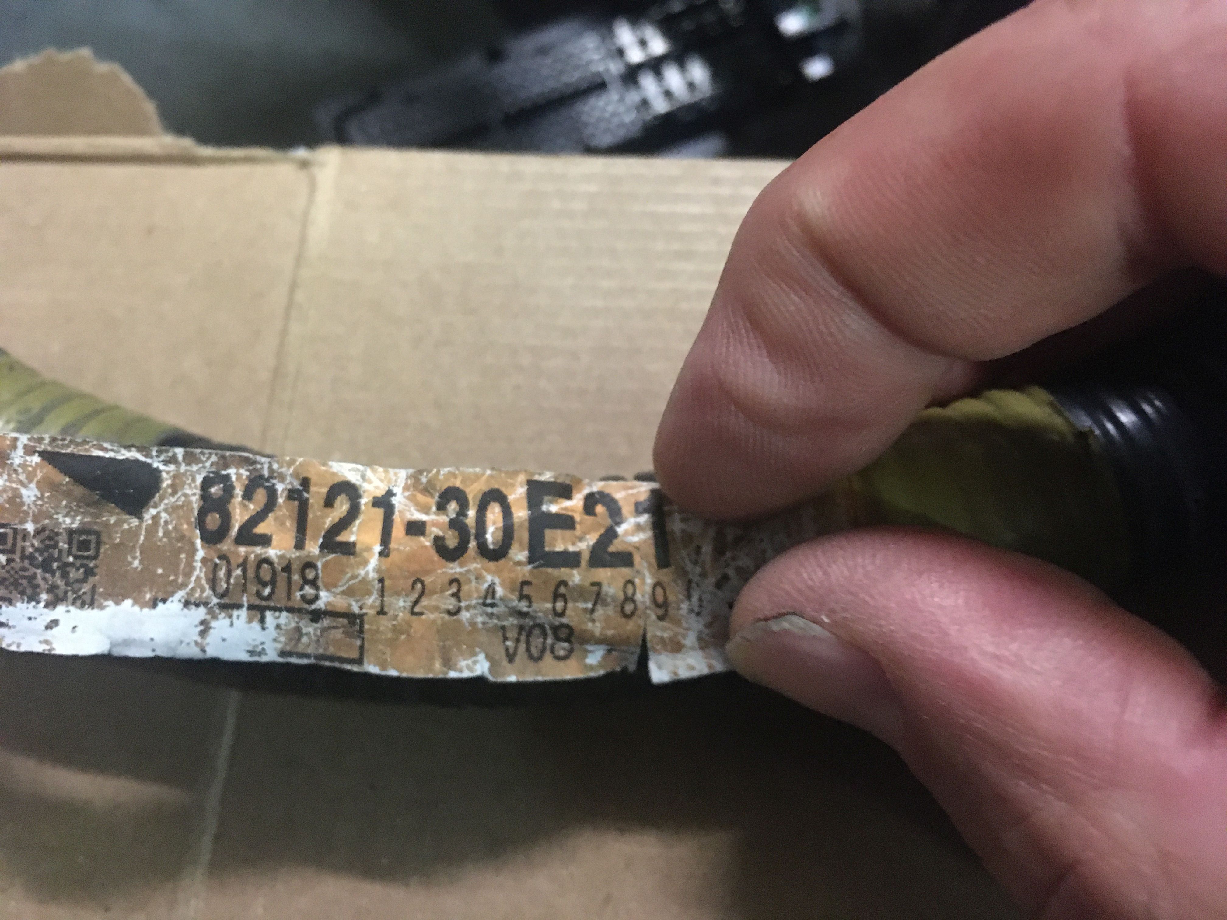

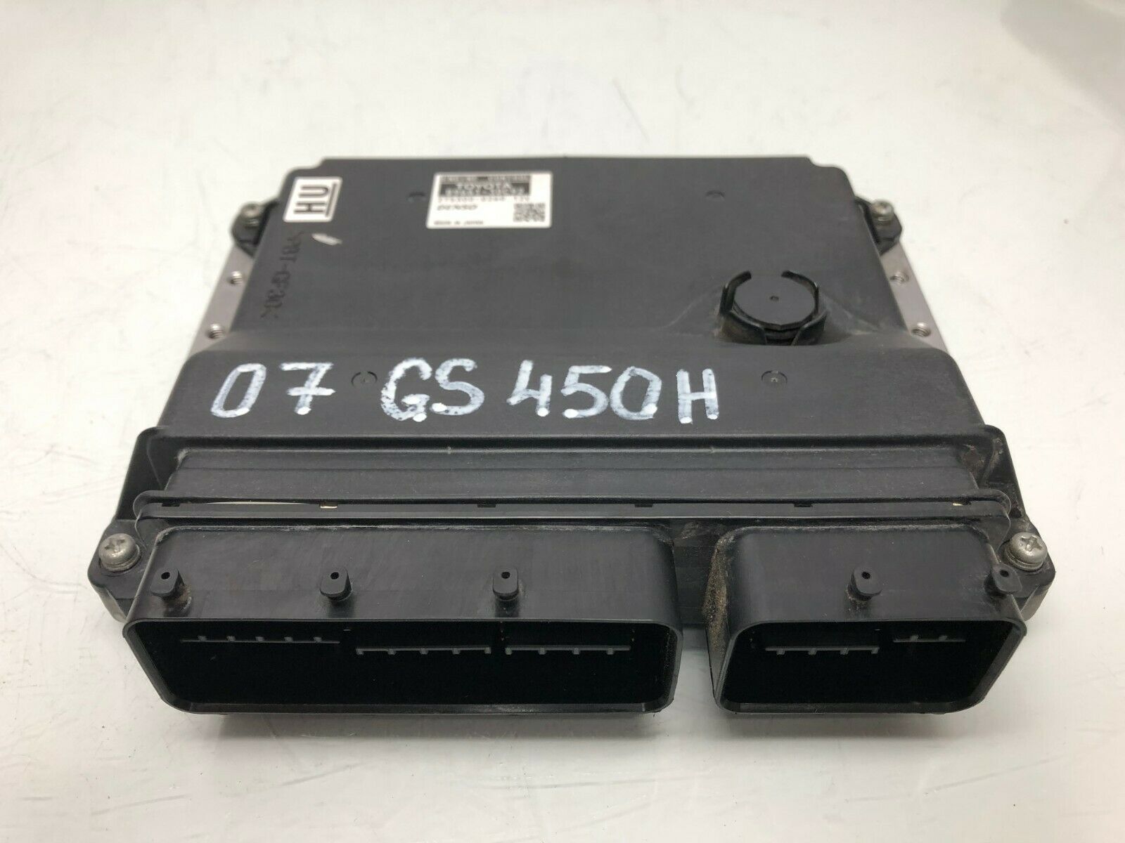

Post by Gregski »
I skimmed this thread and did not catch the part numbers for the Engine/Transmission harness so I would like to share what I have recently learned when buying mine, I hope you don't mind, I also would like to share a link to me going through the detailed steps of "thinning" it out which I posted on the DIY Electric Car forum (I am still a little bit intimidated to post here on the accounts of lack of smarts and all, ha ha) 1971 GMCe Lexus GS450H BMW 530e Tesla Model S powered Electruck
ok so a little background, my transmission and inverted are both from the same 2010 Lexus GS450H, and this harness is from a 2008
now check this out and you tell me if this makes any sense to you guys:
Part Name: Engine Wire
Harness Part # 82121-30E21 is for 2007-2010 (this is the one I bought)​
$1,369 at the local Stealership​
Harness Part # 82121-30E22 is for 2009-2011​ (based on my VIN I actually need this one, but the other plugs in to the transmission just fine)
$1,366 at the local Stealership​
the large rectangular plugs on this harness plug into the Engine Control Module ECM / Hybrid Vehicle Control ECU which appears to be one and the same small metal box with two connectors on it
as mentioned before by some others, this harness does NOT include the INVERTER plug, that plug comes on a different harness, this harness actually directly plugs into the other harness, I have that information as well, but one thing at a time
and here it is all thinned out to just the sections we need

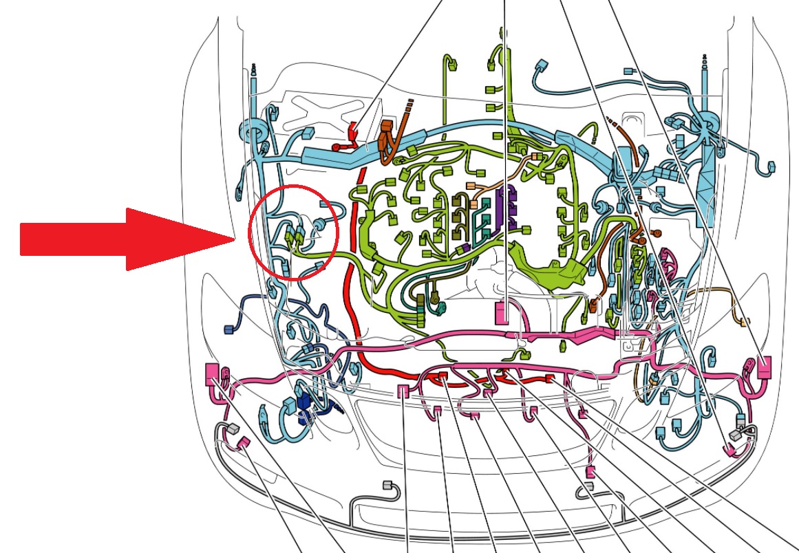

Gregski
Posts: 3171
Has thanked: 635 times
Been thanked: 1611 times
Post by Gregski »
in the diagram below the TEAL harness is the Inverter Harness and the OLIVE harness is the Transmission harness the arrow points to how and where they plug in directly into each other (no intermediate box involved)
their proper names are:
Engine Room Main Wire - this is the Inverter harness
Engine Wire - which is the engine and transmission harness that we need and has the part numbers I listed in the previous post this harness has two rectangular plugs of which the larger one plugs into the Engine Control Module ECM, and a smaller one plugs in to the same box but they call that plug Hybrid Vehicle Control ECU
I've fabricated that locking ring for high range, I've shared here before, from solid piece of aluminum.
It fits like a glove. :)

konstantin8818 wrote: Wed Nov 03, 2021 1:08 pm I've fabricated that locking ring for high range, I've shared here before, from solid piece of aluminum.
SWEET! I am certain this is superior to my (alternate) plan of just filling that space with J-B Weld :D
