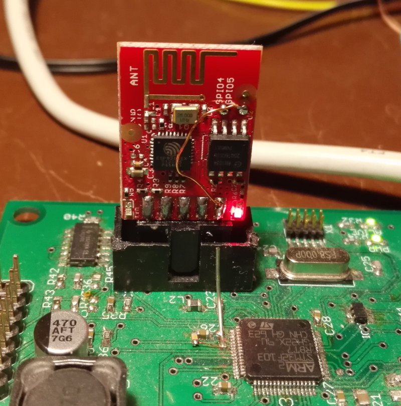

Very nice addition, when it finally works people don't need an STLink anymore to program fresh boards :)
Here is how I patched it to a V3 mainboard, just routed SWDIO and SWDCLK to the unused pins 9 and 10 of the ESP socket. This could be done by default in new designs. Then on the ESP module I also bridged GPIO4 and 5 to those pins. GPIO4=CLK=Pin 9 Esp=Pin 2 SWD and GPIO5=DATA=Pin 10 Esp=Pin 4 SWD
Gpio4 is bridged on the back side.
